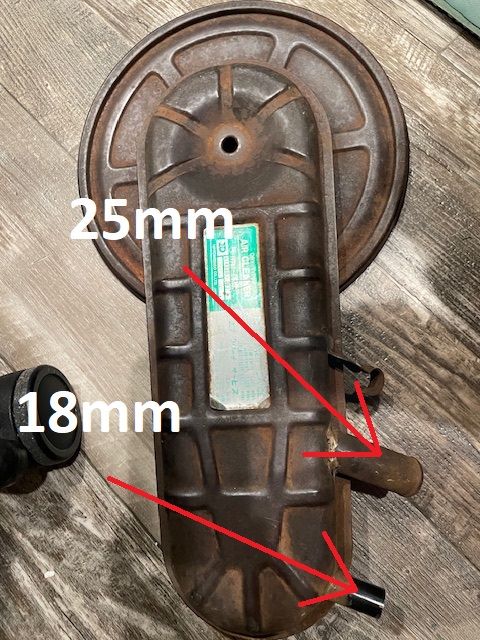

Just wanted to provide the hose sizes for the Nippondenso Air Cleaner in case anyone else couldn't find them. The big one is 25mm and the little one is 18mm. I read somewhere else on here it's best to use silicone hoses so that's what I got. Nice snug fit but I'm still using hose clamps to be safe.
FWIW, you can get cotton braided/plain OE looking rubber hose for those lines in metric instead of silicone. Usually VW parts places have it in stock or Belmetric is a good source too.
