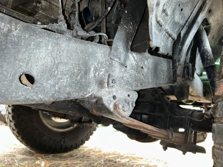

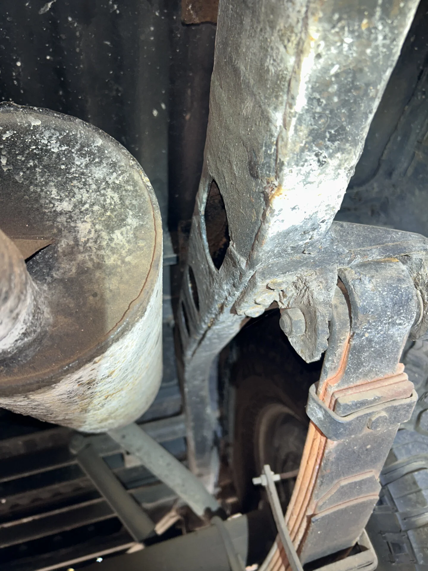

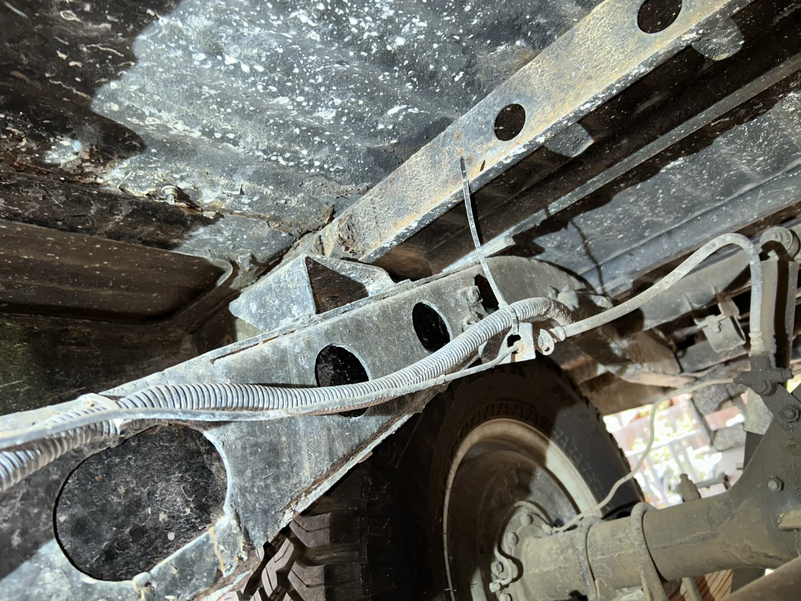

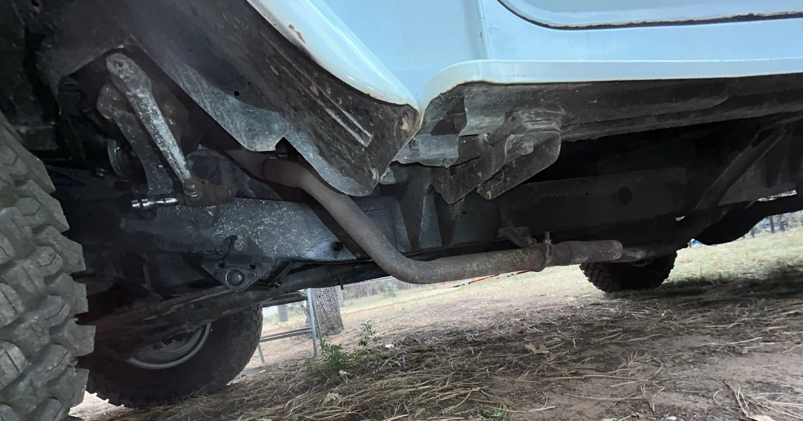

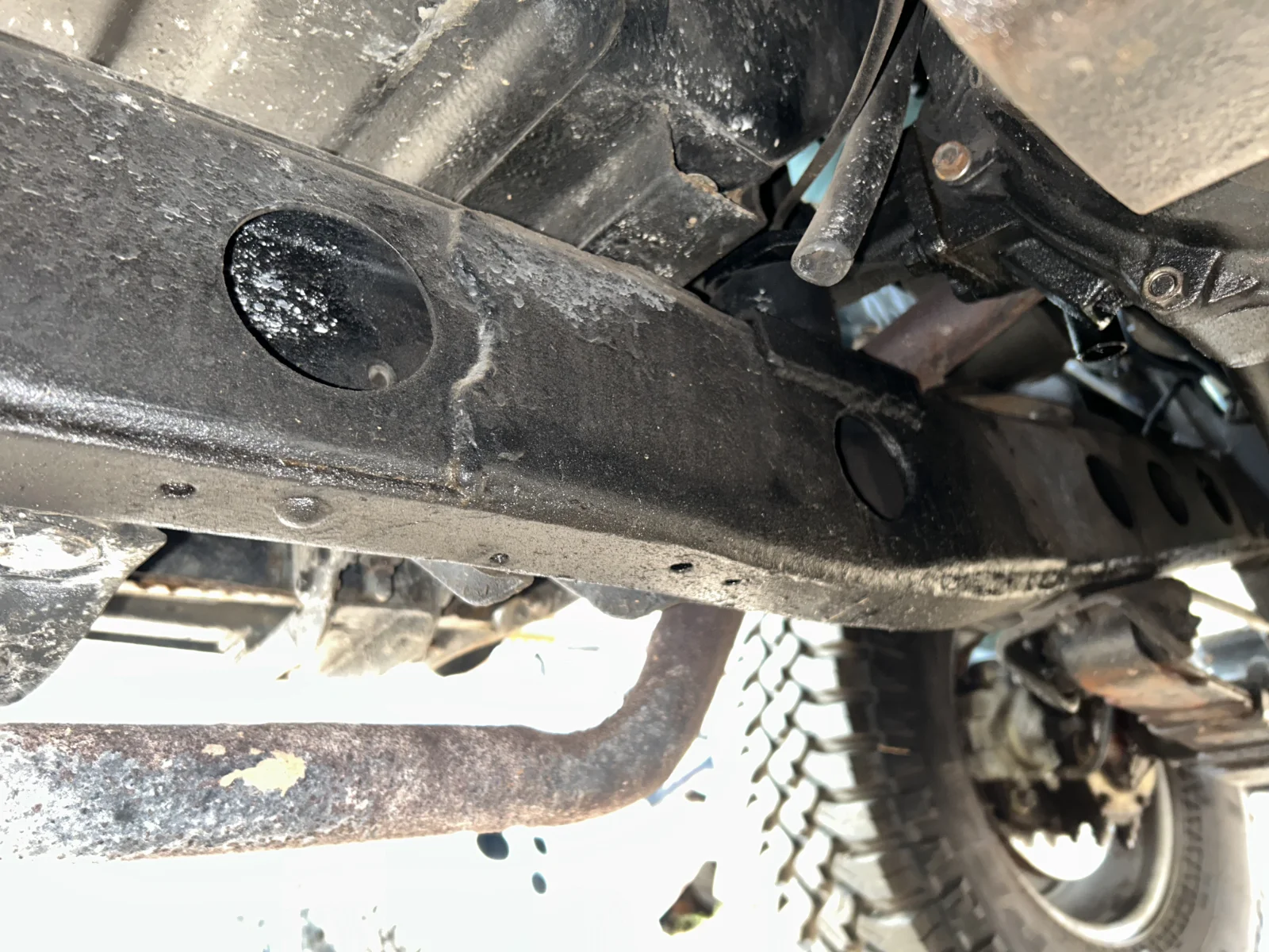

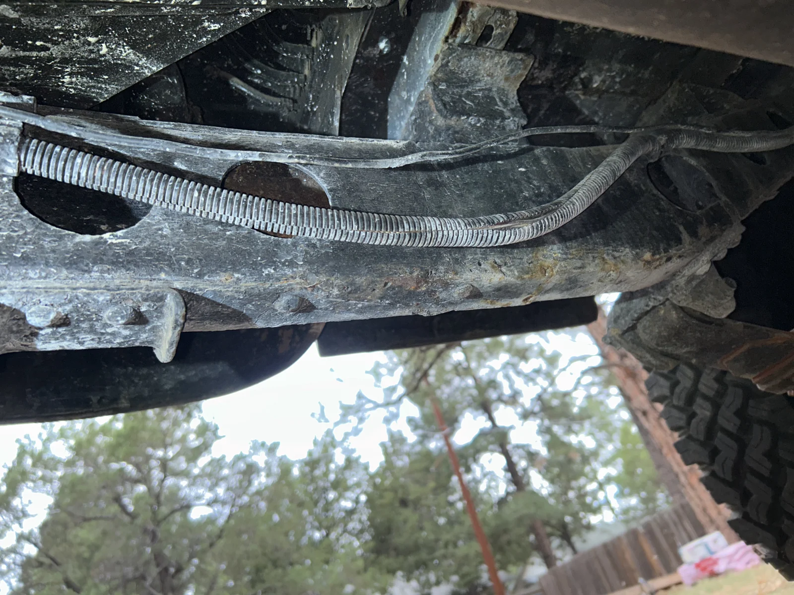

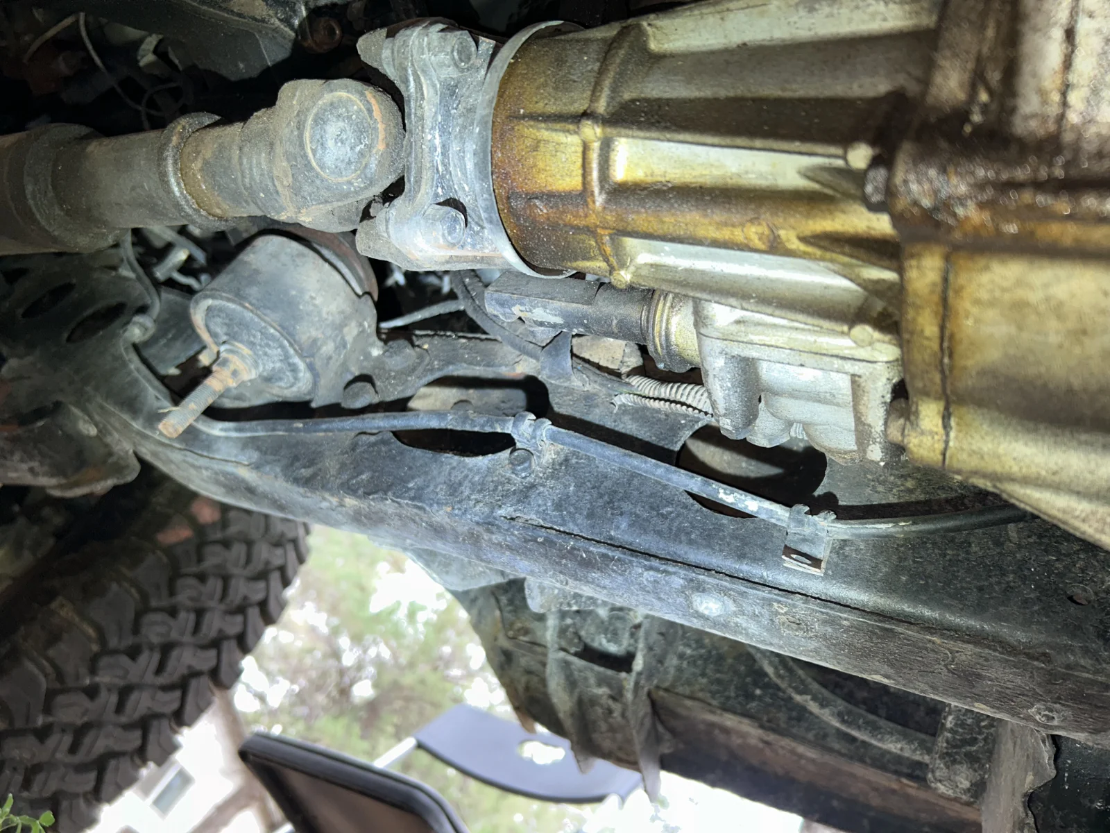

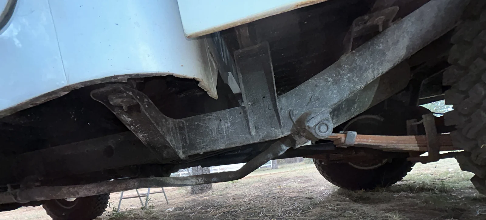

  • I am worried of frame damage. However, I figure cracks can be fixed or a new frame purchased. I will take some pics and post them asap.
  • Outside of the engine/trans/t-case and frame, what the hell is there to really worry about? Yeah, axles, etc. but that's all solvable in increments.

I’m in the exact same boat. I imported hj45 from Honduras. I did all the importation myself and glad I did it to learn about it. It has frame damage and bondo all over it. Would I do it again? probably not from Central America. I have bought a 2H to go in mine and plan on scraping off bondo and see what I have, replacing the floor and starting there. I guess it depends on your time and budget. All my cruisers are mostly rusty especially my LV and fixing them is part of the fun even if some require more effort than others. I was forewarned about trucks coming from Central America on here but I had some money to play with and thought I’d learn for myself. I met some great people in Honduras and learned a lot.

That long-winded reply being said, I don't mind the need for repairs, again-just the lies. I hope mine isn't too bad, but I am gonna get under it and take pictures of the chassis and see if it really is all messed up.

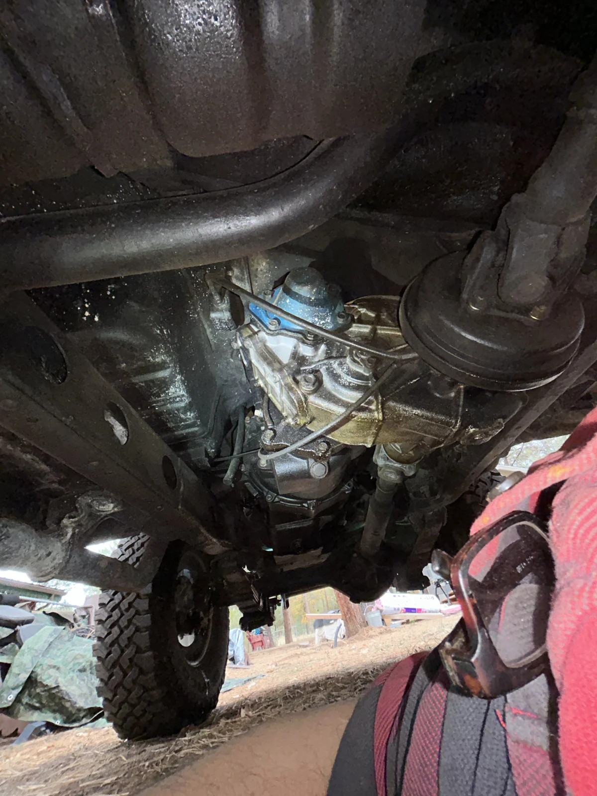

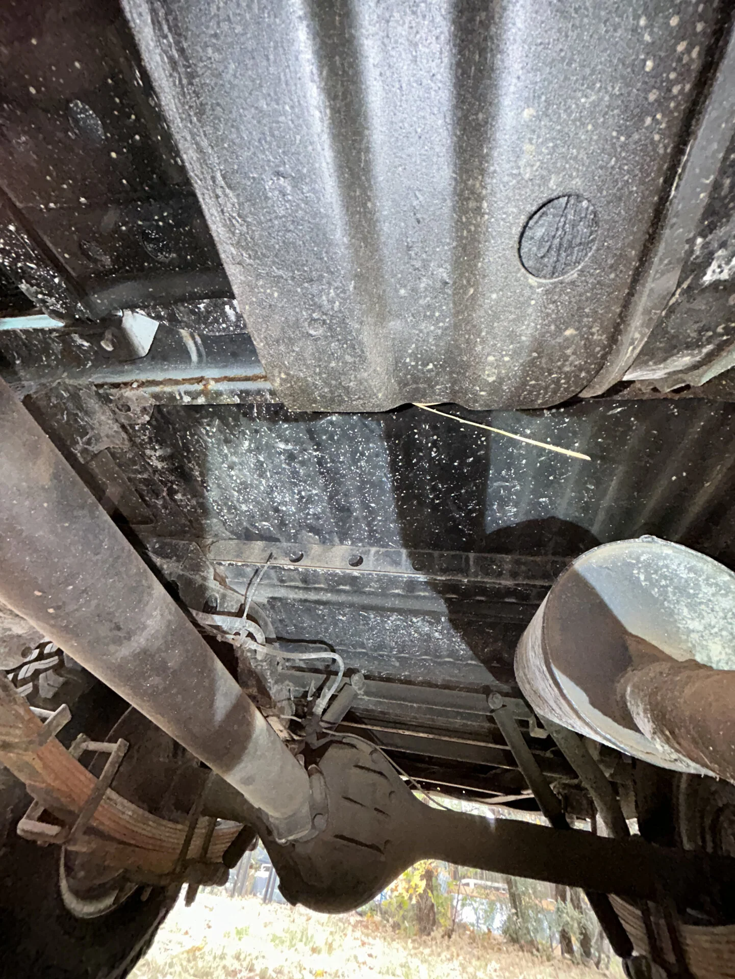

Anyway, I think the main first step is taking pictures of the underside and seeing if there's bad frame damage. Then, building a garage so I can start the process. It's getting cold already and no way am I working in the snow!

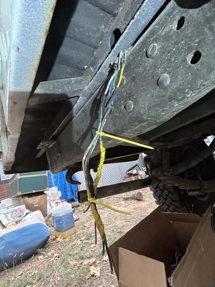

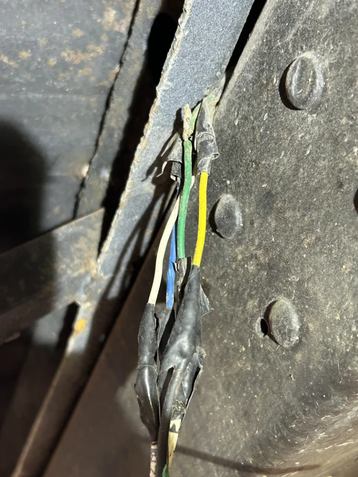

I just replaced the turn and brake signals all around. Suddenly the left and right blink at the same time when on left turn, and the right blinks dimly with the left brightly on right turn. Or the other way around. Can't recall. Very frustrating!!!
I noticed before doing the change that the license plate light would also blink very dimly.
The wiring back there was a mess: up to four splices of different wire colors in a 12" section. Unreal.
I will have to try again tomorrow. Got dark and cold.
Here's a pic or two of the wiring. The yellow tape is mine-I did that last minute before leaving Florida when I noticed the wires wrapped with paper tape.
