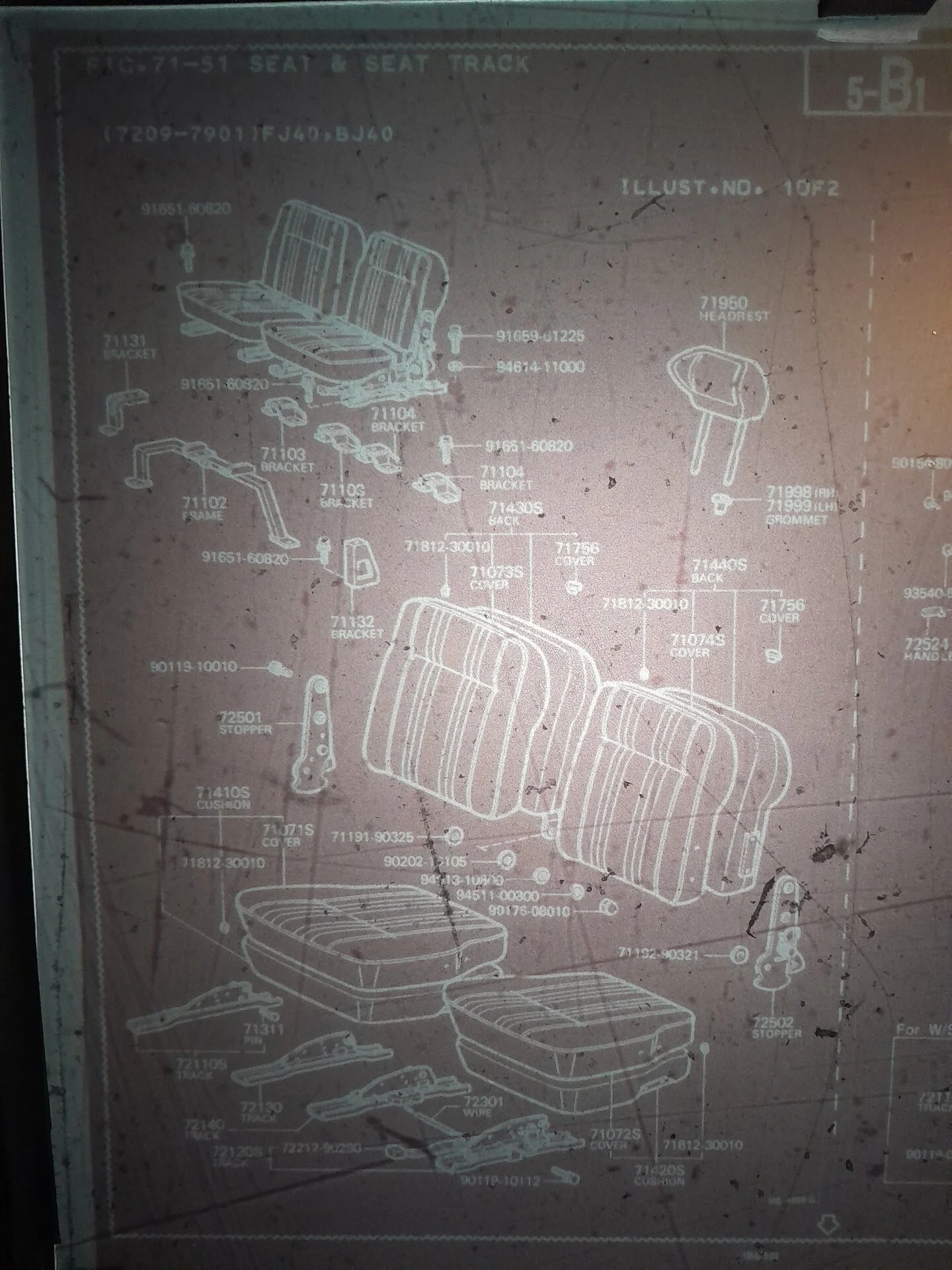

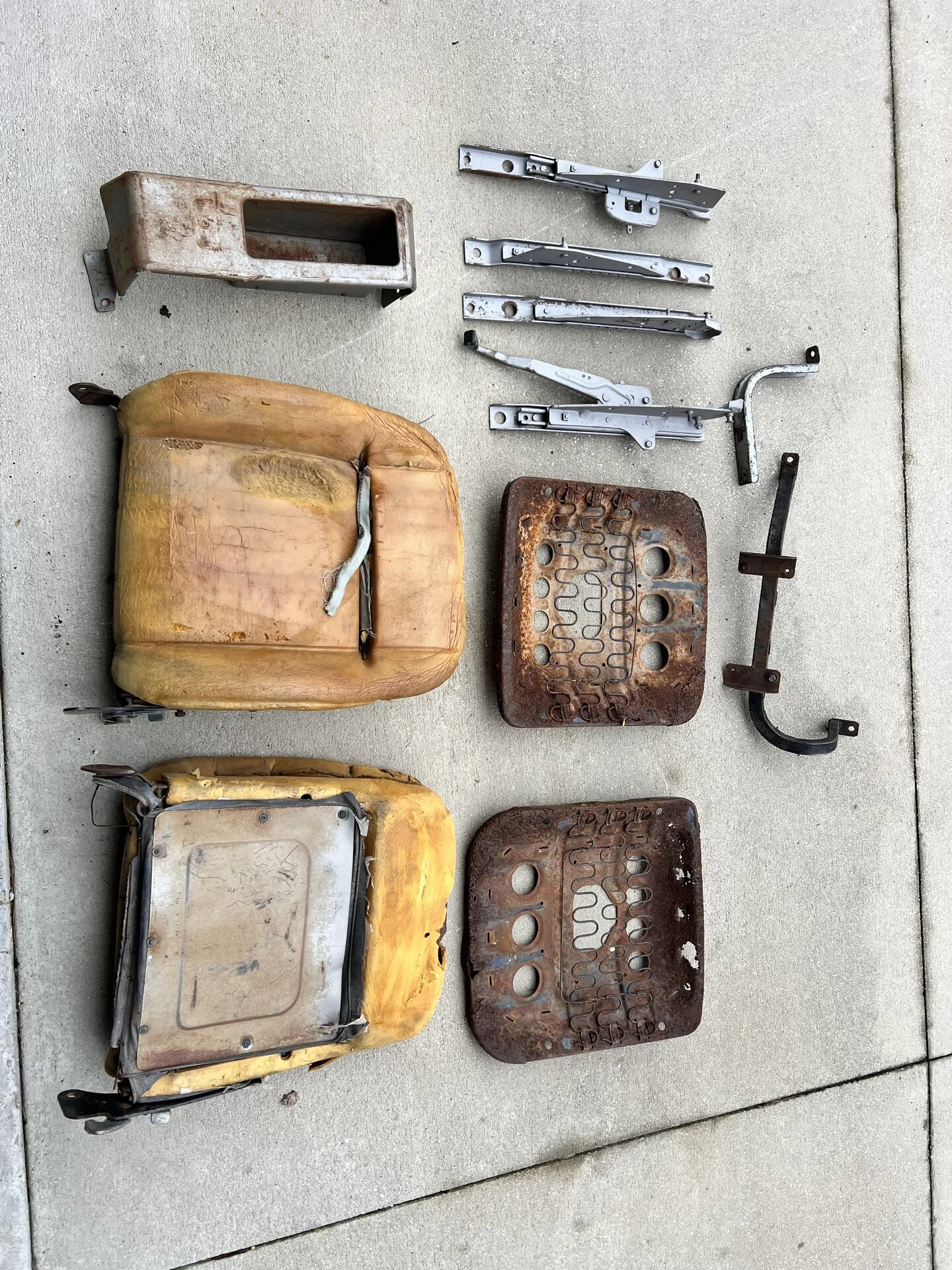

I currently have a set of Corbeau seats in my FJ40 and was considering going back with the original style seats. I think I have most of the needed parts ….. although the bottom pans probably won’t make it and might cause me to get tetanus shot !!!!
Does it look like anything else I’m missing to move forward ? I also have most of the bolts and nuts.
Any good place to locate the bottom pans ?

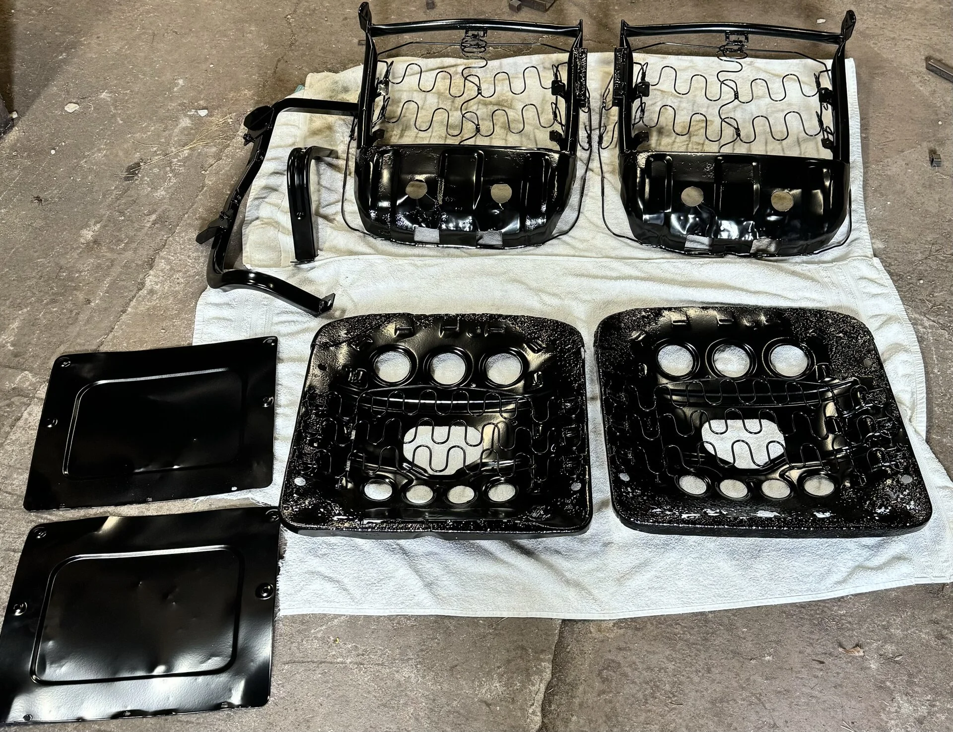

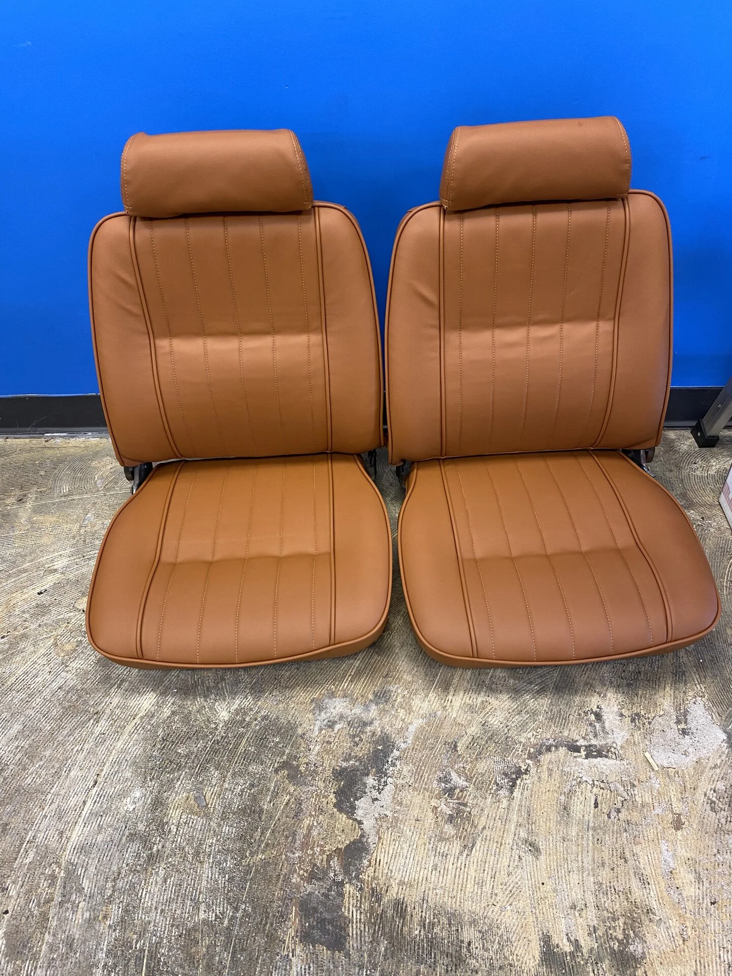

Just got my seats back from sandblasting / powder coating. I welded supports on the bottom of the pans as the rust was pretty bad on the bottoms but the sides where the brackets mount are solid.
I’m looking at the foam / covers kits from SOR ….. I may also talk with a local upholstery shop just to compare pricing. I really like the color on this set for the front a rear
I have the mounts for the seats…. Are there any other items I’m missing to complete the swap?
While you are in there you may think about throwing in some heated seats pads. I did it with my front sheet restoration and it's a nice upgrade. I live in Alaska however so it's cold for much of the year.
Apart from that I'm not seeing anything that you are missing besides the covers, foam (old or new) and the hog rings or HD zip ties.
Headrest? Some have it, some don't.

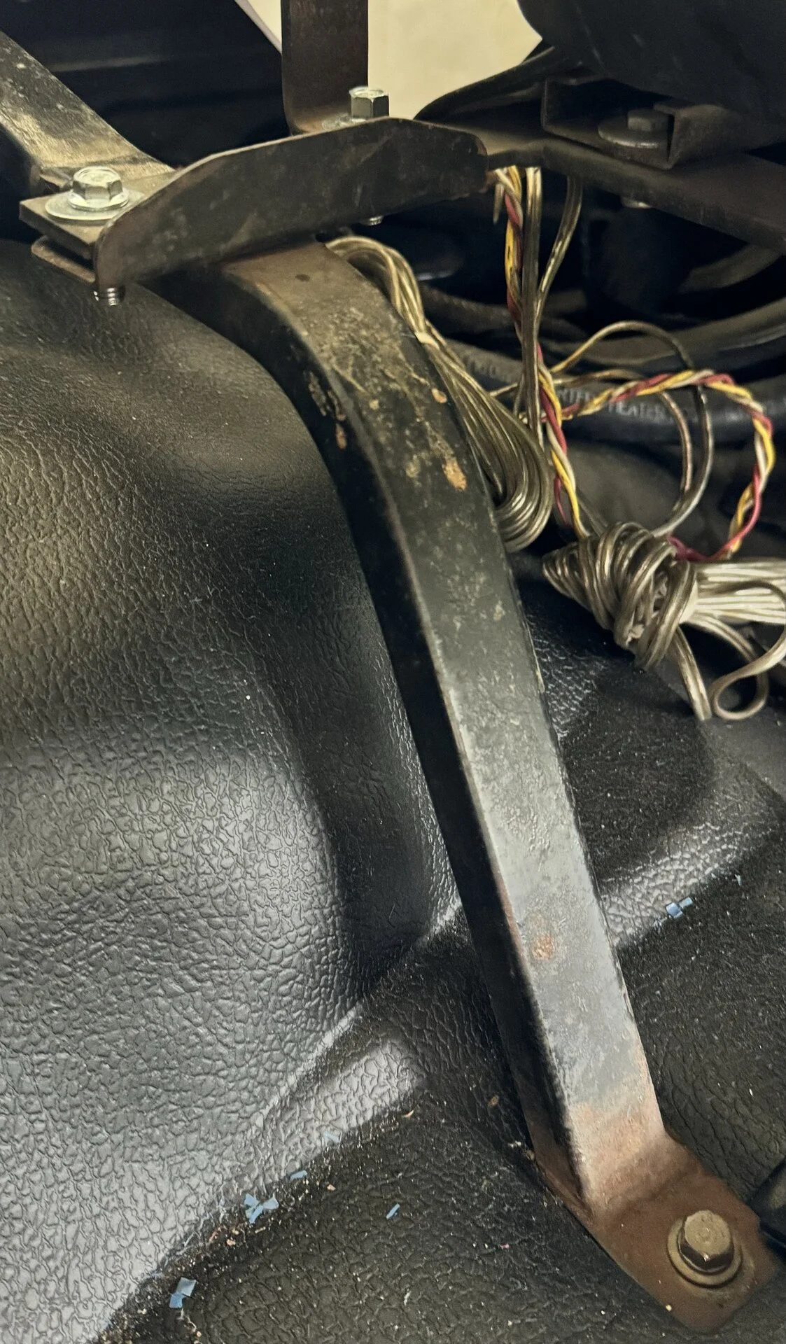

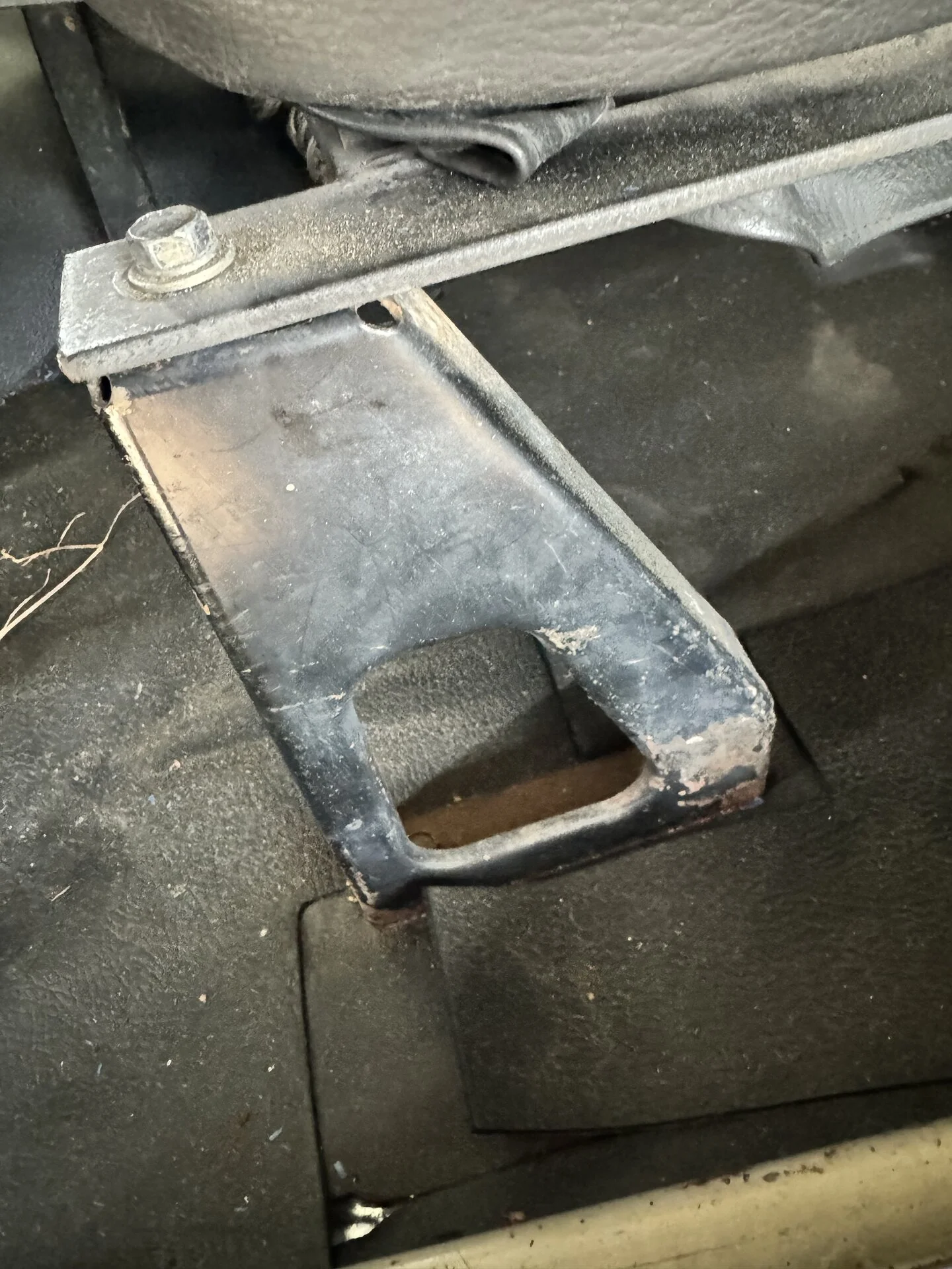

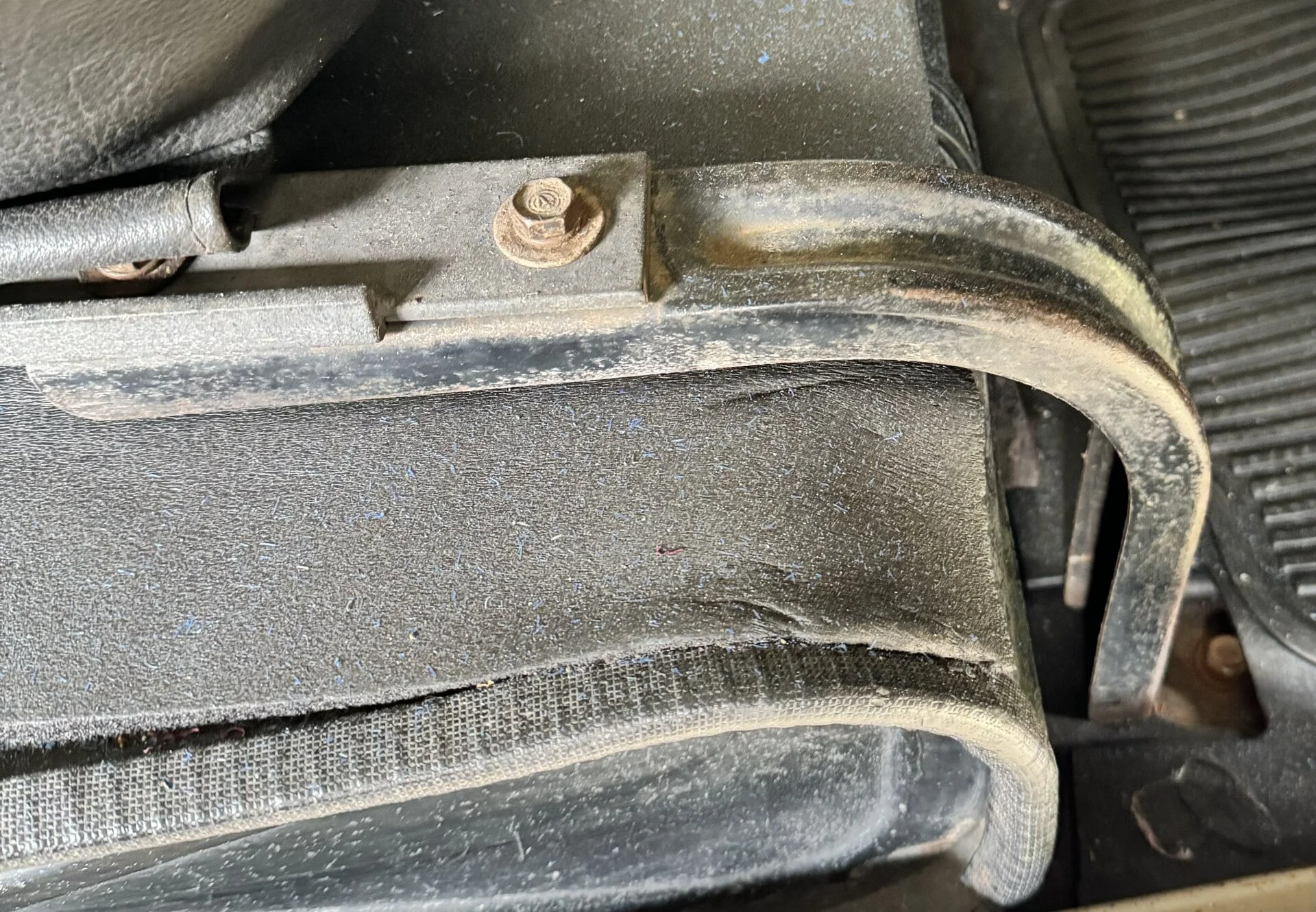

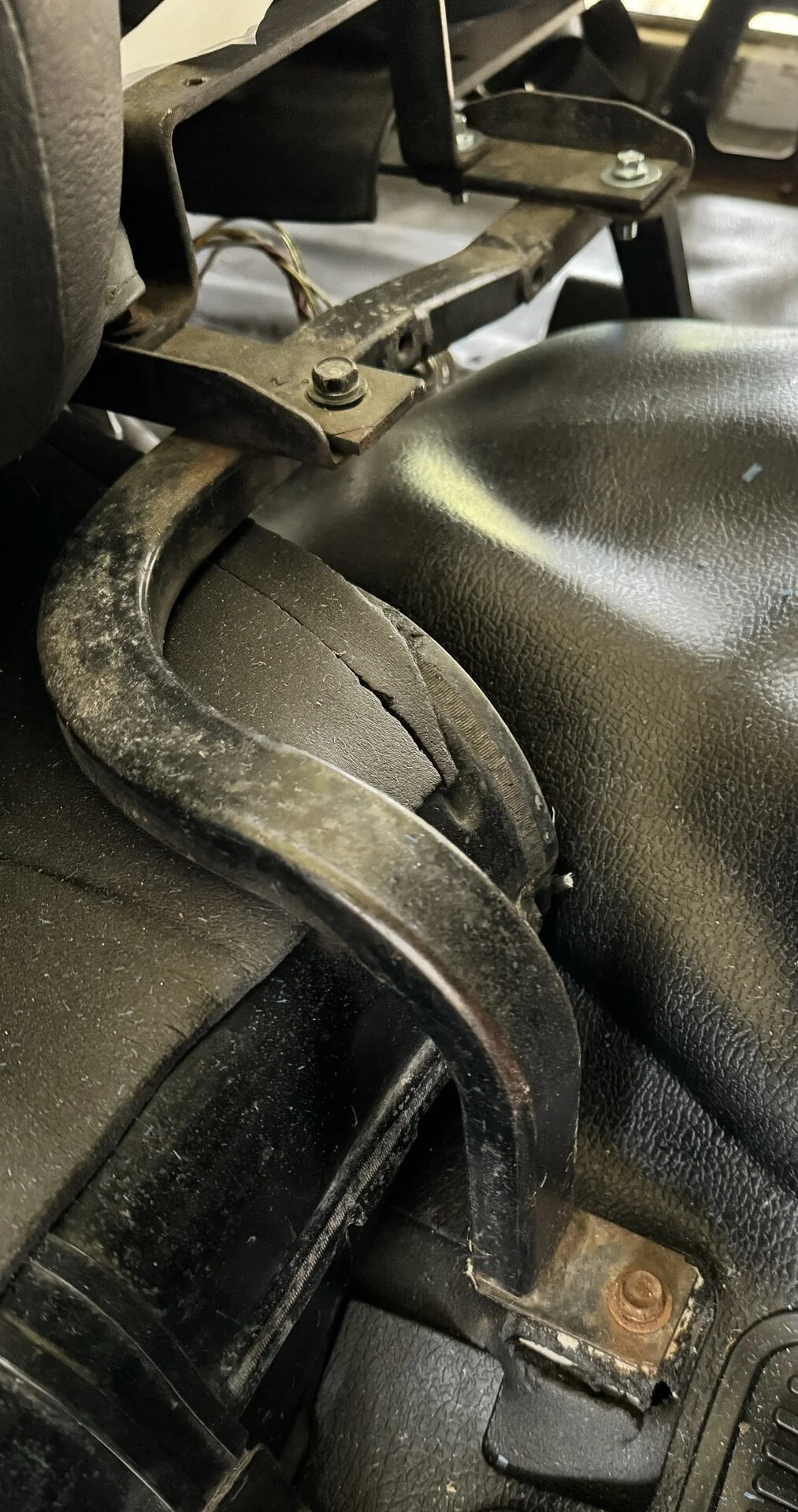

I take that back. You are missing the left support for the drivers seat. Goes on the front left side of the driver's seat and bolts to the floor.

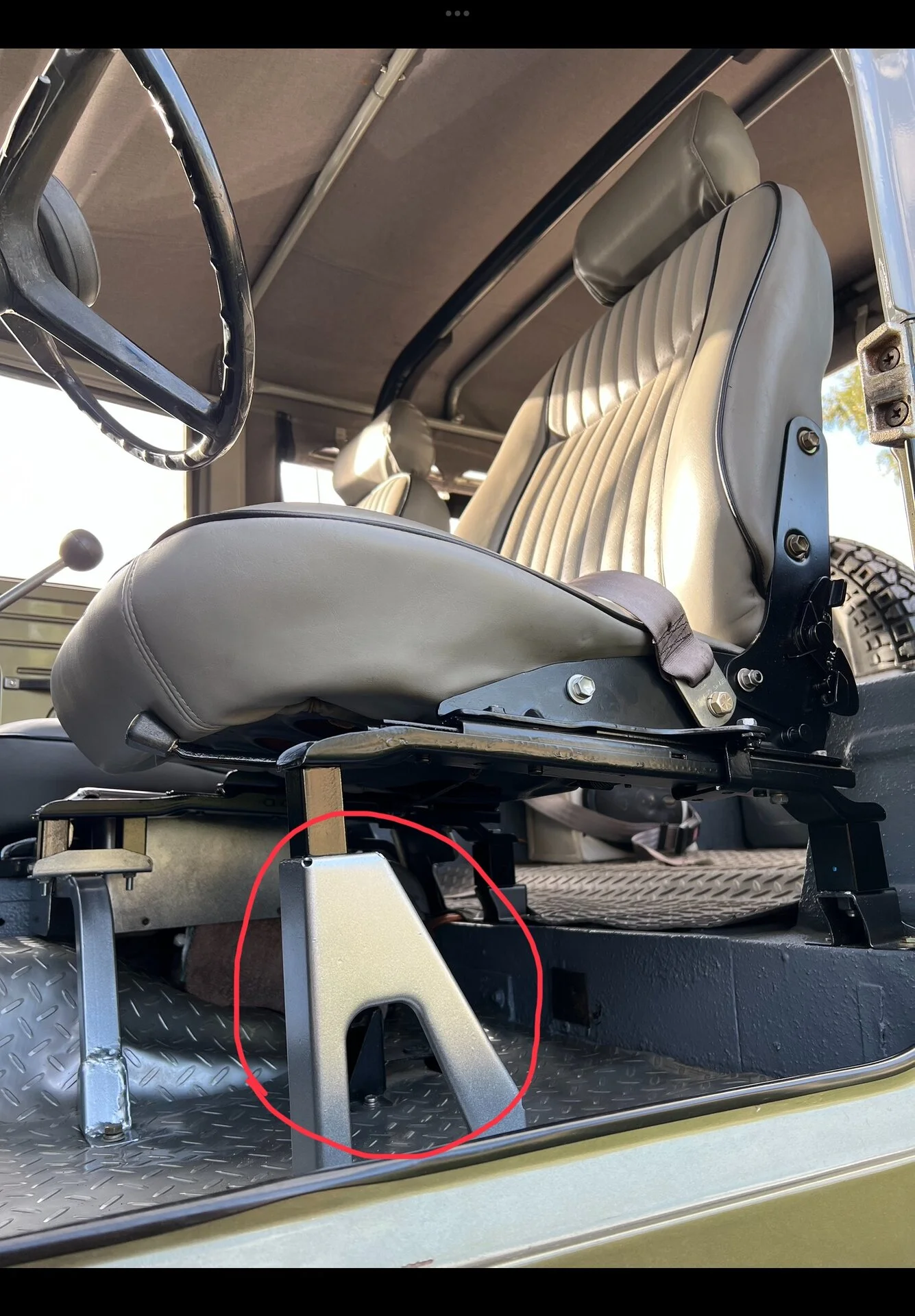

You need this piece
View attachment 3602437View attachment 3602438

SOR has the new seat foam which makes a huge difference. I also like their seat covers the best. Just need to rob bank or work a lot of overtime before you purchase. Once you get over sticker shock of foam and seat cover prices, then they hit you with shipping. But... IMO they are the best. HTH

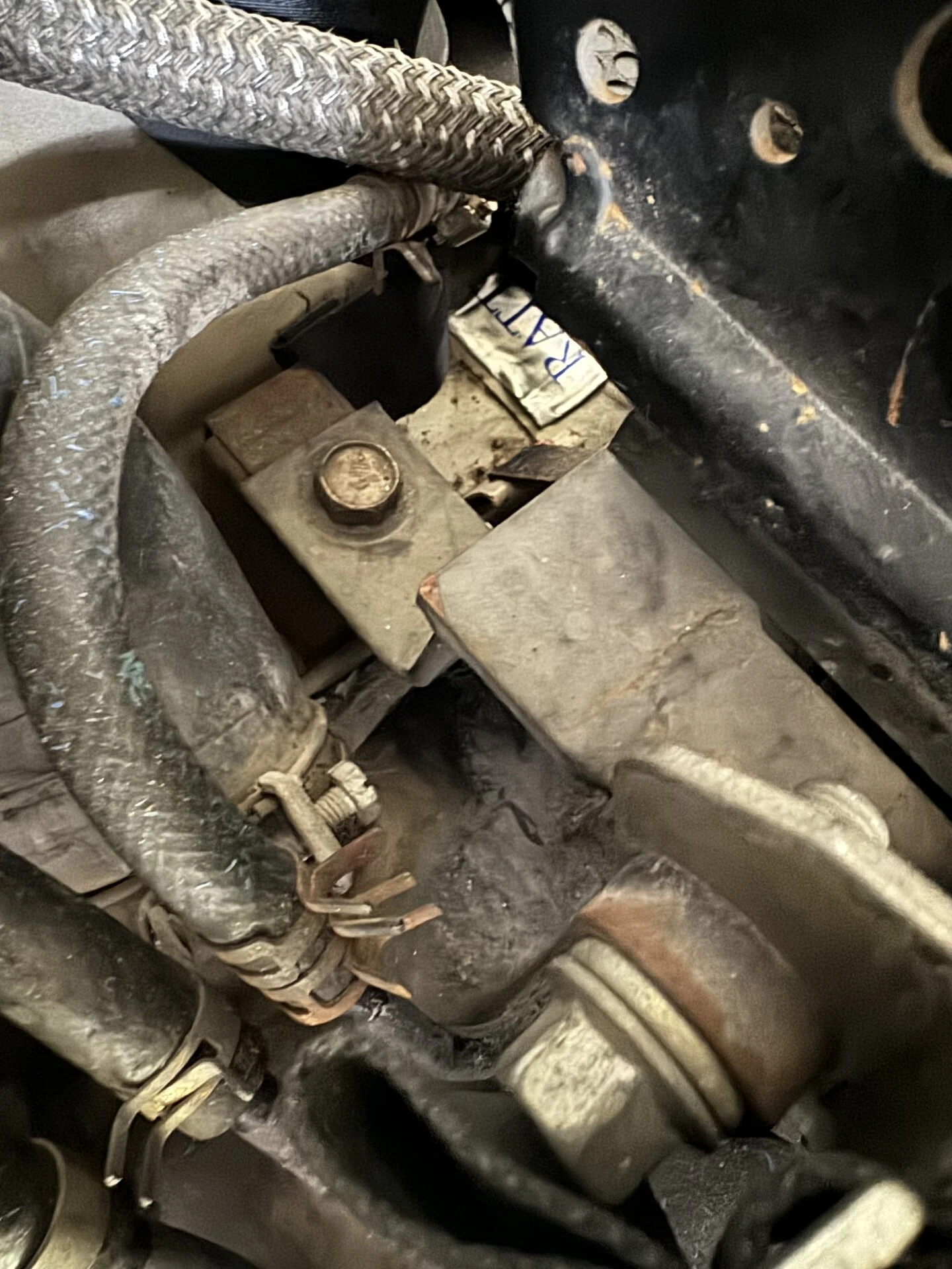

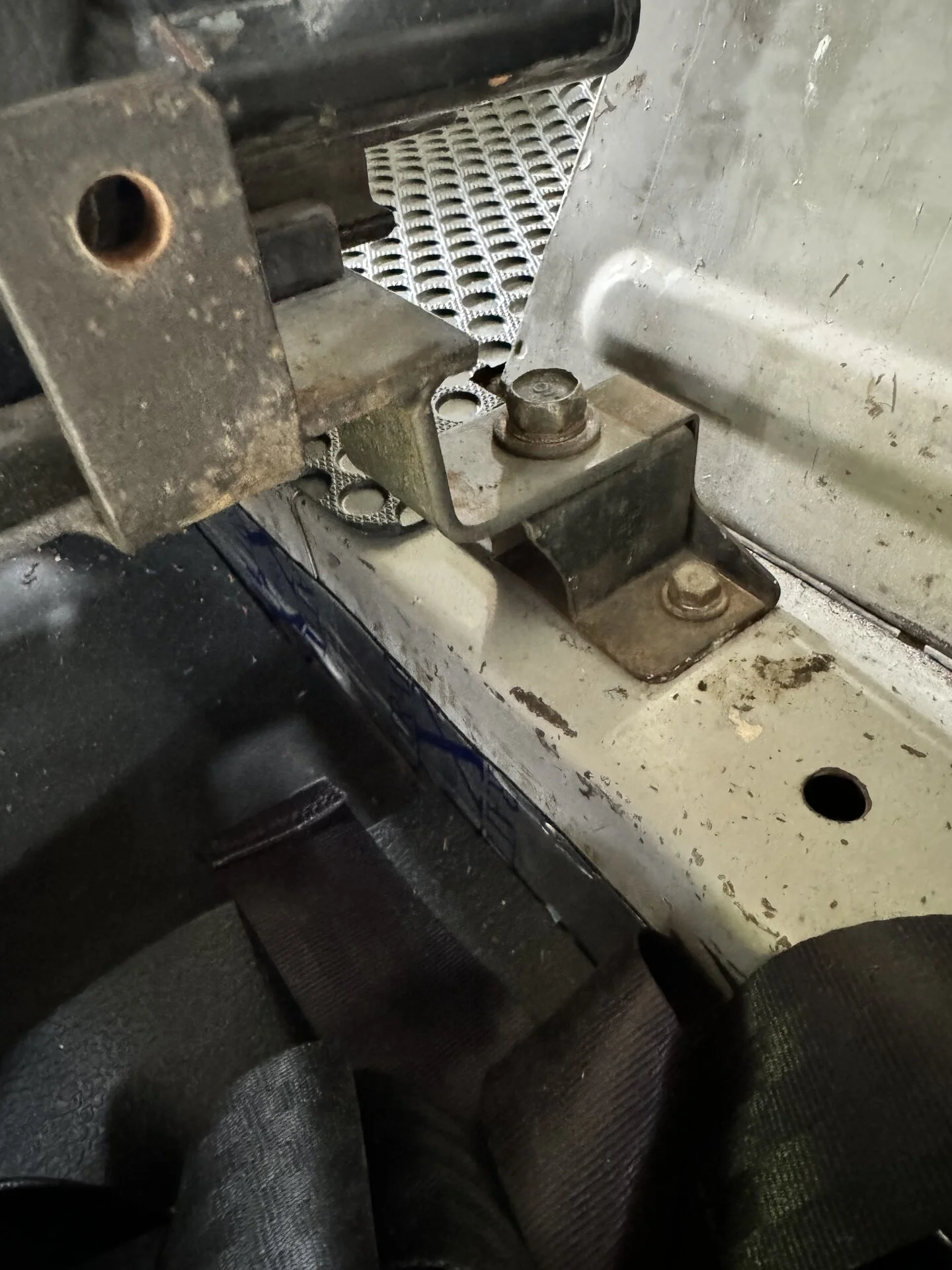

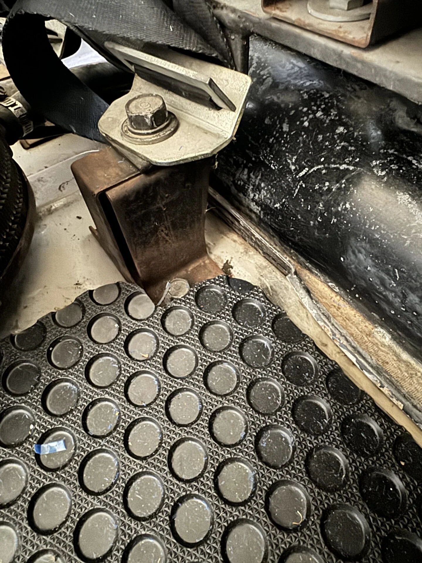

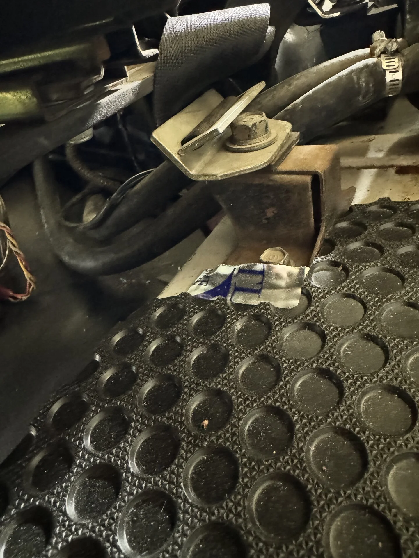

Missing all four rear mounts as well.
Also in the sor bottoms are awesome, and they need to be to cushion you after paying for shipping.
Looks like the missing parts from you earlier photos are in your Cruiser already.
I did this last year. I too decided to bite the bullet on the SOR seat foam and upholstery kit. It was spendy for sure but I haven't regretted it for a minute. The seat foams are nice!
