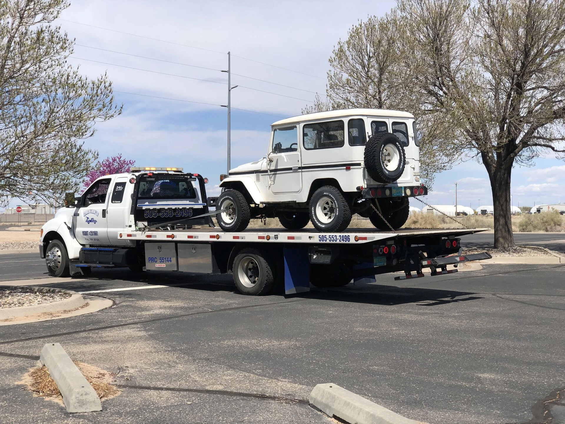

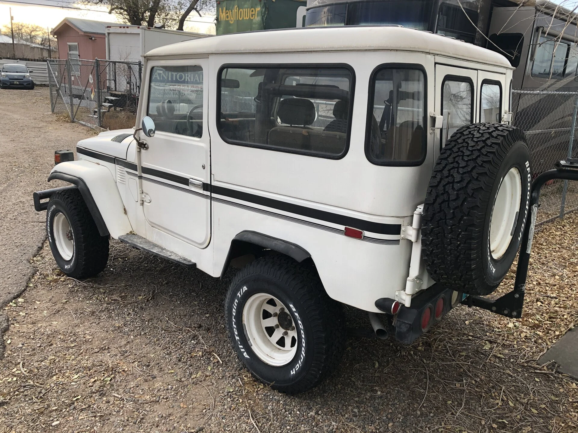

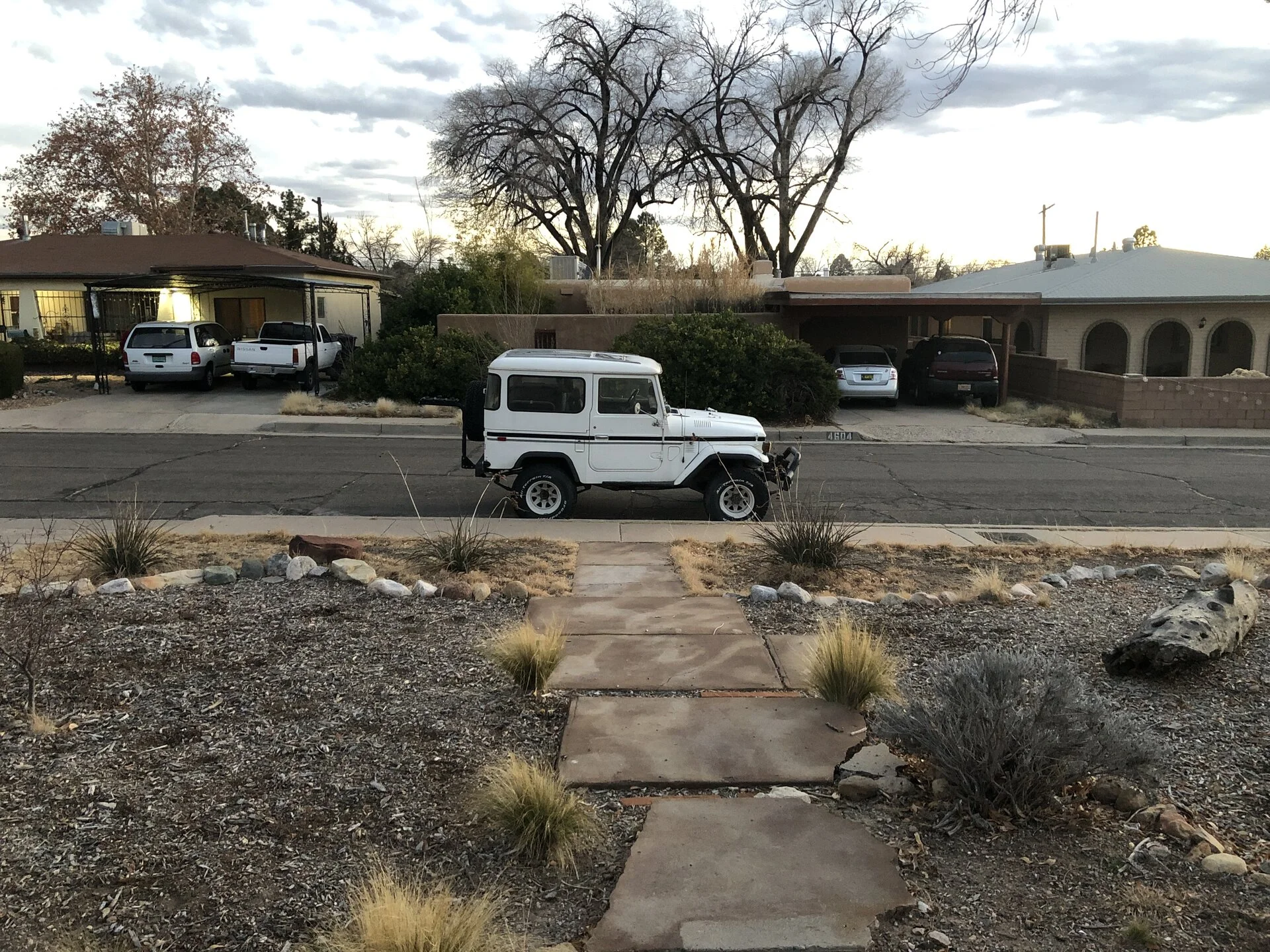

The first two pictures are where we first found it and the last one is when we finally got it home. Even though it is banal, we call her Elsie.

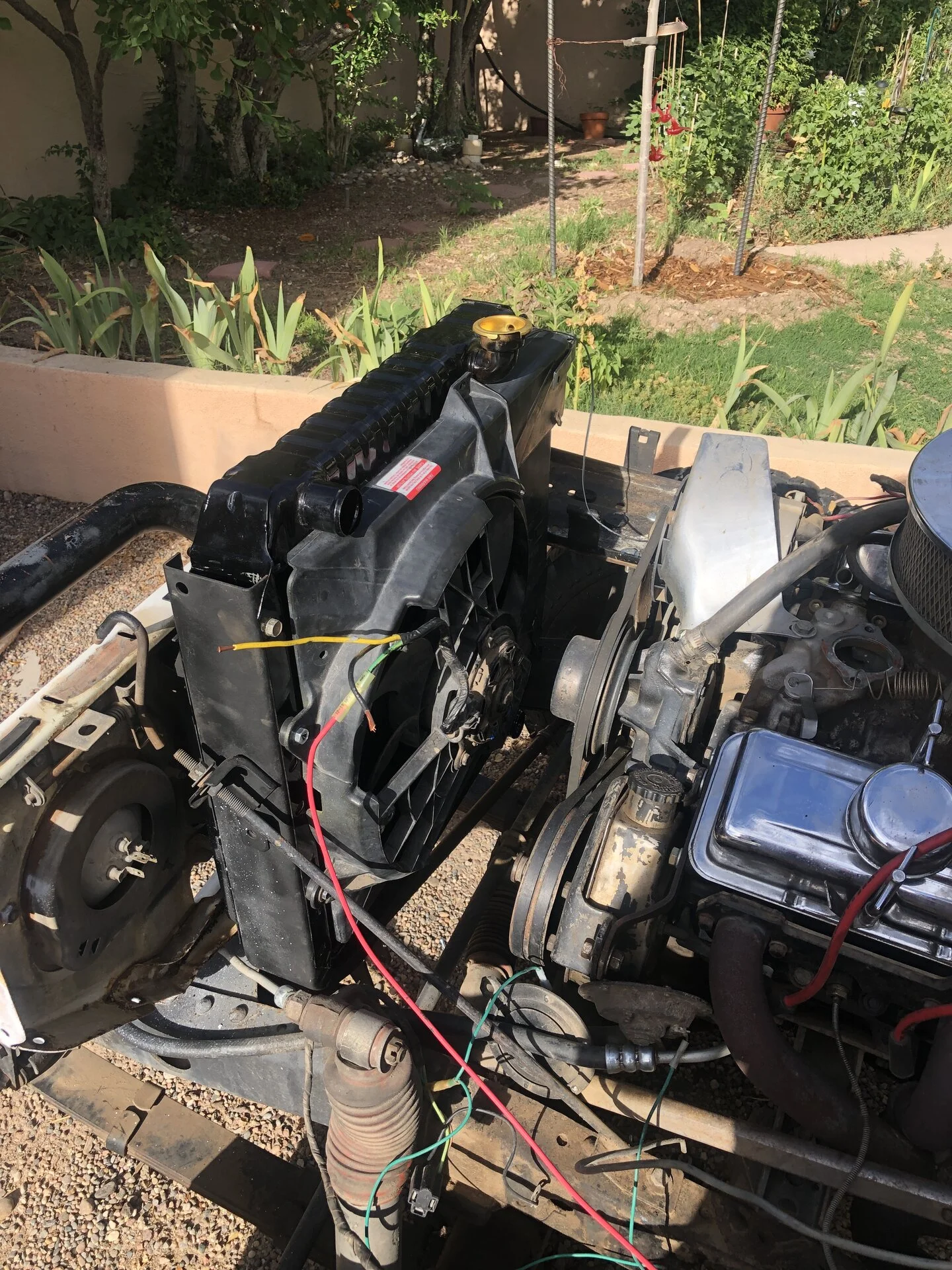

The first really big project didn't come up until summer time. I started to notice in driving that my temperature was getting worryingly high and quickly approaching overheating territory. In browsing the forum I found that the Taurus 2-Speed fan solution was probably my best bet to combat this.
I took a trip down to the local pick and pull to find a fan and also went ahead and ordered the delta current control wiring to make things a bit easier.
While I was in there, I decided to pull my radiator to get it recored as well. The rad shop I took it to said that I would probably be best served to just go ahead and replace it because it was so far gone.
Getting everything out and then put back together probably took me way longer than it should have, but I found the process incredibly rewarding as it was my first big success.
I really like my Taurus fan, so much that I grabbed annother when I went back to the pic-n-pull. Another (cheap) way to control it is the Volvo relay from the same years. They use the same fan, but the Volvo relay is sort of a soft start. I was blowing fuse until I discovered relay. I also run the fuse outside of my main fuse block as it melted the fuse holder over time. The stand-alone fuse socket has held up well.
