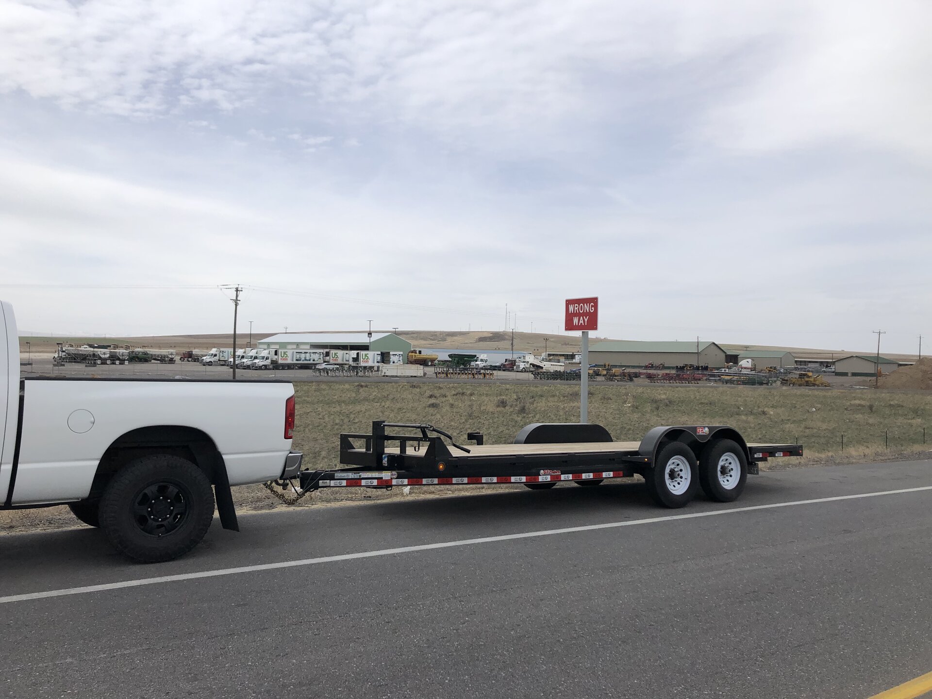

Ignoring the greatness off the Idaho outdoor beauty would be loss. My trailer crapped the rear axle last night. I bought a new trailer in someplace Idaho. 15k gross.
I agree. Not to much other than challenges to report. It’s all good.
