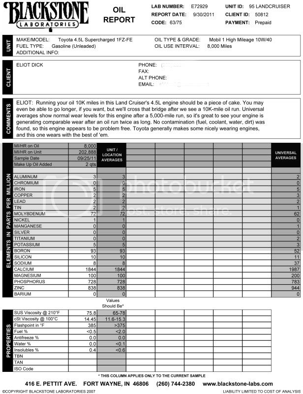

Apparently my cruiser loves mobil 1 10w40 high mileage. I'm ecstatic to hear my engine is in such good shape. I've stopped all my oil leaks now and hopefully wont have to add any oil in between my next oil change.

I'm game. I just ordered my Blackstone analysis kit to add to the other data points.
