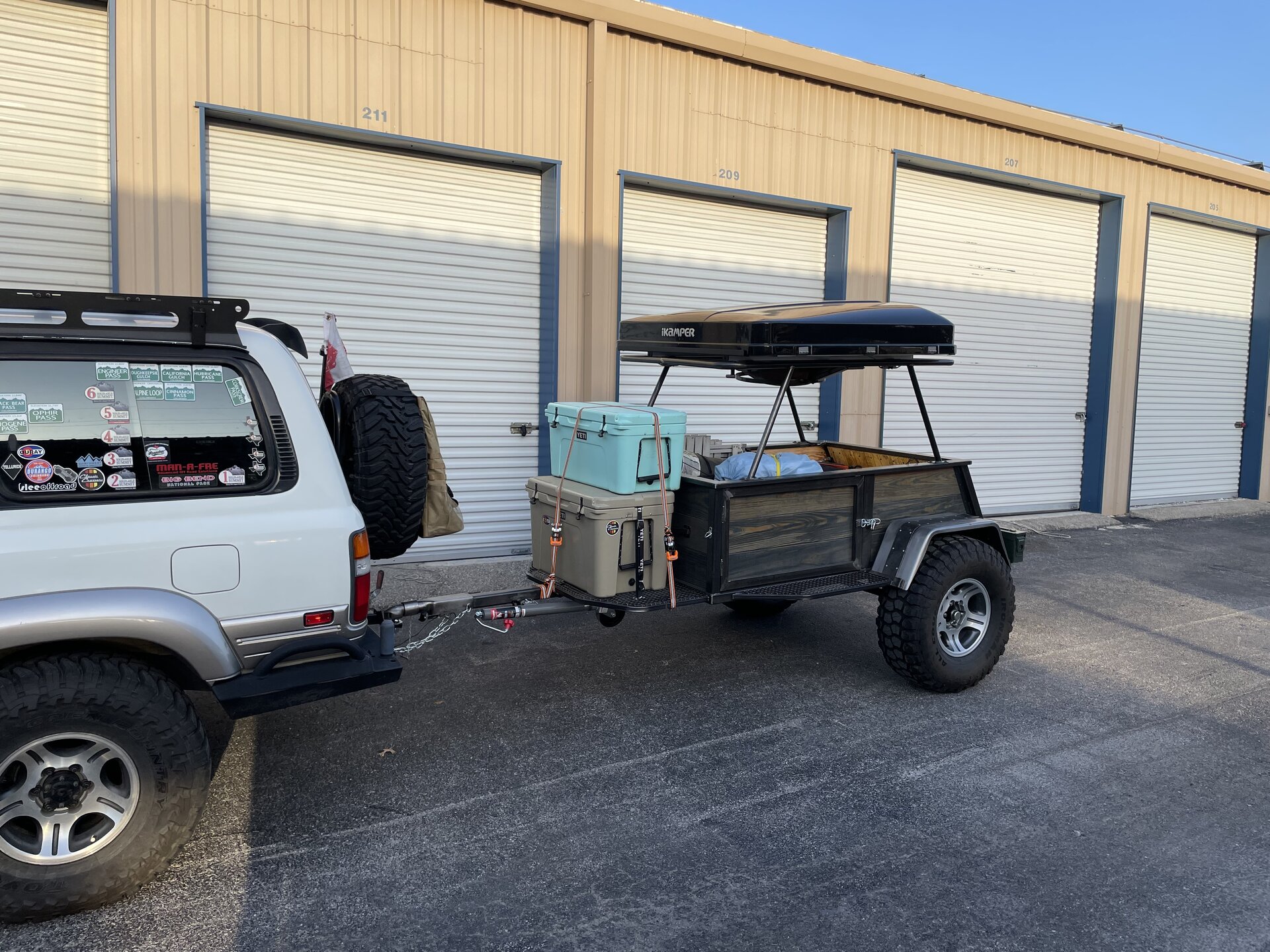

I have OME heavy springs all around from previous owner. When I added the drawer system and loaded it, the back squatted just a bit (by the look of it, although it didn’t measure lower). When I had trailer built this year, it sagged a bit more. Considered various options (including air bags), but ultimately just added 1” spacer and that made it pretty much perfect with or without the trailer. Drives great. Haven’t weighed trailer yet, but I suspect tongue weight 500+ lbs with the design of it and when fully loaded including a 2 Yeti configuration…

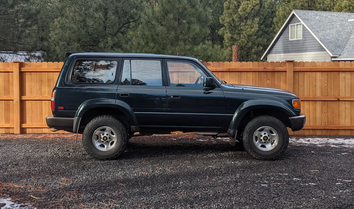

I have the Dobinsons 223V rear coils (220lbs load) and haven't noticed any issues when it's empty other than a slight rake (higher in the rear). The nice thing about coils is that they will be trouble free compared to airbags and it's not difficult to have 200lbs of gear in the back much of the time anyway (tools and such).

No load in the rear (not even a full tank of fuel) right after the springs were installed a few years ago. With my normal load in the back (100lbs) it sits a bit more flat.

Agree on the spacers. The ride quality is excellent with and without a load. I attribute that to the heavier springs which will allow for more preload. It wasn’t my choice up front as that’s how the set up came to me…but I wouldn’t change a thing (considering my uses of the truck).
