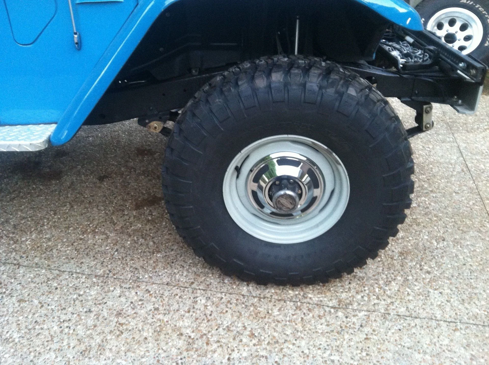

Rattle can color that is close to OEM gray wheel color

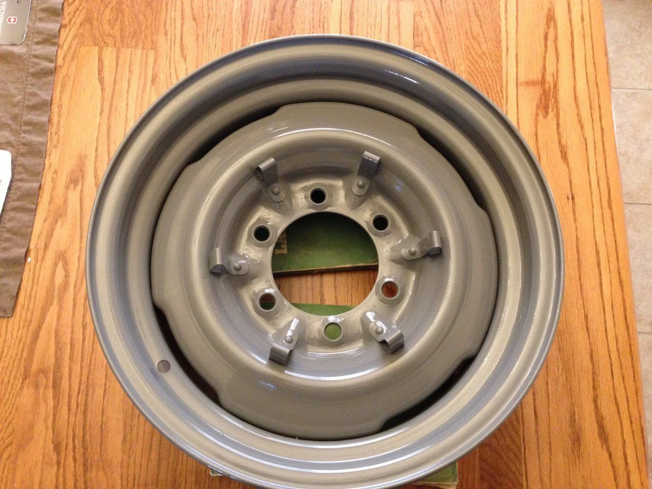

What paint is it you used in this photo?
Cheers!

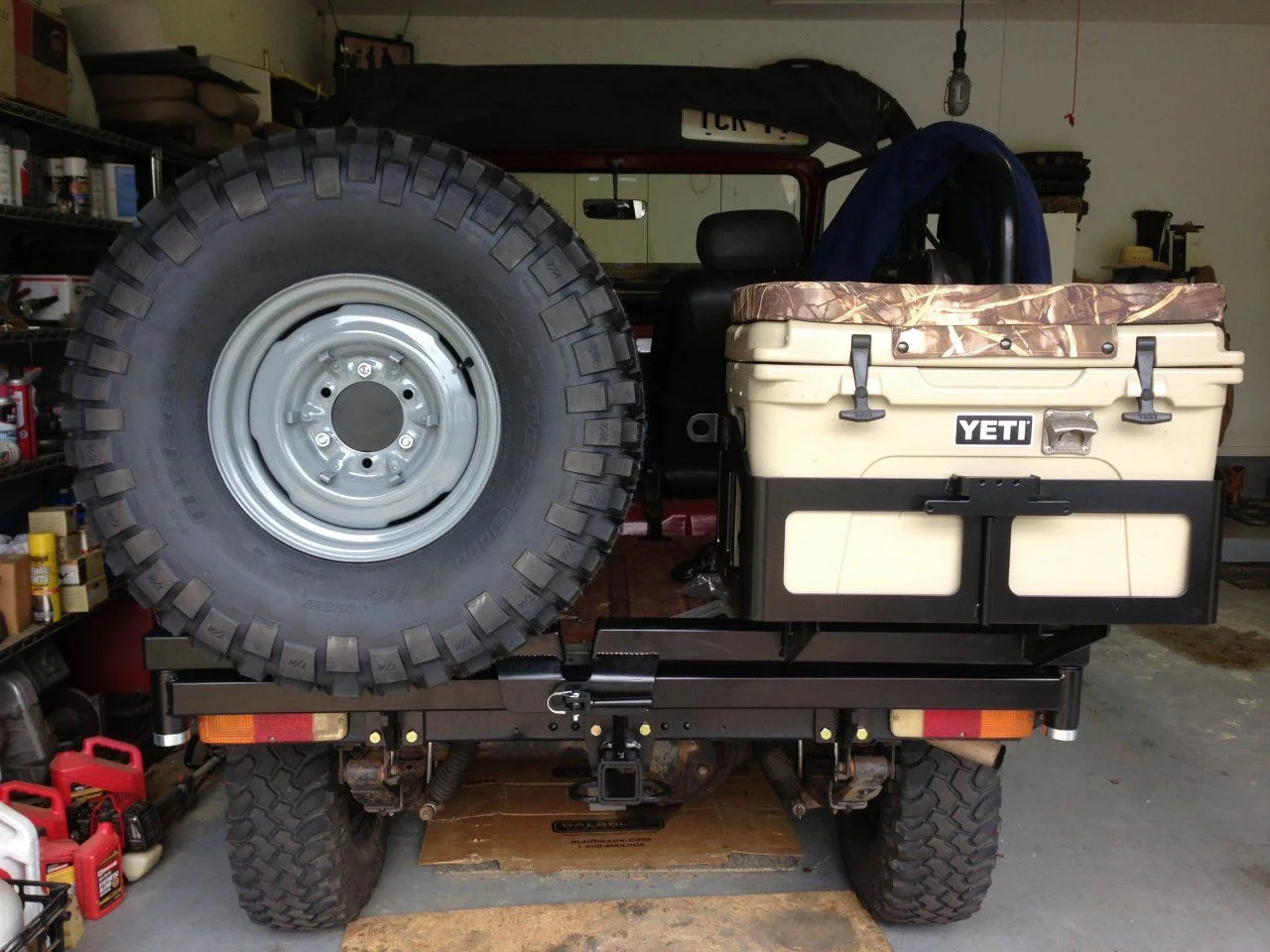

ANSI 49, it is used all over the place. Most notably, it is a standard electrical switchgear color. You can find it in many forms: aerosol, pint, powder. The photo I posted is powder.
I compared it to my OEM original 1971 40 series wheels, very close match. Last weekend, I compared it to another 40, I believe it was a 76, also a close match. By close, I mean dead on. Much closer than the can from CruiserCorps I bought wasted $22 on, which was much too dark and much too blue. But wheel colors seem to have fluctuated over the years, so maybe there is more than one right answer.

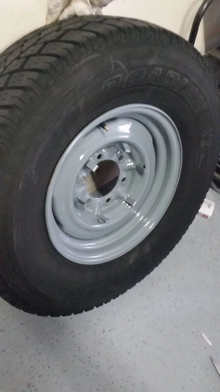

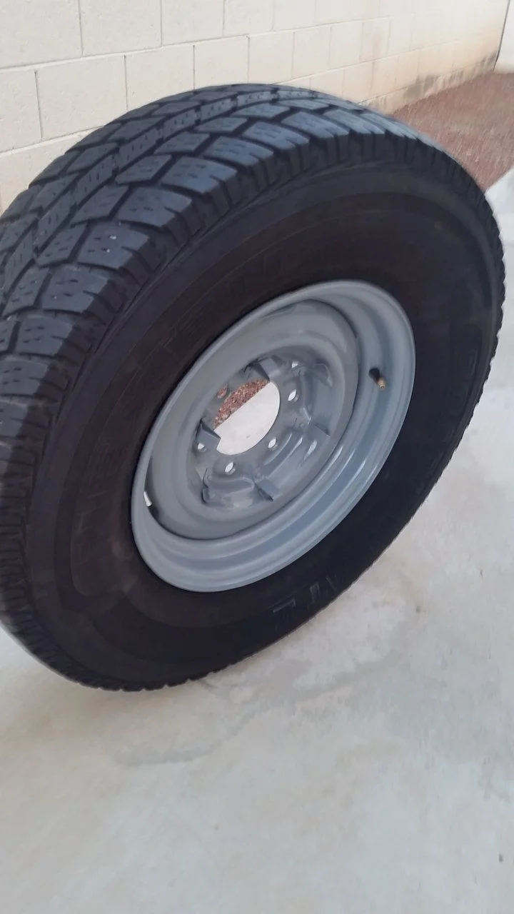

That Rusto Light Machine Gray is too light. The Krylon color below it is pretty damn close.
I agree ...not a bad match at all for $3.83 a can at walmart.
Looks dandy to me as well...course on a computer monitor, it is never an exact scienceo_O

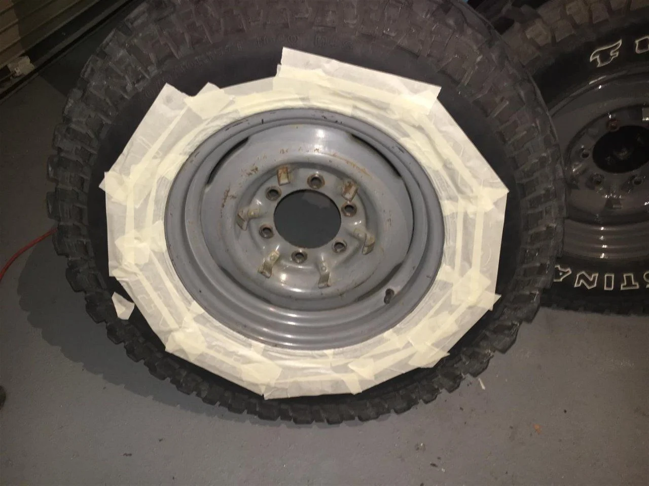

My truck is a 12/78 build. Same owner since 83 until I bought it last month. Very original, low miles, and unmolested. All 5 rims have 12/78 date codes. I'm 99% sure they are wearing original paint. I removed the hubcaps, cleaned, steel-wooled, and then cleaned/degreased again. After doing this the color matched under the hubcap so I think any color change due to sun fading can be ruled out.
Pictures show one painted (on the truck) and one prepped for paint (w/ the masking tape).

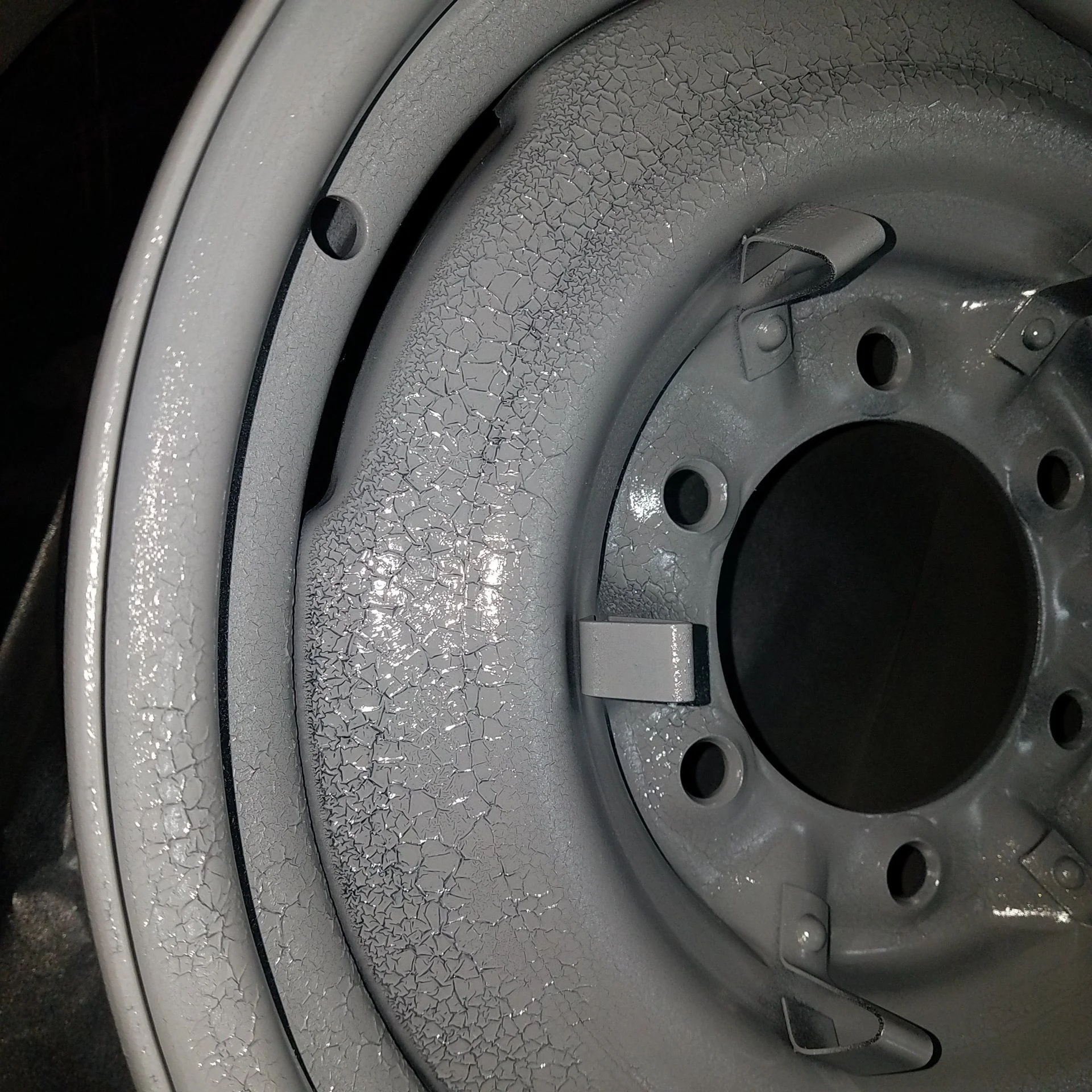

I blasted my rims, used an acid etching primer (1) coat, then painted the entire wheel gloss black (2) coats with Rust-Oleum High Performance Enamel. I then painted just the face of the wheel with the same paint type only Dark Machine Gray (2) coats. I basically painted the rims one at a time with the first two done one weekend then the next two done throughout the week in the evenings. The first two rims came out great. - see first pic. But on the second two the gray paint wrinkled and checked badly. I thought maybe I re-coated too quickly so I re-blasted the two wheels, went through the same process but waited overnight for each consecutive coat. I only did one wheel at a time. Same result - the first coat of gray wrinkled faster than before. I called Rust-oleum and this was their instruction: Either re-coat within (1) hour or wait 48 hours before re-coating.
The ambient temp was about 65 for the first two rims and about 60 this last rim.
Thinking back to the first two wheels that came out nice....I probably did rush the re-coats so maybe that is the remedy. So back to the blast cabinet. :(
Anyone had this happen to them?
