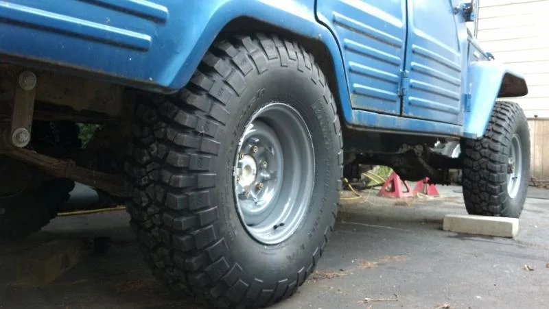

The MF gray shown on the wheels below is available from Tractor Supply. If they are not in your area I suppose you could order it from them online.
http://www.tractorsupply.com/
looks like this...
blue grey rims
I happen to like my rims just a little darker and have a blue/grey look. I just happened to luck onto a color that works just right. Ace Premium High Seas Blue....yep, that's it. looks a little too blue in the picture. They are perfect once the caps are on.

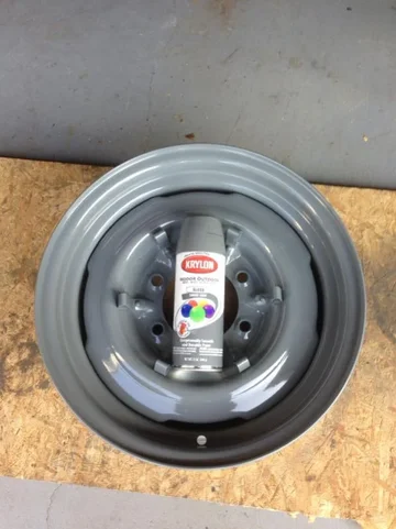

Krylon Smoke Gray. Available almost anywhere. It seems to be more blue/gray than silver/gray.
Sent from my iPhone using IH8MUD
Well, i ordered some MF Gray that won't be here until next Wednesday and going to pick up the Krylon Smoke Gray and some Battleship today……I think i will shoot all three and choose from there.
Thanks for all the input…..I really like that smoke gray in your pictures copenhagen1.
