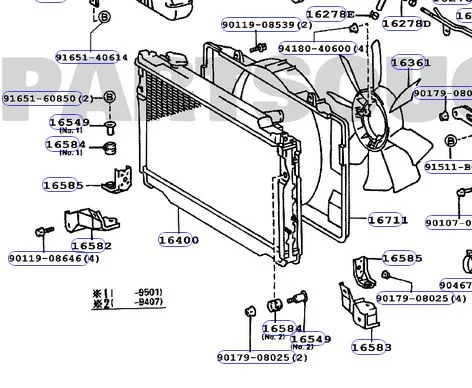

If your 80 has corrosion on exposed nuts and bolts in the engine bay consider ordering all the associated fasterners in advance. There are nuts that hold the radiator to the main L shaped support brackets, then there are two cushions at the top sides of the radiator "frame" that have a metal stud that can get rusted to the nut. IME that stud can snap off when you go to remove it. And then there's the long bolt that goes down through the bottom "donut" cushions (2) and the lower cushions themselves can turn rock hard after 25 years, so aren't doing much cushioning at that point IMO.
And if you wanted to take it a step further, those L brackets that support the radiator themselves can get rusty, partly IMO because water and dirt can collect on them. What I did was to clean them up, drill a large hole in the 90' bend so water could drain out, then primed and painted them. And then the next step is to remove the bracket that the L bracket is attached to, ditto, clean it up, prime and paint. It is a lot more time however to fiddle with those parts.
the radiator themselves can get rusty, partly IMO because water and dirt can collect on them. What I did was to clean them up, drill a large hole in the horizontal section so water could drain out, then primed and painted them. And then the next step is to remove the bracket that the L bracket is attached to, ditto, clean it up, prime and paint. It is a lot more time however to fiddle with those parts.
