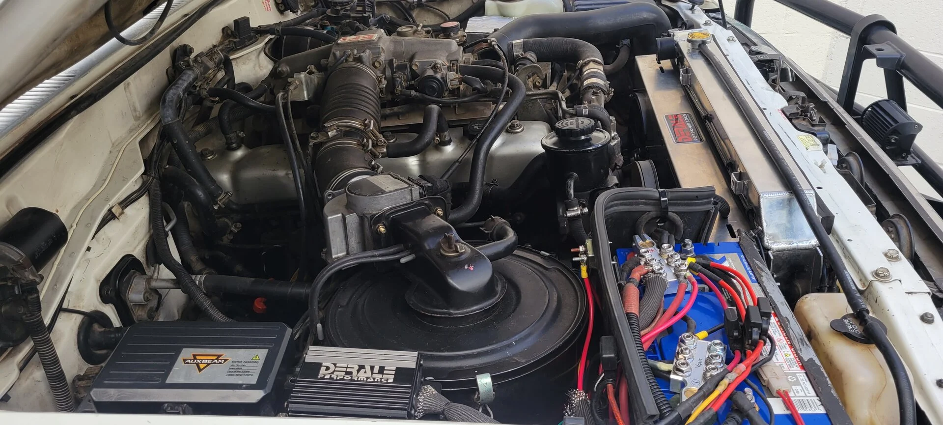

I appreciate the feedback. I have used Ron Davis and Griffin radiators in the past and had great success with them. Is that a Derale electric fan setup that you are using and how has it performed ? Currently debating using an electric fan over the stock setup.
Yes, that was my dual electric fan setup with PWM controller. Just did a 1000 miles round trip over the break and it performs very well. The ability to adjust fan speed is a plus and my avg. temp on the highway is below 180F... (need to dial up the temp. a bit) The reasons i went with an elec. fan setup was because i kept blowing radiators with the manual fan clutch due to aftermarket alum. radiator being thicker than factory unit. This would normally not affect normal users or "Overlanders" but a handful of Rubicon trips and Fordyce creek trail, ended up with 2 broken radiators, fans and fan shrouds. (Yes, my engine mounts and tranny mounts were in great shape when that happened) The elec. fan setup is my attempt for a "fix" and so far they have been great and i am impressed by its performance so far.

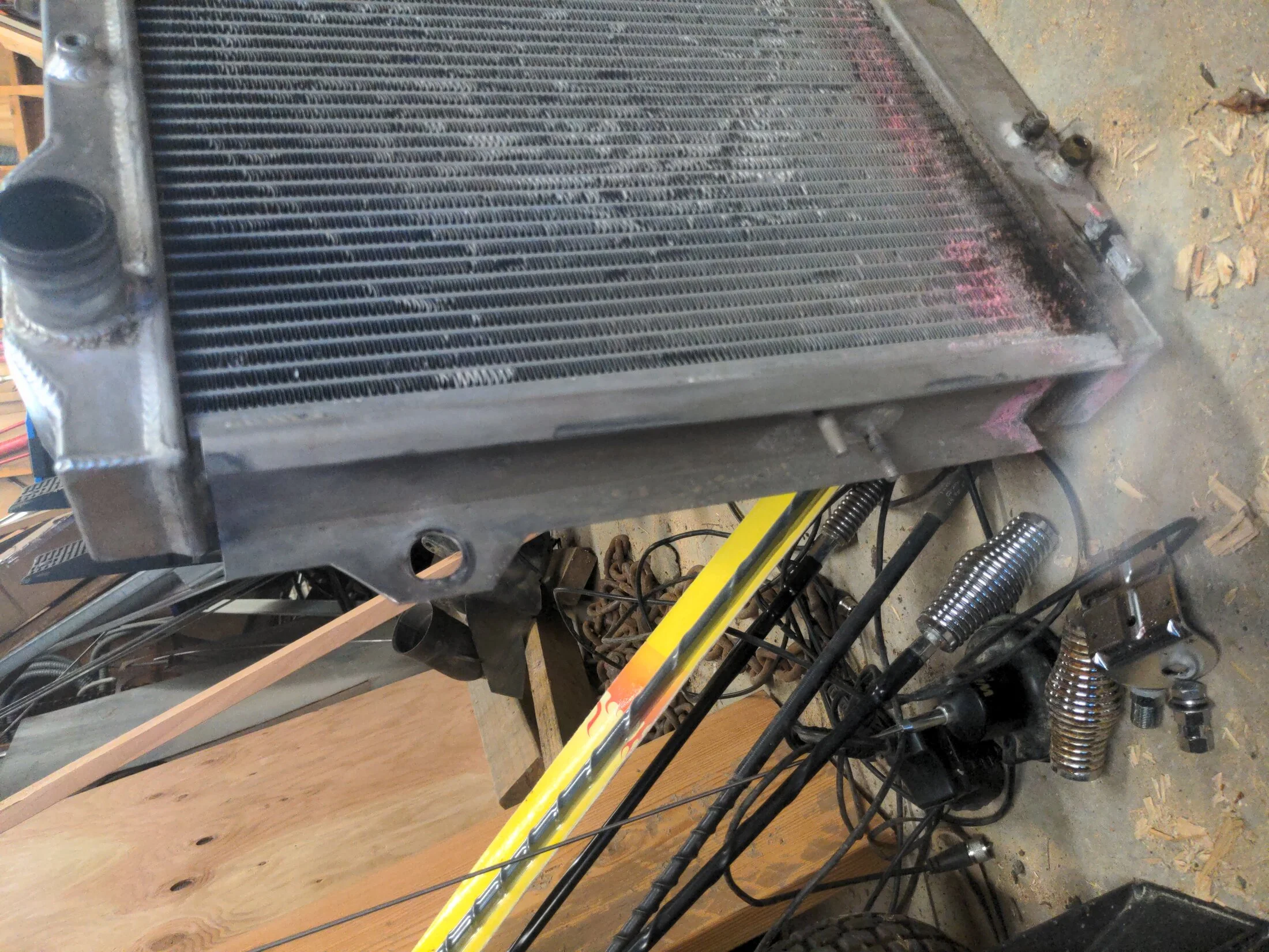

have crack in top part of aftermarket radiator
i think prior owner had it glued together :confused:

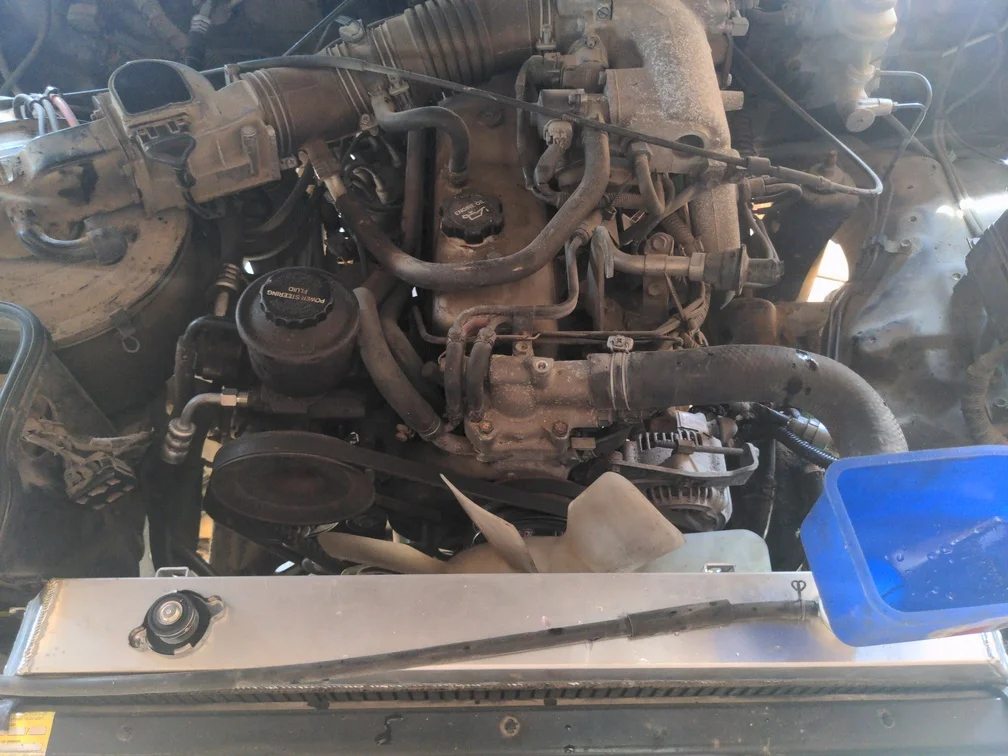

I finally got started with the radiator job with a possible time constraint of getting it done before this weekend.
What a bear getting it out! I guess removing the battery and box would've made it easier.

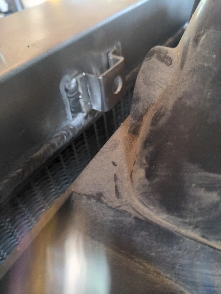

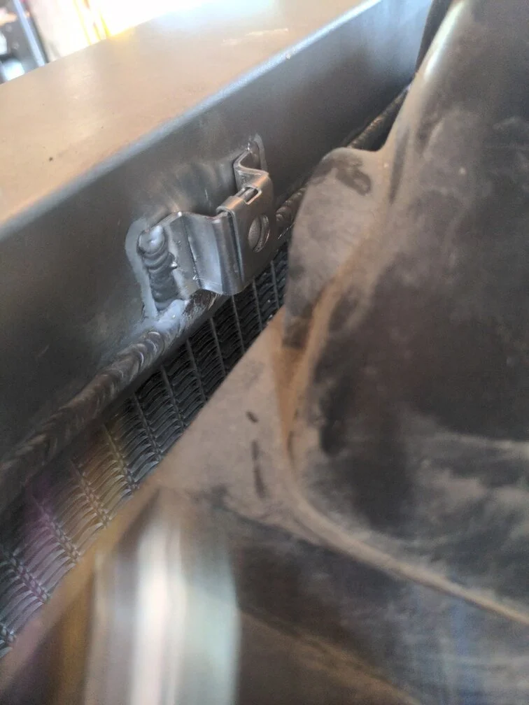

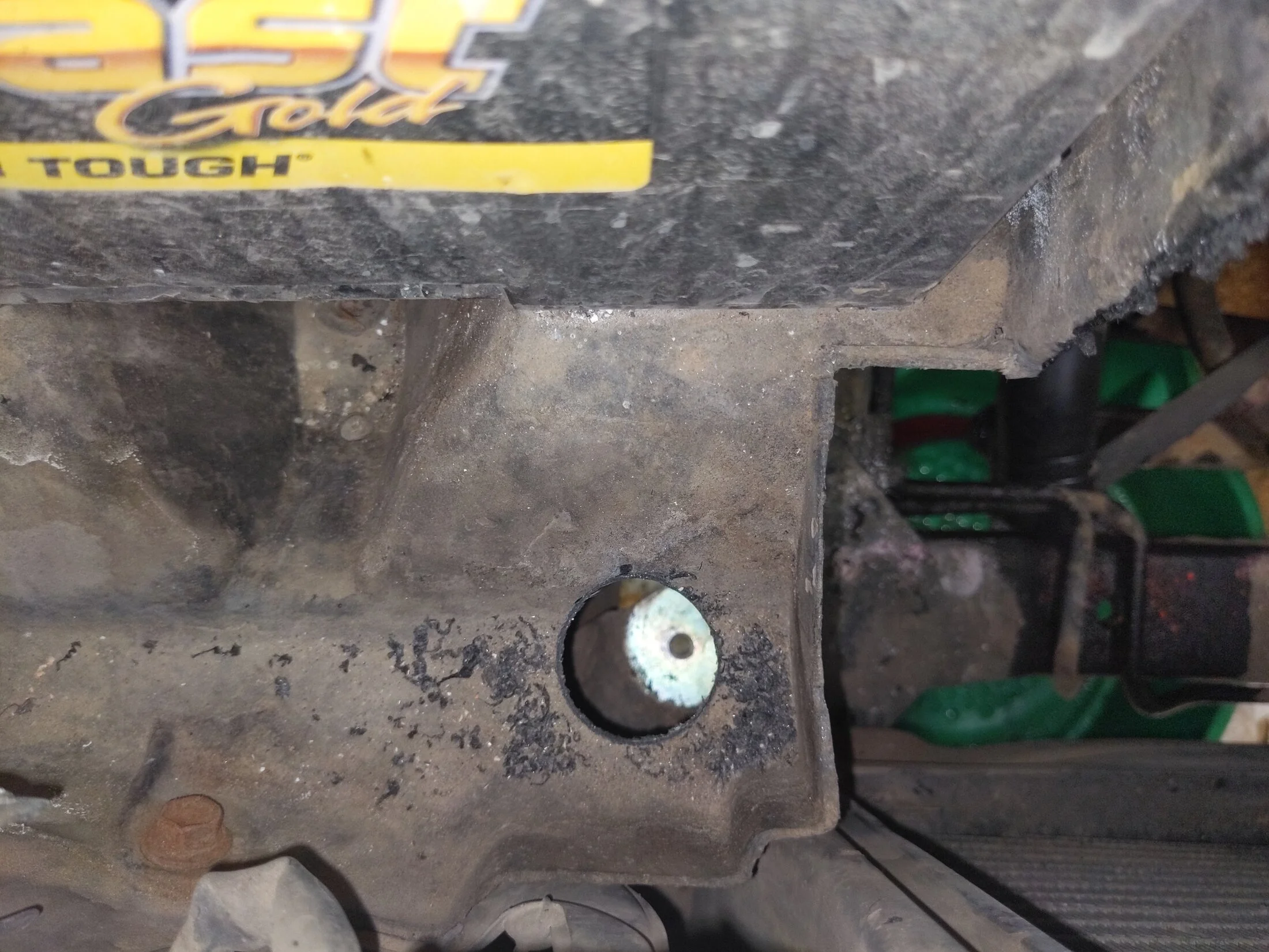

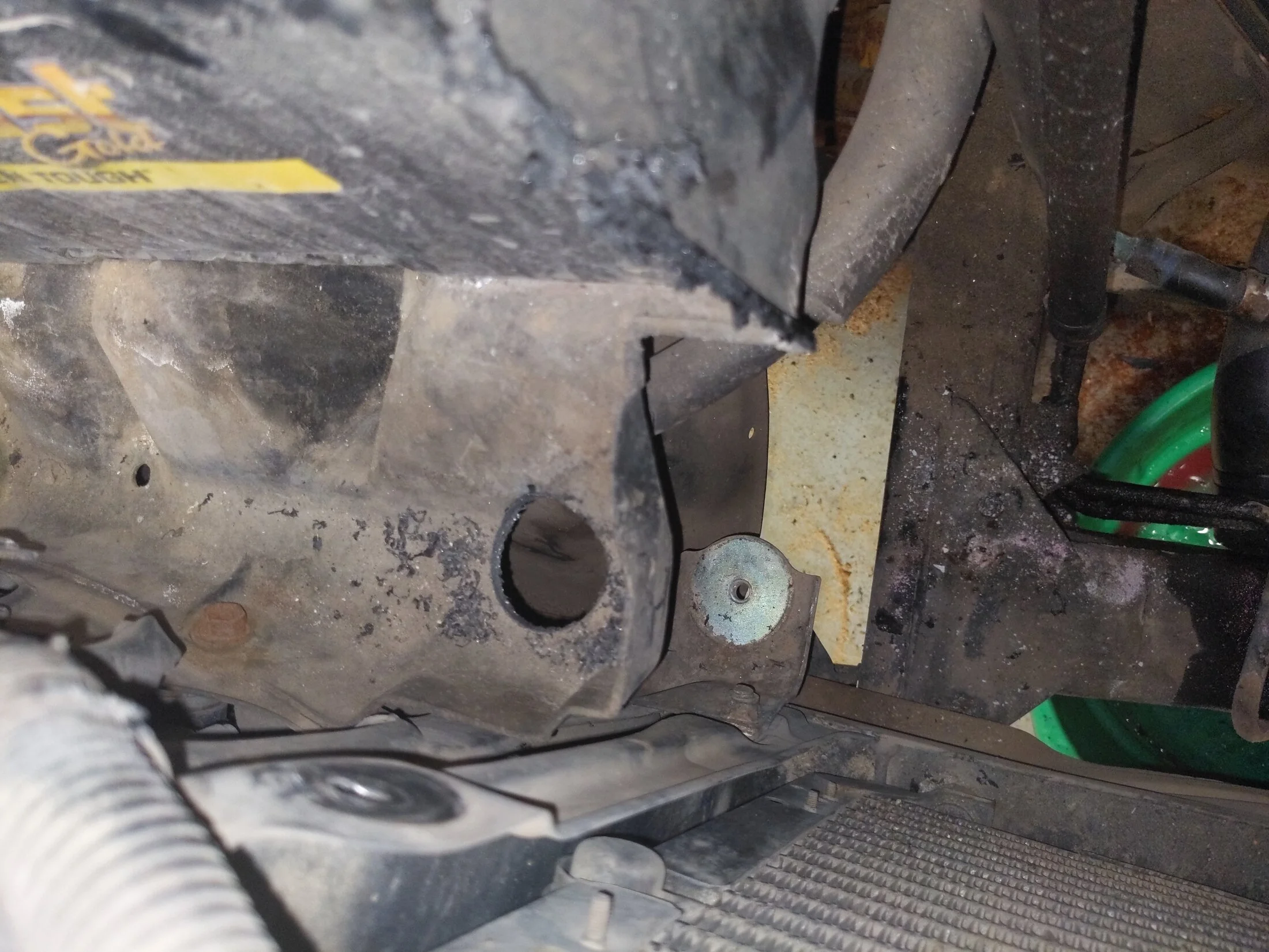

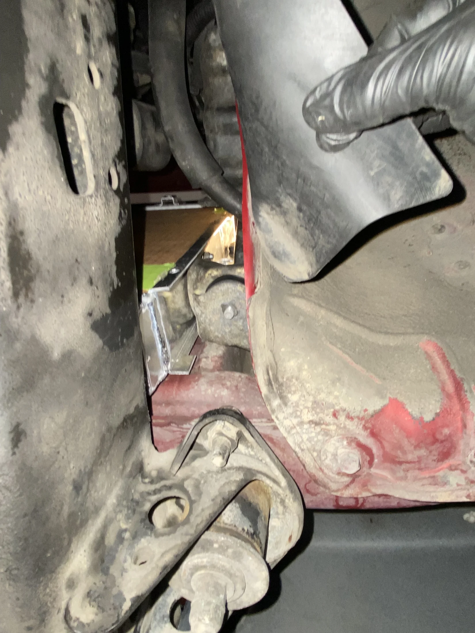

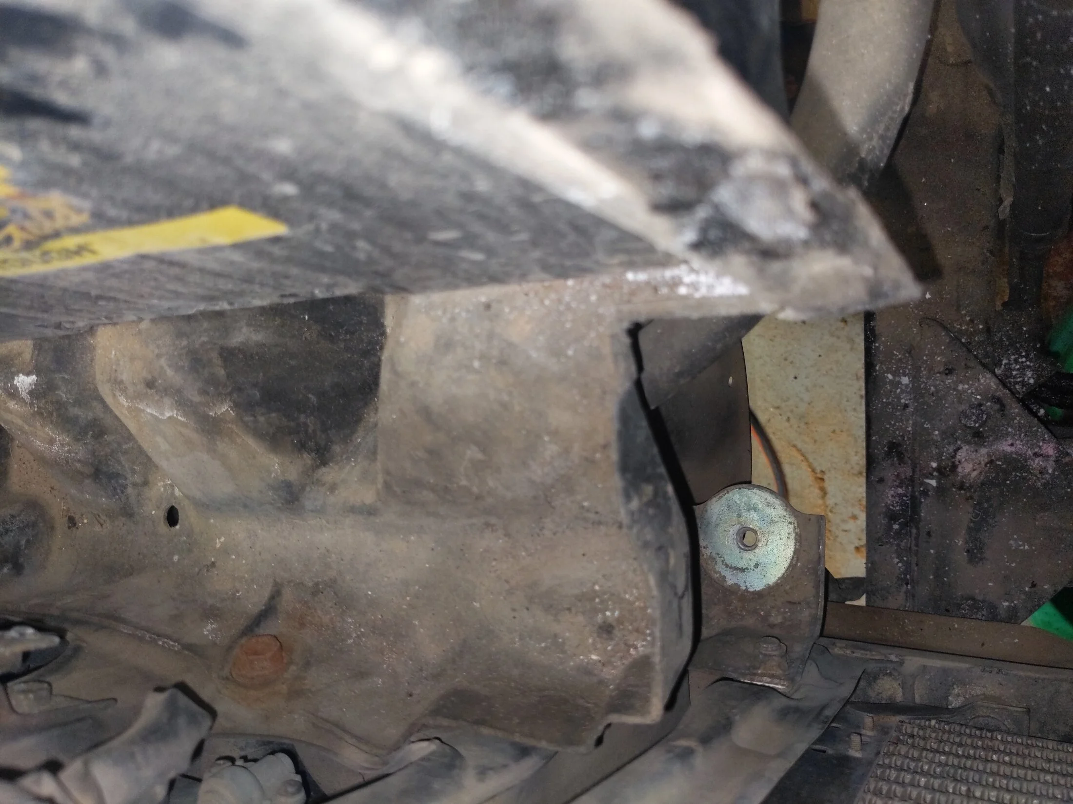

I did come up with a modification to simplify installation and removal of the passenger side bottom mount.
Before:
After:

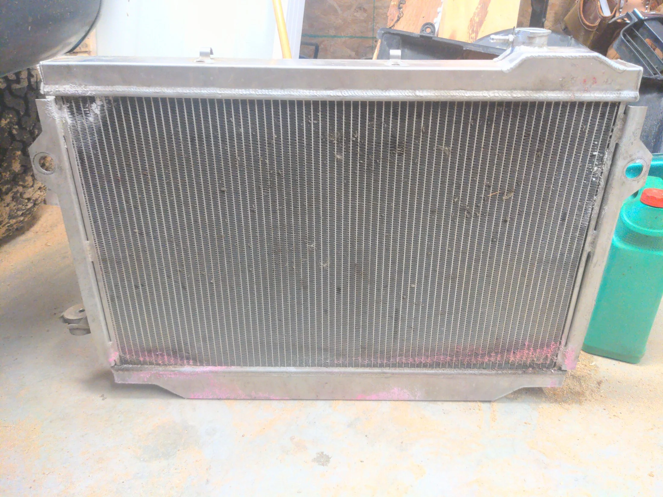

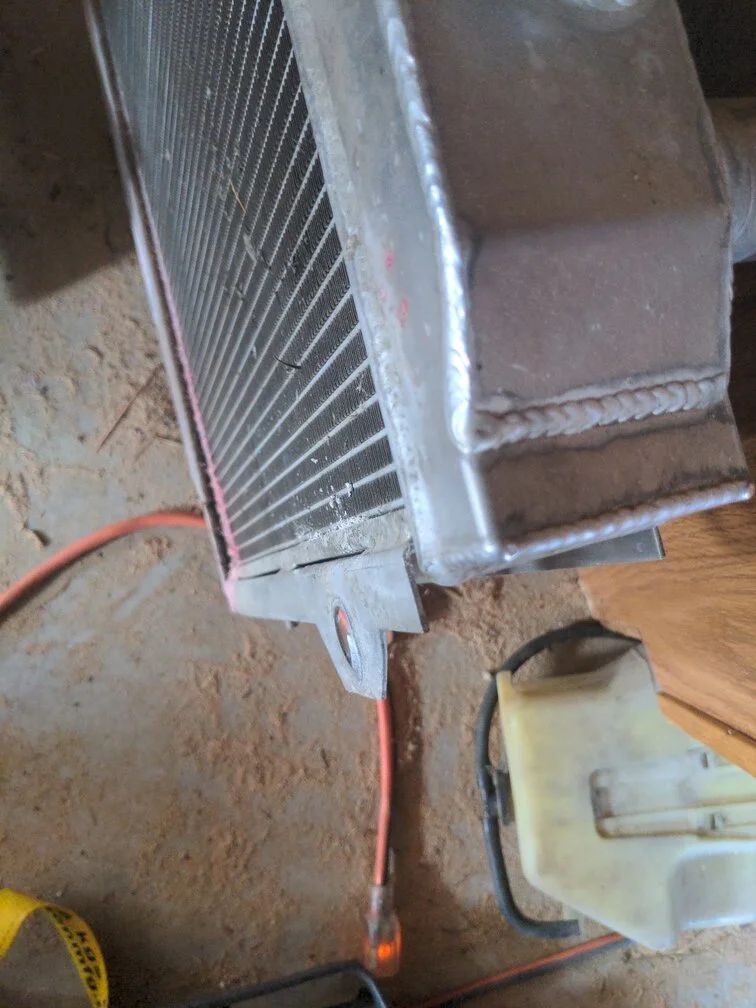

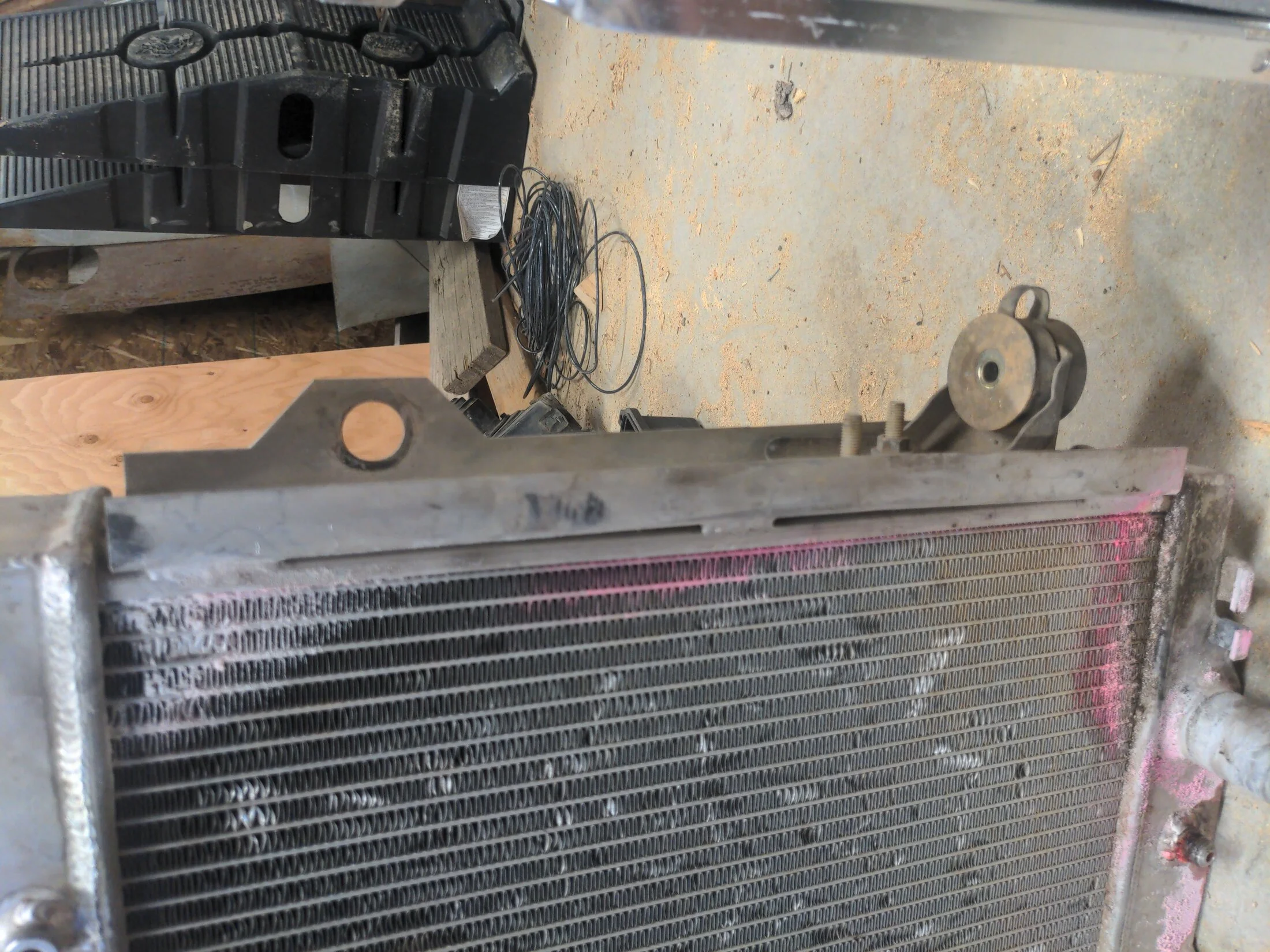

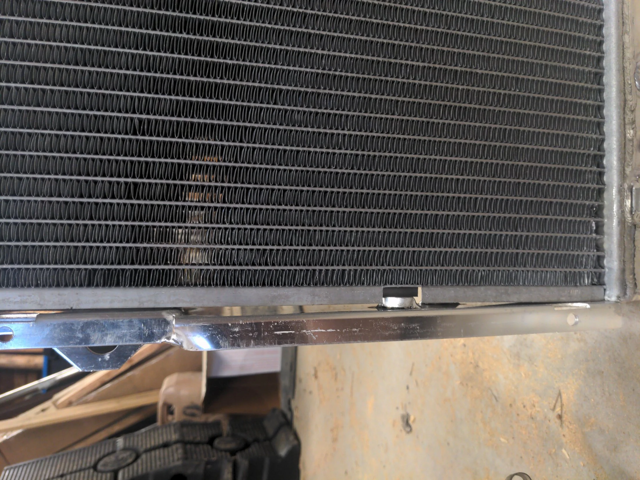

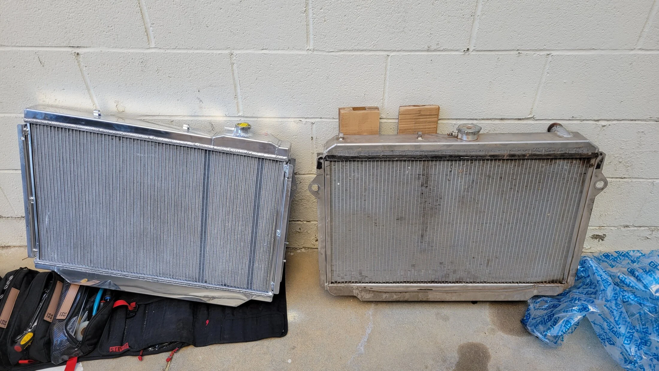

Old radiator. Not sure which brand it is. Cracked because the coolant was too watered down, during the winter... Totally my fault.
(Post part 1/2) -- Hit the file limit.

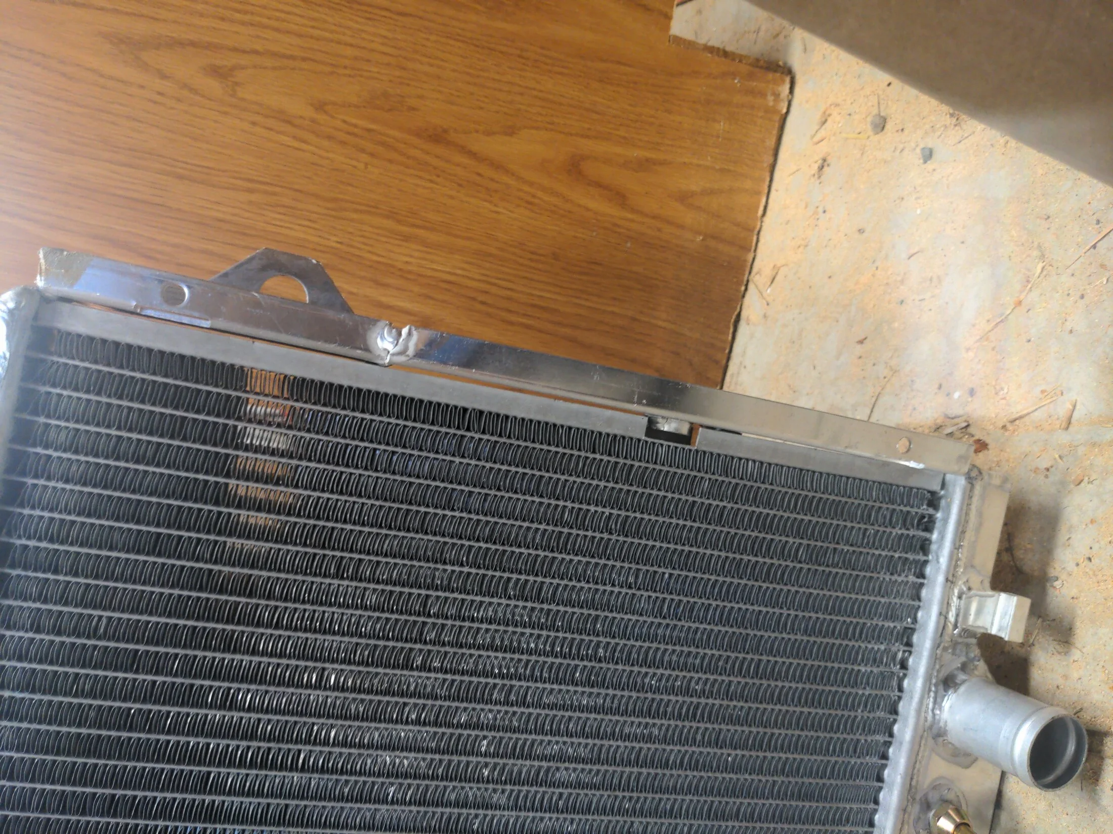

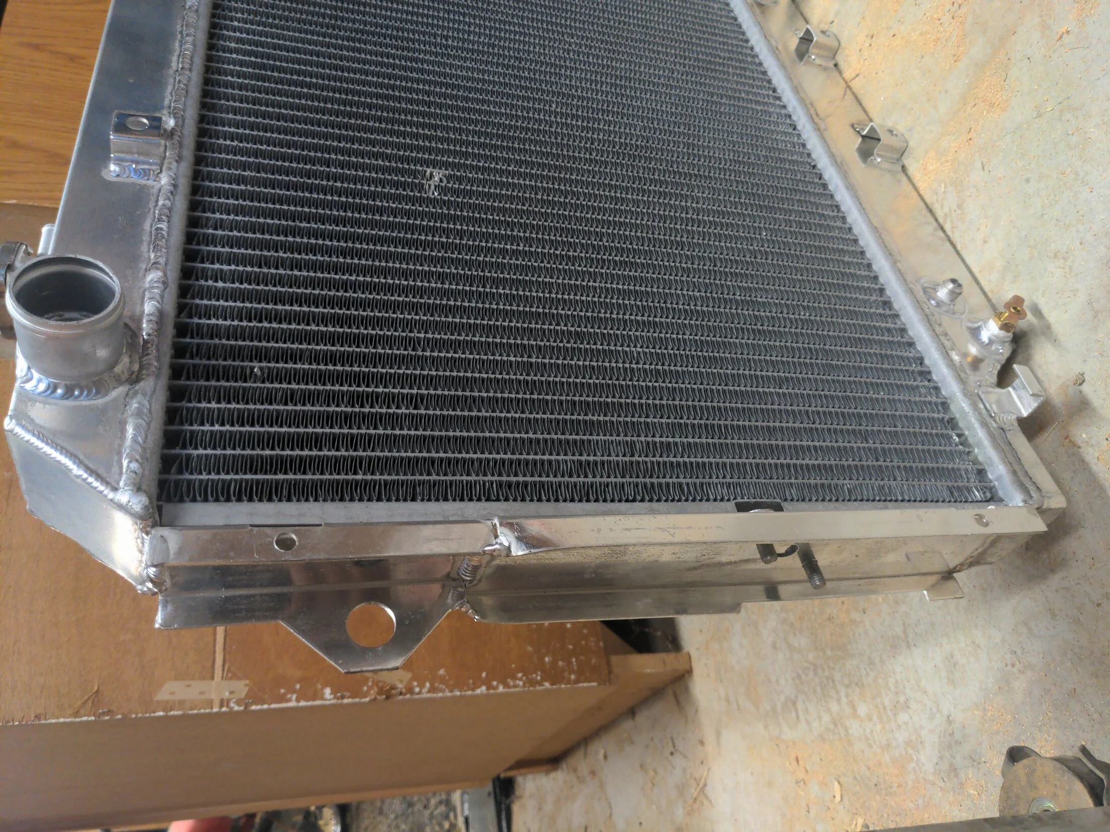

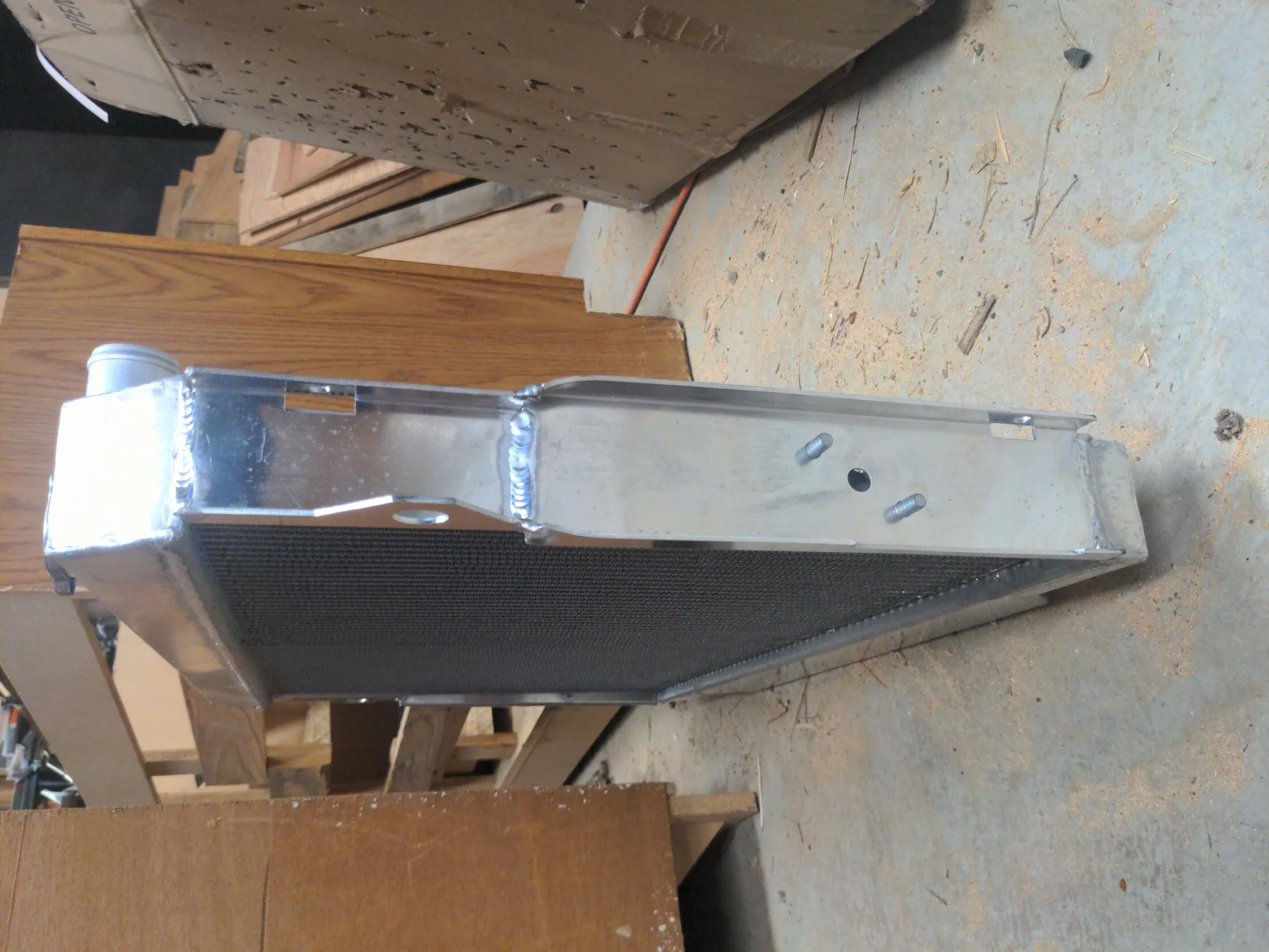

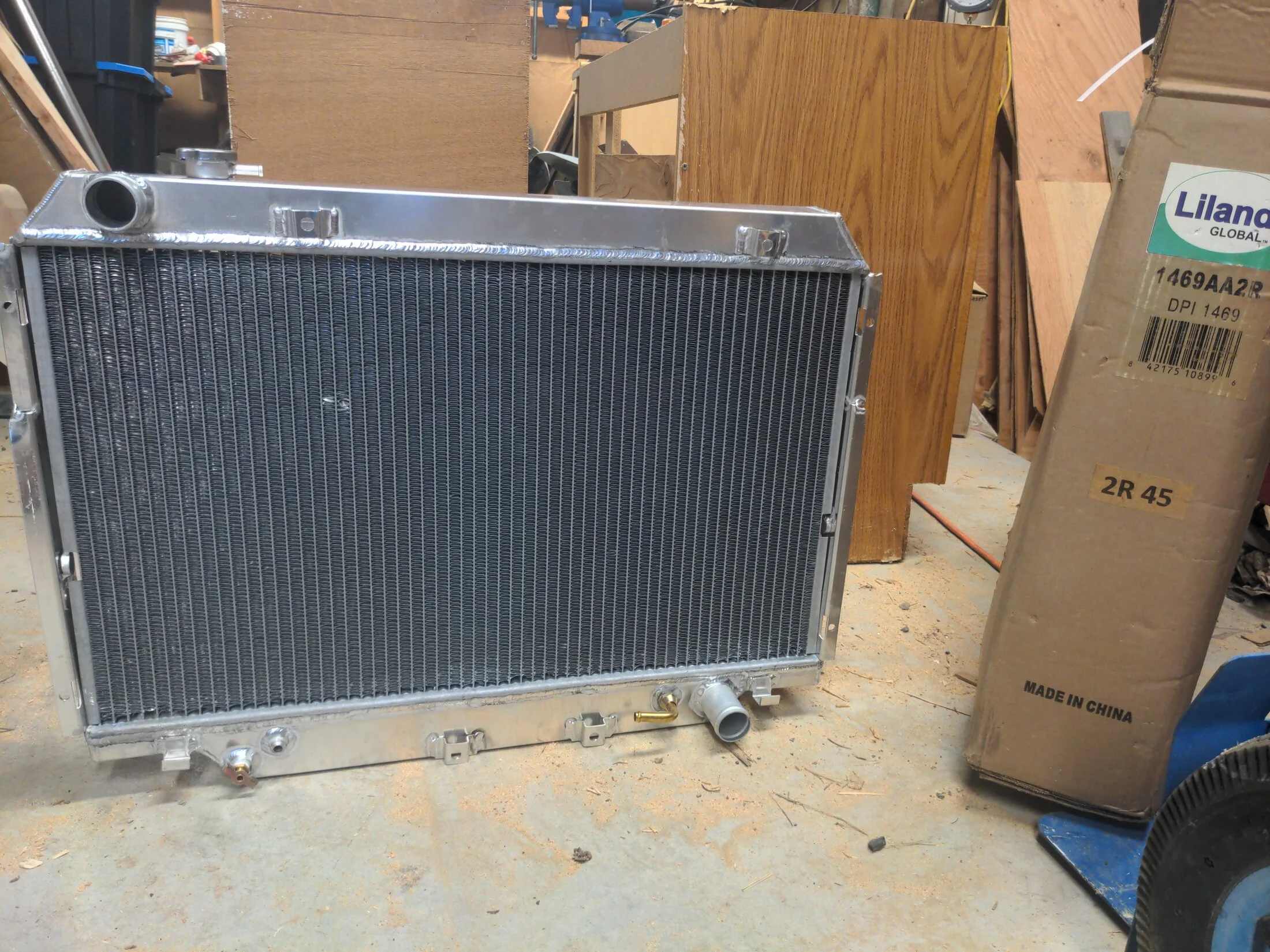

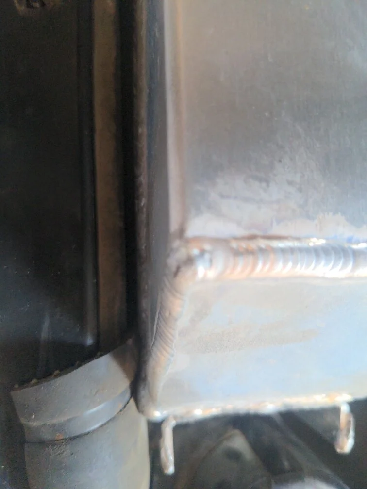

Here's the new (2 core?) Liland.
I am not impressed with the quality and am concerned it might be a leaker from the start, or soon. Maybe my fears are unfounded?
The old one is much nicer. Threads already on the radiator, nicer welds, more stout.
Is this Liland worse than others, or about average? I guess if it looks average, I'll feel more confident to install it.

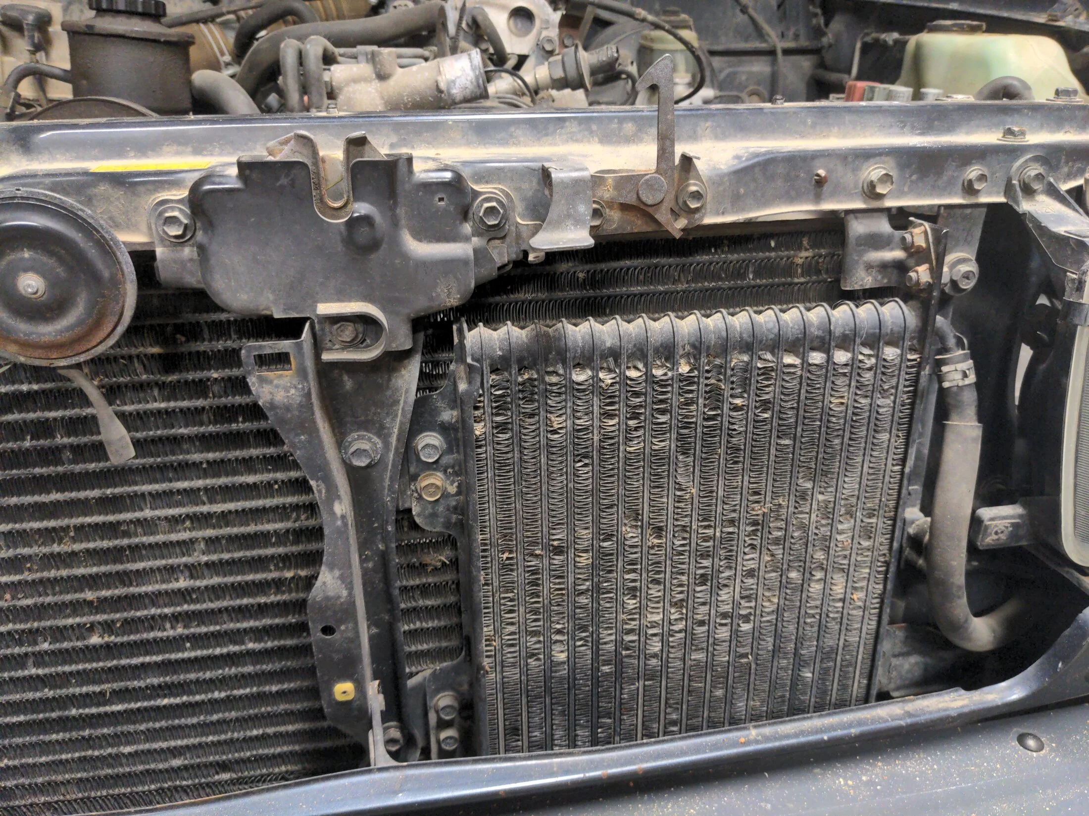

I'm somewhat curious if I could grab one and install it, however my A440 would be left without the cooling it's had... Maybe it'd be fine? Isn't this already a transmission cooler here on the right? Or am I mistaken?
There's not a lot of info on the FJ80 with the 16400-17020 radiator. There is a thread about auxilary coolers here, but it's about the 1HD-T and A442 which I'm pretty sure will make more heat than the 3FE + A440: HDJ81 - High transmission temps, radiator without built in cooler - https://forum.ih8mud.com/threads/hdj81-high-transmission-temps-radiator-without-built-in-cooler.1338229/
Could I connect the auto transmission lines until I get a cooler? Or is it a terrible idea? Eventually, it would be nice to swap this to a manual, but not much progress on that front yet.
Another crazy idea would be to reinstall the old radiator and put some stop leak in it. I assume that's a terrible idea, or does the leak look minor enough that it'd probably work?

I'd advise against running without the radiator cooler unless you know how it will operate in ALL potential conditions. You may end up needing a larger cooler if you want to stay bypassed. It's common to do this in the 3rd gen 4Runner world, but if you use too small of a cooler you may find out that what you thought was completely adequate for your daily drive in the boonies will be on the verge of overheating on a steep grade or in stop-and-go traffic. The Toyota engineers will always prevail.

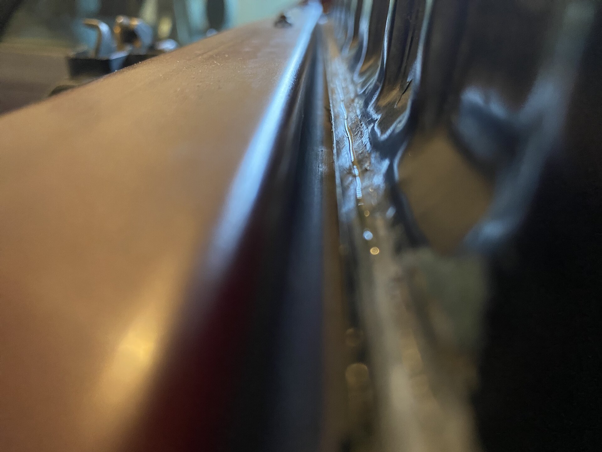

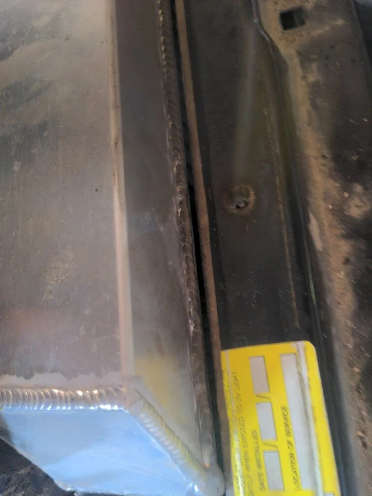

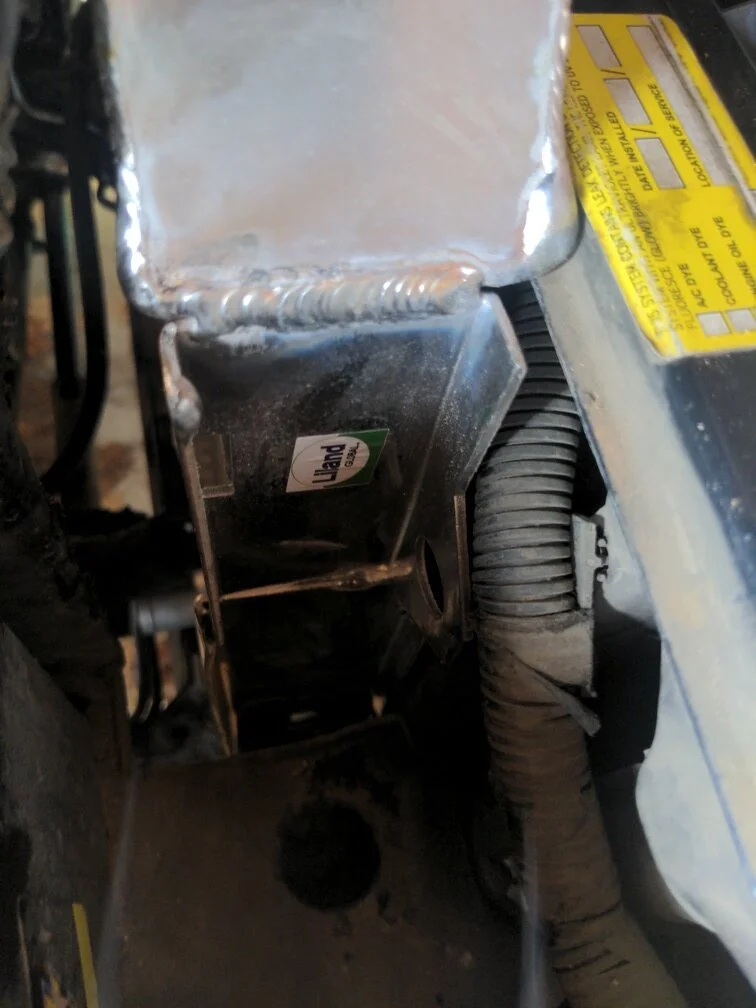

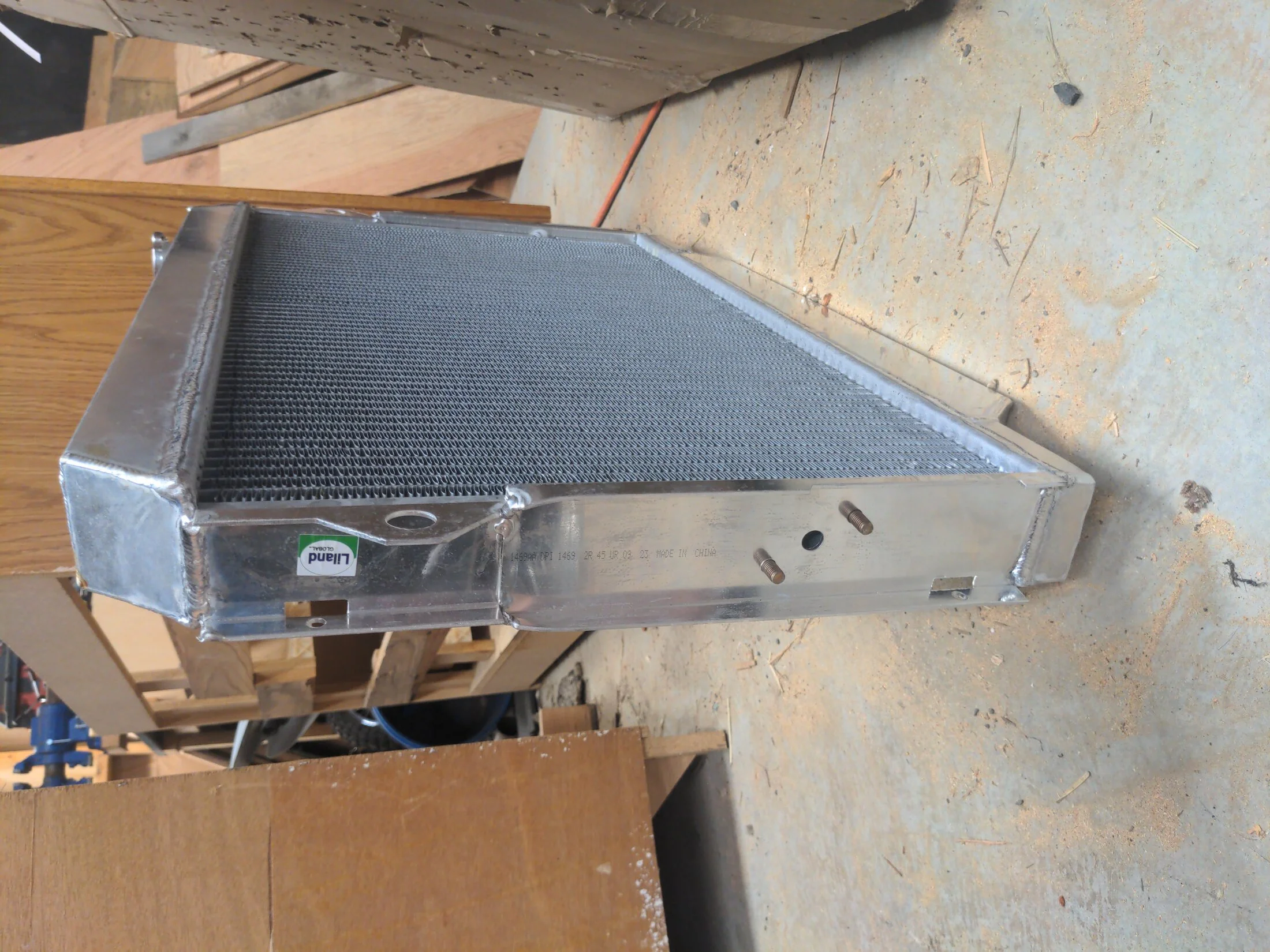

I am not impressed with my Liland 1469AA2R... it was a bit of a pain to deal with.

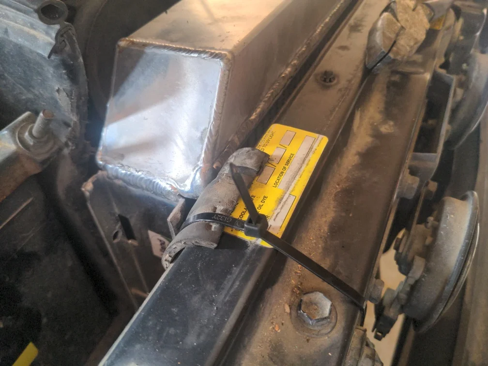

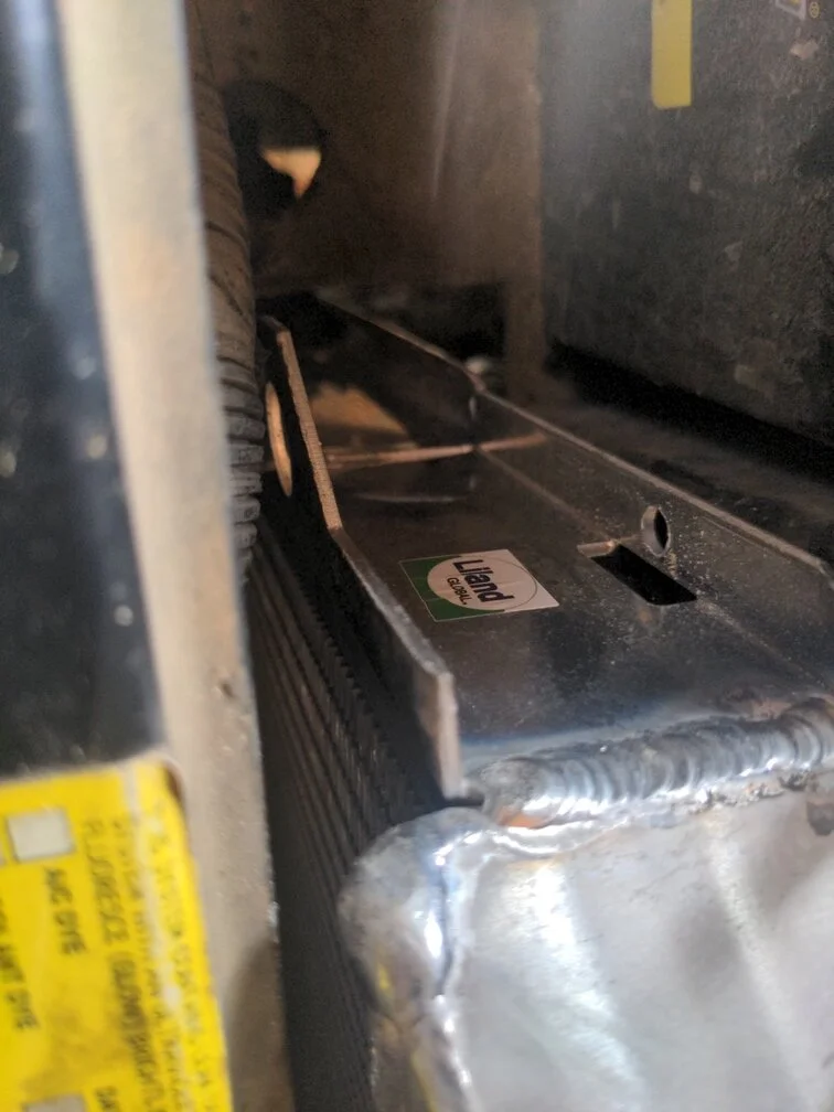

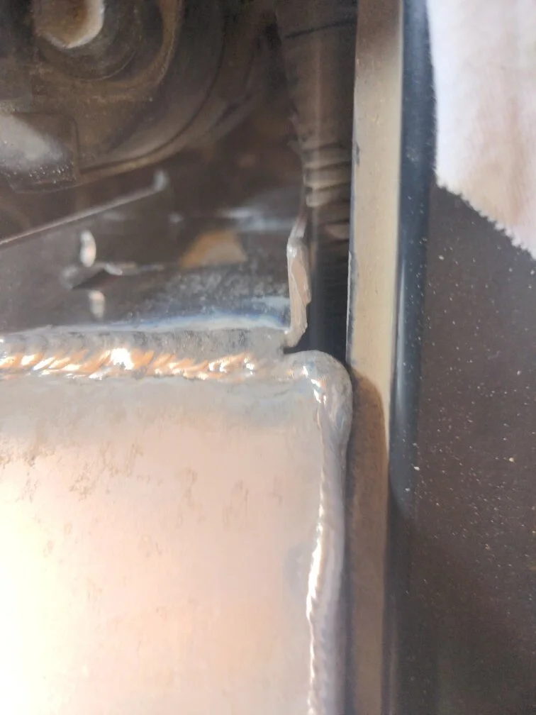

The radiator is sized such that you can't use the stock upper radiator mounts. The top part of the radiator sticks out like a lip, and catches the body. So the rubber mounting would be useless, and even then it might barely line up. I'd also be concerned about the radiator possibly getting knicked by the fan. I had to use zipties and some old rubber hose.

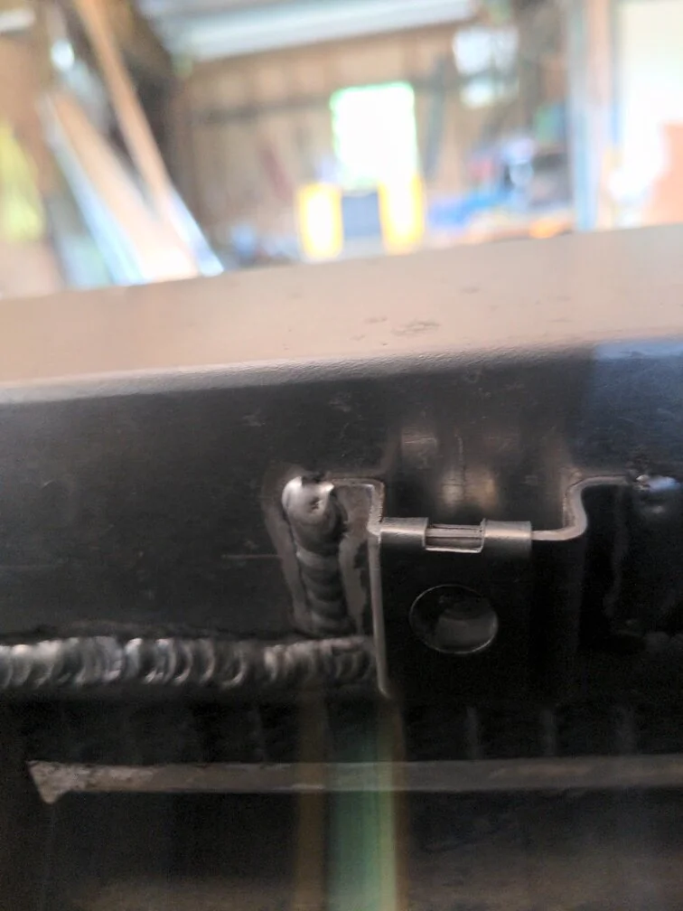

Also, they got the holes misaligned to where I couldn't mount the fan shroud without hogging out the hole. This is a particularly dumb one, because it's obvious even at the factory. The radiator includes these clip on nuts. The hole doesn't line up on the one.
I'm sure not all are as bad as mine, but I will not be buying another one of these!
I figure mine was probably a victim of poor quality control. I'm sure others have been better.

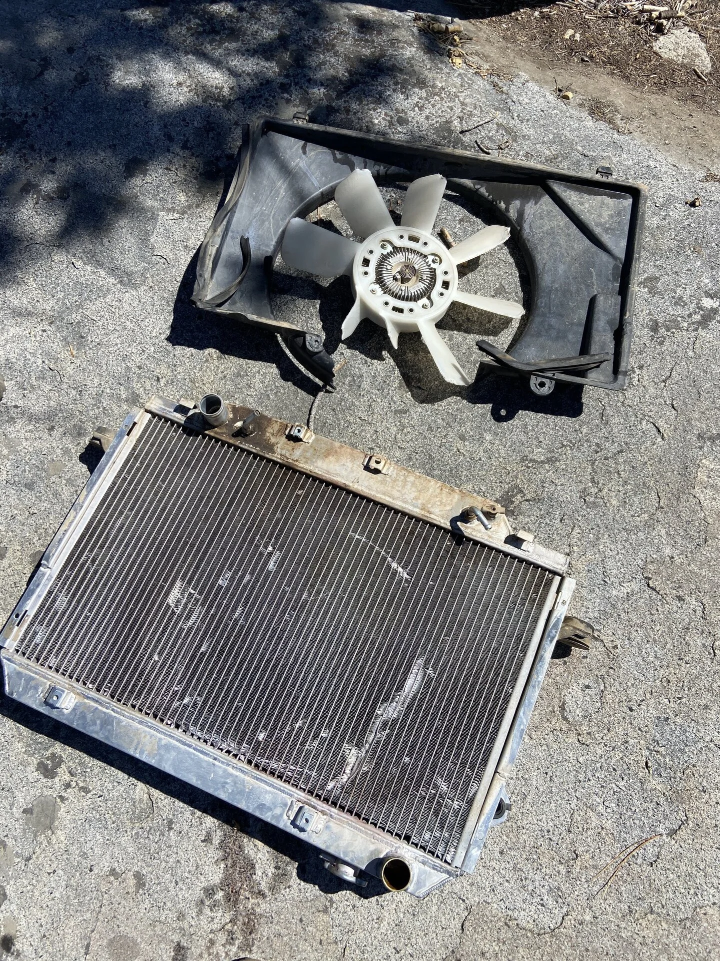

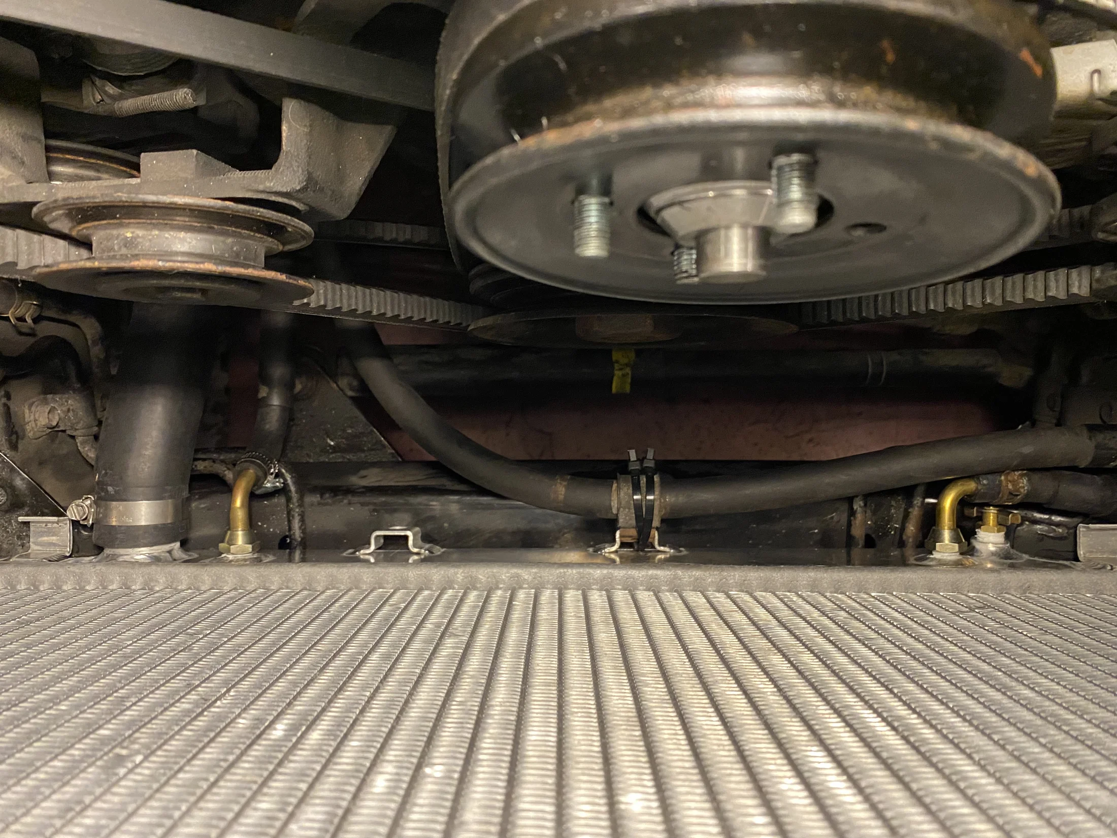

Here is a pic of the Lilland and a Ron Davis side by side....a $400 vs $2500 unit. I have ran both units thru the Rubicon trail and i see no difference in temp. difference. For what it is worth, it is a great unit as far as i can tell.
I was able to get mine in without modification as well, but order of operations mattered when putting in bolts. Upper mounts first, then with the side brackets loose put in the lower bolts, then tighten up side brackets.
The shroud gap is very annoying, I bought closed cell 3/8" HVAC foam from a hardware store to fill the gap.

Dropped in Liland 1469AA2R from rock auto. I had to loosen side bracket bolts to get it all to linenup, same as @mtnbiker4evr13
Easier to do side bracket bolts from underneath on pass side, no need to drill thru battery tray as others have done.

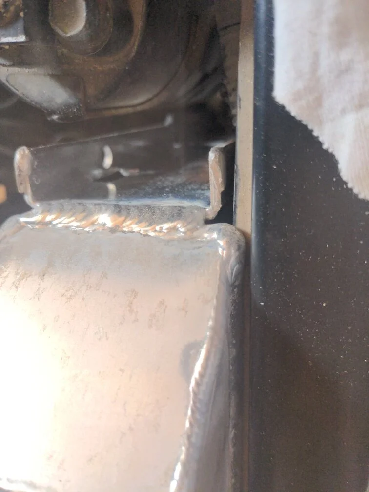

So far so good despite the sketchy tig welds on Liland.
