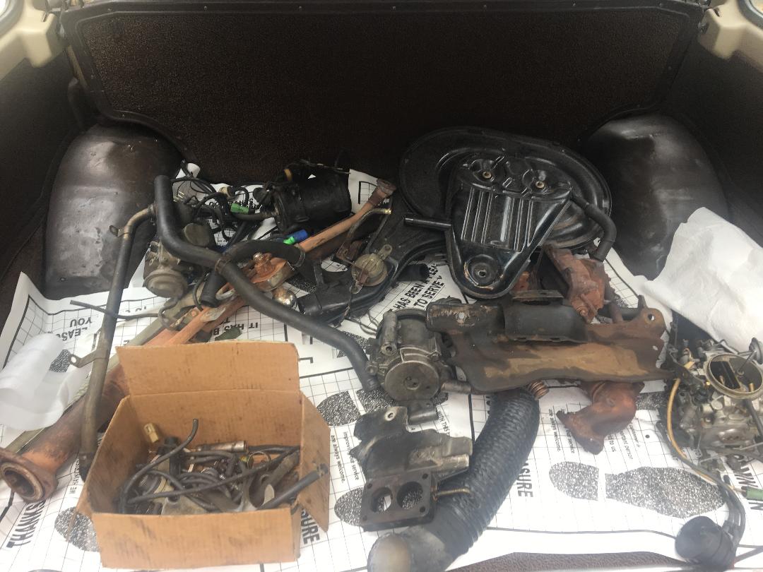

I did not do anything to my disti....you may not have too...here is what you get to remove if you desmog. Its a lot of stuff that can no longer go wrong. I still need to remove the fan that cools the carb after you shut the engine off. You can sell a bunch of the stuff too....I was on the fence about doing mine but my smog pump started making a loud clicking sound. Seemed like a good time and ended up finding some things that needed attention in the process....seems to always be the case:)
