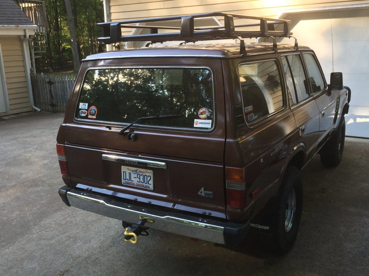

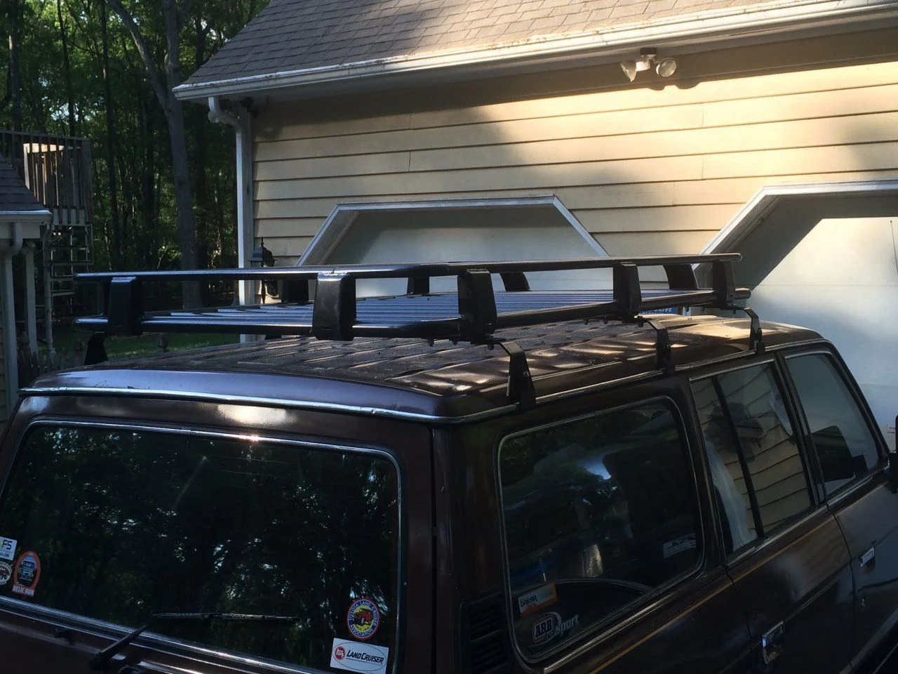

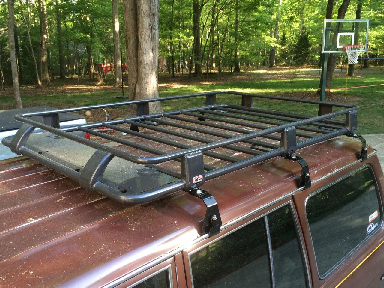

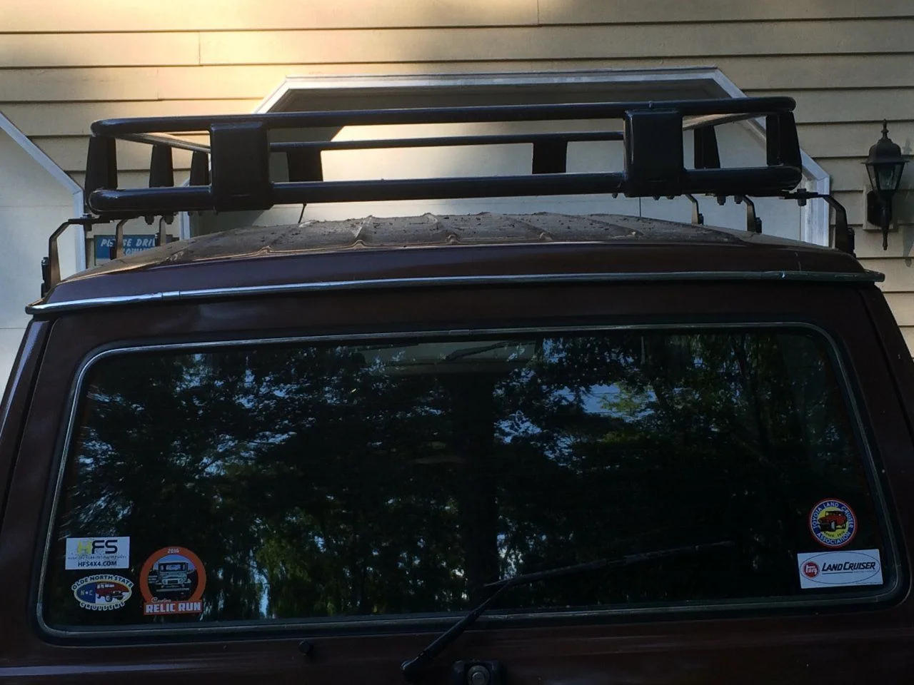

Looks really good! I'd be worried about the extra leverage that the rack has on the mounting brackets since the weight won't be directly on top of them. I'm not an engineer, but I would think your weight capacity will decrease because of that.
Yeah, Fish. I am sure you are right about that. The capacity will be less with the brackets cantilevering like they are. I don't plan on putting a roof top tent on there or anything like that. As a rule I try to keep the heavier stuff down low (inside). The things that will go up top are things like camp chairs, camp tables, etc...bulky items that take up valuable interior space but don't weigh much. I have a feeling this thing will hold more weight than I am willing to heave up there anyway.
Thanks for the compliments. I do not profess to be a welder. I only have a little 140V Hobart MIG which is fine for small stuff. I get by. That is all.

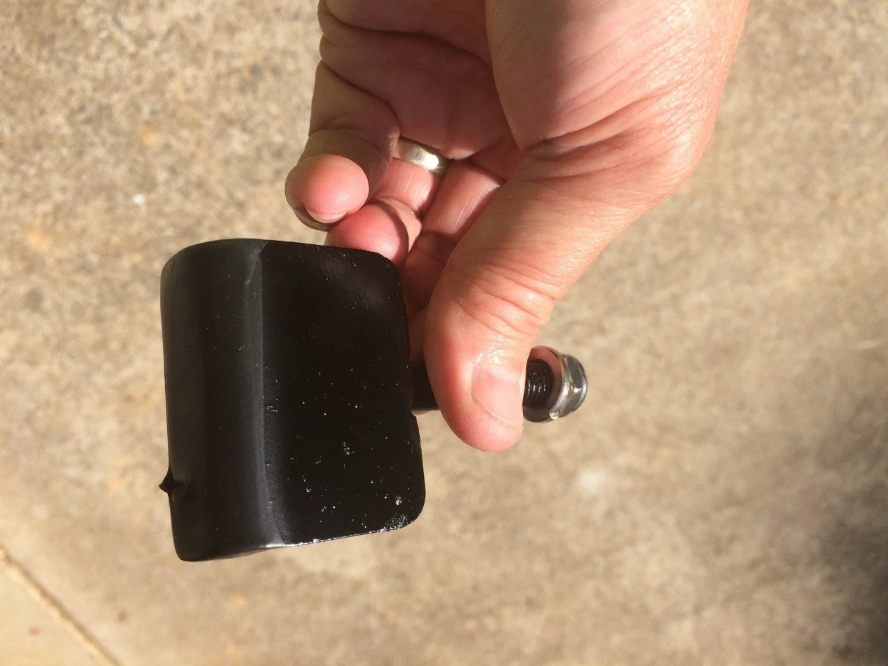

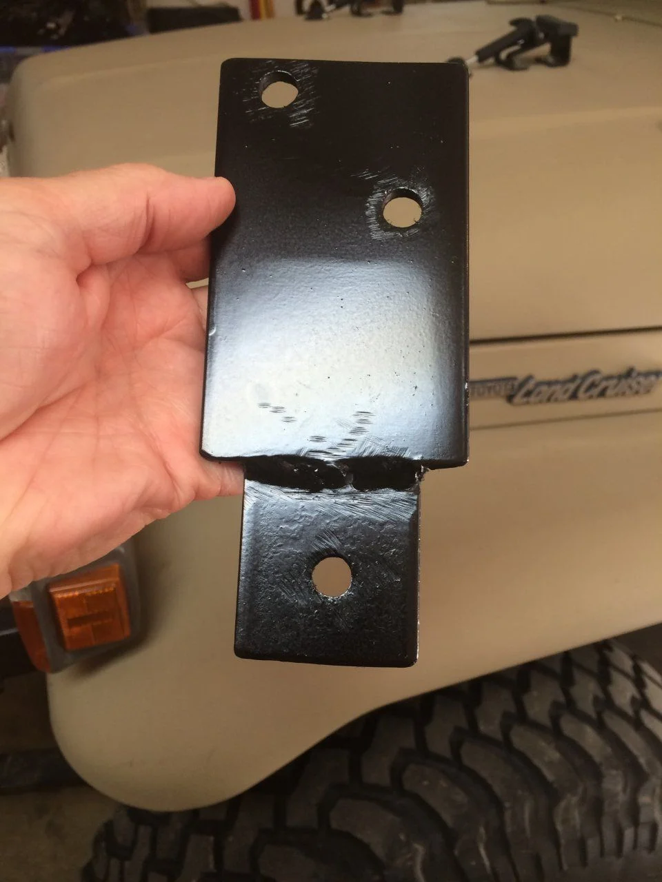

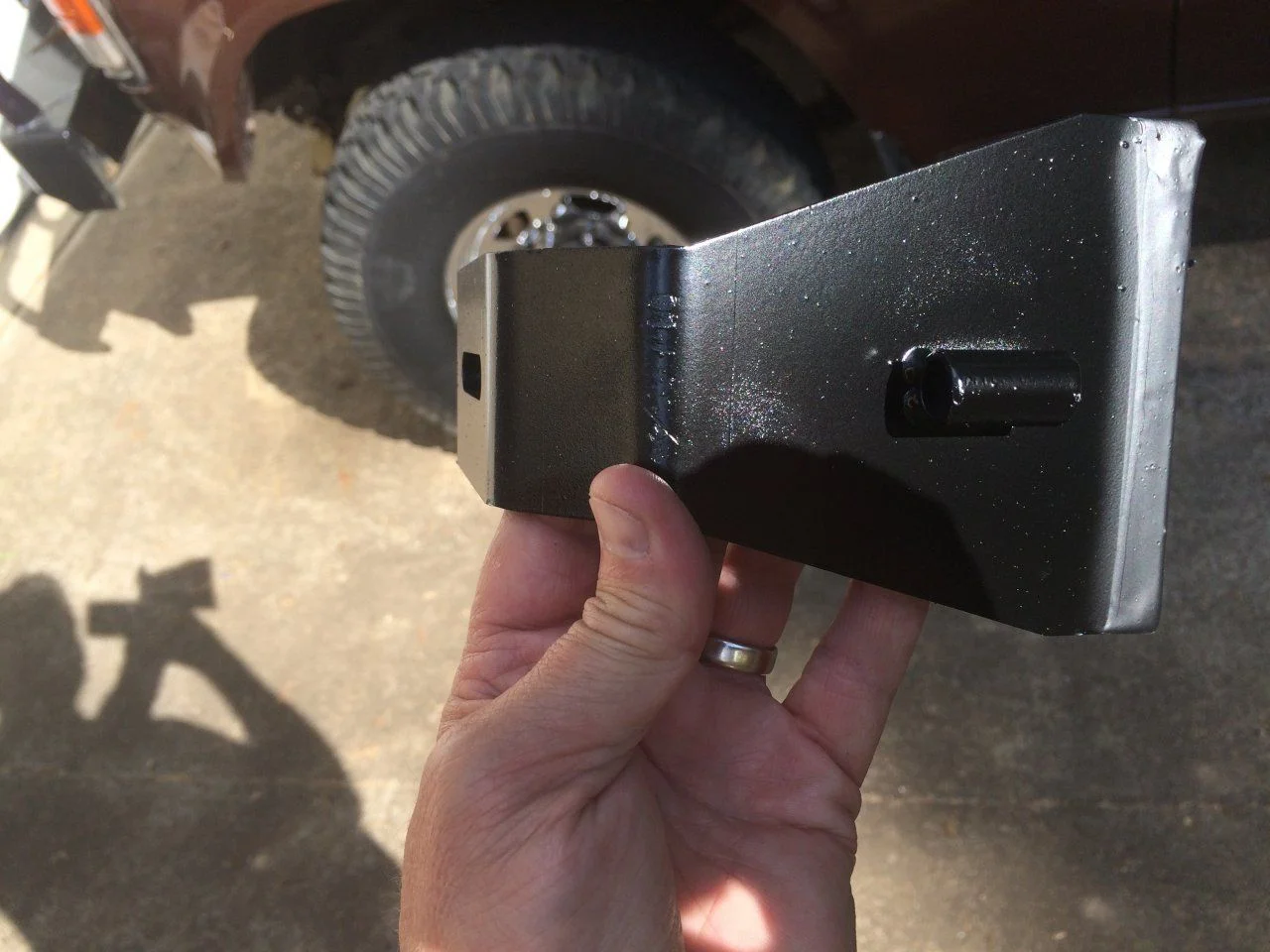

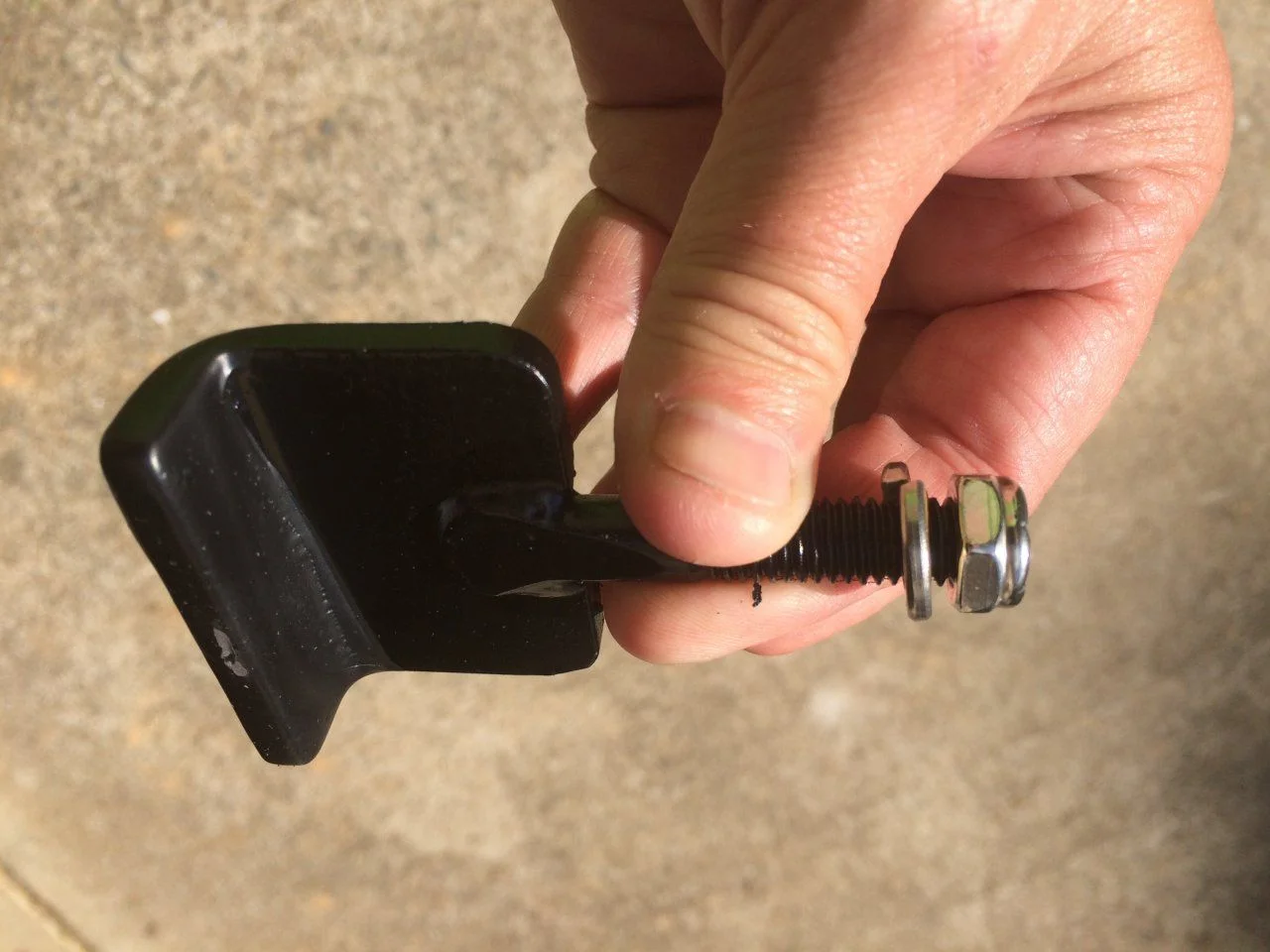

The brackets I fabbed up were about an inch too long so I cut them down and drilled a hole for the bracket to attach to the TT gutter clamps. I primed and painted the TT clamps and my homemade extensions. I decided to go ahead and Plasti-dip the ends of the clamps at the points where the clamp will contact the body of the truck. I was impressed with the liquid Plasti-dip. I can think of a million uses for this product. The can is small and my parts would not fit into it so I poured the liquid in a paper plate and dipped everything and then poured the leftover liquid back in the can. I used two coats of Plasti-dip. Three would have been even better.

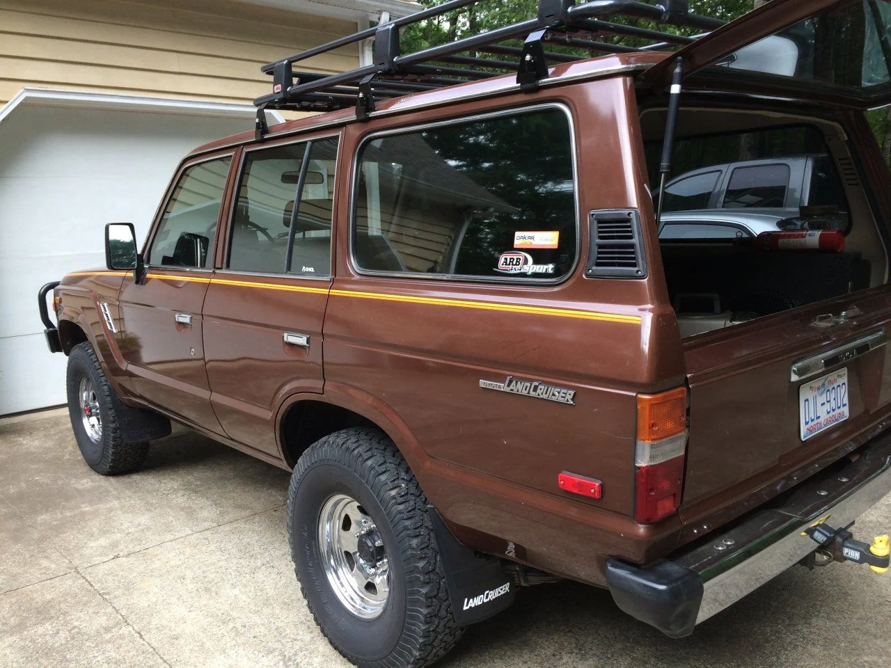

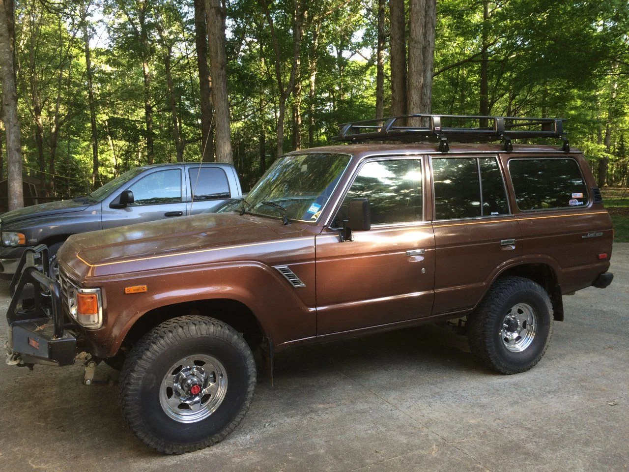

Here is the ARB 100 series rack mounted to the Turdle using Trail Tailor gutter clamps and my homemade extension brackets:
I am happy to report that everything fit just fine and the rack and clamps are very sturdy despite the offset mounting arrangement. I can rock the entire truck front to back and side to side by pushing and pulling on the rack and there is no indication of flex in the brackets or clamps at all. I don't foresee having any issues whatsoever with putting serious weight up there if I need to.

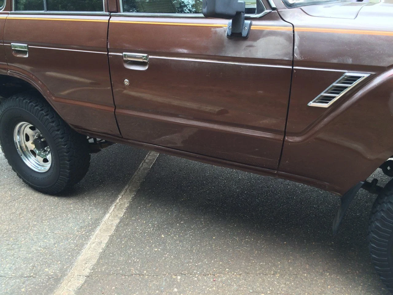

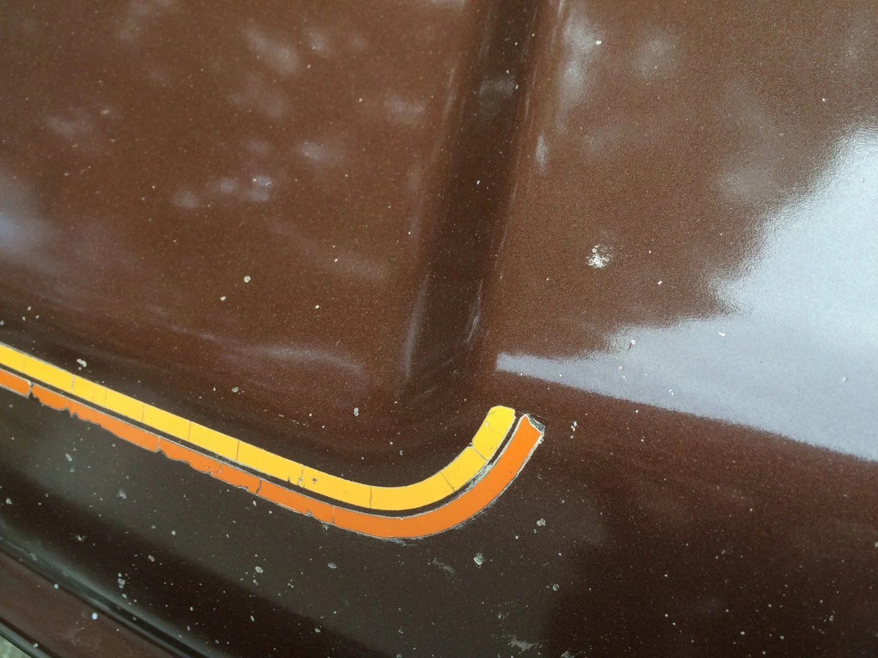

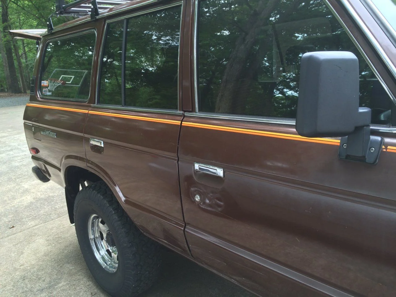

The Turdle had those awesome gawdy 80's multi-colored stripes down its sides long ago as evidenced by impressions left in the paint from sun fade. It looks like those got removed at some point and some simple straight line vinyl pinstripes were added. The last striping job appeared to be two 1/4" stripes, a yellow and an orange, running along the tops of the fenders and doors. The orange stripe has mostly met it's demise. There is still a section of it on the passenger side of the hood and the passenger fender. The rest of the orange is gone. The yellow is largely intact, however it has turned a "peachy" color and has various cuts, scrapes and shows many years of wear. In keeping with the beat-up vintage '80's look, I decided to leave the peachy yellow with all it's scars and replace the sections of missing orange pinstripe. I'm happy with the results. The striping is 3M brand and I got it at my local paint store. $15 for 50 feet. It went on really easily.
Here's what it looked like before:
Note the missing orange stripe (the bottom one) from the passenger door going rearward.
...and now for the big makeover reveal....(drum roll)....
Craptastic!
That looks good!!

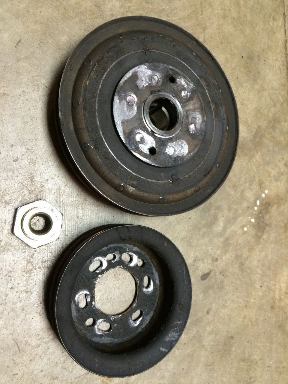

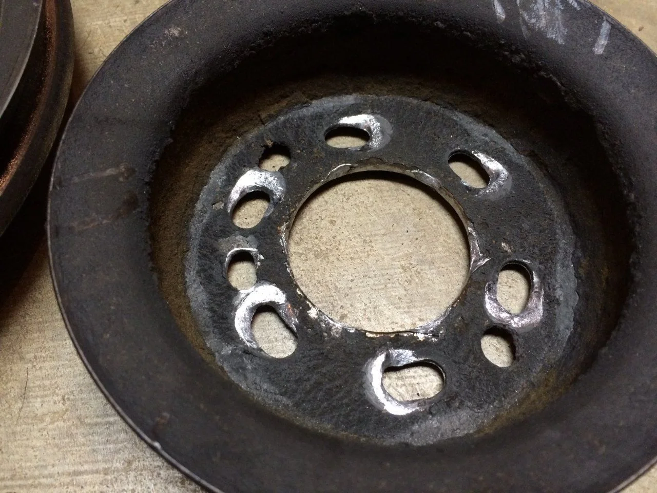

Last Saturday I was running some errands in the Turdle and at stoplights I started noticing a ticking noise from the engine. It almost sounded like the pfft...pfft of an exhaust leak. When I got to my destination I popped the hood to take a look. What I found was a wobbly crank pulley. The harmonic balancer was running true but the last section of the pulley (the outer two groove part) was wobbling. I knew this might let go at any moment but I took a chance on carefully driving the truck back home. I didn't make it. About three miles from where I made my discovery the outer pulley parted ways with the harmonic balancer. The charge lamp lit up and I lost power steering. I pulled into a gas station and waited for a tow. I got lucky in some respects. The pulley broke away clean and did not cause any collateral damage. In fact, it was just sitting there in front of the engine, suspended by the two belts. Last night I pulled the HB. Here are some pics:
Evidently this has been working itself loose for a while based on the galling and elongation of the rivet holes in the outer pulley. I plan to swap on another pulley from a spare short block in the shop. Hopefully the transplant will be a success. I guess we will see...

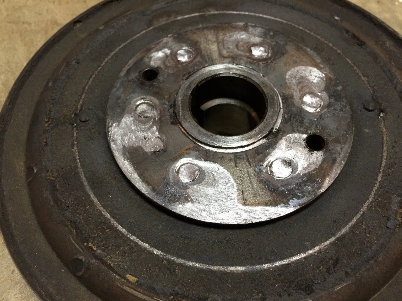

I'm happy to report that the Turd is back on the road! I did a DIY repair on the Harmonic balancer/ crank pulley against my better judgement but I'm hoping that it will be a permanent fix. Here's what I did: I used a hammer and punch to drive out the remains of the rivets in the harmonic balancer. The holes were perfectly sized for a M10x1.5 tap so I tapped them. I purchased six metric grade 10.9 bolts (roughly equivalent to standard grade 8) and nuts and bolted the pulley to the HB using the grade 10.9 fasteners. Next I tack welded the bolt and nut heads to the balancer. Just for safe keeping I ran three 1.5" beads (equally spaced) around the pulley to secure it to the harmonic balancer.
I'm a cheap ass. I admit it, but I couldn't justify $400+ for a replacement pulley. I had a line on a 3FE pulley for $100 that would have probably worked but it would have required me to replace all three belts as the 3FE pulley is smaller. My current belts are brand new. I was also concerned that the alternator would not spin fast enough to keep up. It struggles enough as it is.
You might ask, "What about the balance of the balancer?" I asked myself that question too. What effect will the bolts, nuts and welds have on the balance? I'm not sure. I can say this...the original pulley had been working itself loose for many, many miles. I had no idea until just before it let go. No vibrations. No noises. Nothing that would make me think that the engine was being compromised in any way. The crank and key/keyway looked perfect. The front two pulleys had years of built-up mud and crud inside of them and there is no way that it was balanced perfectly with all that dried crud in there. Who knows, my DIY fix may be better balanced than it was before the pulleys separated? It spins true. One thing I did do was to loosen the belts a little to reduce the leverage on the front of the crank pulley. They were tight as hell which probably contributed to the demise of the pulley. Thanks alot, PO!

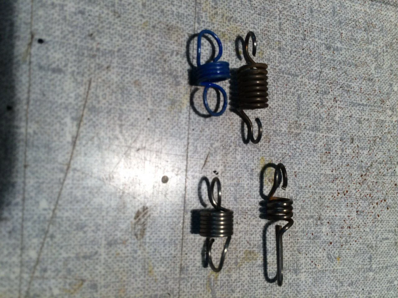

The second issue with the FJ60 distributor is the advance springs. The primary advance spring is soft and thin and the secondary advance spring is thick and quite rigid. They work fine on a truck with the emissions intact but being de-smogged, I knew I needed something different. I picked up an MSD recurve kit (PN 8464) and used the springs in that kit. The kit was $16 at Pep Boys.
The kit comes with a pair of hard, medium and soft springs. I replaced Mr. T's primary spring with the blue (medium) spring from the MSD kit and Mr. T's secondary spring was replaced with the silver (light) spring from the MSD kit. Here is a pic of the factory springs next to the springs that replaced them.
Once the MSD springs were installed I reassembled the dizzy and re-installed it. I re-installed the vacuum lines with primary to primary and secondary to secondary as they were intended. I played around with the timing and I found that this set-up likes more initial advance than the original set-up. The timing light I have is a cheapo so I don't know my exact setting but it has to be around 15-17 degrees advanced. The BB is down below the sight window about 1/4". It seems like a lot of advance but the truck starts right up and runs great. I drove the truck hard with several pulls all the way up to redline. The truck pulls much stronger throughout the RPM range. Overall the truck just feels peppy. There was no pinging whatsoever and the advance curve seems very linear. My butt meter tells me I have a new truck now! I know I don't but the drivability is night and day compared to before. I will continue to drive the truck and tweak things as needed but for now I am very happy with my set-up.
