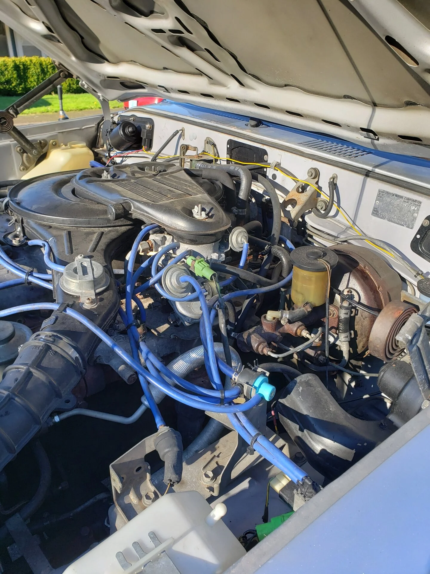

The vehicle started it's life in Oregon, then made it's way to North Carolina for most of its life, then to Idaho, then back to Oregon. The PO said the car was already desmoged, but am unsure to what extent. My first question would be, did all FJ60s coming to the states get the same smog equipment or did it vary state by state? Also, from the photos I've attached below, does the motor look like it's desmogged already?

Your engine is missing the EGR system and air injection system, so yeah, you’re pretty much desmogged. There’s no way in hell the vehicle would pass a smog test in the state it is now.

Your mechanic pretty much summed up the situation correctly: vehicle has been partially desmogged.

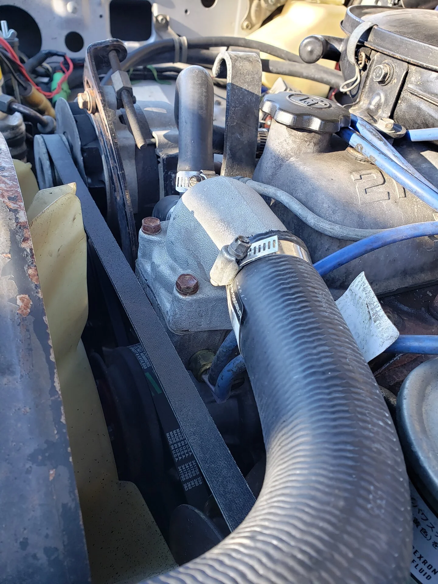

This is right under the thermostat housing and it shows both ports being plugged
My thermostat housing shows one port still has vacuum lines going to it. Would this be one I need to plug? The same goes for this port that's on the manifold

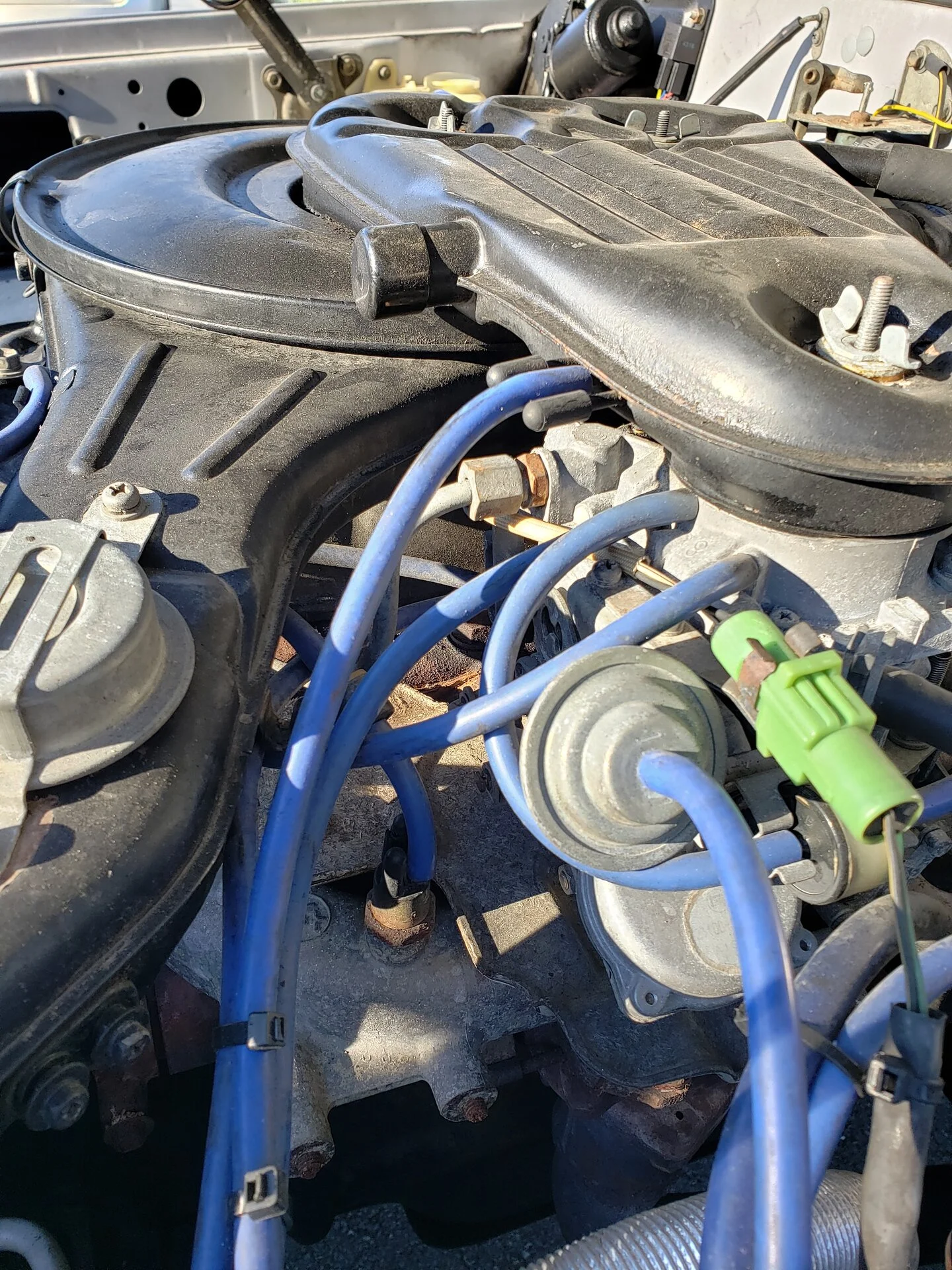

There's a plug in the port next to the Toyota logo, but on mine it still has a port with vacuum lines.

You should really read the pdf I mentioned above. As @OSS said there are varying degrees of desmog and there are optional parts that are disputable and or affect you depending on where you live and drive. BVSV(1) SHOULD be kept because it is part of the EVAP system!!! That is the upper valve. Lower BVSV(2) should be removed and plugged. Some people do not use the HAC valve like me, as I am at sea level and don't plan on taking this cruiser to CO anytime soon. HIC is another optional part..... I read the 24 page pdf a couple of times to understand it all prior to touching anything. I'll PM you.
----You should keep the port on the intake manifold.
