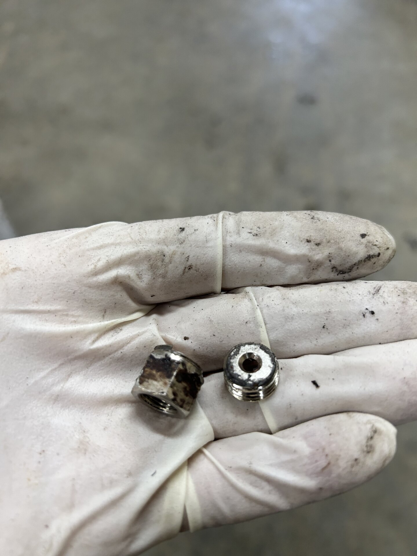

Why was I stressed? ‘Cause the axle is back together and the locker is not locking!?!?! This sent me in a tailspin of checking everything- switch wiring, air lines, solenoid & free hub( see above). All eventually checked out. I was convinced I needed to tear the axle back down, so I could tear the diff down (again). Looking back I was pretty sure I followed the ARB instructions to the “T”. Pissed I stopped for the day and slept poorly. Next day I thought to check the airline coming out of the diff before I tore it down. The bulkhead came out a little to easy:
Well actually, the top half came off easy. The second part needed an easy-out, but it came out pretty easy too. So hopefully this is the reason for my angst. I have a new one on the way and next weekend I’m headed to Sand Hollow with a couple buddies. I really want a front locker for the trip. Oh well, I’m learning??????

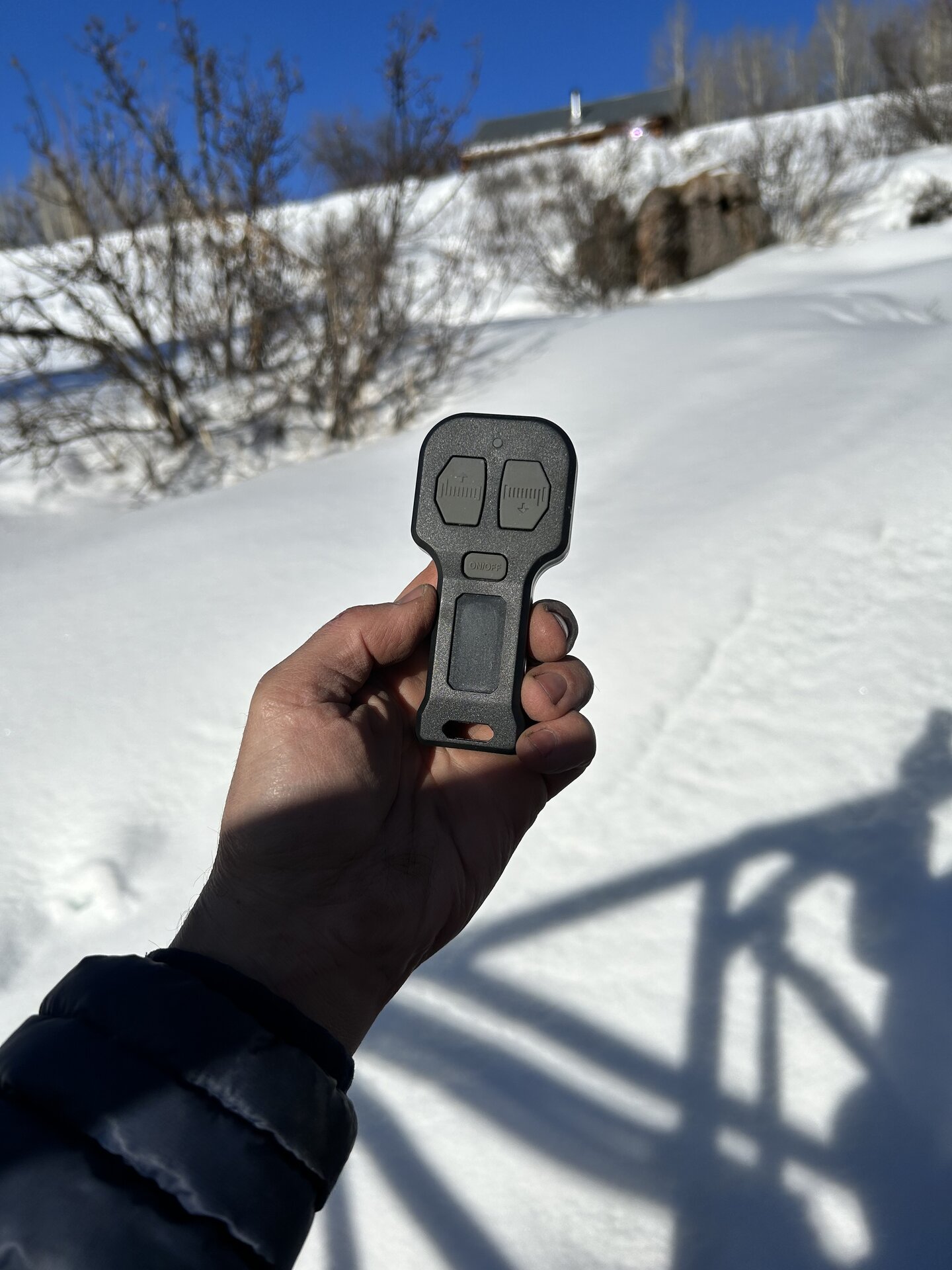

Next up was a wireless remote. While my Warn remote had never failed me, I was ready for something else. Recently, the mud terrain lugs had grabbed the cord while was using the winch and broken the socket out of the cover. Coincidentally, someone had posted up a $17 wireless remote on this forum, so I jumped on it.
Spooling it up showed just how neglected my batteries in the truck were. If I stalled the truck, it required the jump pack. Even a light pull required revving the engine to keep from stalling. But the line is loaded up on the spool and the cruiser is back in the garage. And the new line matches the cruiser color, so there’s that …
