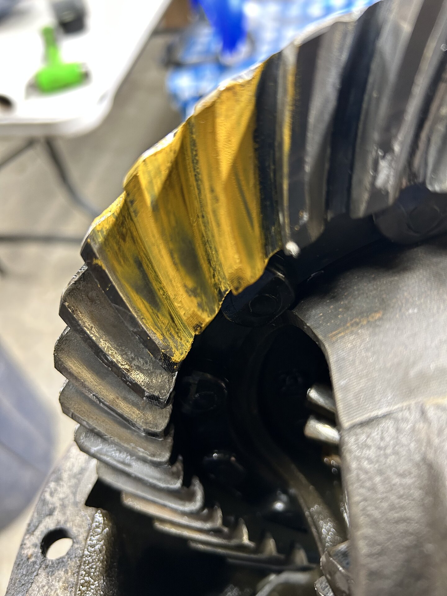

Here’s the gear pattern before I tore it down. I think the differential was in good shape. It pains me to replace all the hardware since it was in good shape, but I understand this is the way.

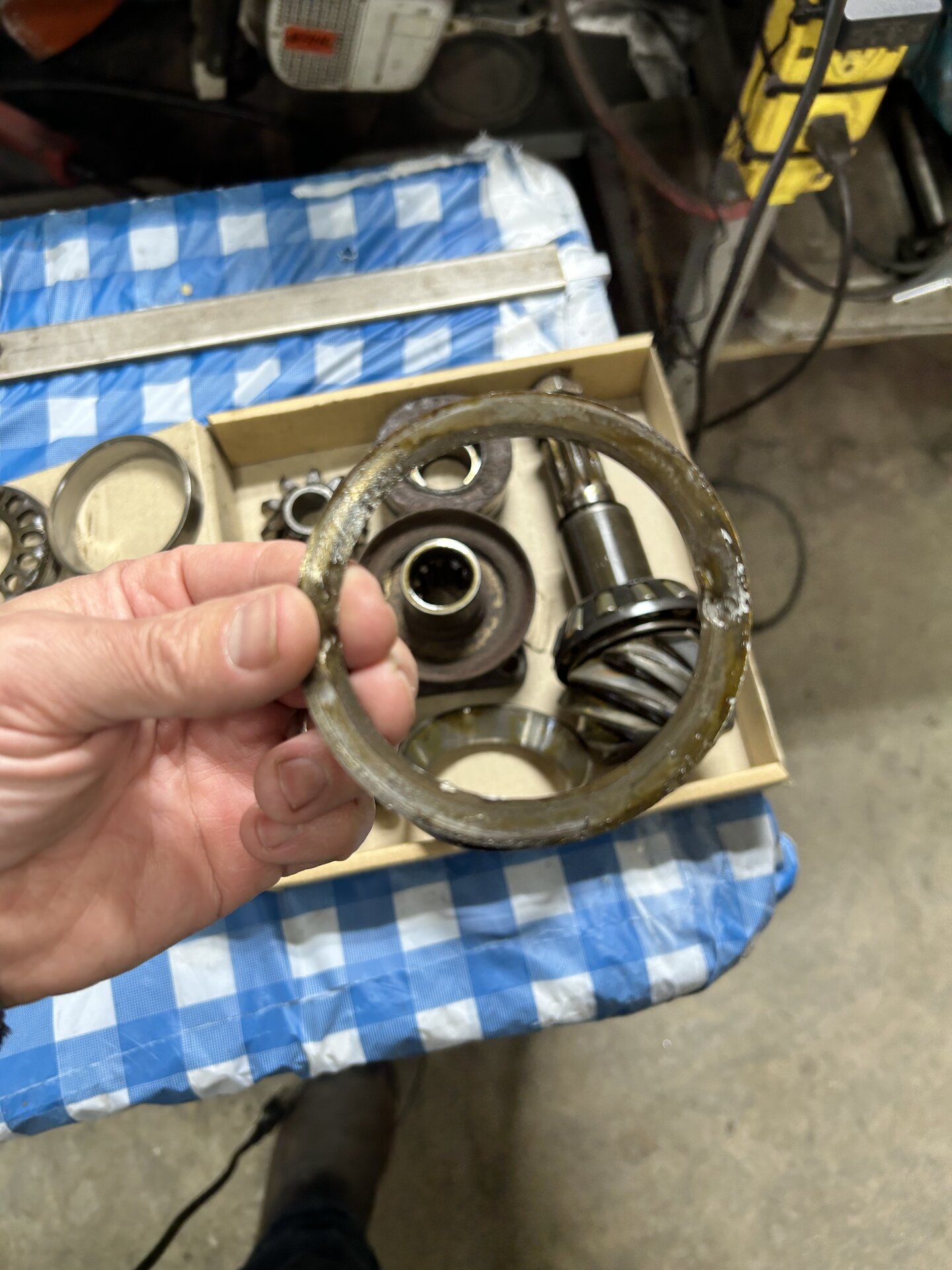

Then I forgot to press the inner(rear?) bearing out and fubar-ed the bearing spacer knocking the race out with a hammer and drift. Luckily the new install kit comes with a set of shims. Time will tell…

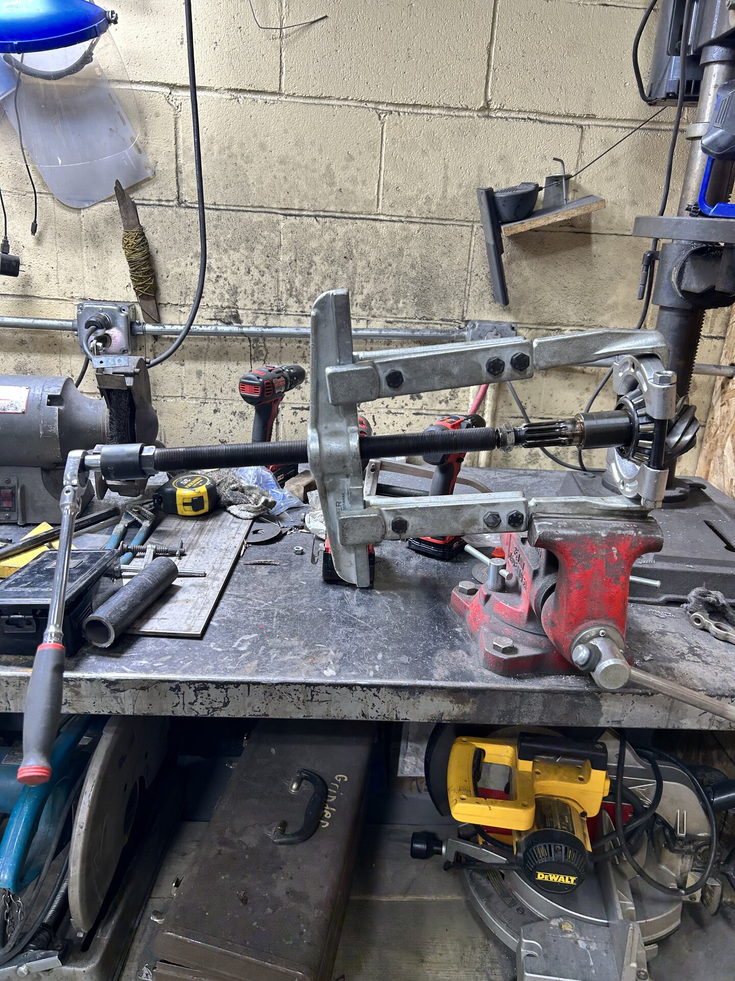

This mother is kicking my butt. I’ve tried two different pullers, but it keeps deflecting one way or the other. I have it in the freezer currently, hoping the shaft will contract more then the bearing I’m open to suggestions.

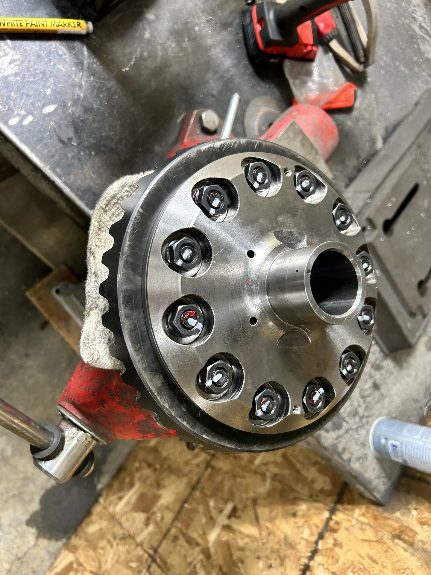

On the flip side, the ring gear went on easy as can be with a little from the oven. Bearing will have to be sit til next week.

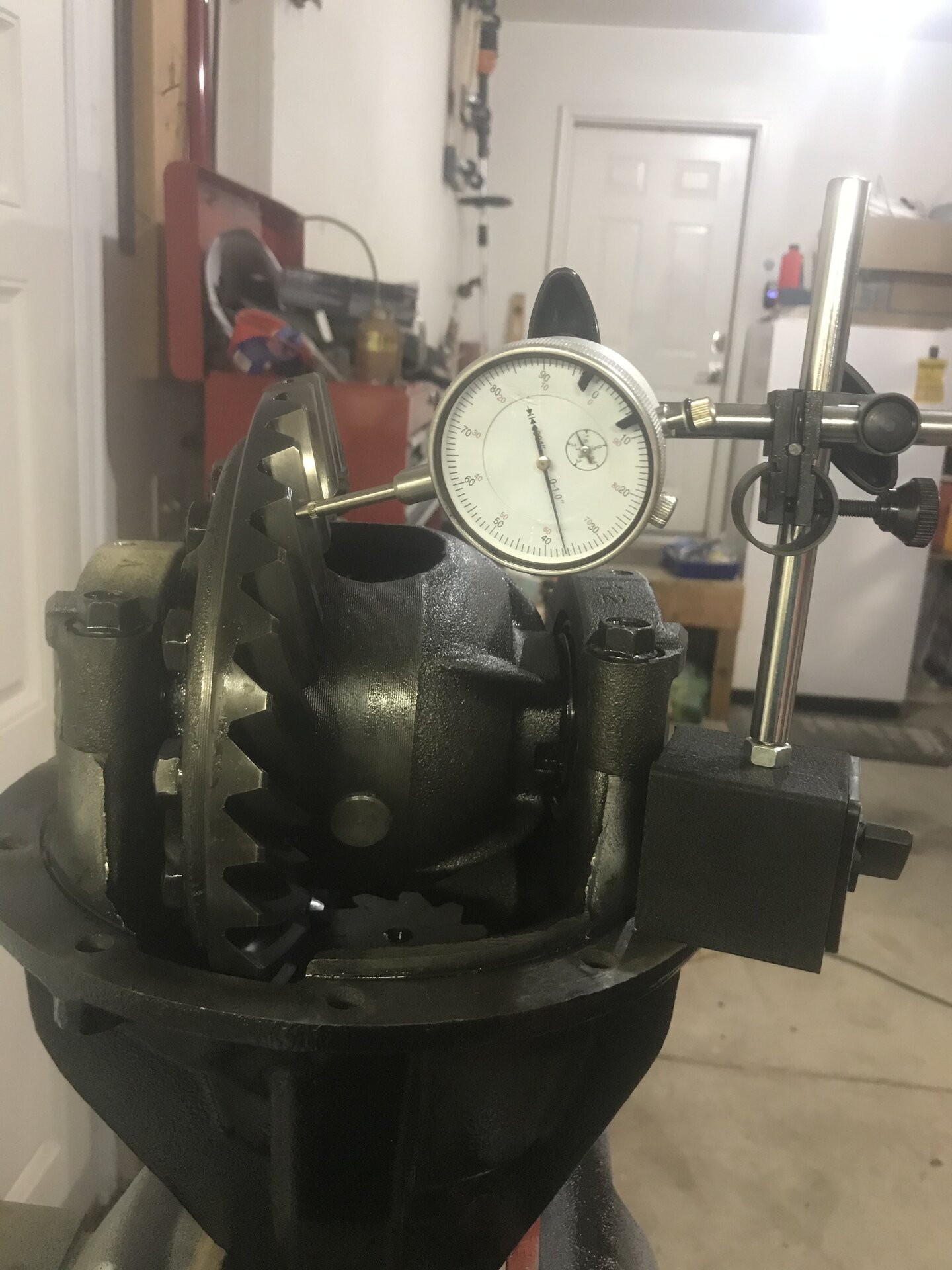

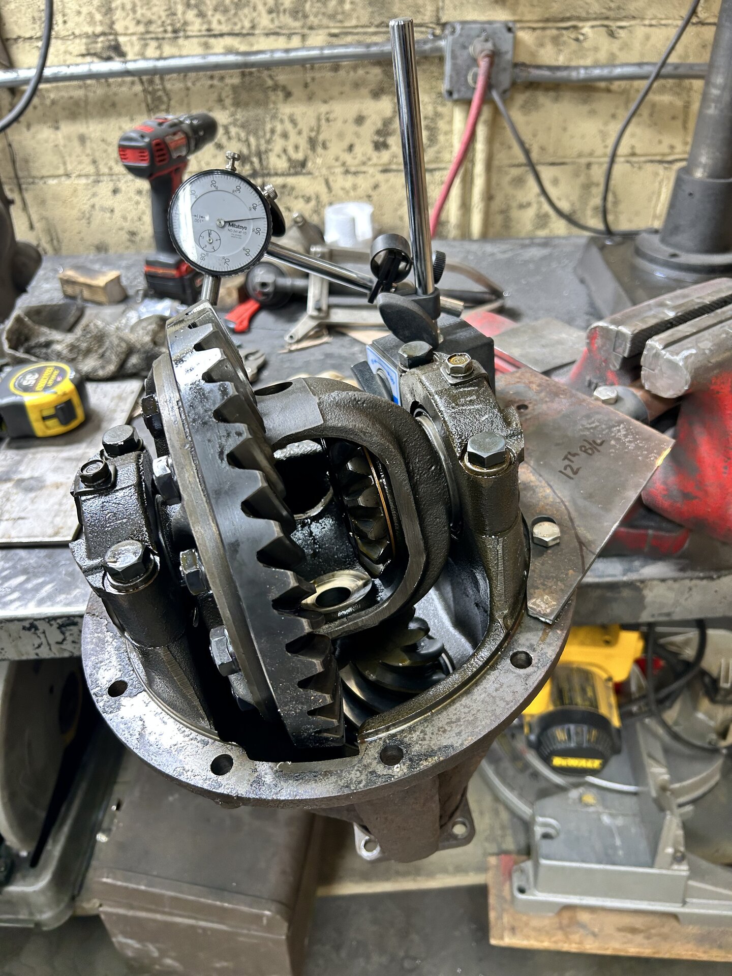

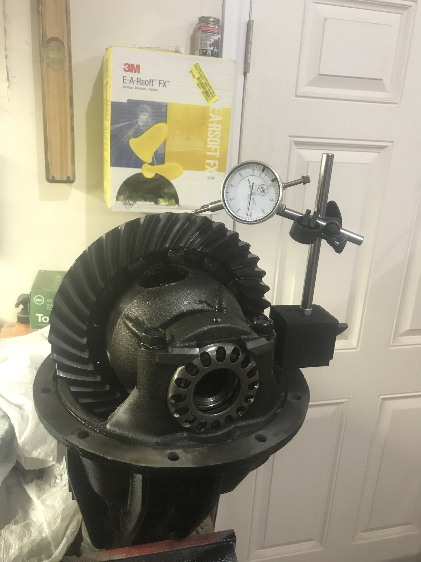

My initial backlash measurement was 14 thousands. In my internet research I found that the backlash should be 5-10 thousands or returned to the initial backlash. Which is it?
In my mind, this’ll likely honing in three steps, this will be the first. The next is to finish the differential assembly. Hopefully the next week. After that I’ll install it with the chromoly shafts. Hopefully all this happens by mid February, because February 27th I’m headed to Sand Hollow!!! Hopefully, it doesn’t snow!!!

View attachment 3224963Here’s the gear pattern before I tore it down. I think the differential was in good shape. It pains me to replace all the hardware since it was in good shape, but I understand this is the way. View attachment 3224965
View attachment 3224964This mother is kicking my butt. I’ve tried two different pullers, but it keeps deflecting one way or the other. I have it in the freezer currently, hoping the shaft will contract more then the bearing I’m open to suggestions. View attachment 3224966
I’ve never taken one apart without a press. In a pinch, you could also cut the bearing cage off with a die grinder and then score the race with a cutoff wheel. Slow is the key word here. After that you should be able to crack the race with a couple hits with a hammer and cold chisel. All that said, I would look for a hydraulic press first.
As far as the backlash goes, if all the bearings were good and preloaded before you took it apart, I would set it back up with the 0.014” backlash. With a used gear set, I was always taught to make it match. I’m sure there will be other, more technical opinions come from others.

In your pics of the puller your jaw arms are not parallel to each other which might be causing the deflection of the bearing spitter. Most bearing pullers I've seen screw into the threaded holes in bearing splitter and pull evenly and are parallel. I think the splitters bolts need to be pretty tight. When you use a press, they have plates that sort of go around the circumference bearing splitter to support it evenly. As mentioned b4, you can cut the inner race then crack it with a chisel. Fyi, once the old bearings are removed, I stick the new bearings in the oven for a while so they easily slide on to the journal.
You have a keen eye. My first attempt with the splitter was with the supplied thread-in puller, but it suffered major deflection. This monster puller was my follow up attempt, when it didn’t work I decided to regroup and ask for advice. If the freezer trick doesn’t work, I’ll cut it off.
The deflection in the splitter was noted and I tightened them enough to remove the threads from the nuts. It’s a tight fit on the bearing. I could use a bigger one, if I had one.
It’ll give- one way or the other.
I used the oven for the ring gear, slipped right on. I’ll keep the practice on the bearings. ARB recommends ~200 deg for the ring gear. Will that temperature damage a bearing?
Shouldn't.
I used a SKF bearing heater when I rebuilt my rear diff, I hit something like 225F and dropped the bearing in place. A couple love taps with some pvc pipe just to make sure it was set in place properly and I went on my way.
As far as getting that bearing off, I used a press that I had access to. It might be worth a shot to hit it with a torch, and Kroil or something to try to break it loose. Try to focus heat on the race.

The old pattern looks like it could have been moved out a fuzz.
Makes me think it's been worked on before.
