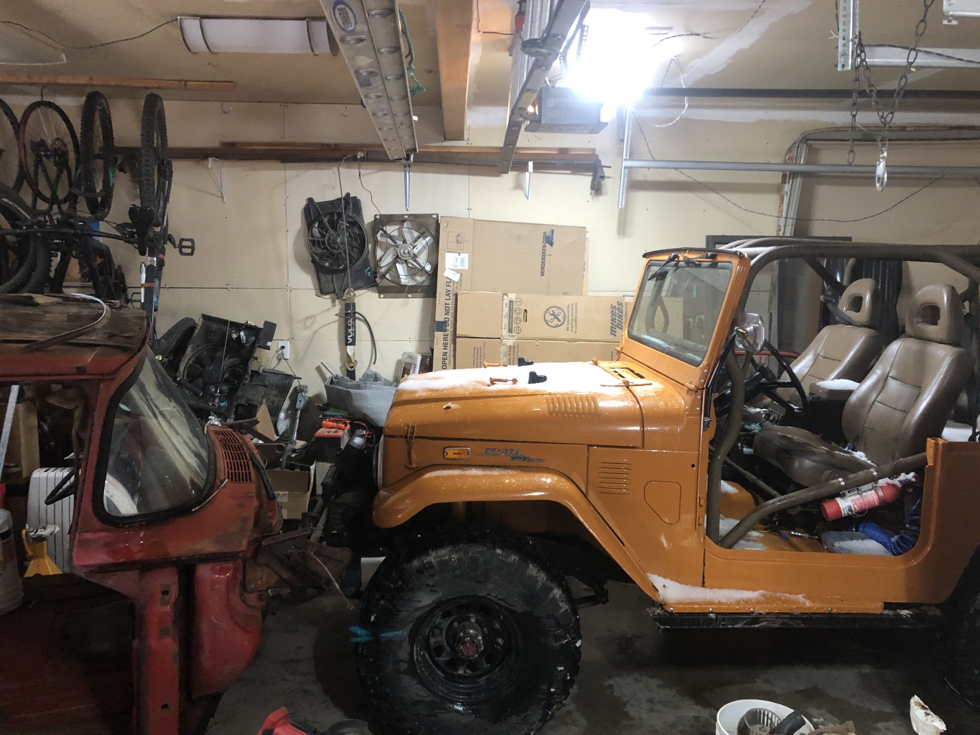

Pulled it out so I could get the cab from the ford in the garage. When the cruiser finally came back in it was cover with this white stuff.

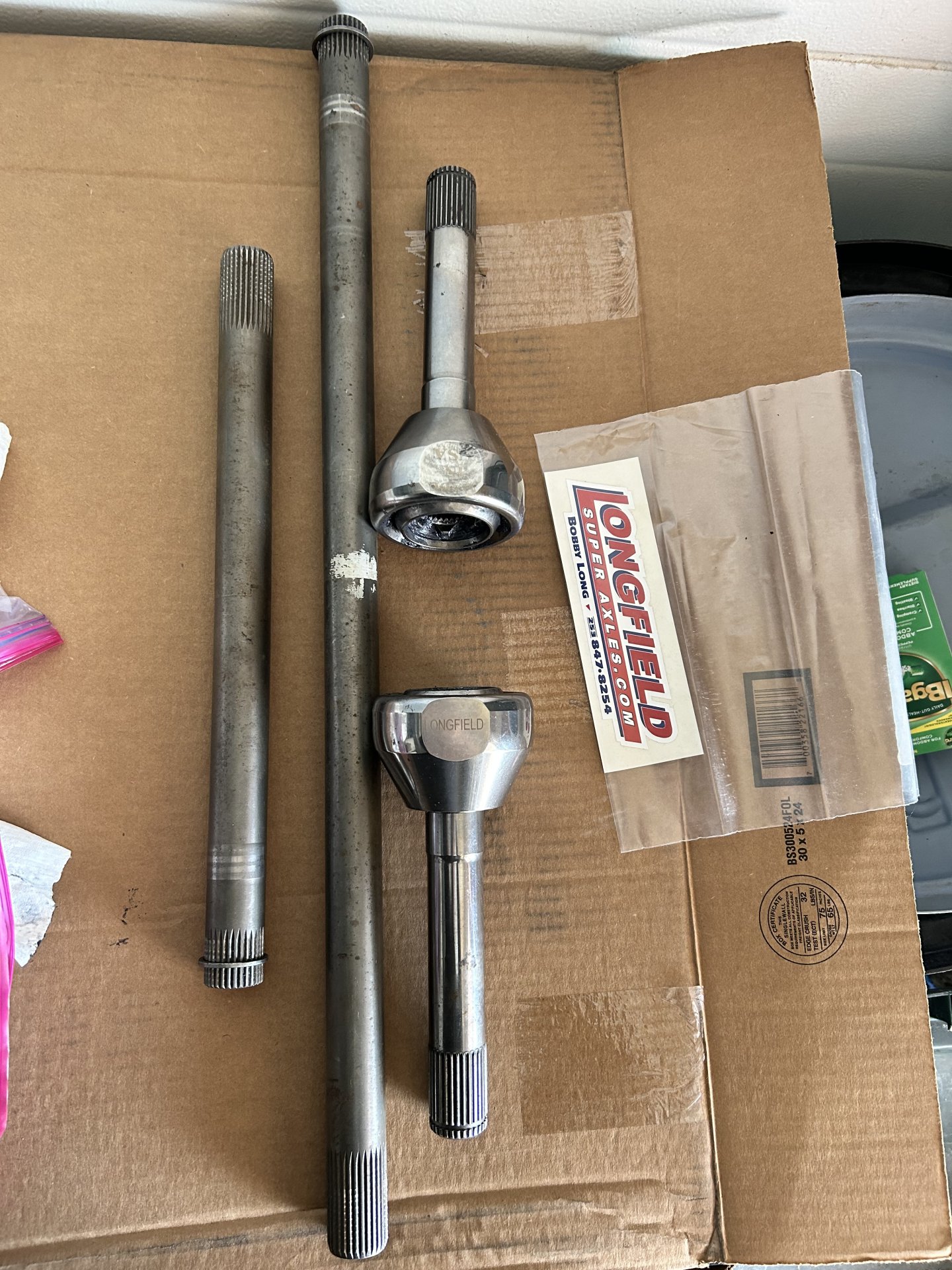

@Okie_dave was selling these Longfieilds he had as spares. I’m one step closer to locking the front end….

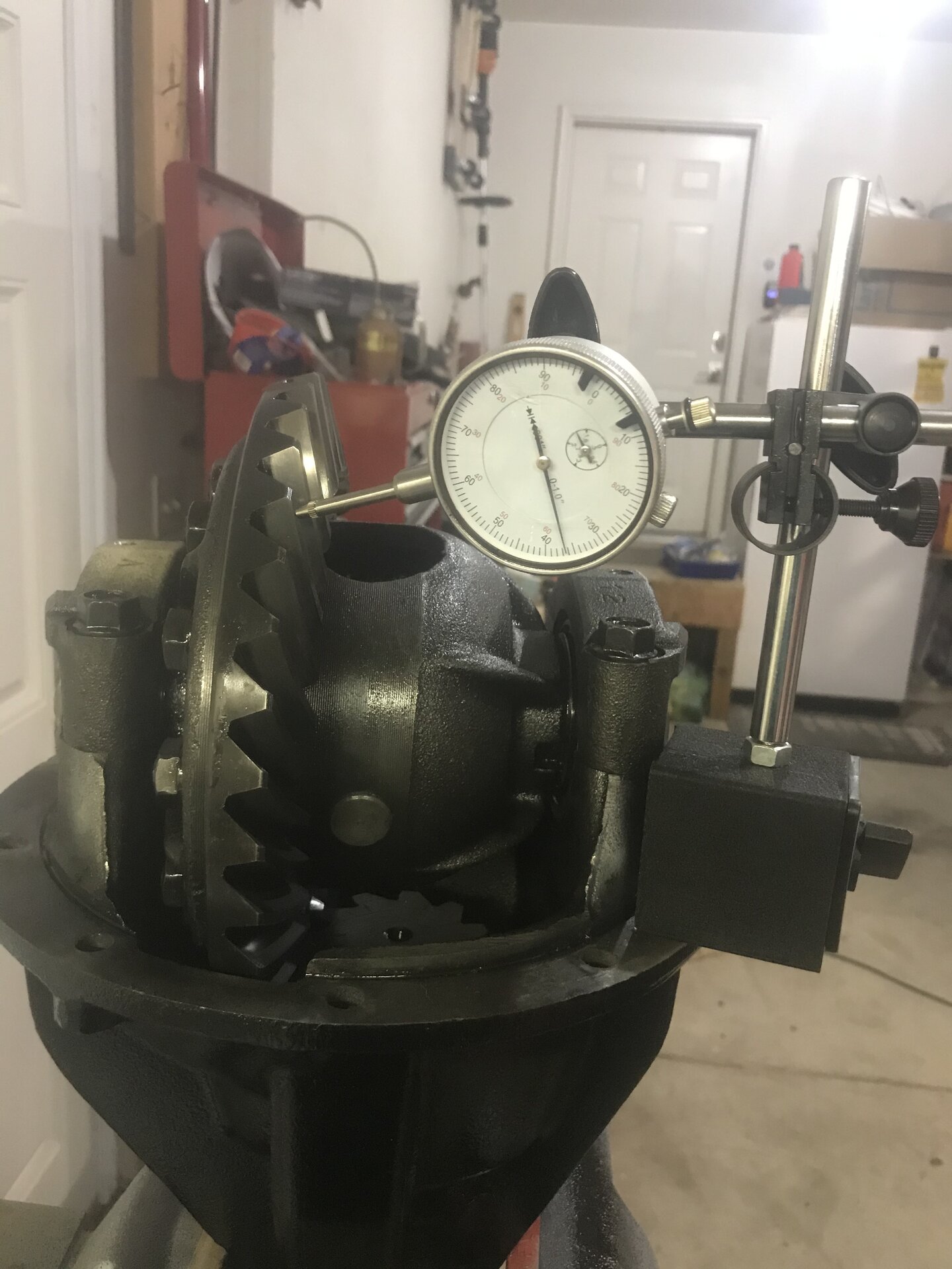

Plan is to rebuild the rear differential that got pulled when I upgraded to the fine spline 80 chunk/arb for the back. I need to dig this out of the parts pile and make sure it’s up for the job. If not I’ll pull the diff out of the cruiser.
This leads me to the next step- do I farm out the locker install or do it myself? I’ve never set up a differential, but like most shadetree mechanics I enjoy a challenge. I’ve been watching the @OTRAMM youtube videos on the 9.5 diff and I think I have a decent grasp on what it takes. Tool wise I’ll have to buy a dial indicator and fab up the SST for the end caps, but the rest I have at work. OR I breakdown the old diff and farm it out to a local shop. It would likely be better done and I wouldn’t have to buy/make any special tools that aren’t likely to used a lot. What do peeps think? @White Stripe i think this is your area of expertise- should I leave it to the pro?

They aren’t hard, just take it slow and be methodical. Don’t make more than one adjustment at a time.

That’s encouraging, thanks. I’m confident I can make the end cap tool at work, I’ve made similar tools in the past. Anyone have any recommendations on dial indicator that won’t break the bank? I don’t know how much I’ll really need it, so I don’t really need a top of line one. Just something that’ll give me reliable readings.

Here is the one I bought when I did mine. I usually go for the best, but it’s accurate enough to set up gears.

I would say depends how much time vs money you have. If you have the time to carefully setup the arb go for it. Having it done elsewhere will cost more bit then any issues is on them which is a plus. You can add a york compressor to a LS motor easily too fyi.
I think I have the time and I’m game for the challenge. Cost is a factor, but if I can’t get it right I’ll take it to a pro to clean up my mess. One up shot is I already have a compressor, so I don’t need to spend money on that. The York would be sweet on the bagged f100 though.
