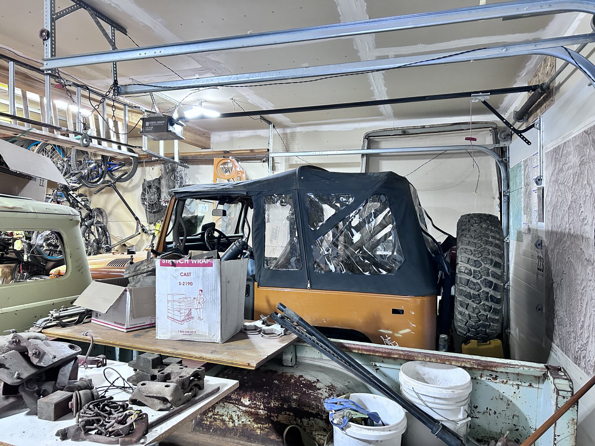

So I cranked the heat up help the top get malleable and set about installing the bows. AND finding the bits and pieces scattered around the garage. Couldn’t find the windshield bracket for the door frame. Made some.
Couldn’t find the connectors for the bows. Made some. While digging in the scrap bin, I found the connectors. While getting the top out I found the windshield brackets (& a mouse nest). That’s how long term storage goes I guess. I added some bicycle inner tube under the brackets to protect the paint. The HiLift and brackets came off the back of the cage. The homemade mirror bracket came off the drivers hinge- probably going to spring for the oem mirror arms now. The struggle is real.
Anyway, it’s on. It fits pretty good. Stretching it was fun, hopefully, I don’t have to do it again soon. Maybe I’ll install a heater. Hahahahahahaha

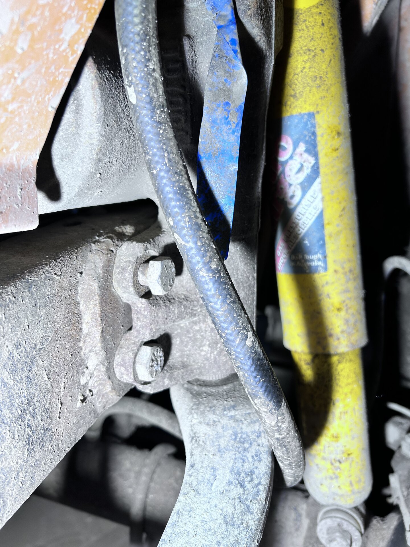

Having the steering box firmly attached to the frame is probably important. It’s Remedied. I ran out of time to do a thorough torque check on the rest of the truck. Tomorrow…

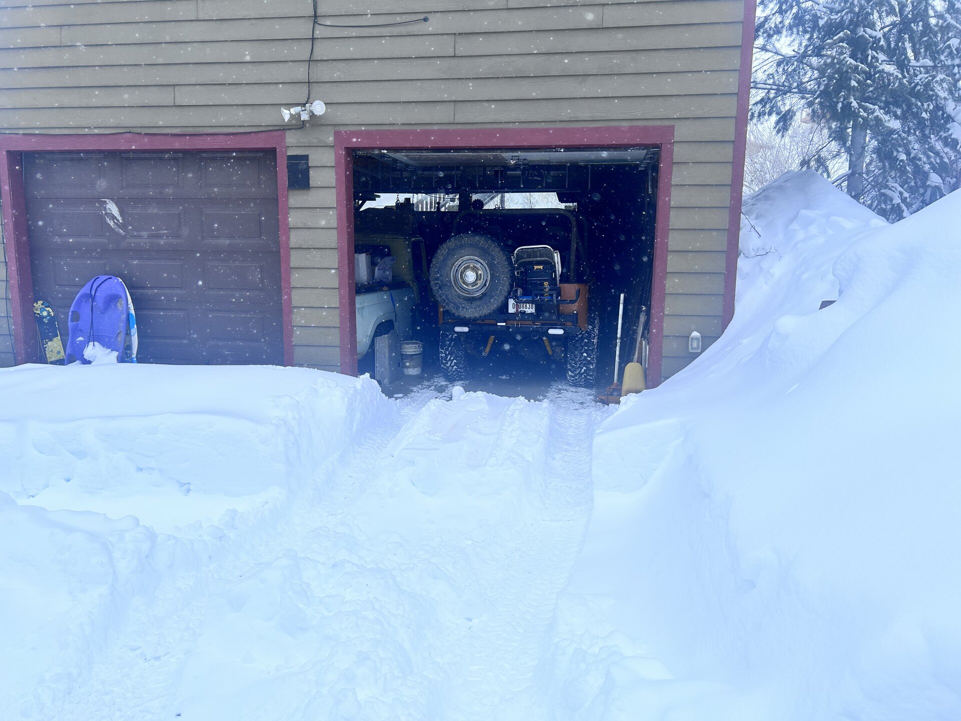

Made it home to 2’ of fresh at the house.
We were getting reports from those at home of the snowstorm last couple days. They weren’t exaggerating, it’s a mess. Roads were messy the closer we got to home, but manageable if you kept it slow. It was tricky getting the trailer into its winter spot as the plow must of been rushed when he was here last.
Cruiser is tucked back in now.

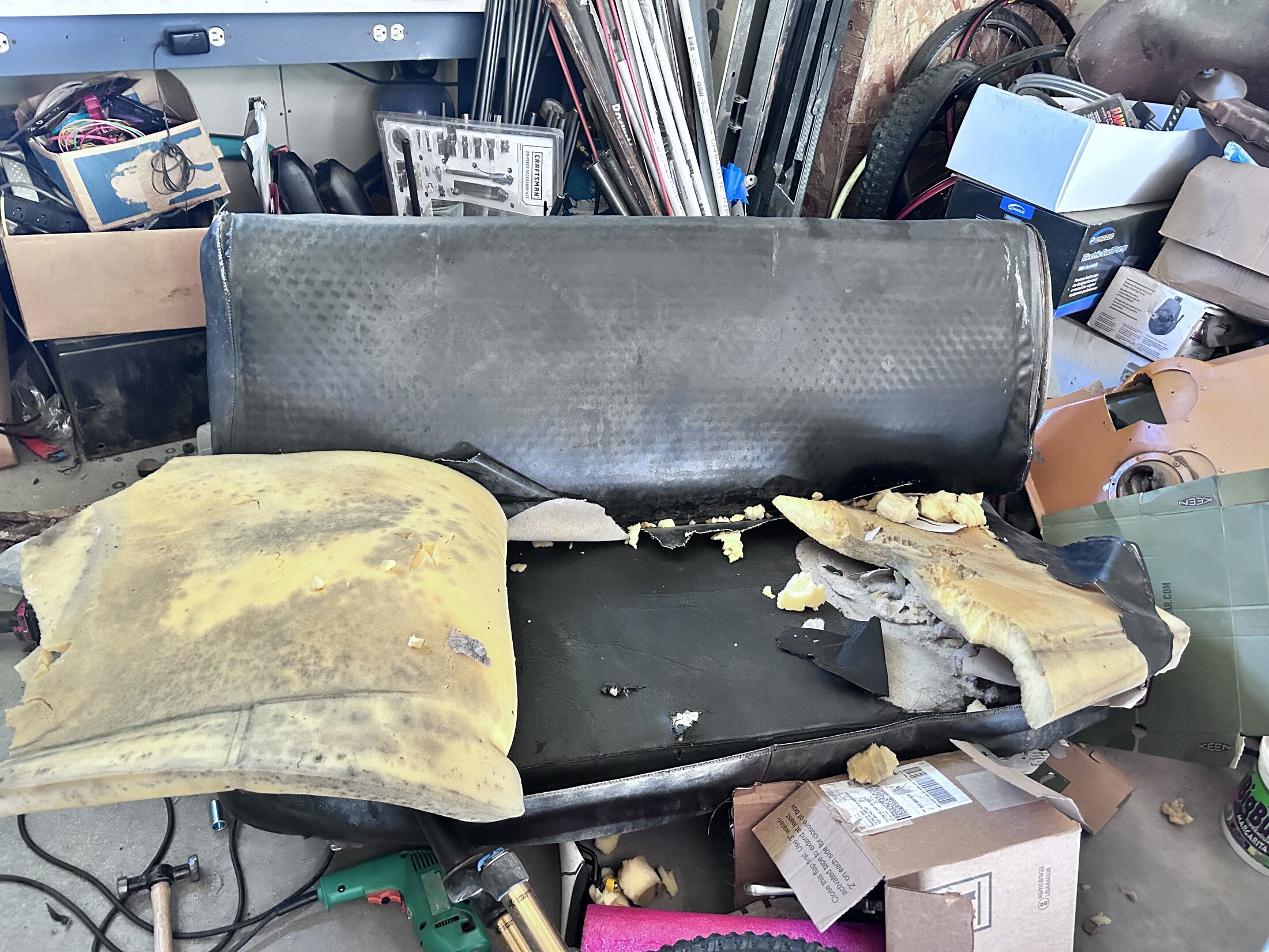

Most of it was just mess fortunately, but that doesn’t mean he didn’t cause any damage. This is the bench seat from my 59 ford. It wasn’t perfect, but it was useable.

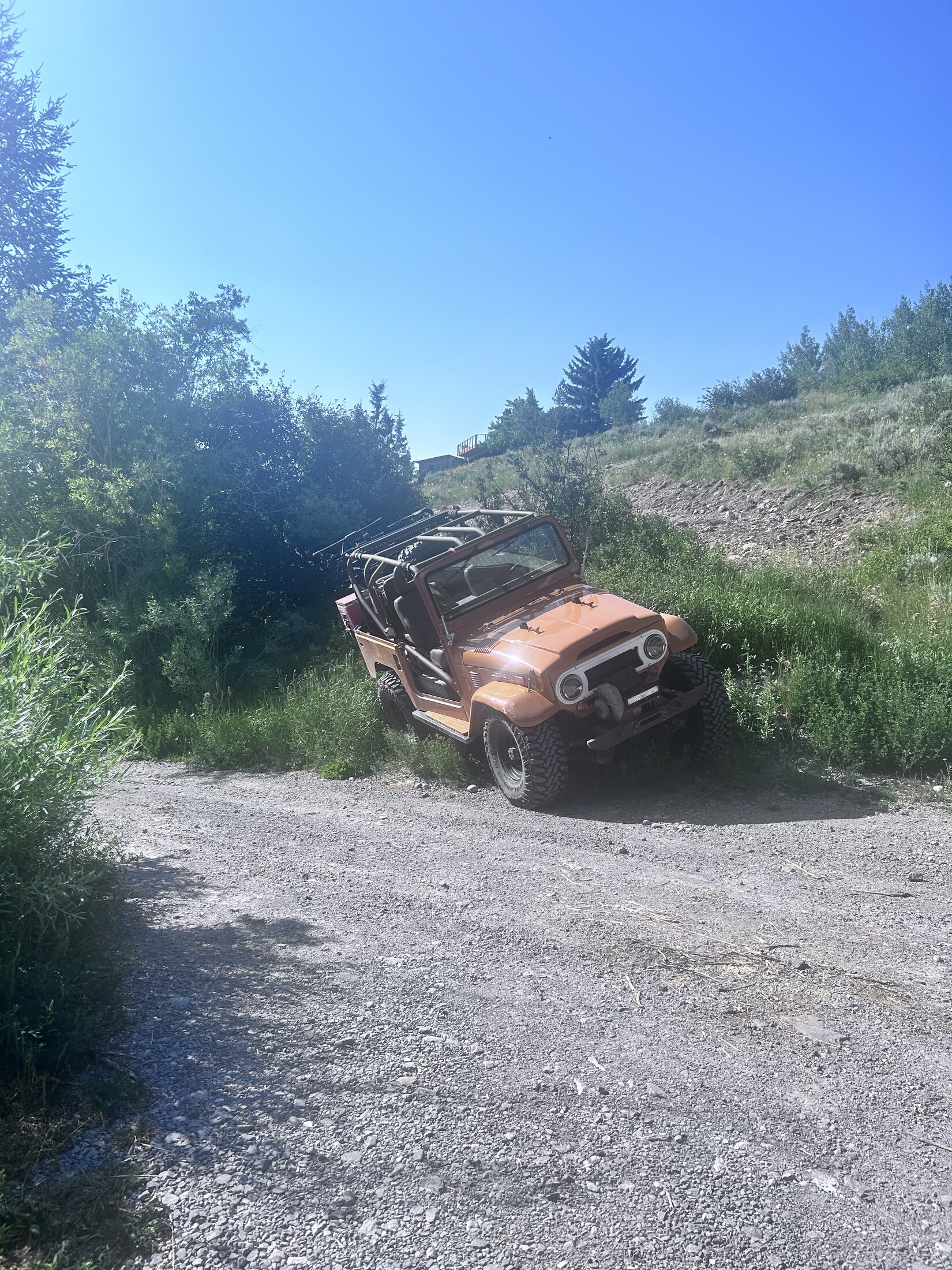

Wife’s been driving it more then me, so when she called at work and asked “what the most important thing in my life was?” I said the cruiser, figuring something bad had happened. After getting over me not saying her or the kid, she dropped that the cruiser had popped out of gear when she parked at the house. See, we live on a hillside and the house is at the top of the driveway. The driveway has a nearly 90 deg turn, which is where the garage sits. So my immediate assumption was that it had rolled down to the 75’ and imbedded itself in the garage. She countered “no it’s just on the hillside. At kind of a funny angle..” she sent me a picture. That’s a releaf.
I tell her to put it in low first and it’ll walk itself off the hillside. She’s to nervous to do that, she’s afraid it’ll cause damage.
When I got home it fired right up and walked off the hillside. Honestly, I’ve had it in much worse situations. She’s back to driving it while I’m at work…
