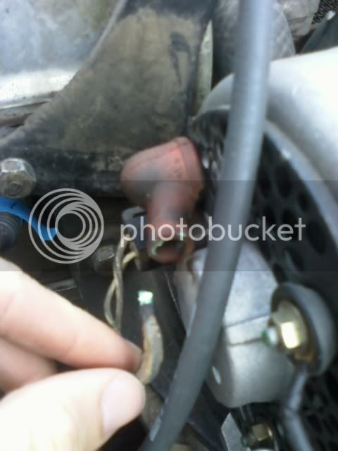

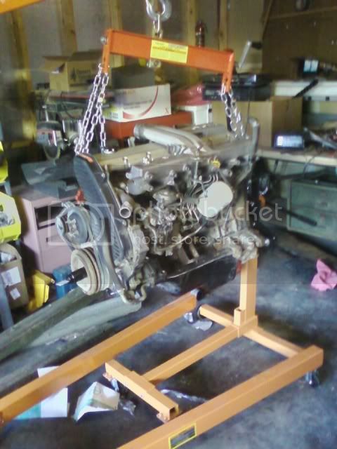

I finally got my 1HZ up on a stand, so I can start cleaning it up, and it appears that a 1FZ motor mount will work. And I got my splitcase this weekend as well. I also found out I had broken alternator wire, which was causing some issues. Lastly, I got a daily driver, so once I fix the alternator wire the forty is going into the garage and the work shall begin.
I guess that answers a few questions, eh?!

Very much, so and it also tells me its time for a new wiring harness, especially by going with the diesel, because I can get ride of so much of it.
What's under the red boot? Is is just a standard ring or is there a plastic connector into the alternator?
Also, when you go to rewire I have a bunch of Weatherpack connectors left over from my project. You can have what ever you need and I'll loan you the Packard tool to set them right.
It is a standard ring, so a super easy fix. The plug is fine.

The engine looks good, Paul! We are excited for your project, and look forward to hearing all about it as you proceed.
So am I. It has been a fun couple of days.

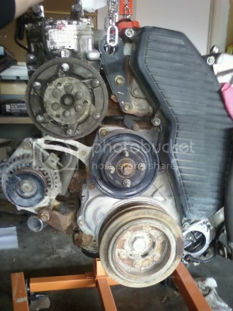

And an update for today.
I cleaned more of my 1HZ and started cleaning up my york compressor. It appears like it should mount up easily once I make it a bracket. There are several tapped holes in the block and head that I can use to attach the bracket. I am a little worried about the belts getting enough contact, so I might go out to the third pully ring. Further investigation needed.
I also turned over the engine by hand today and it turned over very easily. Lastly, I started taking apart the forty, which consited of me taking off the bumper. I can't take off too much because I need everything running as I clear up a couple electrical issues and then away we go with dismantling.
