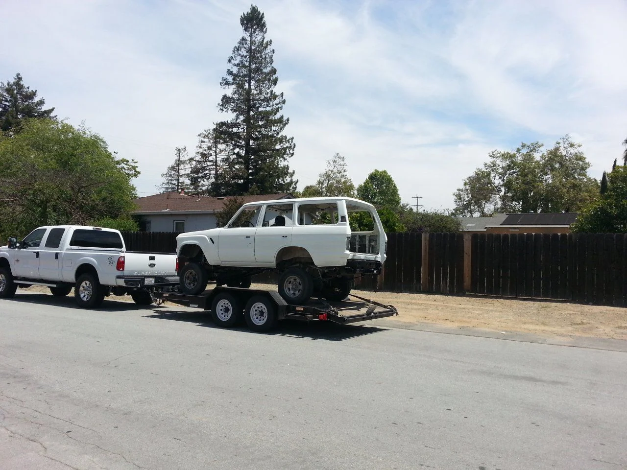

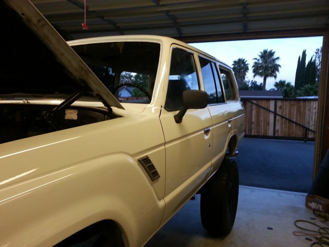

So I just got my Cruiser back from the paint shop. I'm not super impressed with the quality of the paint job, but seeing as this is a combo Expedition Rig/ Daily Driver, I didn't really want a Concourse-winning paint job.
I got a hold of the body shop owner and he's going to refund me some money so all is well. More money for parts!
Returning to its lair...

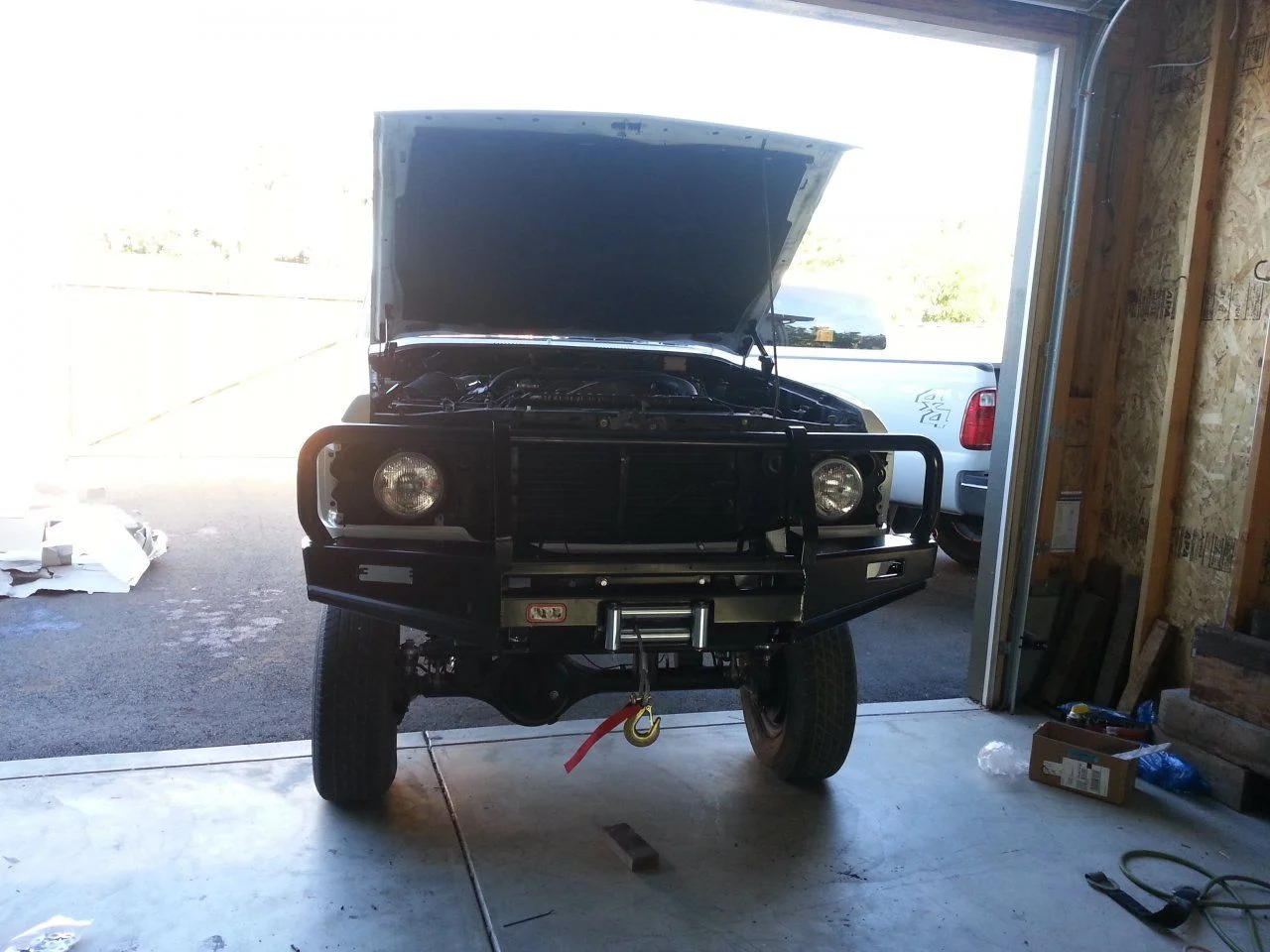

ARB Bumper installed with a HF 12K winch. That is one heavy SOB to manhandle by yourself - or as I call it: Life CrossFit

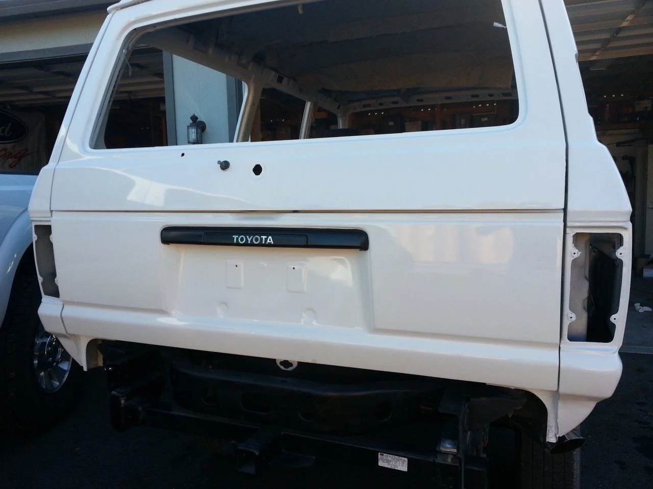

Blacked out Toyota Logo:

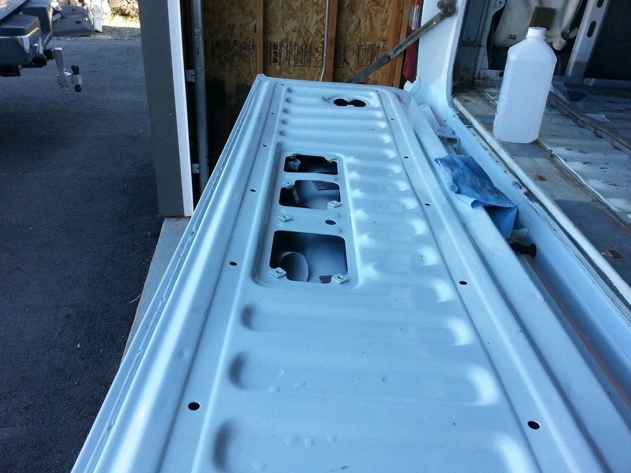

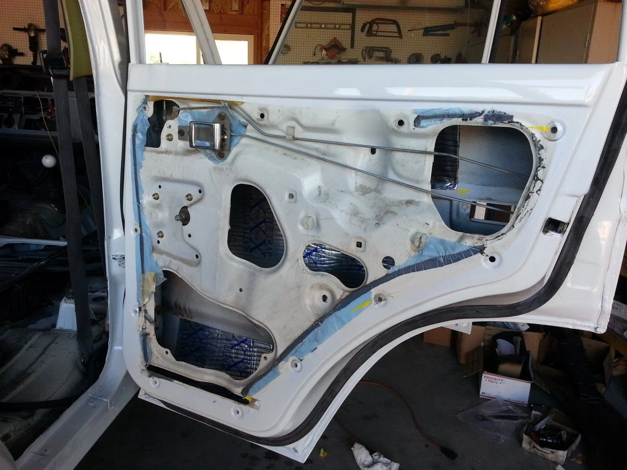

Imitation Dynamat (FatMat) on all doors, quarter panel and tailgate:

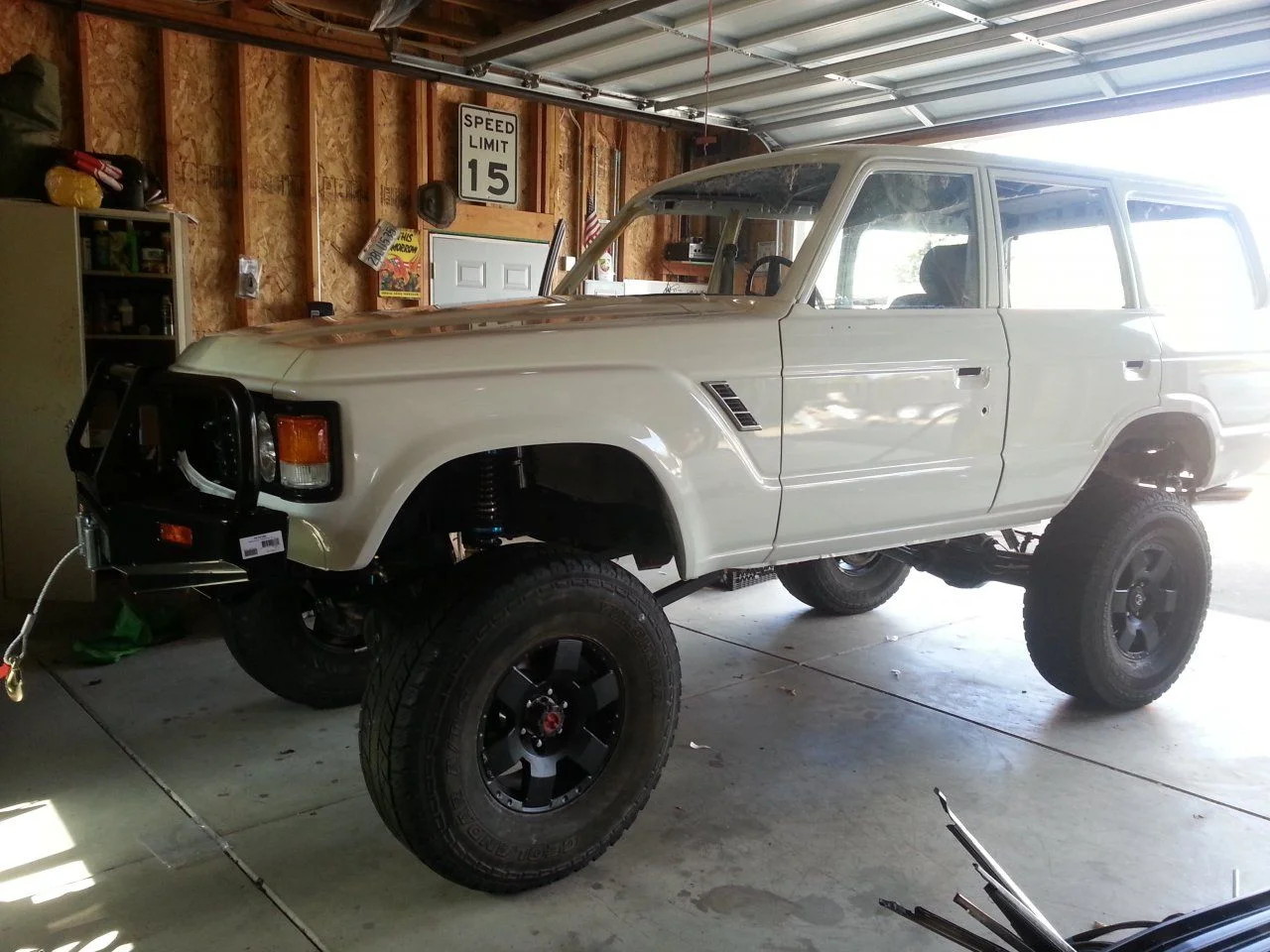

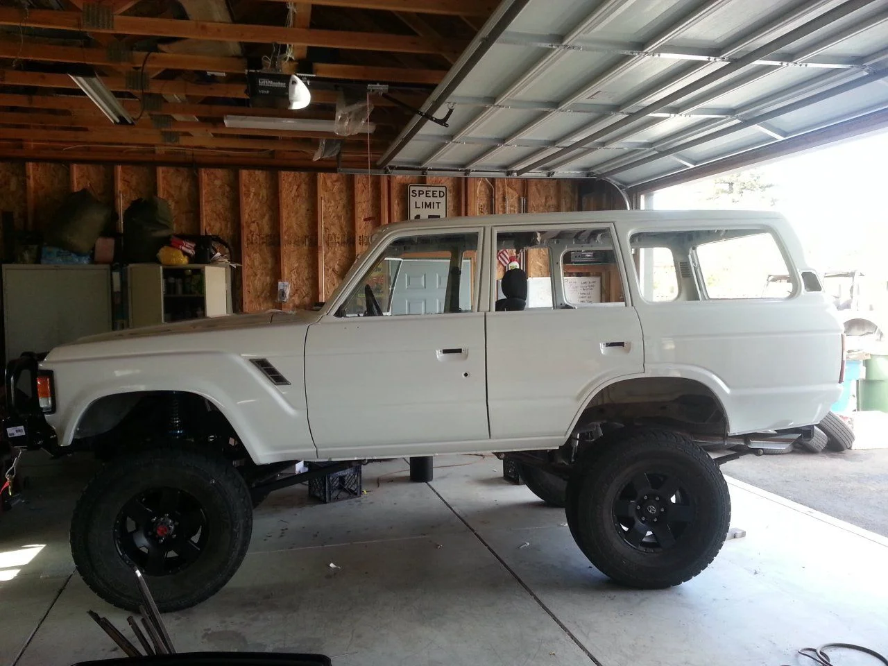

I got my 37s on my FJ Cruiser wheels on 1.5 spacers. All seems to be well. I need longer sway bar end links however (which I already knew).
It's sitting a bit high in the back. It still needs all the glass, carpet, MLV, seats, stereo, sliders, panels and bumper which should sink it down a few inches.
I think you are right about the back end coming down with all of that weight. I'm always surprised at how much mine squats with camping gear and 4 adults.
That's my guess. There's at least 200-300 lbs of interior stuff going into this so it should come down a bit. Plus I need sliders / side steps because it's kind of tall.

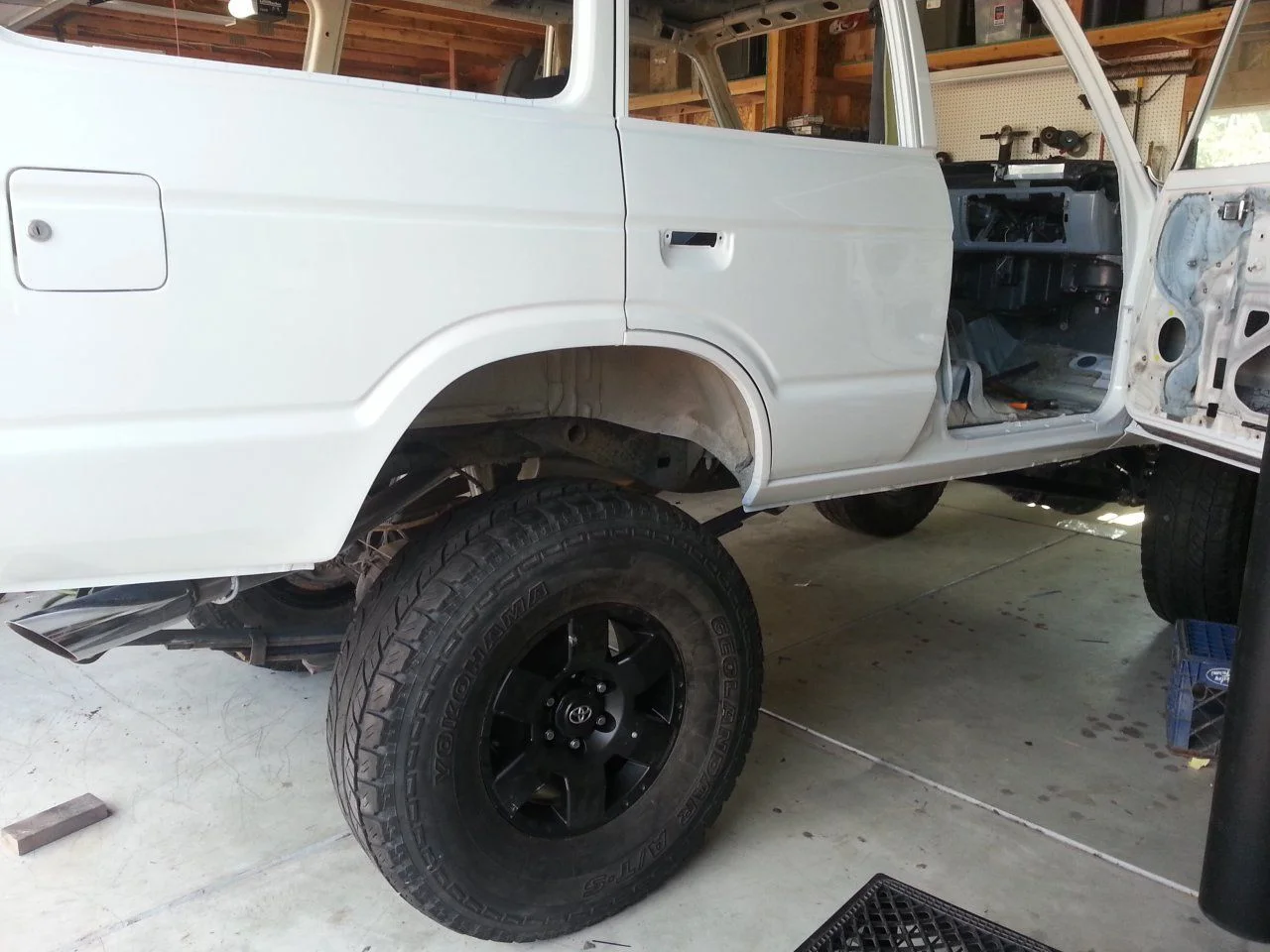

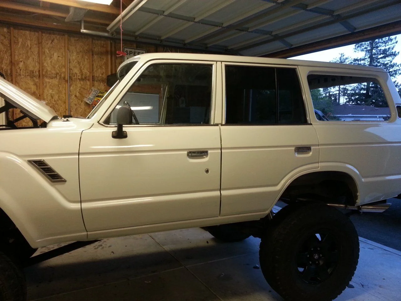

I added some more stuff to it today. I finished off soundproofing all the doors with MLV which was a heck of a job. The doors sound SOLID now. It's pretty awesome how much this stuff works. I also plan on adding MLV to the interior panels as well so this thing will be whisper quiet on the road.
I have all the rear windows tinted, so now comes the process of installing all of the door glass and trim. It really wasn't too hard to do on the front doors. The rear doors are kind of a bitch to do - but I got them done. I also installed the mirrors and all the locks / latch assemblies around the 'Cruiser.
My next order of business is to work on putting the headliner back in the thing so then I can put the glass in it.

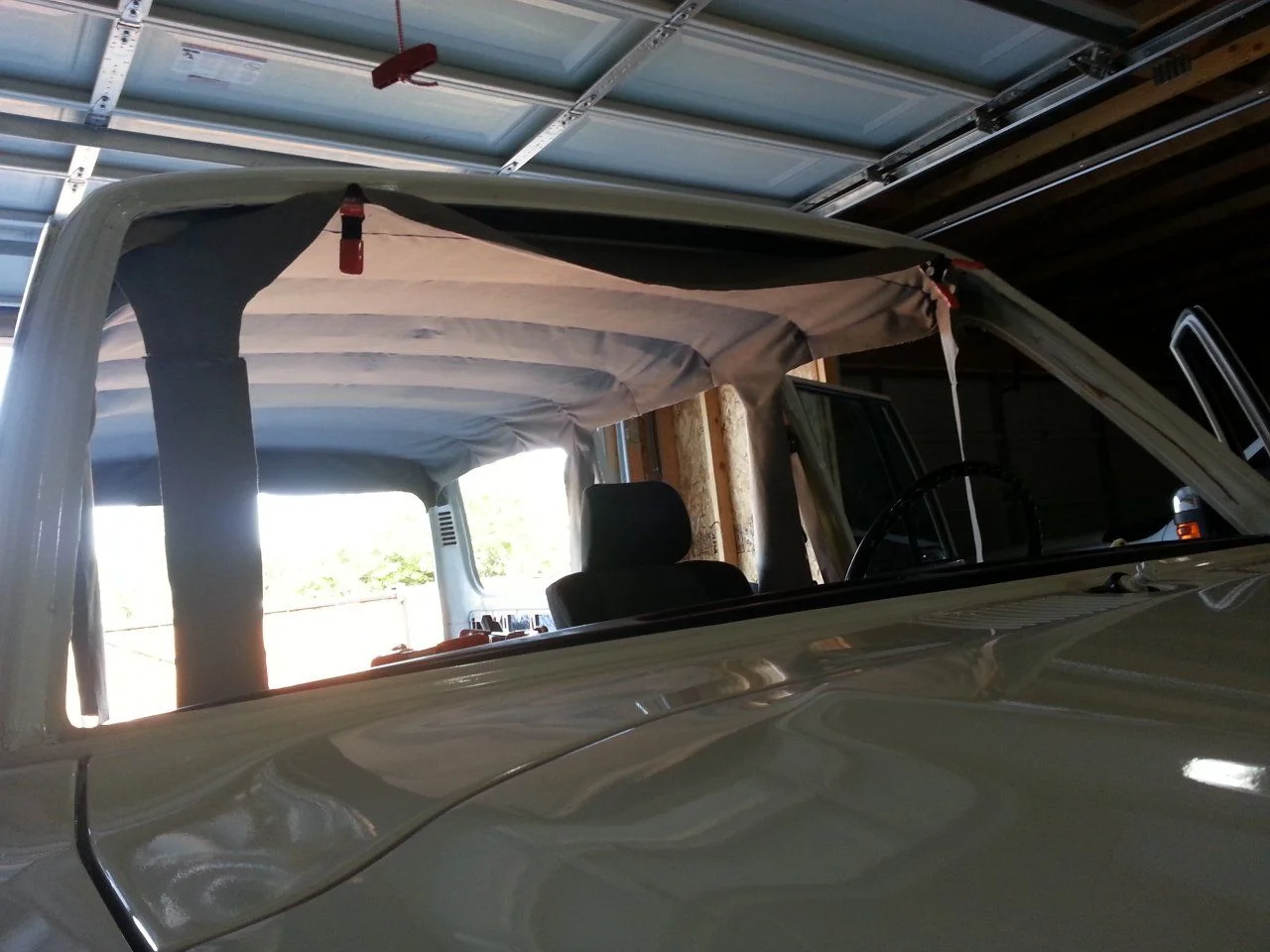

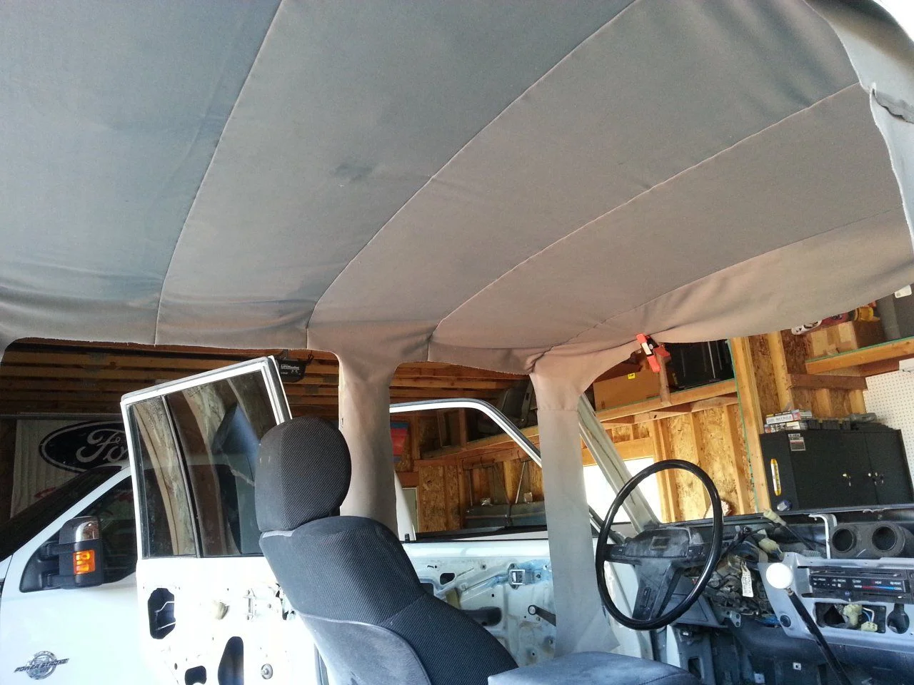

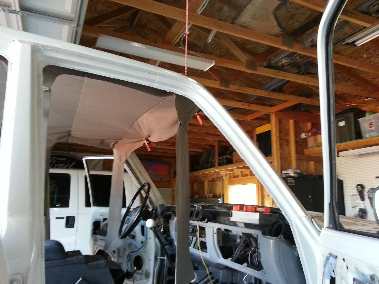

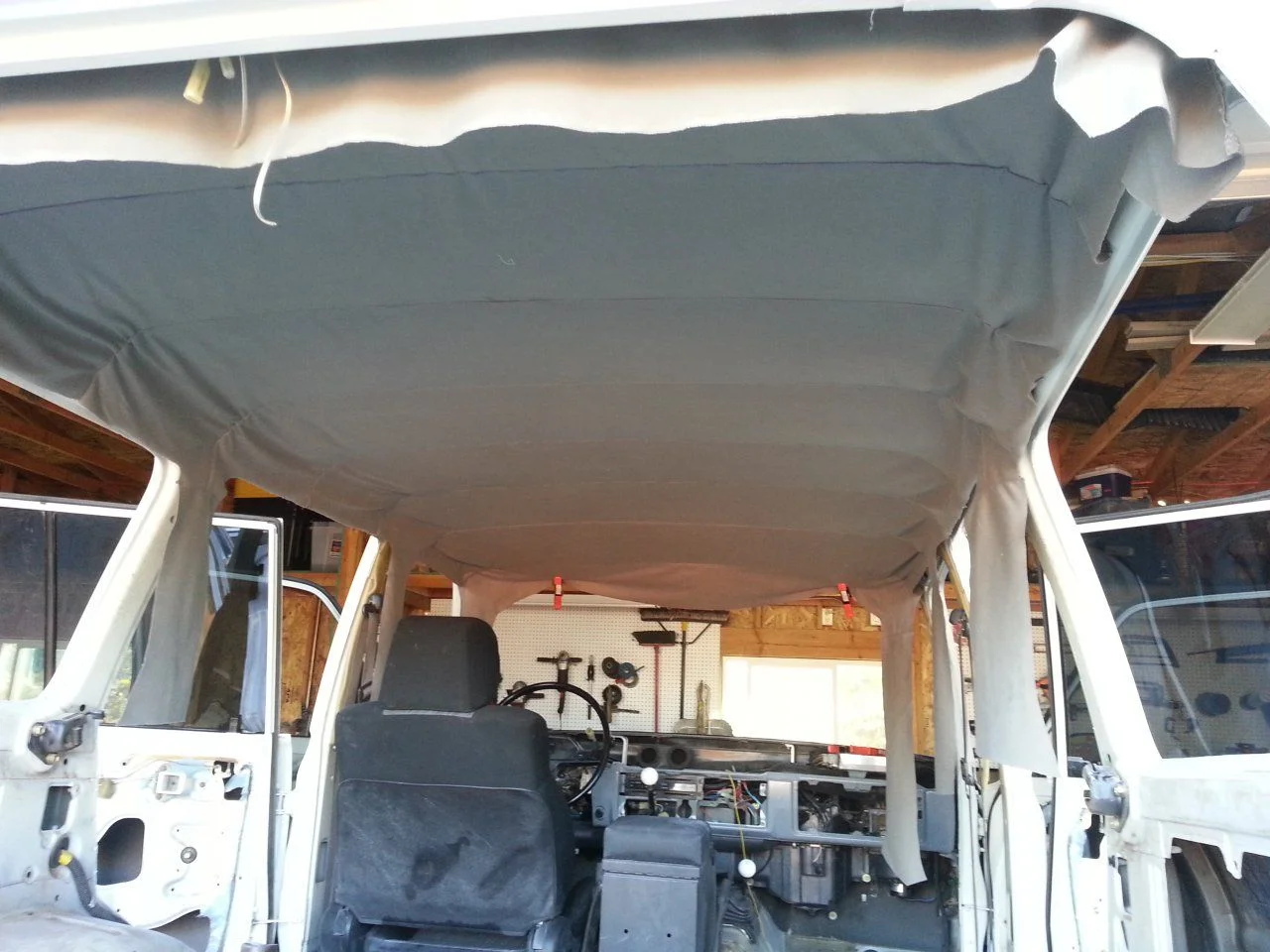

I've now began the process of putting in the headliner - since this is really what getting this thing roadworthy is now contingent upon my headliner installation skills.
Once I get that done, I can throw the dash in, get the A/C functional and start on the carpet.
