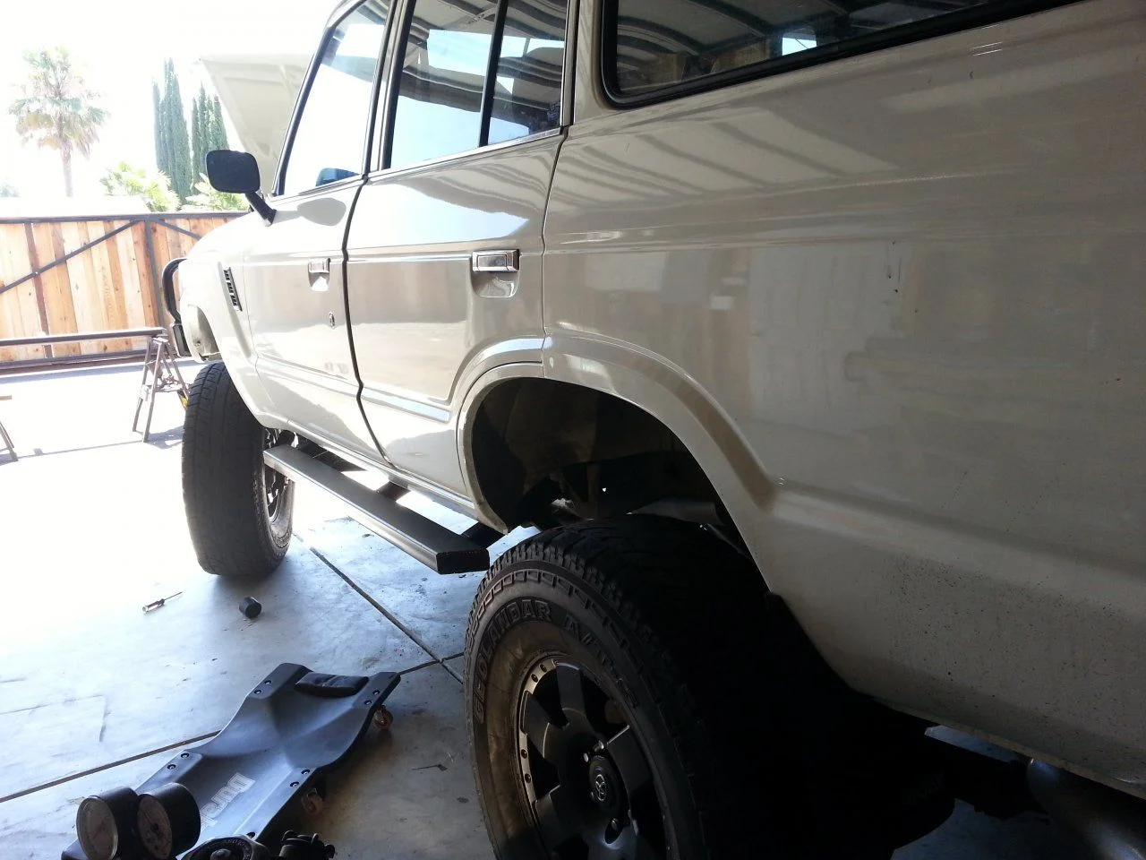

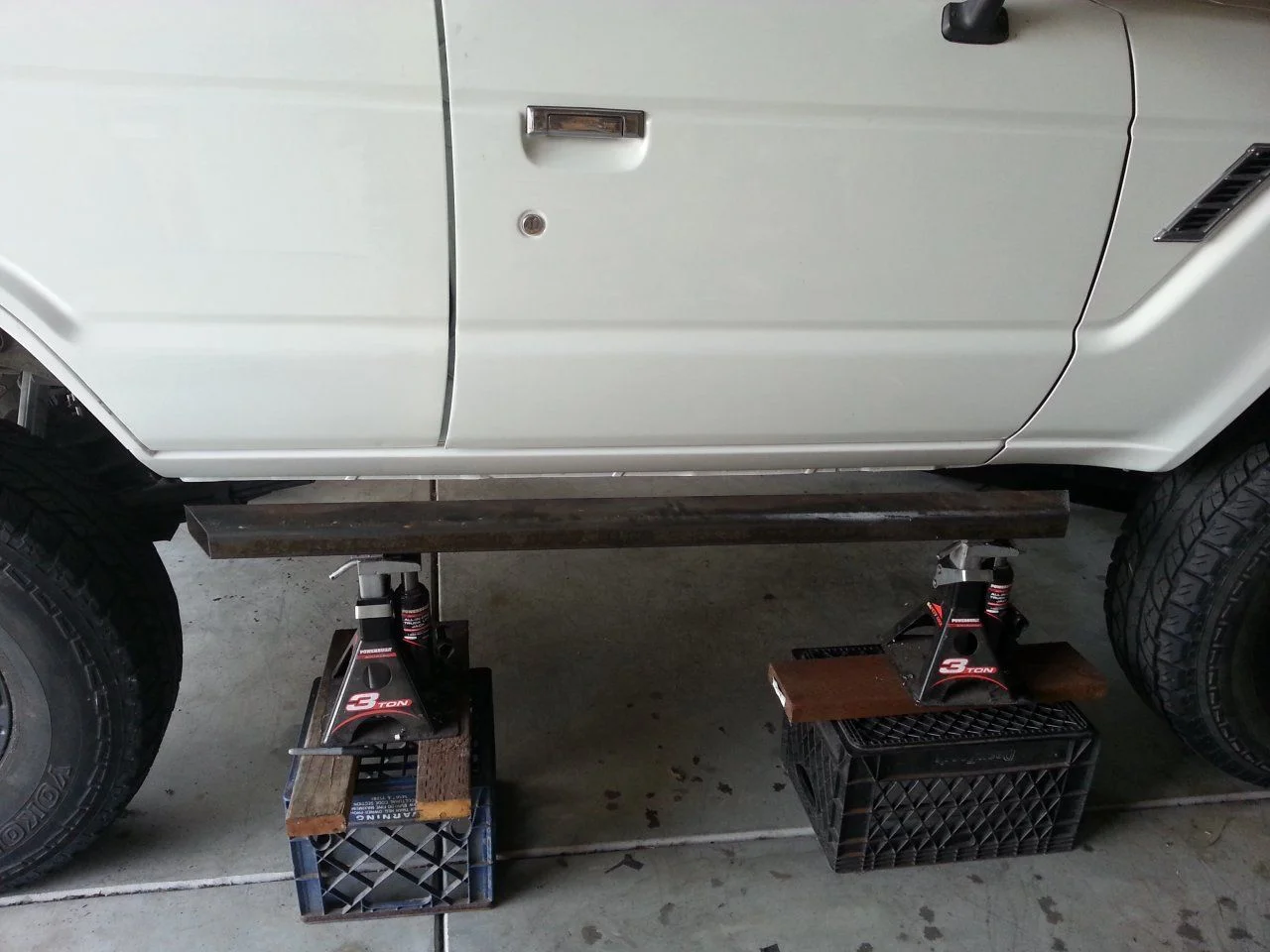

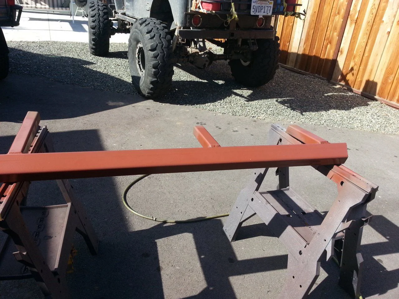

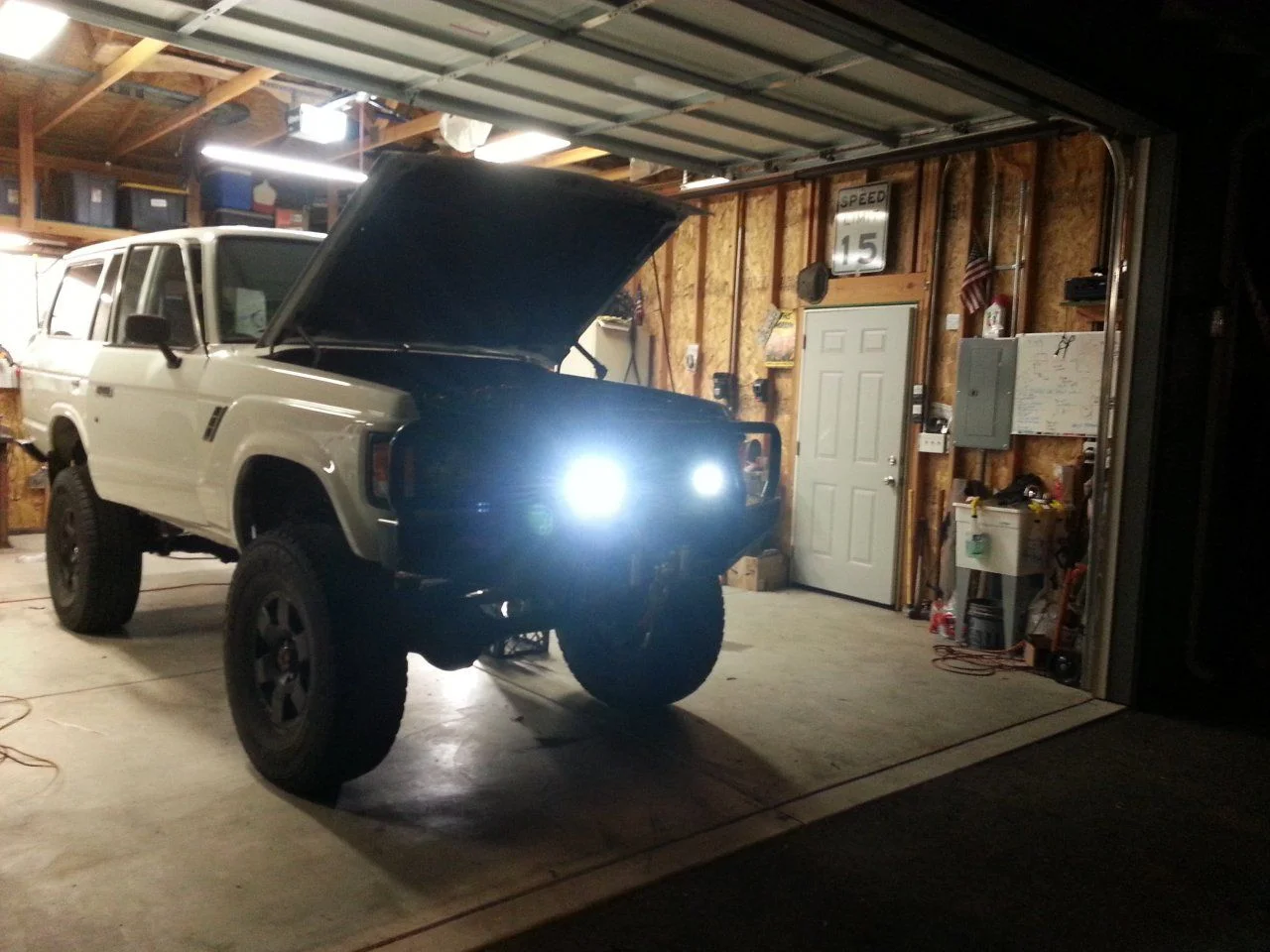

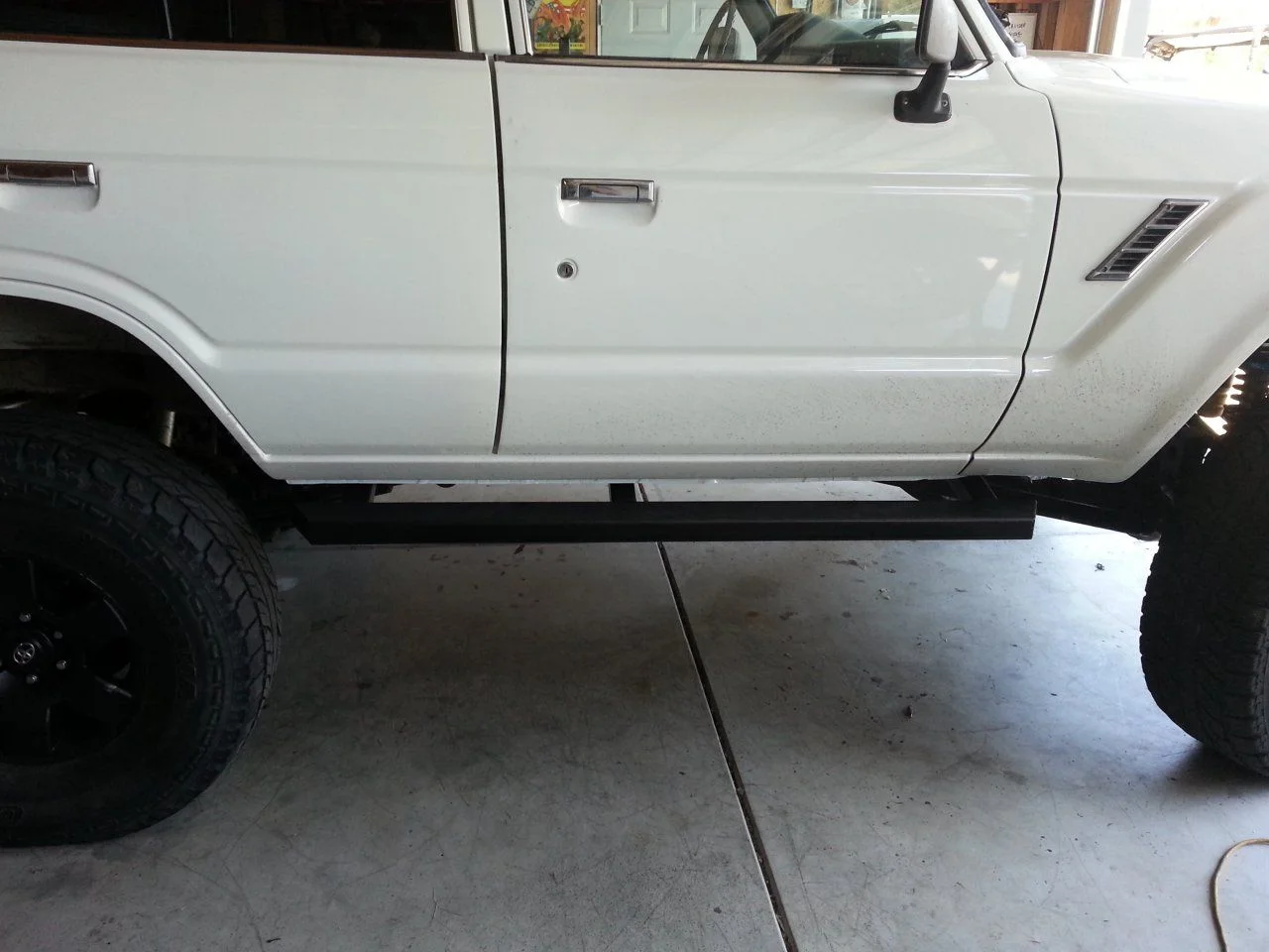

Today I finished up my sliders and mounted my offroad lights. I bought these $25 Amazon specials and wired them to a relay. I have to get under the dash and wire in my secondary rear defrost switch to activate the lights. I typically like to wire lights to the headlight feed so turning off the headlights turns off the auxiliary lights.

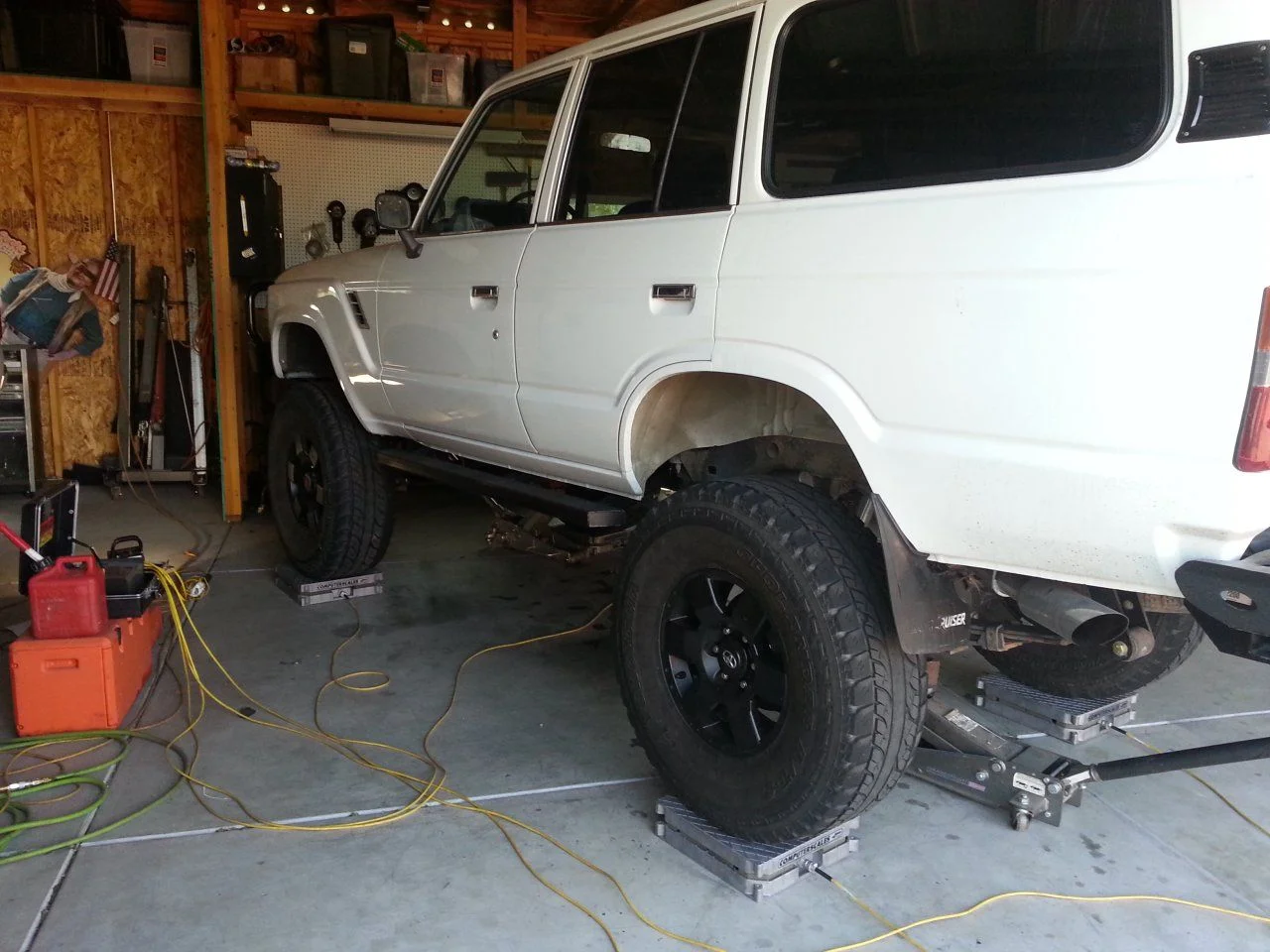

I'm sure this has come up multiple times in this thread: How much does project Space Shuttle weigh?
Here's the stats:
  • 5.0L SEFI V-8
  • ZF S5-42
  • Dana 300
  • 3 link front end with Barnes 4WD Enduro Joints
  • 14" dual rate coil overs
  • TK1 Customs Sway bar
  • Chevy 63" rear springs
  • Recentered FZJ-80 rear axle
  • Stock FJ60 front axle
  • 37 inch tires on stock FJ Cruiser 17" wheels
  • Stock frame
  • Full treatment of MLV / Dynamat
  • Full length rock sliders
  • ARB front bumper
  • 12K HF Badlands Winch
  • Custom rear bumper
  • Class 3 trailer hitch
  • Stock tank, full of fuel
The Challenge
Whoever gets within 25lbs of the actual weight will win. Extra prize for getting the front / rear weight balance percentage correct.
Example of a guesstimate
1000 lbs | 10/90%
The Prize
I will mail the winner a 40 or a bottle of Night Train - winner's choice. Extra prize for getting the weight and bias correct.
End
The challenge ends at 9:00 PM tonight.
P.S. - if you're underage or a recovering alcoholic, I will send you something non-alcoholic or an A/C amplifier. Perhaps an assortment of random metric fasteners.

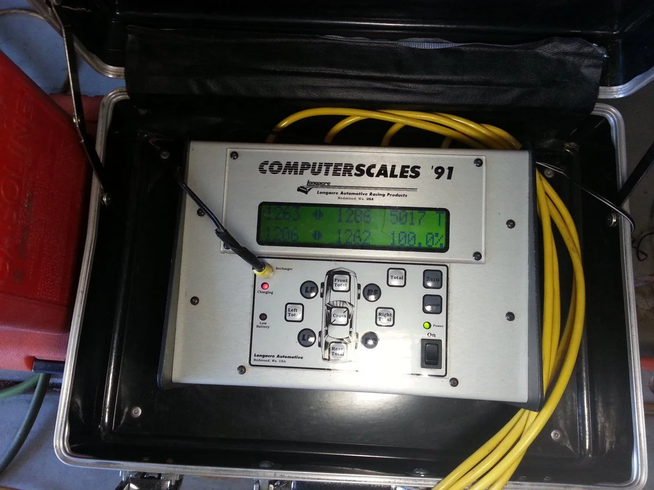

To show I've actually weighed it legitimately:
5246 lbs. 59/41 front /rear

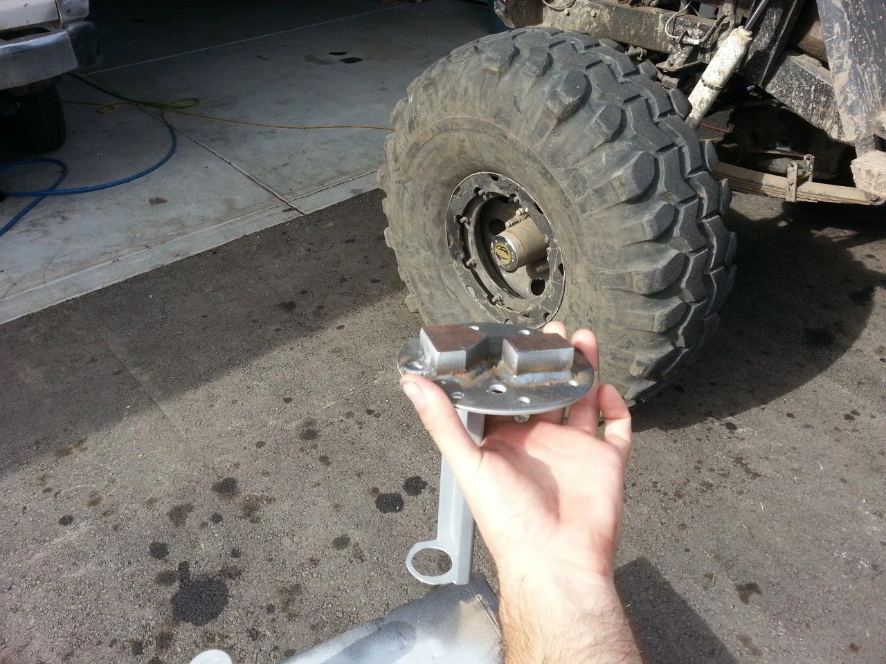

I built a new in tank pump sending unit by using A&A Manufacturing spring plates. I didn't take detailed pictures, but I used a round 5.5" spring shim combined with a similar spring shim with a 3.5" hole in the center to make the reinforcing ring. I then made a beef pump bracket and installed the thing. I will add more details in the future.
This is awesome. With the popularity of a TBI or 5.3 conversion, I'm surprised a Mud vendor hasn't picked this up...hint...hint.
