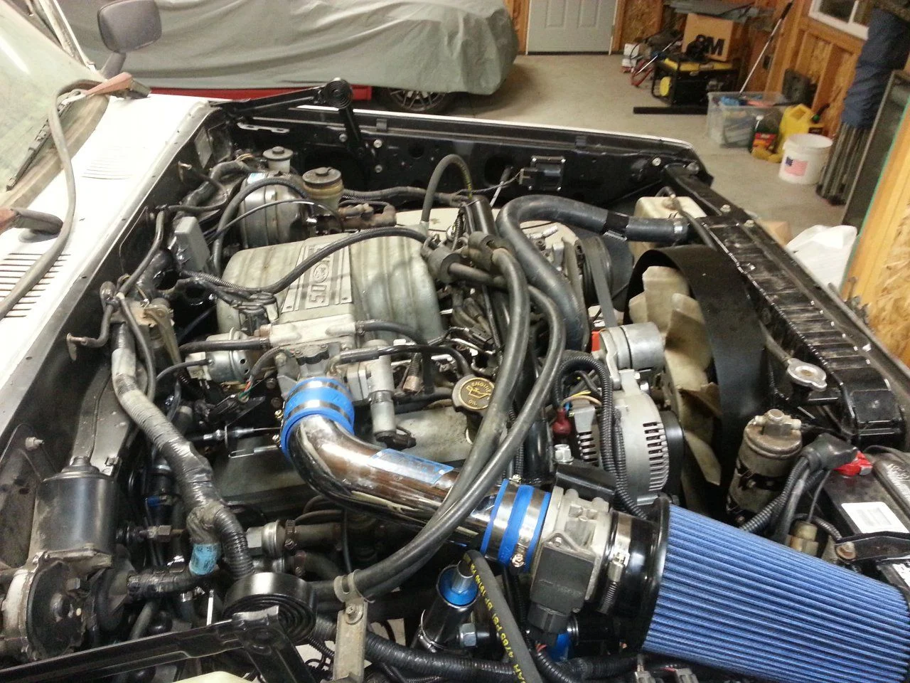

I bought a CARB approved air intake for the Mustang since it fits a bit better than the stock box.

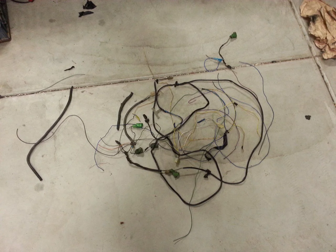

The wires removed from all that stock smog crap:

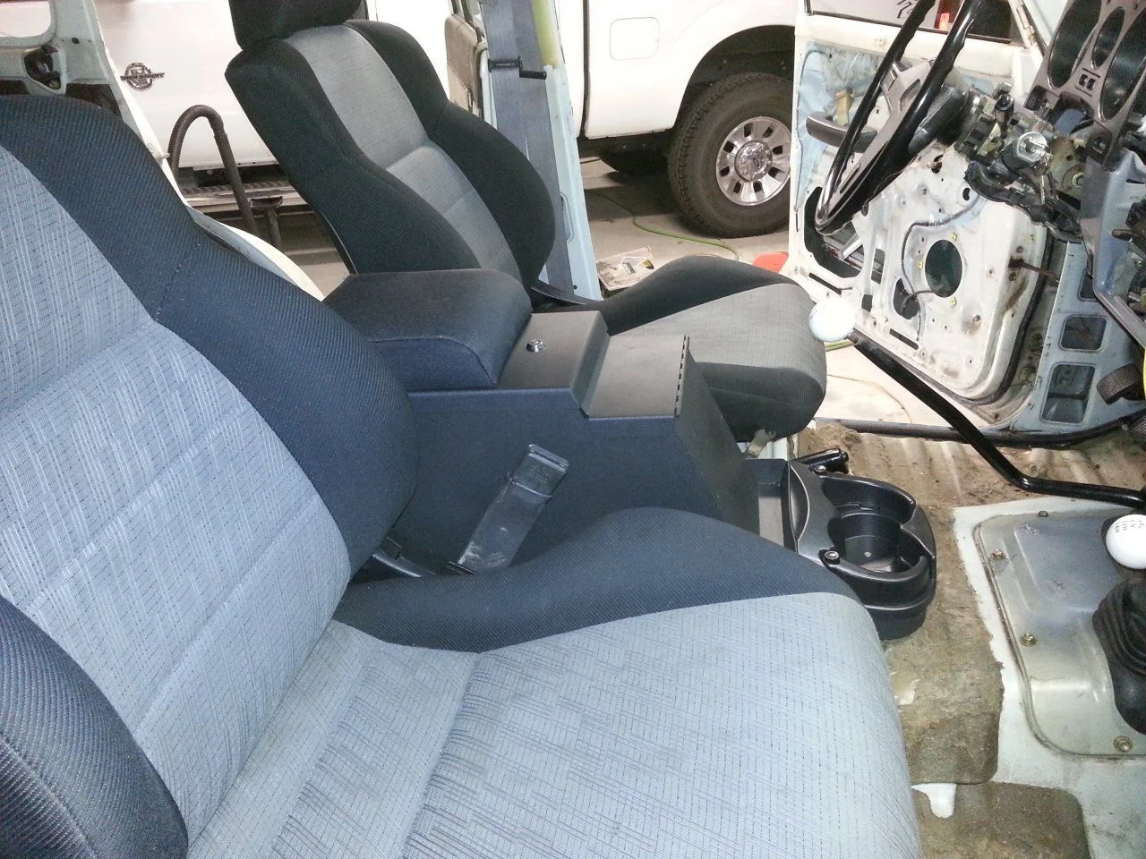

Added some 2005 Celica GT seats to replace my s*** stockers and built some brackets for them. Added a YJ center console to replace my broken stock one.

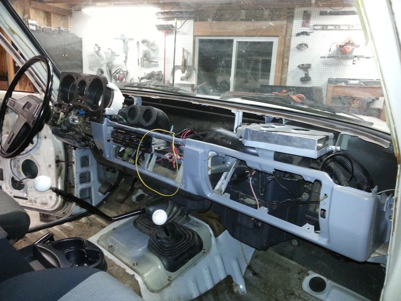

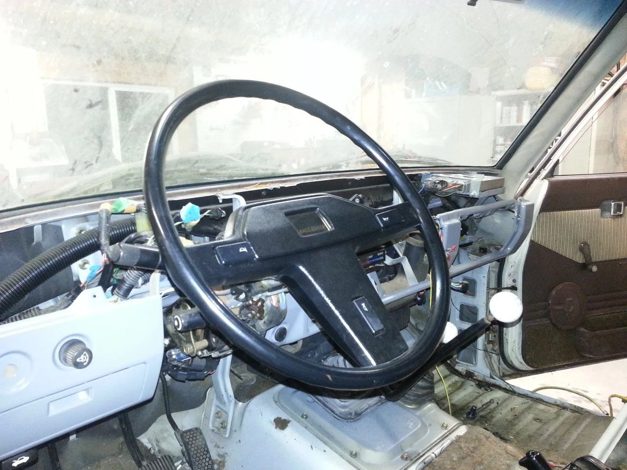

I took the steering wheel and column completely apart and washed them for days to get the grime out. Then I dyed them to gloss black.

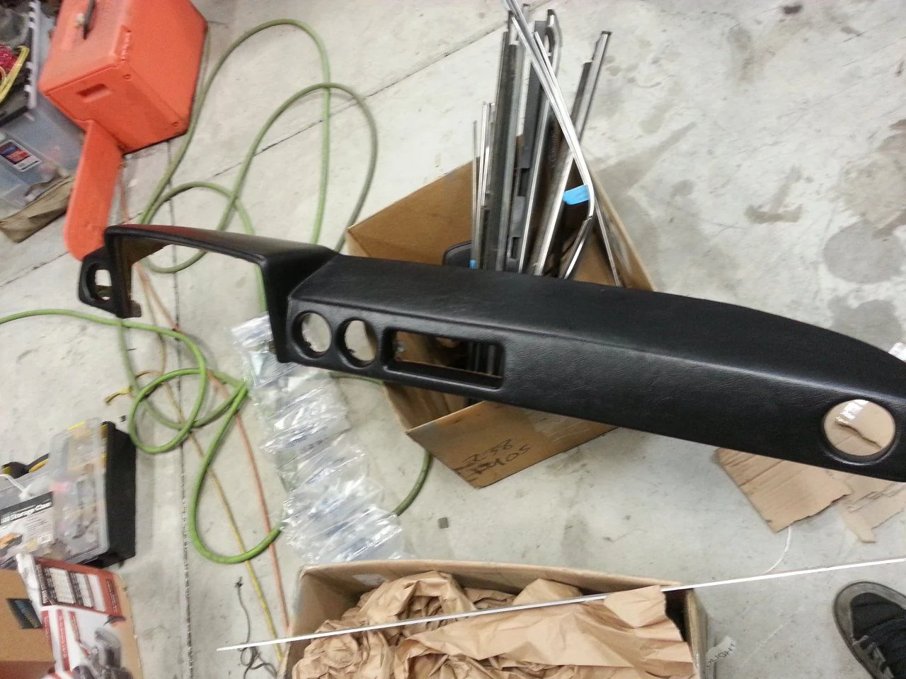

Repainted dash and shifters mocked into place. You can also see where the ECU is mounted in the stock single speaker location.

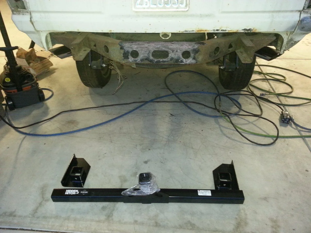

No one seems to offer a hitch for this thing, and I didn't want one integrated into the bumper for multitudes of reasons. Did I mention that everyone who sells a rear bumper for this thing wants a god damn fortune for one?
I went onto E-trailer and ordered a DIY RV class 3 hitch and adapted it to my frame. It turned out very clean and only cost $203 shipped. The part no. is 82200 from etrailer.com . I do plan on towing some stuff with my Cruiser in the future.
Hitch laid out.
Fitting the hitch (the white stuff is rust converter).
Bolted on (I knocked off that sharp edge but didn't snap a picture)

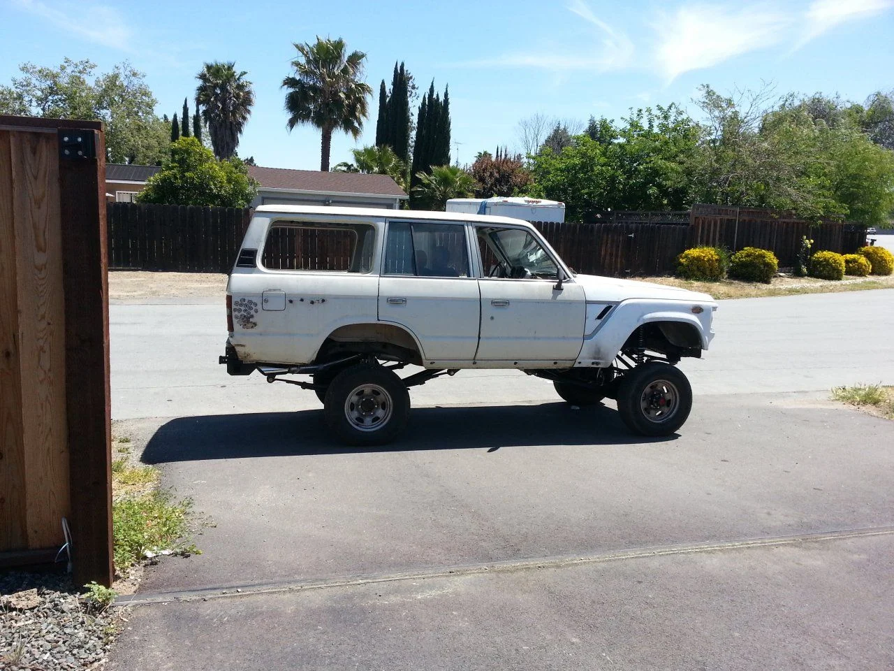

Side view of my multi color no windowed cruiser.

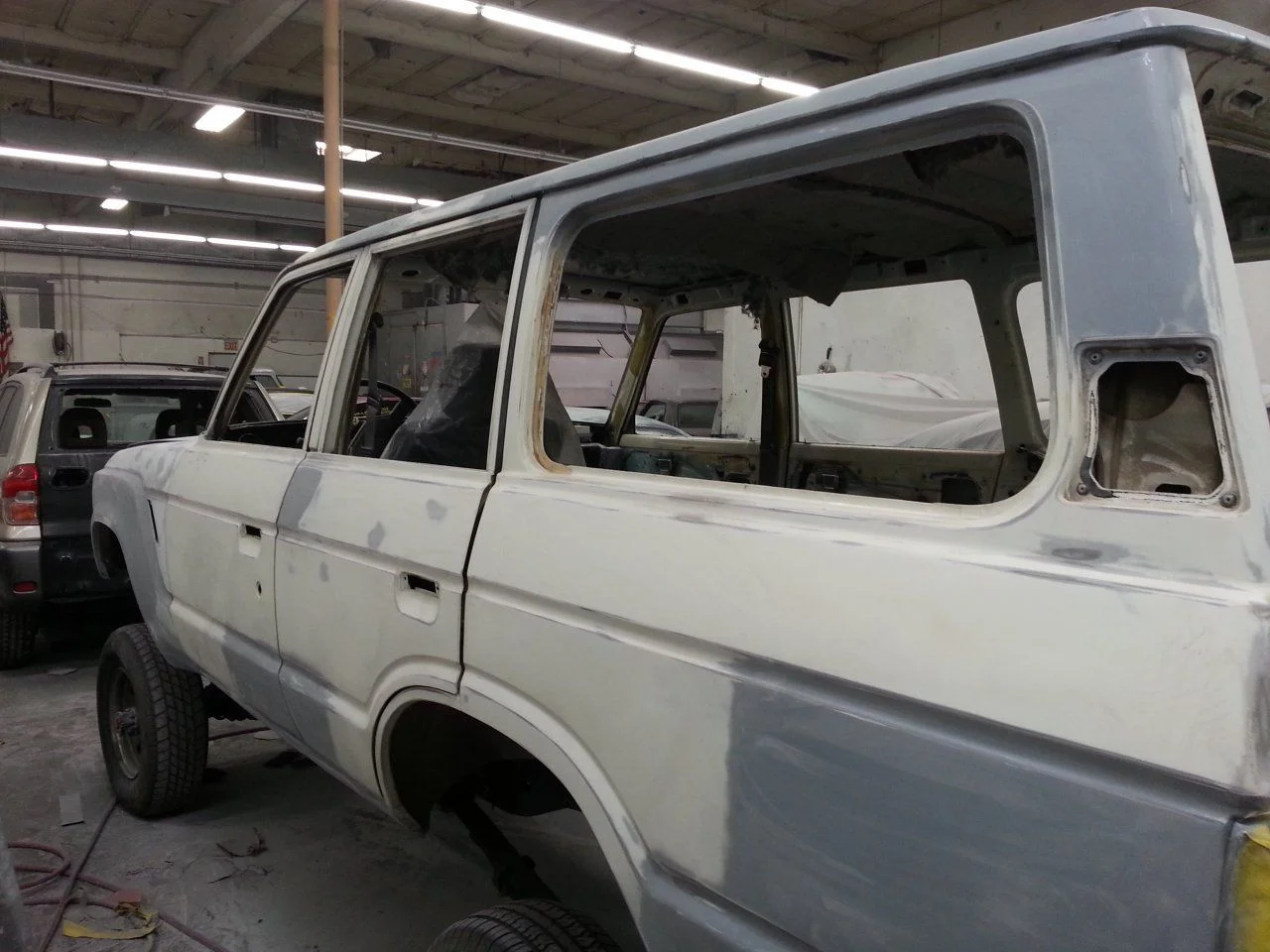

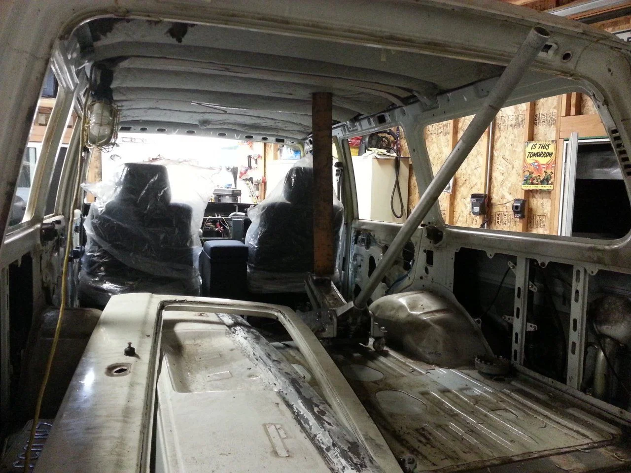

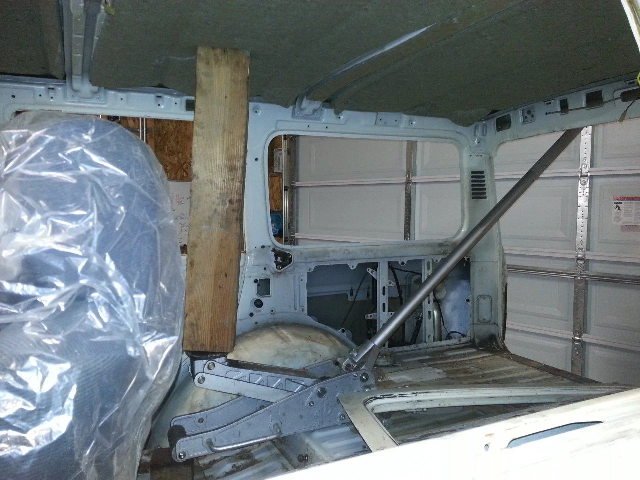

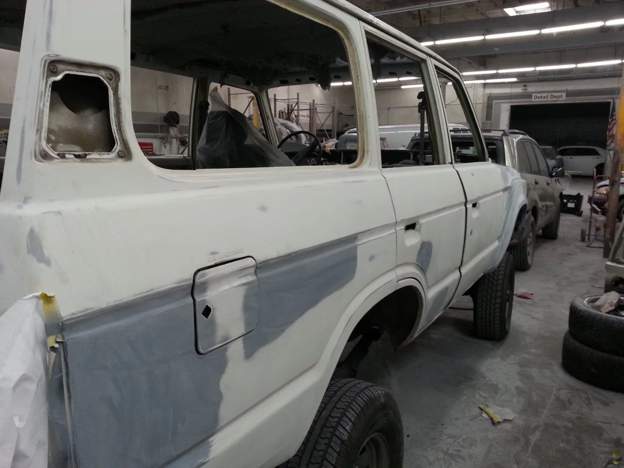

As noted before, the previous owner used to stand on the damned roof and caused quite a bit of damage. I noticed that all of the roof cross members were bent down about 2 inches because of his stupidity. I took my floor jack army to get the roof back into shape.
Then the thing was off to the paint shop.

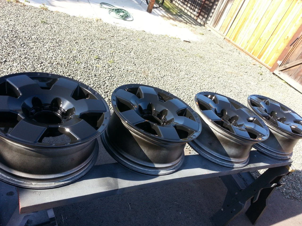

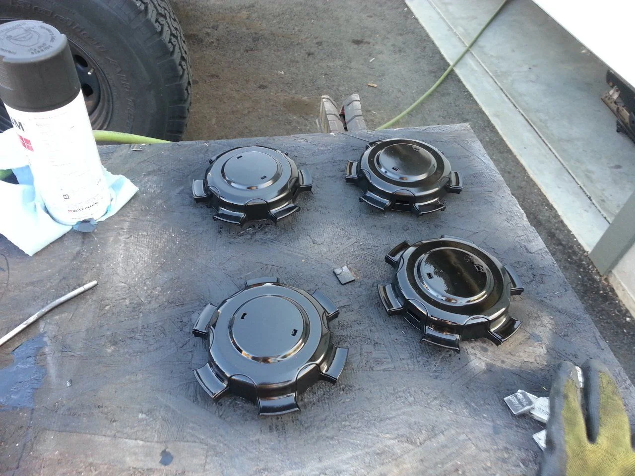

While it's interned there, I found a set of FJ Cruiser AL wheels with spacers for a good price. They had some scratches on them, so I opted to paint them semi-gloss to match everything else.

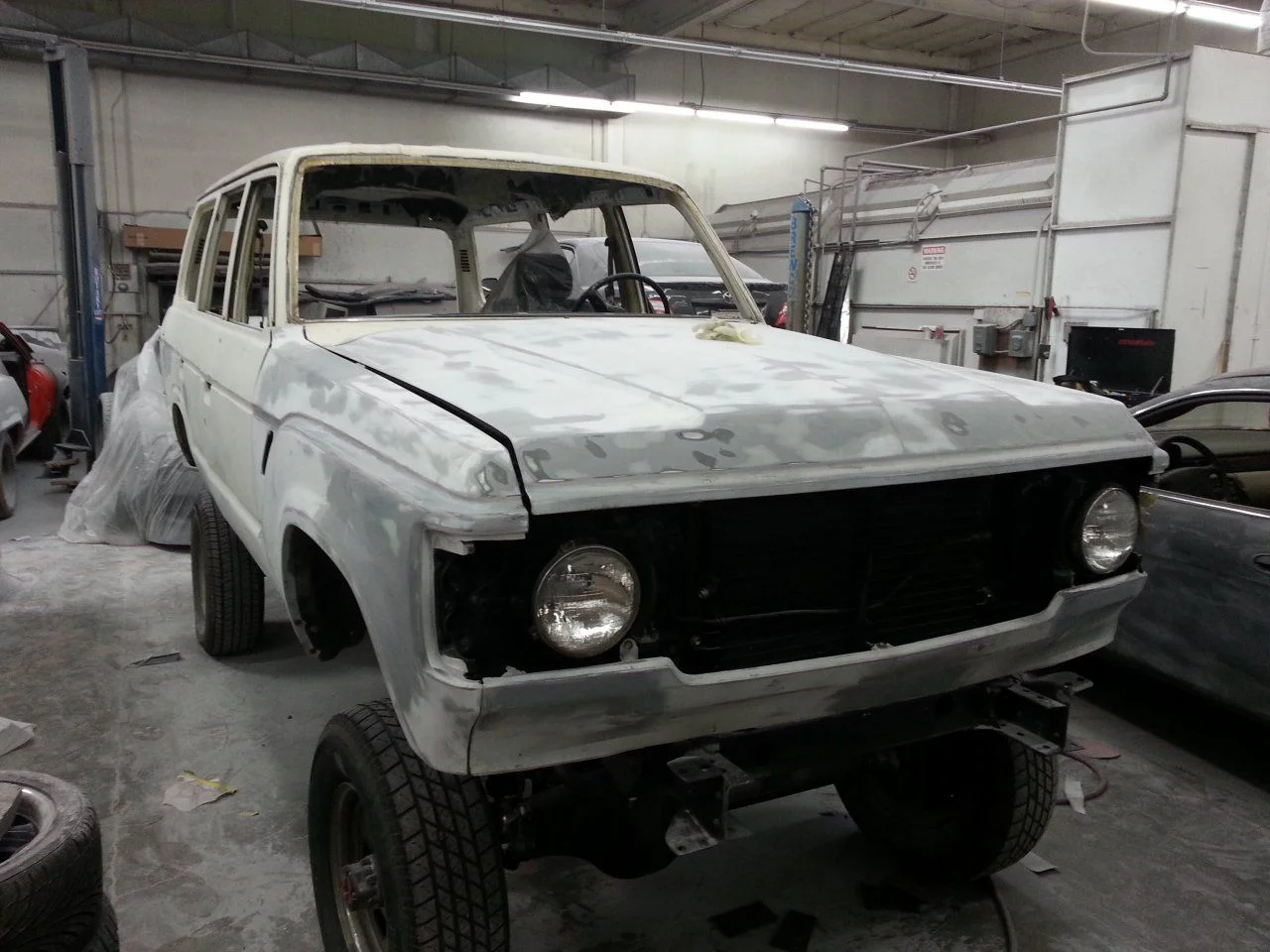

Here it is at the paint shop. All the body work is finished.
