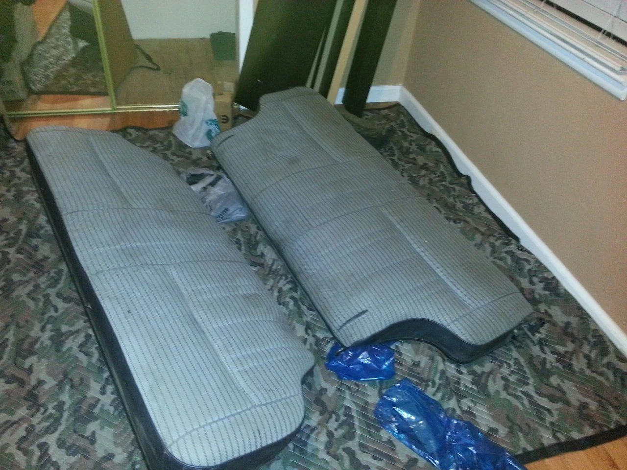

This is the only part of the Space Shuttle still in my soon-to-be guest room. I also discovered that I have a Stainless Steel barbecue in there as well.

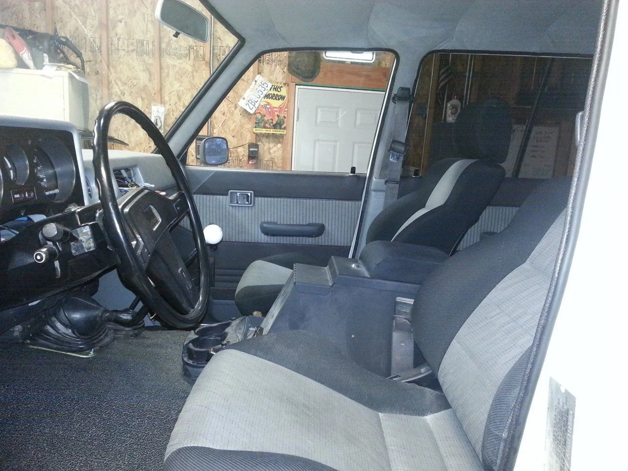

I finally put the dash back in. I bought a $60 cover from Amazon a few months back and it actually turned out quite nice.

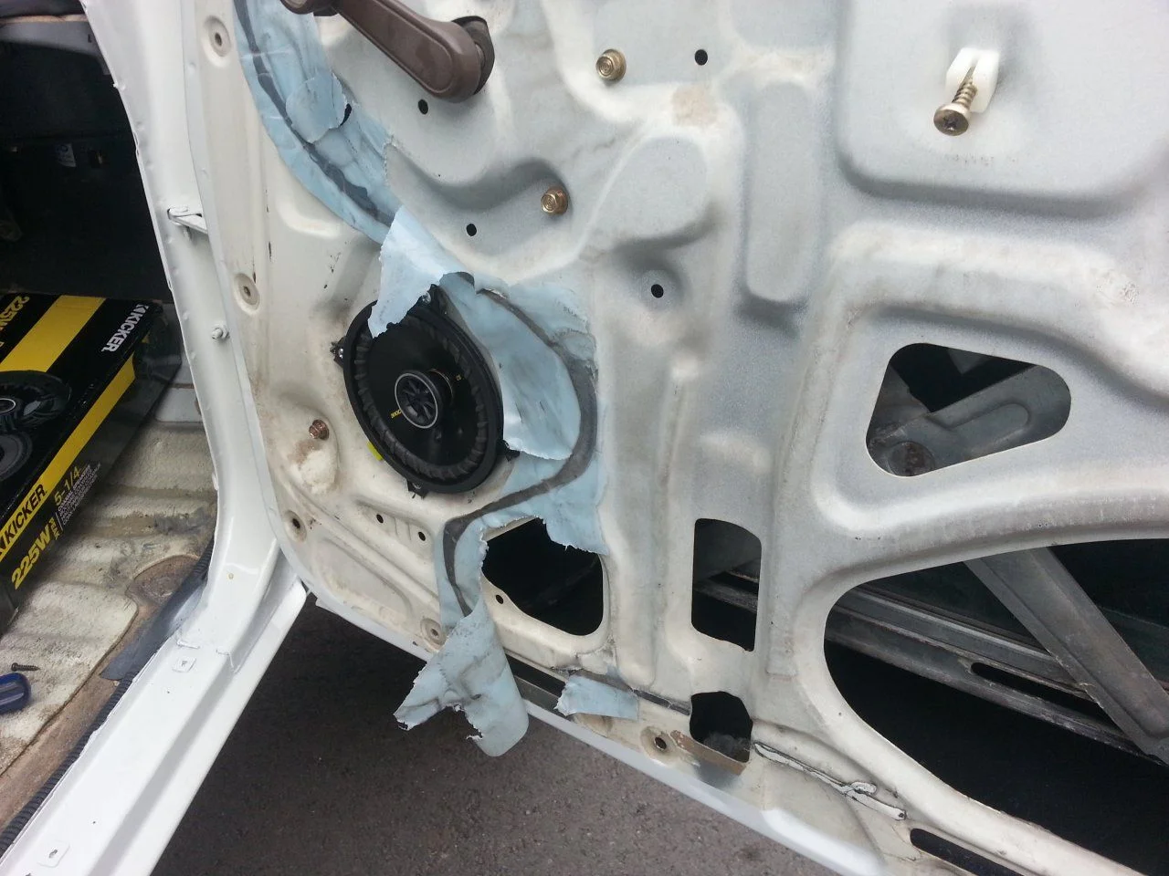

I found a set of door speakers that fit my stock location. They are Kicker audio 5.25 speakers. The previous owner had hooked the speakers to the door panels (instead of the door sheet metal) and the weight of the speaker simply tore the door panel. I like that these look stock. I have already Dynamated and Lined my door with two layers of MLV / Closed Cell foam to insulate and isolate any road noise. I got the driver's side door panel on, but haven't done the passenger side because I need to make a new latch rod since the body shop broke / lost mine.

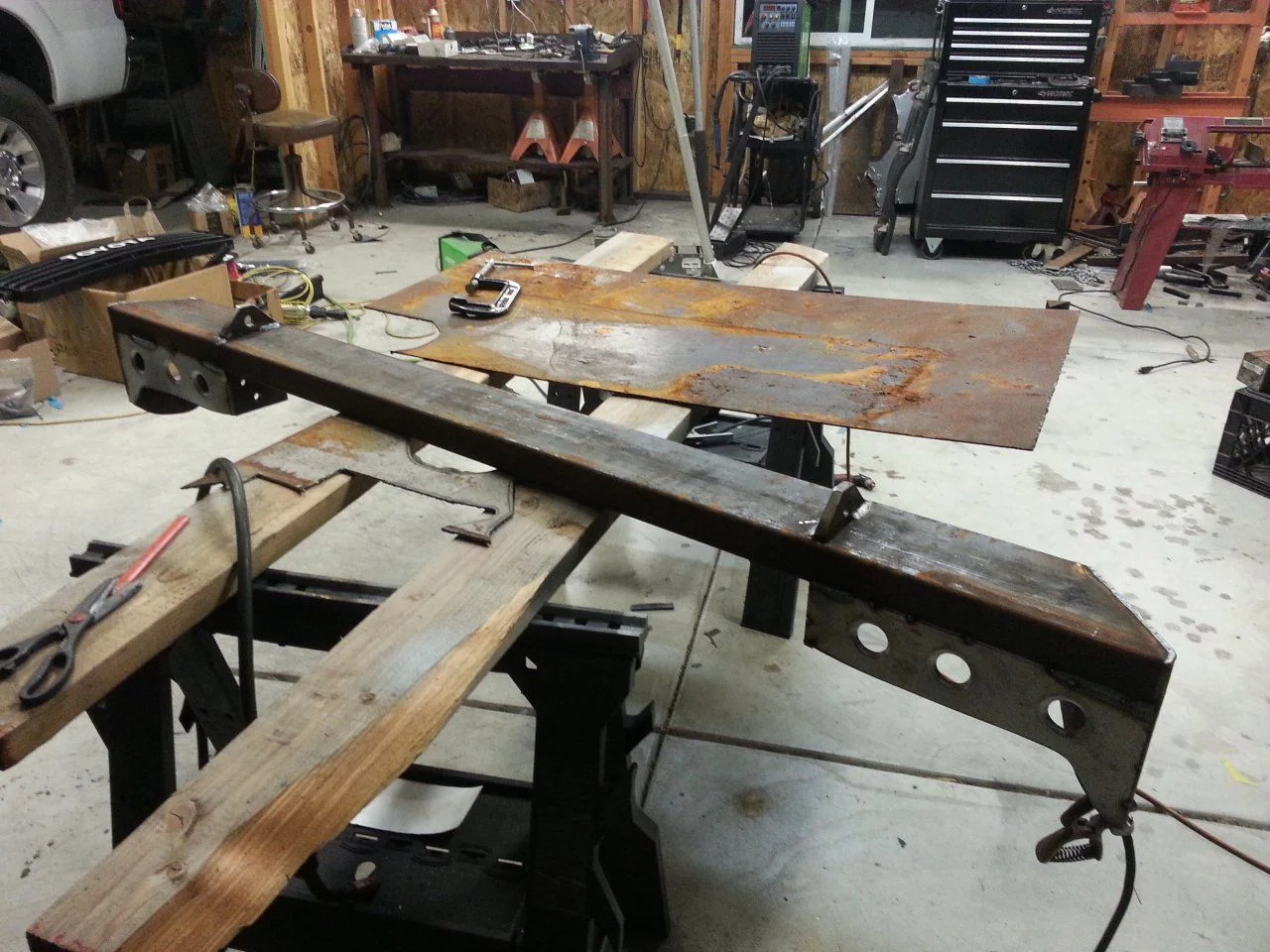

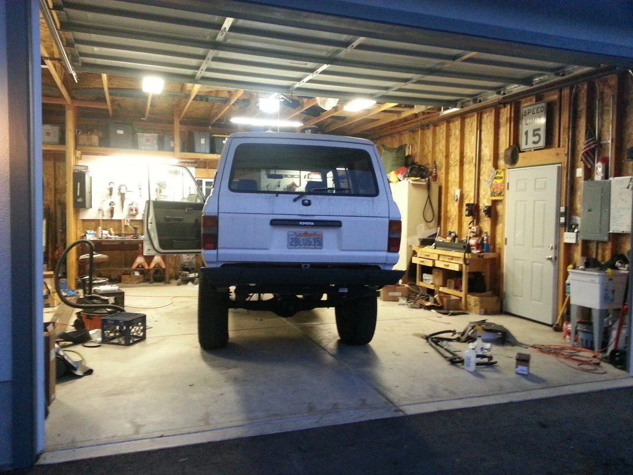

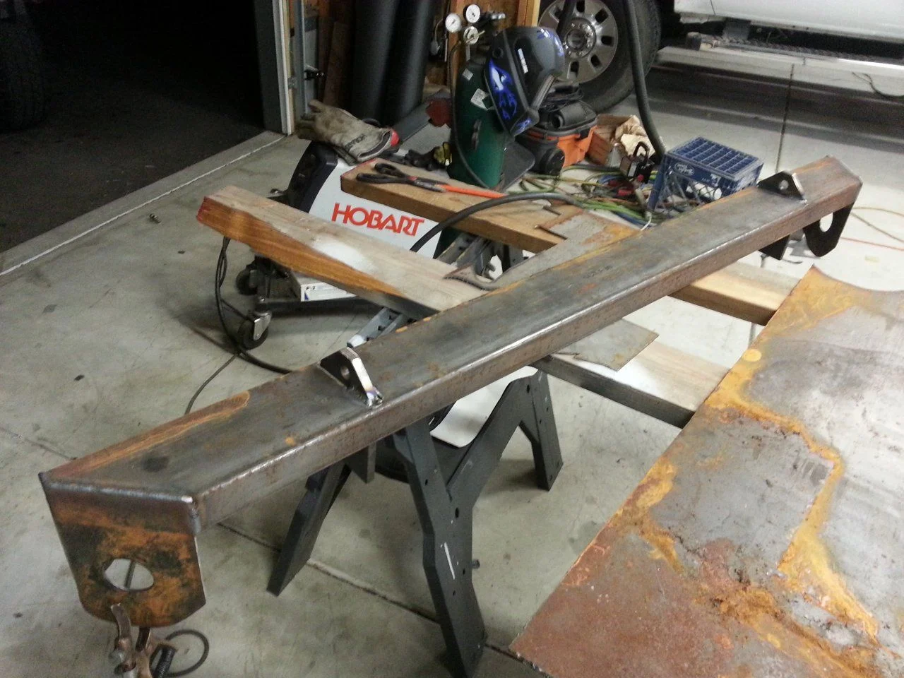

As I've noted earlier, FJ 60 rear bumpers are obscenely expensive. I don't plan on carrying all sorts of crap on mine, and I have no desire to hang the spare tire back there. I don't really understand why guys with stock tanks don't put a spare in the stock location. I measured and I can fit a 38 x 13.50 tire and still have it above the hitch. But I digress.
I chose 2 x 5 x .120 wall rectangular tubing, with slight kickouts to protect the corners. The bumper is mounted using the stock rivet holes that the stock bumper bracket bolted to. The bumper mounts also double as clevis mounts (they run through the tubing) and are .500 x 4" band iron. I should have about $100 in material in this bumper when finished.
I threw some dimple died parts on there because I'm also posting this build on Pirate and you can't fabricate without dimple dies!
I worked on this until about 1 AM tonight because it's hot as hell outside and it takes my house this long to cool down - thus I'm out in the garage where it is much more temperate.

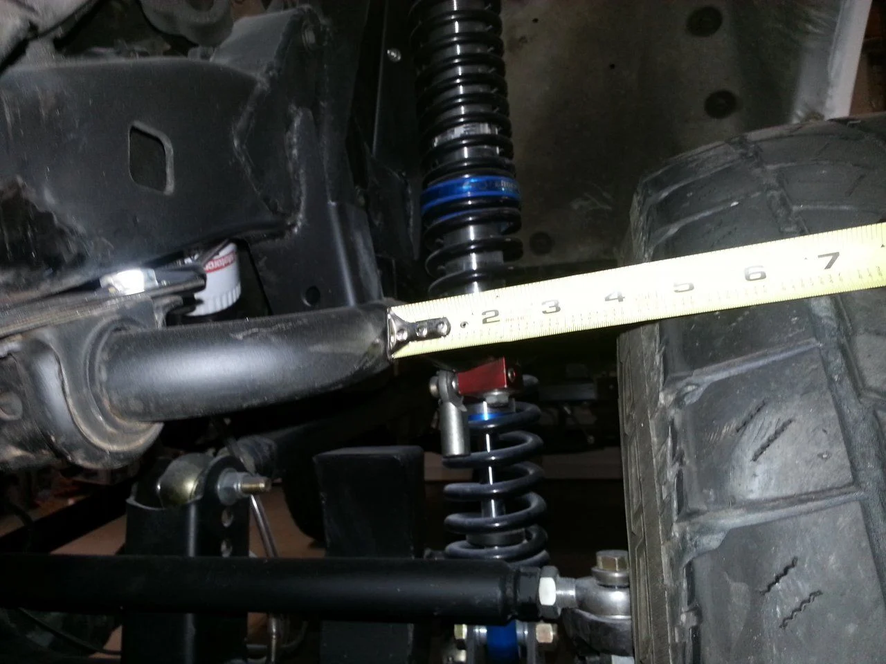

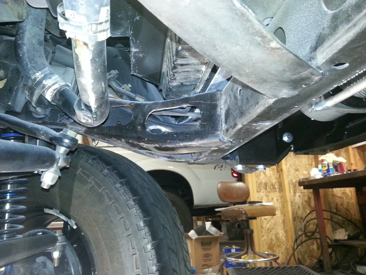

I've been facing another issue that is a bit annoying. I have a free sway bar off of my friend's Dodge, and like his Dodge, my axle plays hell trying to maneuver around this thing. I cut off the brackets I made for this thing previously earlier today and started fabricating new ones. After test fitting my new brackets, I realized I was going to have to bit the bullet and go with a custom long-travel rock racer sway bar, and will likely need a rear sway bar from something like a Suburban to combat all the body roll the Space Shuttle encounters on daily drives.
I other news, I finished my rear bumper, installed my seats and carpet and got my "Hapa A/C" working as intended. It's ice cold. Fun fact: Ford started using Nippondenso A/C compressors in 1980. I still need to make some sort of inner fender covers to fit over their eventual treatment of MLV.
My test drives were all very quiet, cool and smooth. I must say turns are a little nerve-racking since there is a lot of body roll with the sway bar disconnected.

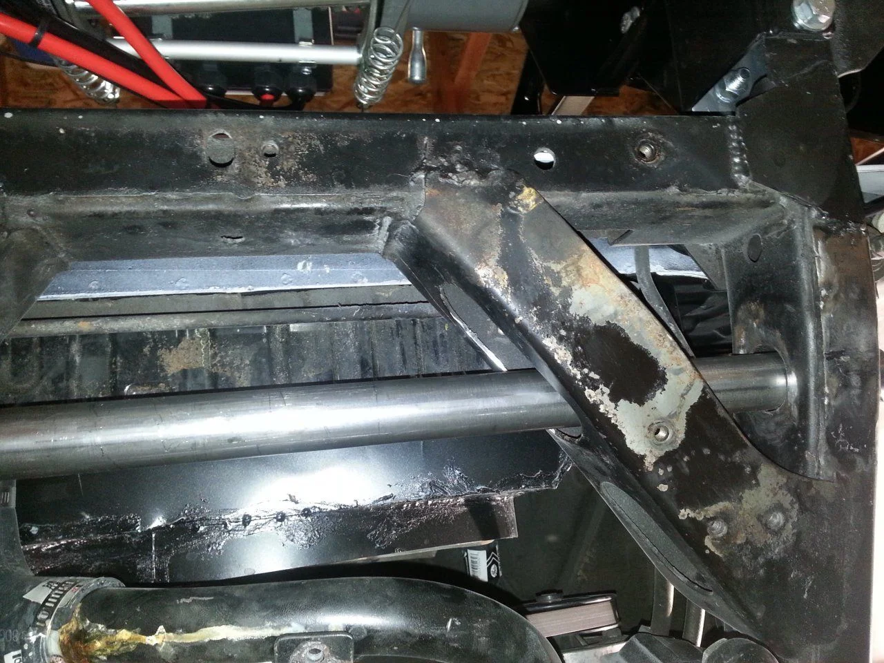

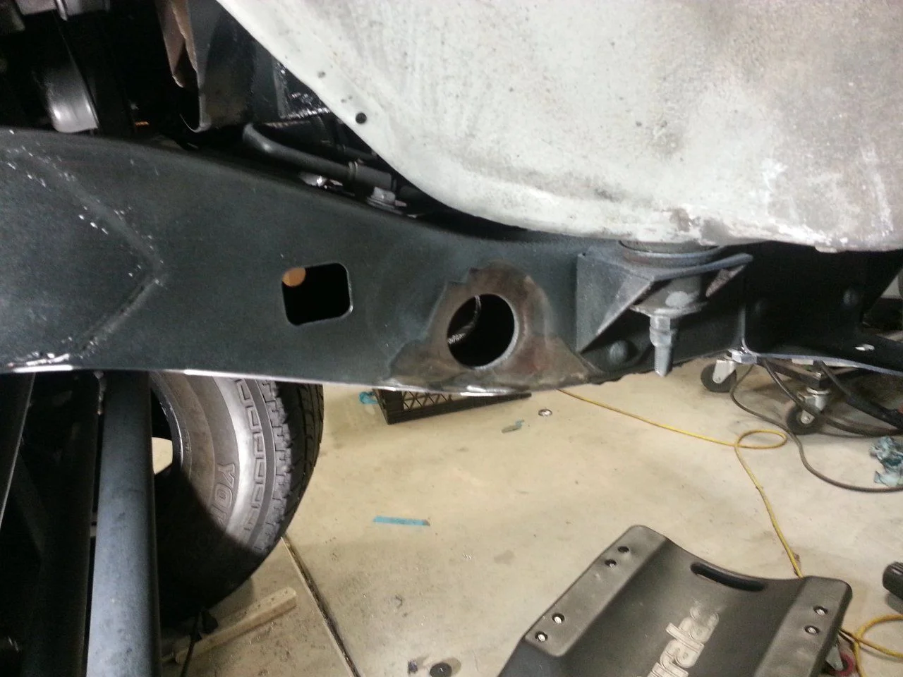

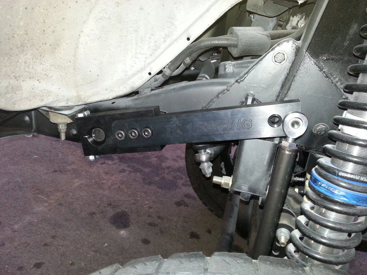

So I got mad and solved my sway bar problem last night.
I bought this sway bar from TK1 Racing, and I must say that the quality on this thing is excellent. This definitely ups the Bro-factor of the Space Shuttle. I highly recommend it.
I had to cut the area between the two speed holes into an oval in order to pass the sway bar tube through.

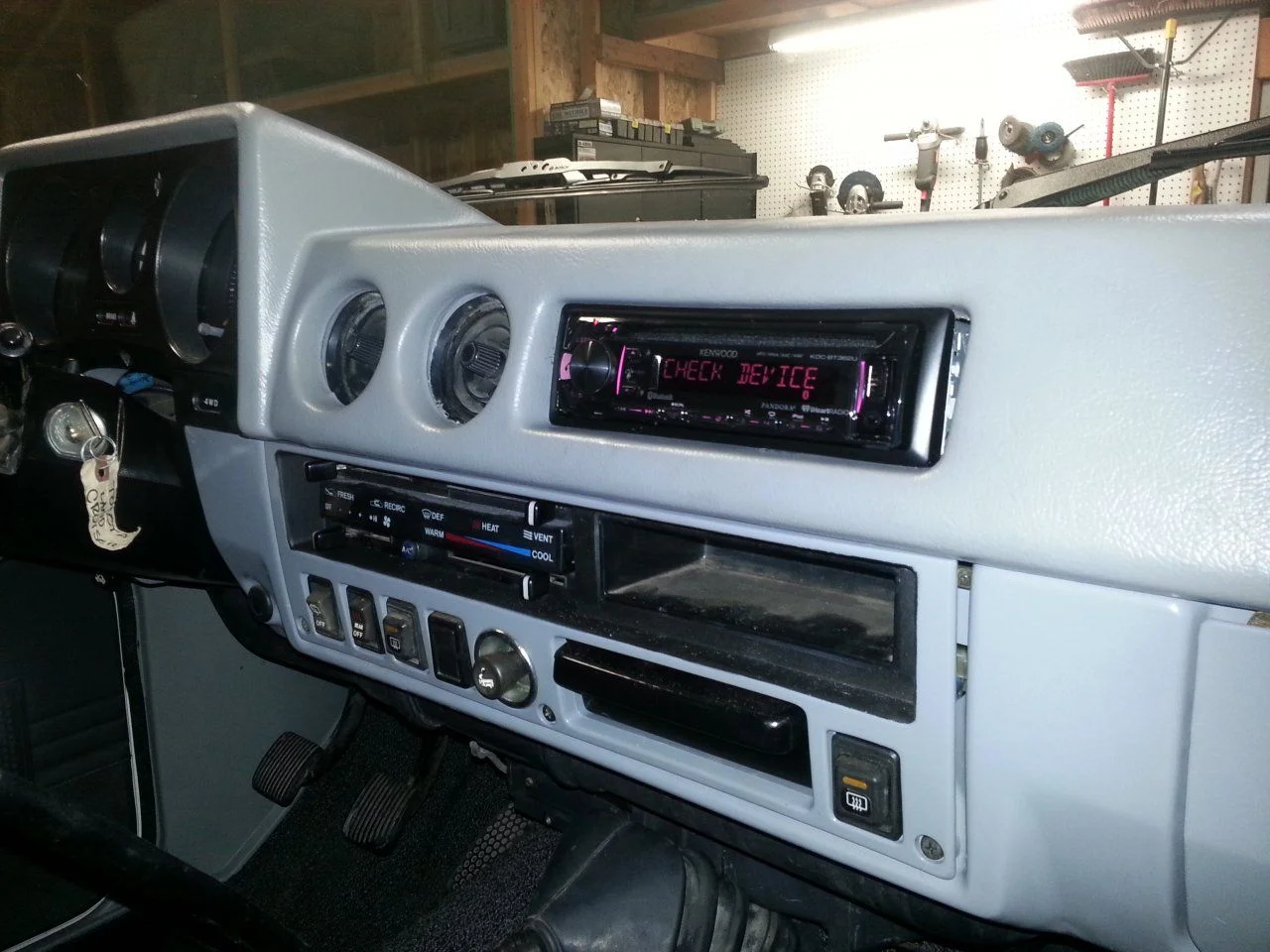

I also finished the installation of my stereo and it works quite well (only the front speakers are hooked up). It does Bluetooth and a whole bunch of other neat features that I have no idea how to use.

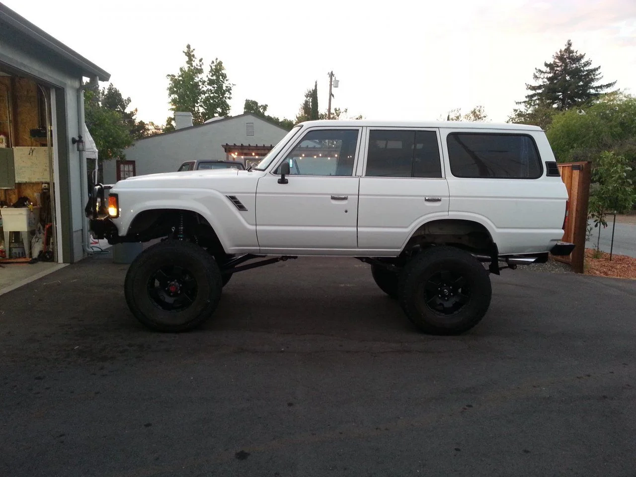

One more driveway poser shot:
I usually don't like tall cruisers but this is quickly becoming one of my favorite rigs on here. Very unique and creative setup, and clean work.
Are those 37" street tires? Awesome
This thing will laugh at cheaps on the trail and the road!
I know you won't get comments from the purists...but I like it!
They are Yokohama Geolanders. They are all terrain and will work perfectly for the intended use of this truck.

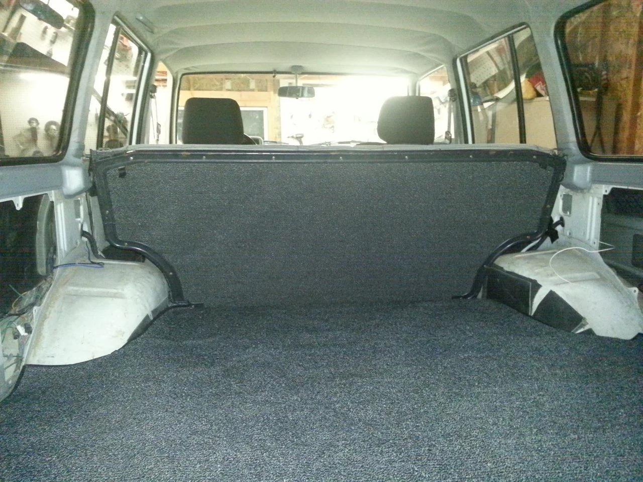

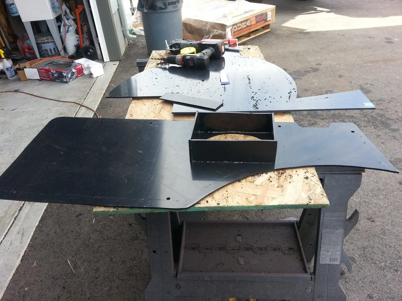

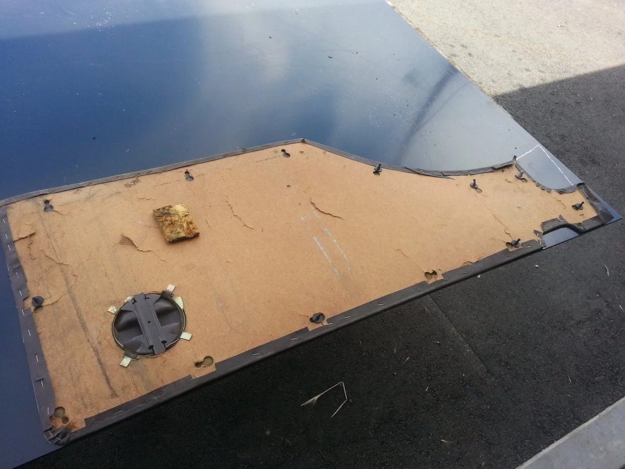

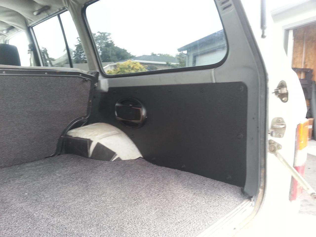

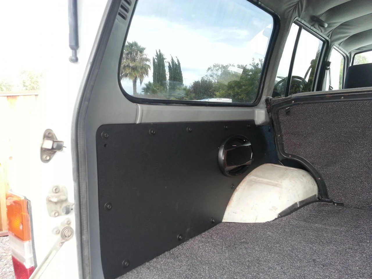

Today I got my interior 90% - enough to where I can now drive this thing and not hate life. I installed my speakers and side panels. I made them out of .250 ABS textured plastic. A 4x4 sheet of this was $100 over at TAP plastics. Fortunately I kept my completely dilapidated cargo panels to use as templates.
Not to bash vendors here, but accessories for this damned thing are OUTRAGEOUS. $700 for cargo panels is pretty steep for anything that's not made of platinum. This whole project cost me $125 (including the cost of the jigsaw at Harbor Freight).
I put them on the ABS reversed so the textured side was out, and traced them with a paint Sharpie.

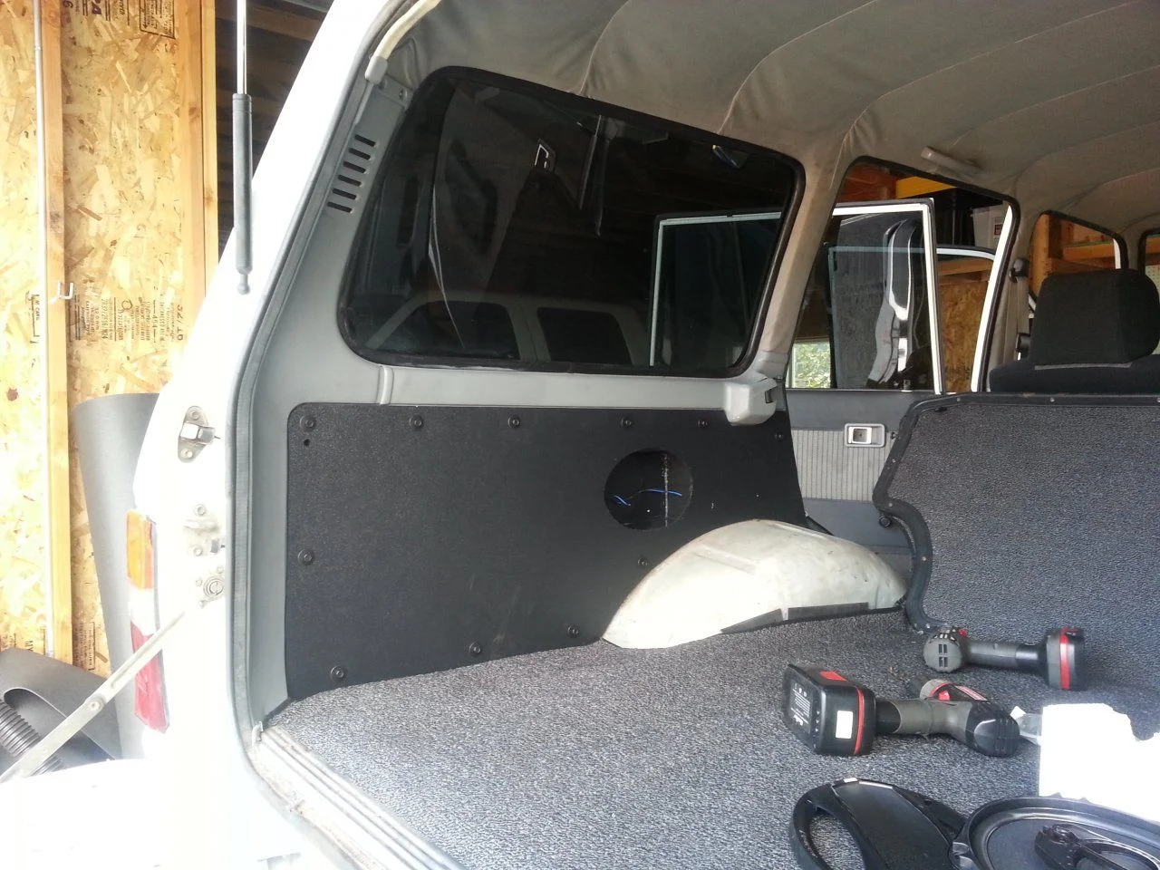

Then it was to the jig saw with a 10 tooth blade and slowly cut them out. I used the factory clips as templates for the holes, used 6 x 1.00 mm speed nuts in place of the clips and GM tender bolts from Amazon to hold them in place.
I also boxed in the speakers with more ABS to give a bit more bass and isolate them from the interior panel for resonance purposes.
All done!
