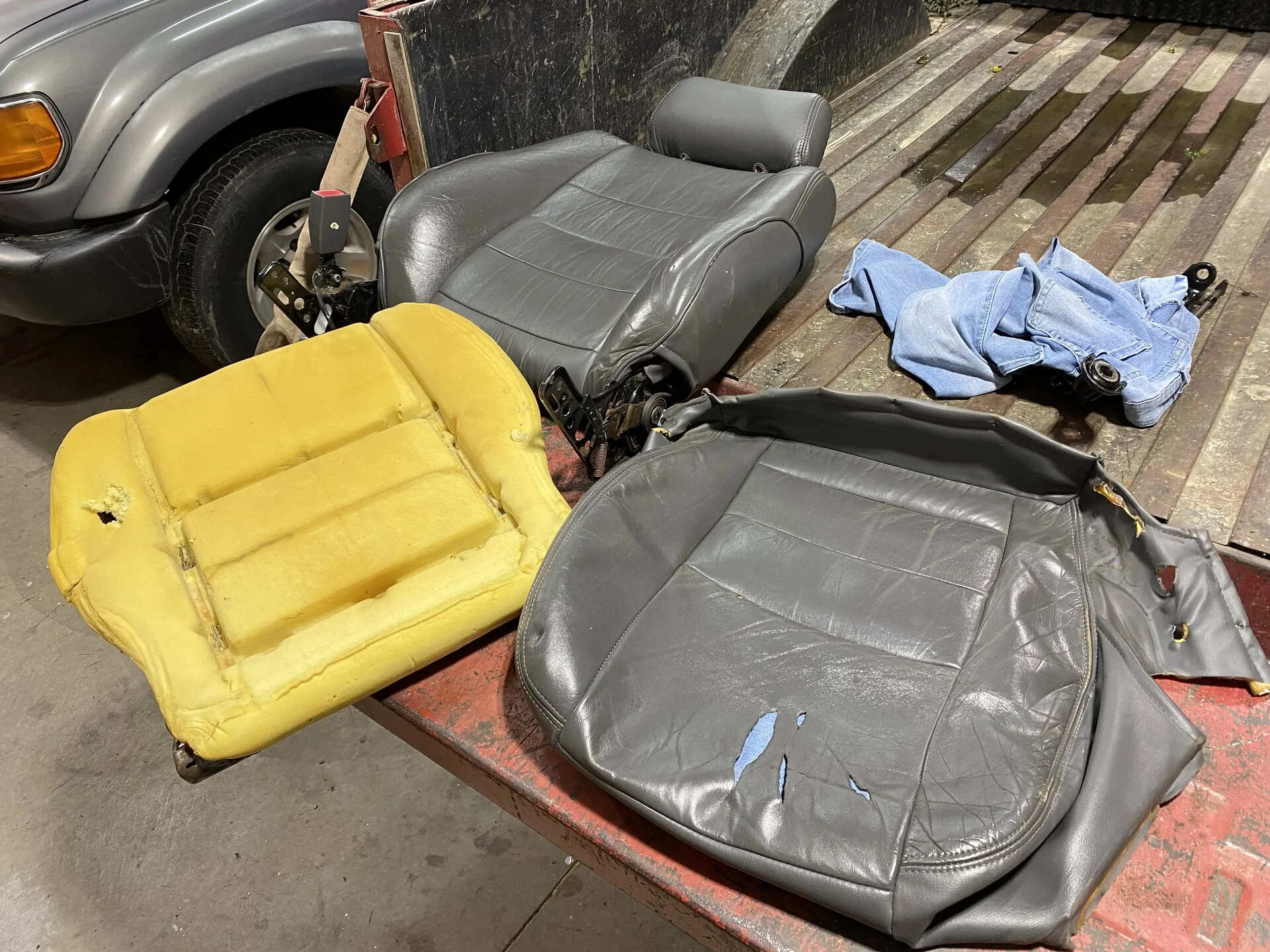

I had a little time in the garage last night so I worked on the driver’s seat a bit.

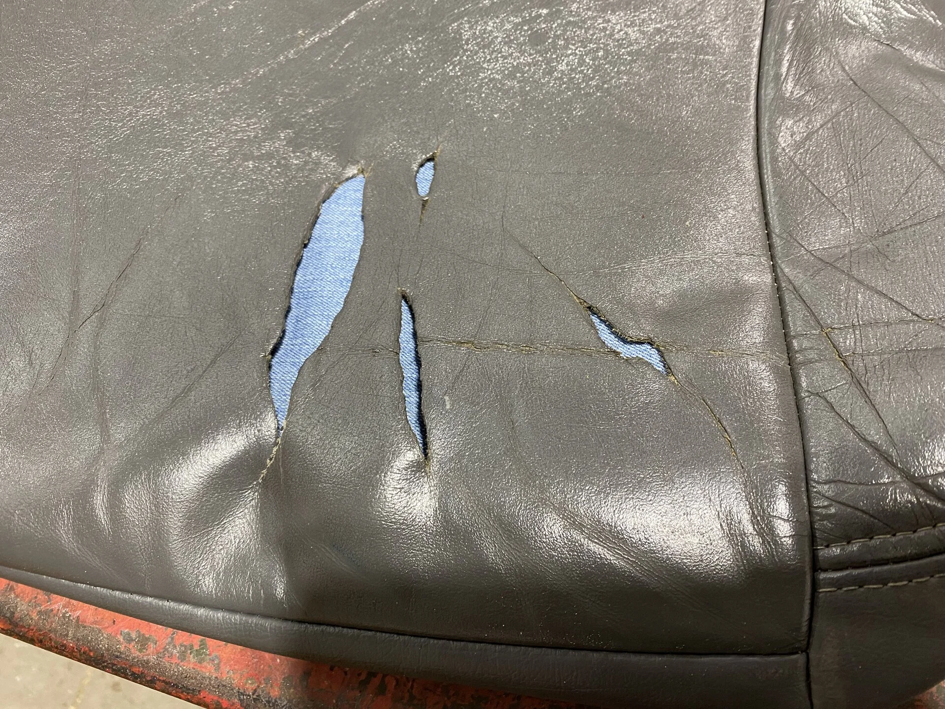

I disassembled the seat because the lower vision foam needs to be re-attached, I want to patch the tears, and I’m going to install seat heater elements.
The seats came apart easily and luckily the foam is in better shape than I thought. Unfortunately, I didn’t have spray adhesive so I’ll have to repair it later this week.
I was able to mock up my tear repair. My wife had a pair of blue jeans that no longer fit so I decided to repurpose a section of them to cover the tears in the seat cushion. I cut a slit in the foam and slid the piece of denim in between the foam and the leather. I will glue it in when I get adhesive. I think it looks pretty good for a low-buck repair!
Hopefully the denim glued to the back of the leather will also give it some additional tear resistance.

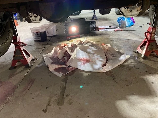

I was able to get some additional trans fluid for my second drain and fill. I need to wait for an opportunity when I have more time to get dirty and change it. Hopefully the second change will do the trick!

I drove the truck for a bit with the "stop shudder" friction modifier... it didn't fix it. I can't say that I'm not surprised but I was hopeful. So more than likely it's a mechanical problem... My hunch is the clutch pack on the 2nd gear.

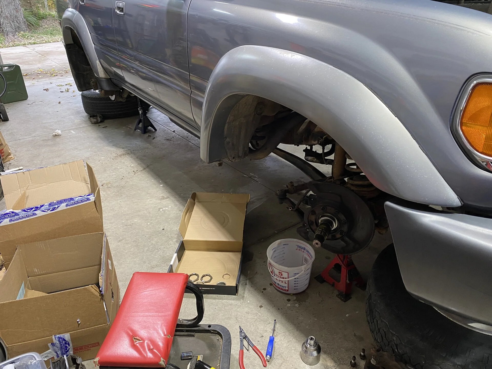

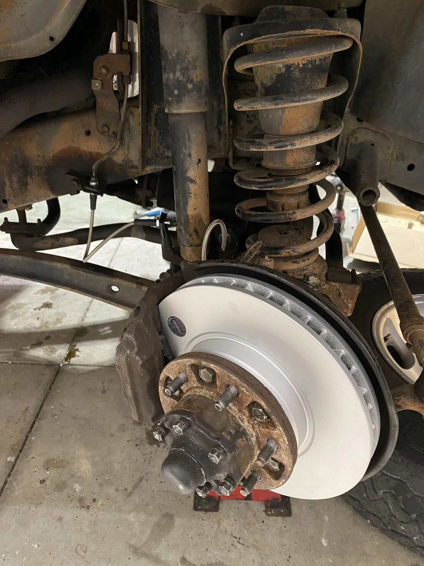

But before moving further on that front, I decided to install the brake hardware that I have on hand. I'm about halfway done at this point. The new front pads & rotors are installed as well as the extended stainless brake hoses.
I also took advantage of having the truck on jack-stands to remove the running boards. That instantly makes the truck look 10x better!

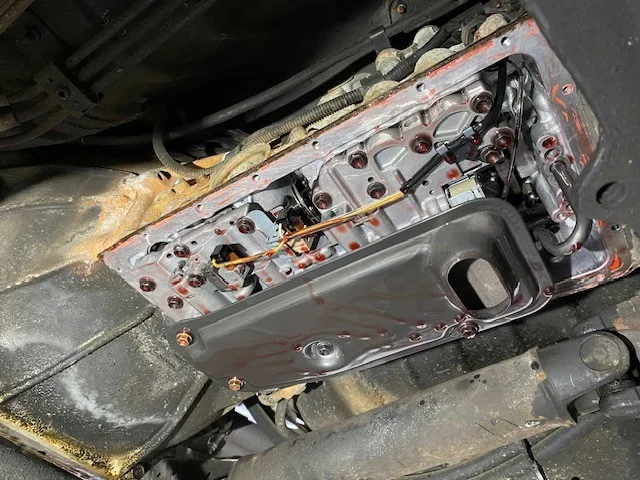

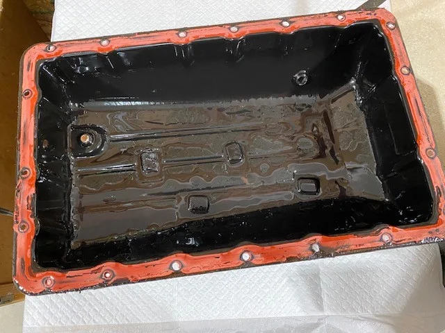

Last night was mostly spent prepping a clean space on the workbench to inspect the valve body. I also stole the idea from someone on the forum and used puppy pads under the trans to catch any stray fluid.
This is the first time that I've dropped a trans pan and I wasn't sure if the dipstick came with it. I unbolted the dipstick from the brackets just in case. I then unbolted the trans pan and tapped it with a dead blow. It peeled off partially and then was hung up on the dipstick. I was monkey-ing with it when the worst happened... the pan fell on my head. Thank God I was wearing my safety glasses! All the fluid that was left in the pan then spilled onto the left side of my head, in my ear, and onto the ground... It looked like someone died under there! haha.
It was at that exact moment that the baby got mad and I got the call from the wife to come in and help. I had to hastily clean up and head inside. That being said, I did get to at least take a quick look at the trans pan.
It does look pretty dirty and the magnets are caked in material. I don't know if this amount of material is normal for a 142,000mi trans. I'll clean it up when I get time and go from there.
initial glance at the bottom of the trans and it looks ok.

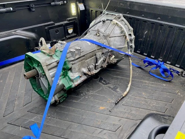

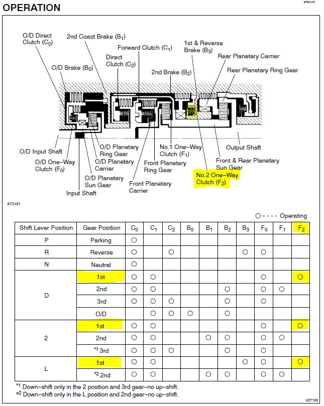

My options then are to A) remove the transmission and spends $$ on specialty tools and rebuild kits or B) source a used transmission with similar mileage to my truck and give it a shot. After hunting the local classifieds for a few weeks, I was fortunate enough yesterday to snag a $500, 129,000mi transmission from a local scrap yard! It felt kind of like bagging a prize buffalo! Or so I imagine.
So now I have the trans but my 1st floor bathroom is just studs, half a wall, and a tub currently so I need to focus on that. Hopefully I can wrap the bathroom up in the March timeframe and I can work on the transmission in April. And if I'm lucky, I can use the truck on an offroad trip that I'm planning for later in May!

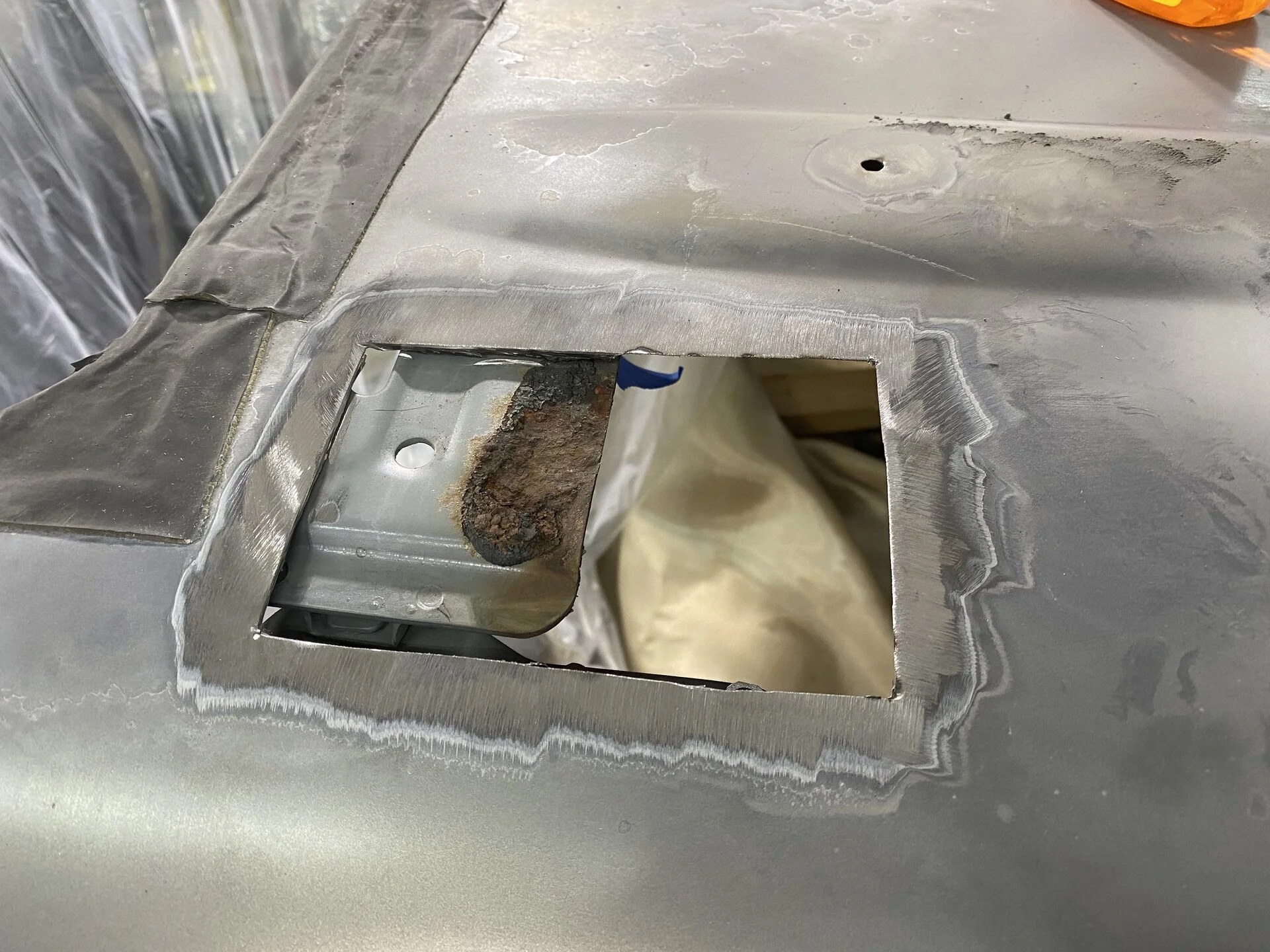

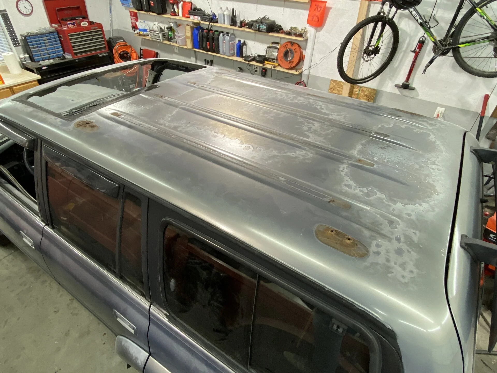

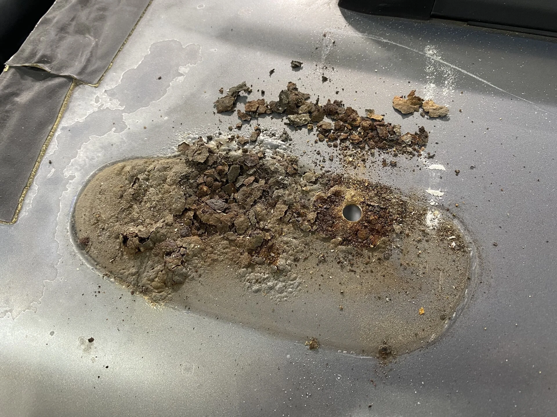

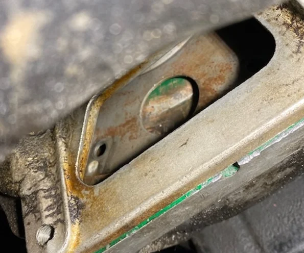

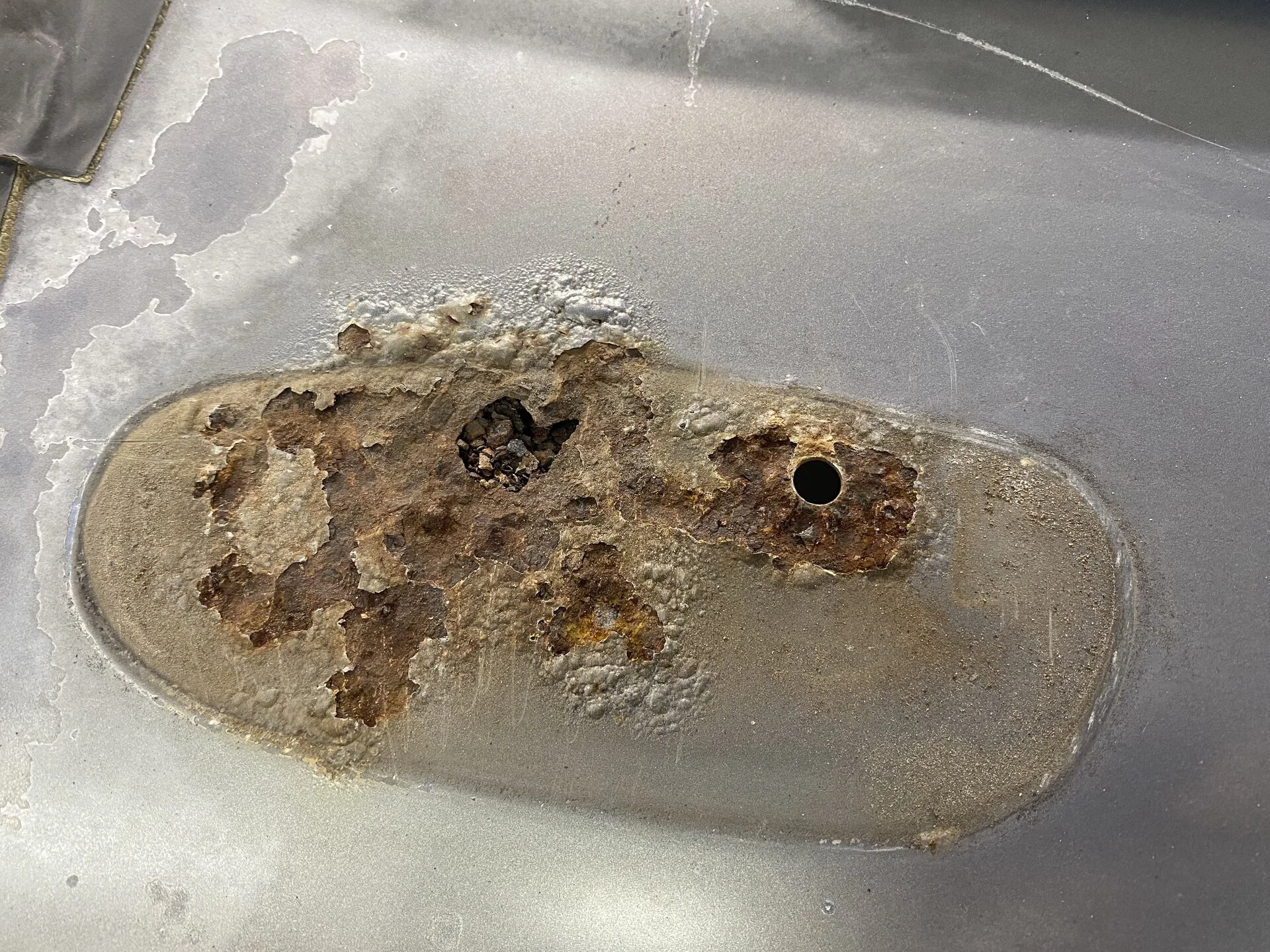

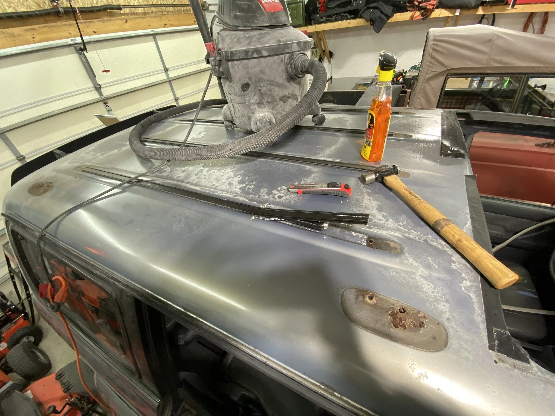

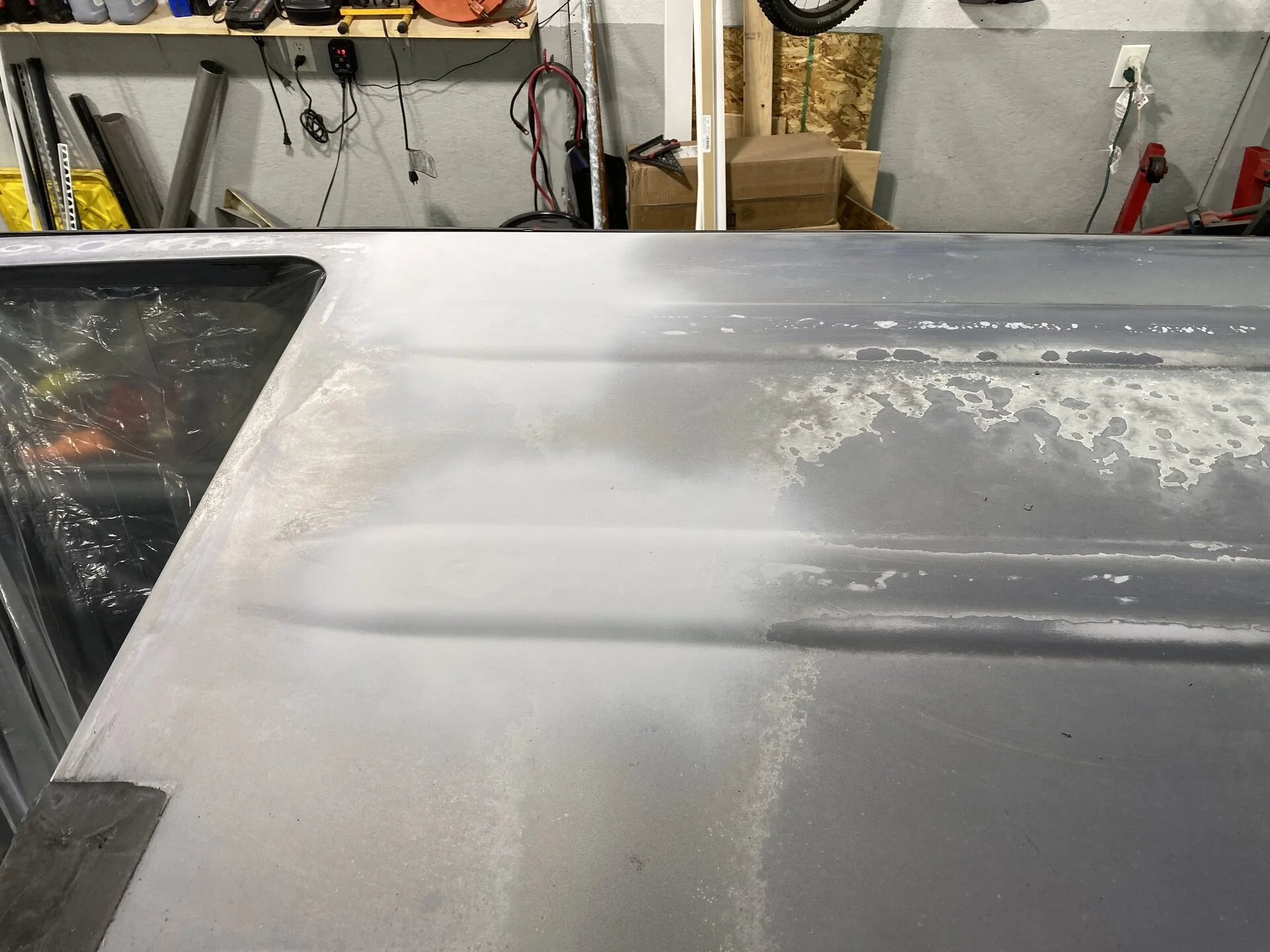

Mild update on the roof project. I've begun to take the roof apart and strip it down to repair the rust and paint. I knew that the roof rack feet were rusted underneath but I didn't expect that it was this bad... woof
so... as opposed to simply filling in the rivnut holes and smoothing, I guess I get to weld in some patch panels. it is what it is.
I was also able to remove the load bars(?) off of the roof. turns out, your trusty putty knife and a hammer works pretty well to remove them. but I wouldn't recommend doing it this way (or maybe removing them at all) if you care about your roof paint. mine's already burnt and I'll put white bedliner on after so I don't care too much.

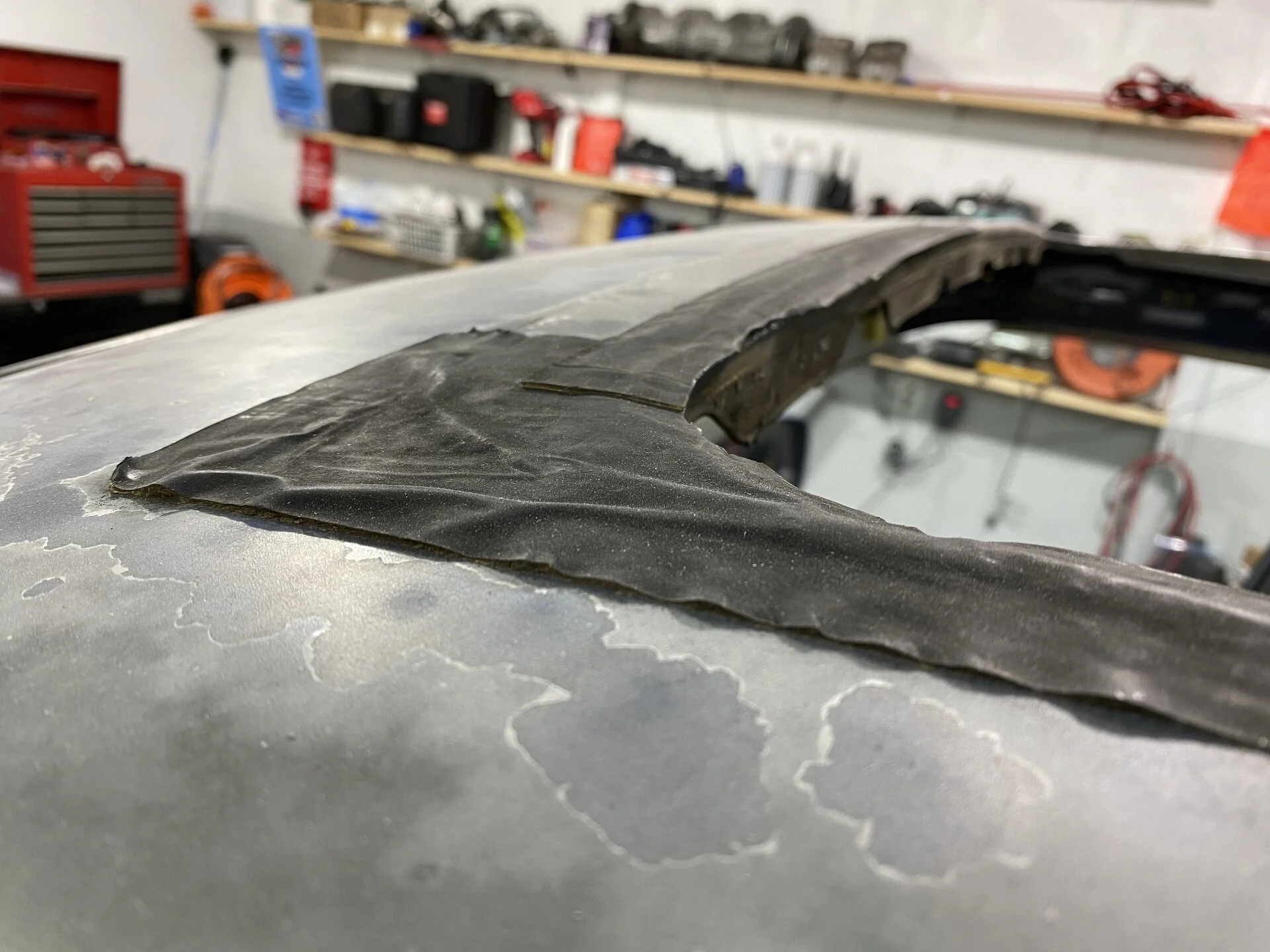

The final bit of removal prep will be removing the nasty tape around the sunroof. I don't know what the previous owner used but the adhesive is THICK and the tape is weird. I'm hoping that a heat gun, adhesive remover, and some patience will remove it... and then I need to get it off of the sunroof glass. That will be fun.
That's where it's at. I'll eventually cut out the rust and weld in the new pieces/holes. I'm happy to be able to make these little steps while renovating our bathroom. I still think that I can get the truck ready for our offroad trip in late May. but we'll see

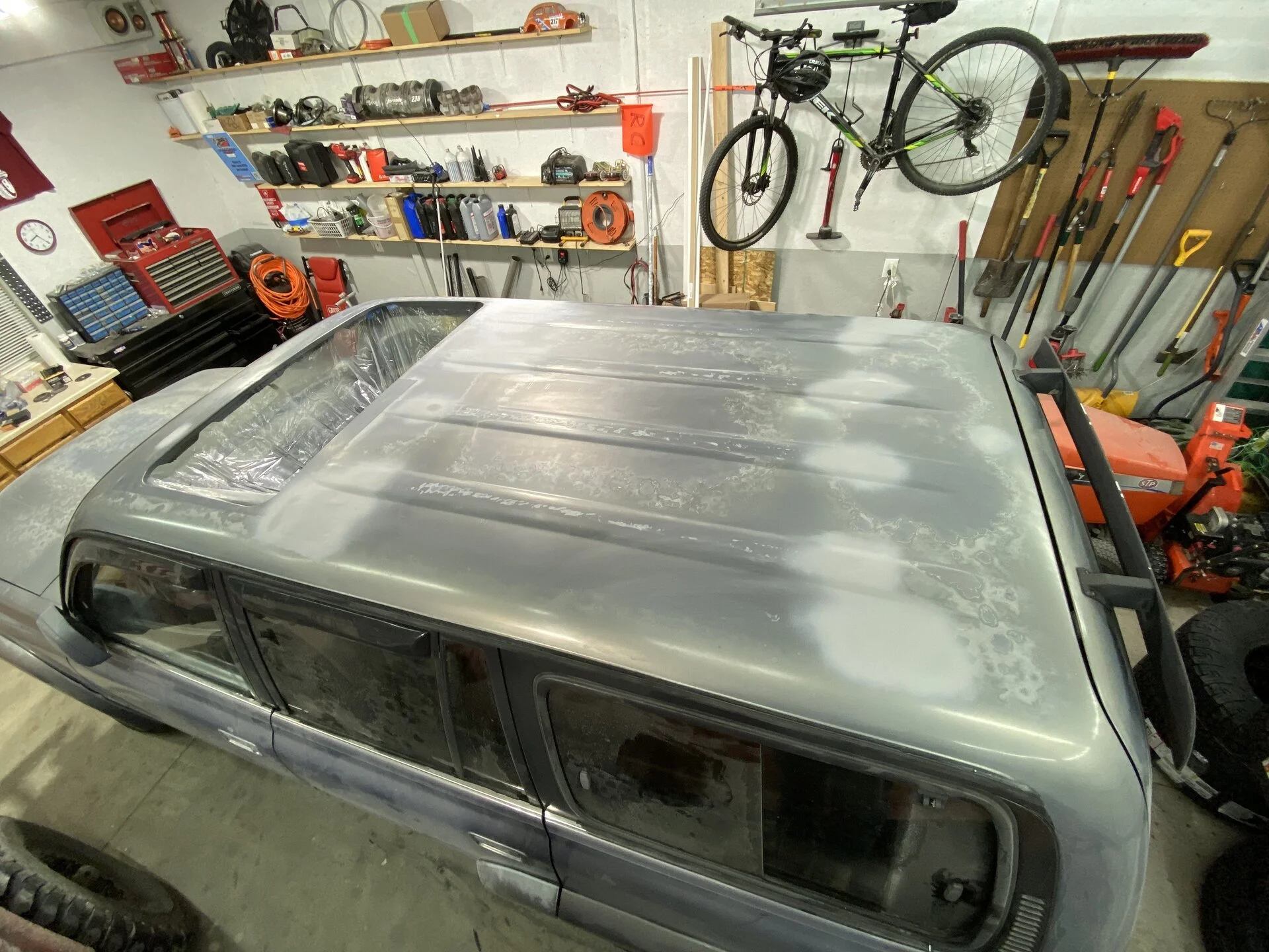

Ok, after a long hiatus and a trip to Japan, I was able to restart work on the truck.

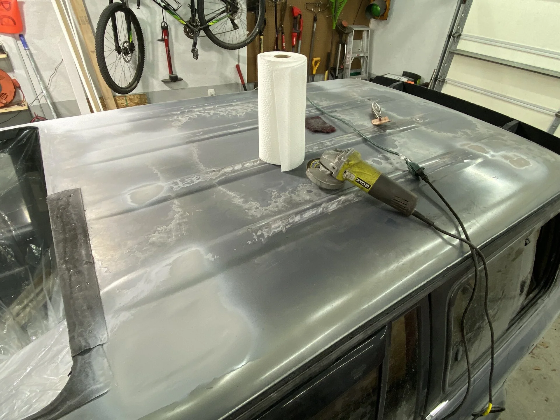

I've been plugging along at getting the roof rust removed. I've cut out two panels and welded in those plus all the rivnut holes that remained. I'm almost done so it should just be one more evening of that to have the roof resealed.

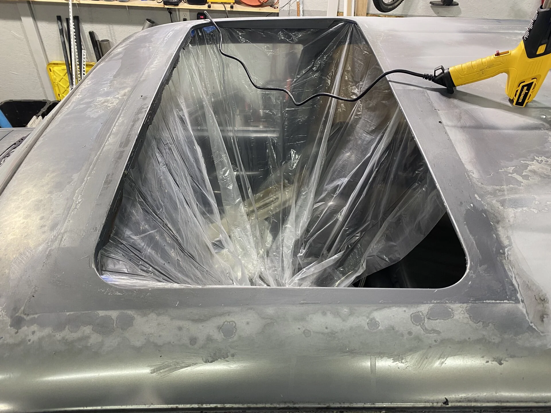

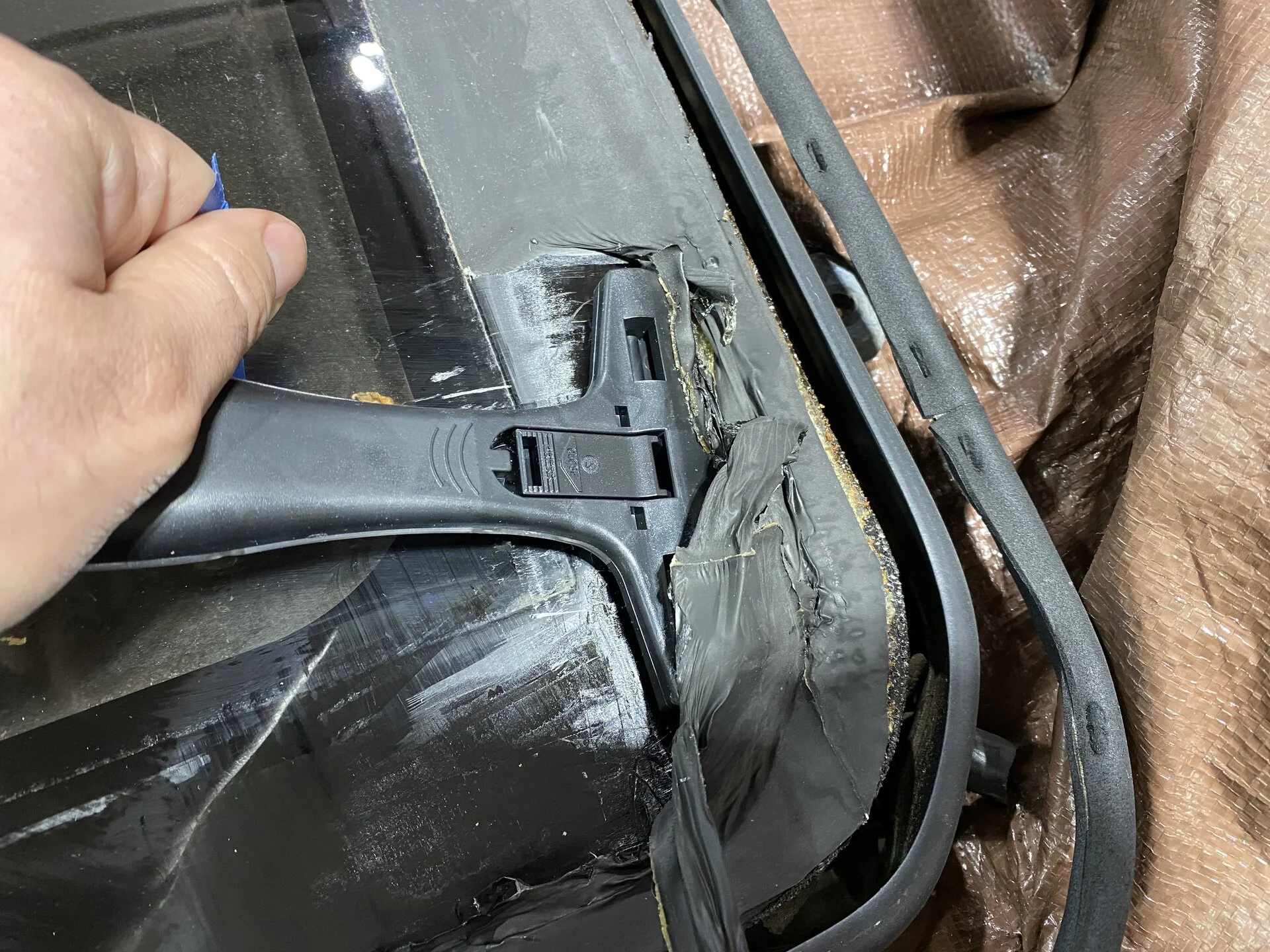

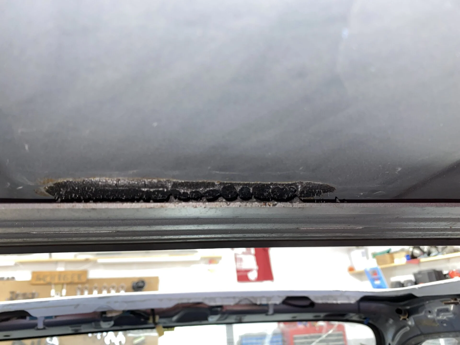

I've also been working on that AWFUL tape. I think I've determined that it's a butyl tape of some variety. And as such, it is only removable with a heat gun and metal scraper. even the remnant adhesive is tough! using acetone and a scotch brite pad, I can eventual wear it down. But this process has also worn the paint through to the primer in a few spots. Not a huge deal since I'm going to paint the whole thing, but it does give you an idea of how sticky it is!
So... mostly done with that part. The problem is going to start with the sunroof itself... That butyl tape is all around the window glass and rubber seal. I'm not sure how I'm going to remove it without damaging it. I think I saw a post a while back of someone using a bicycle tire inner tube to reseal the sunroof. Maybe I can do that and cover any butcher that happens to the rubber seal. Or I try to find the seal, cut the old one off, and glue on a new one. We'll see.

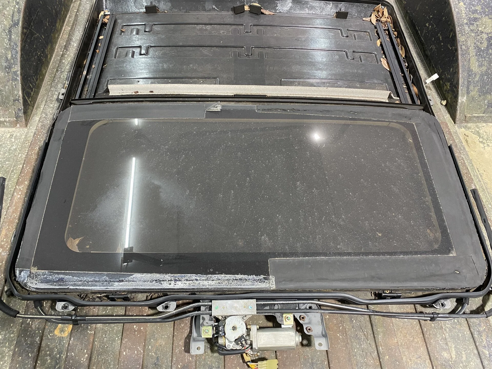

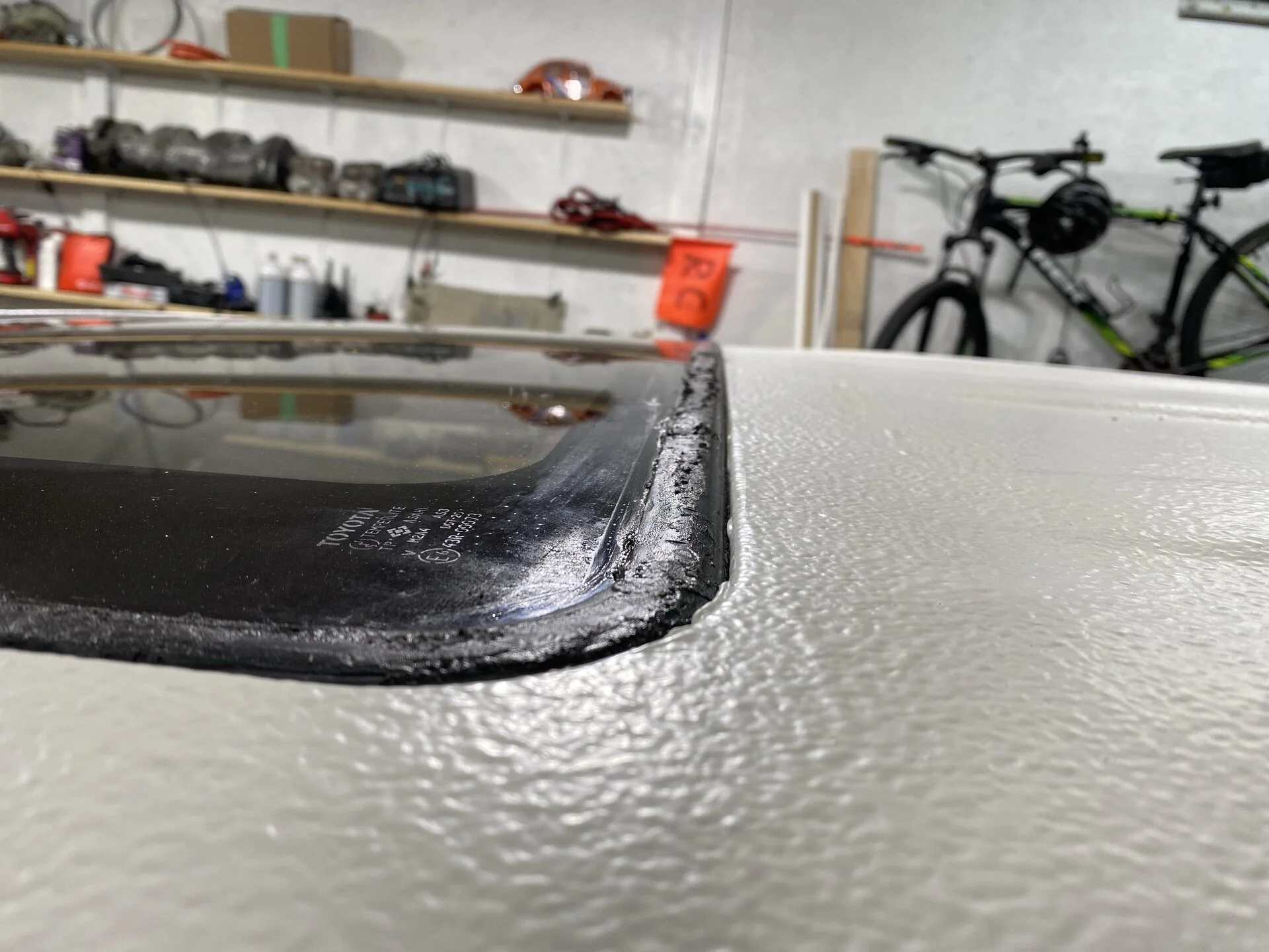

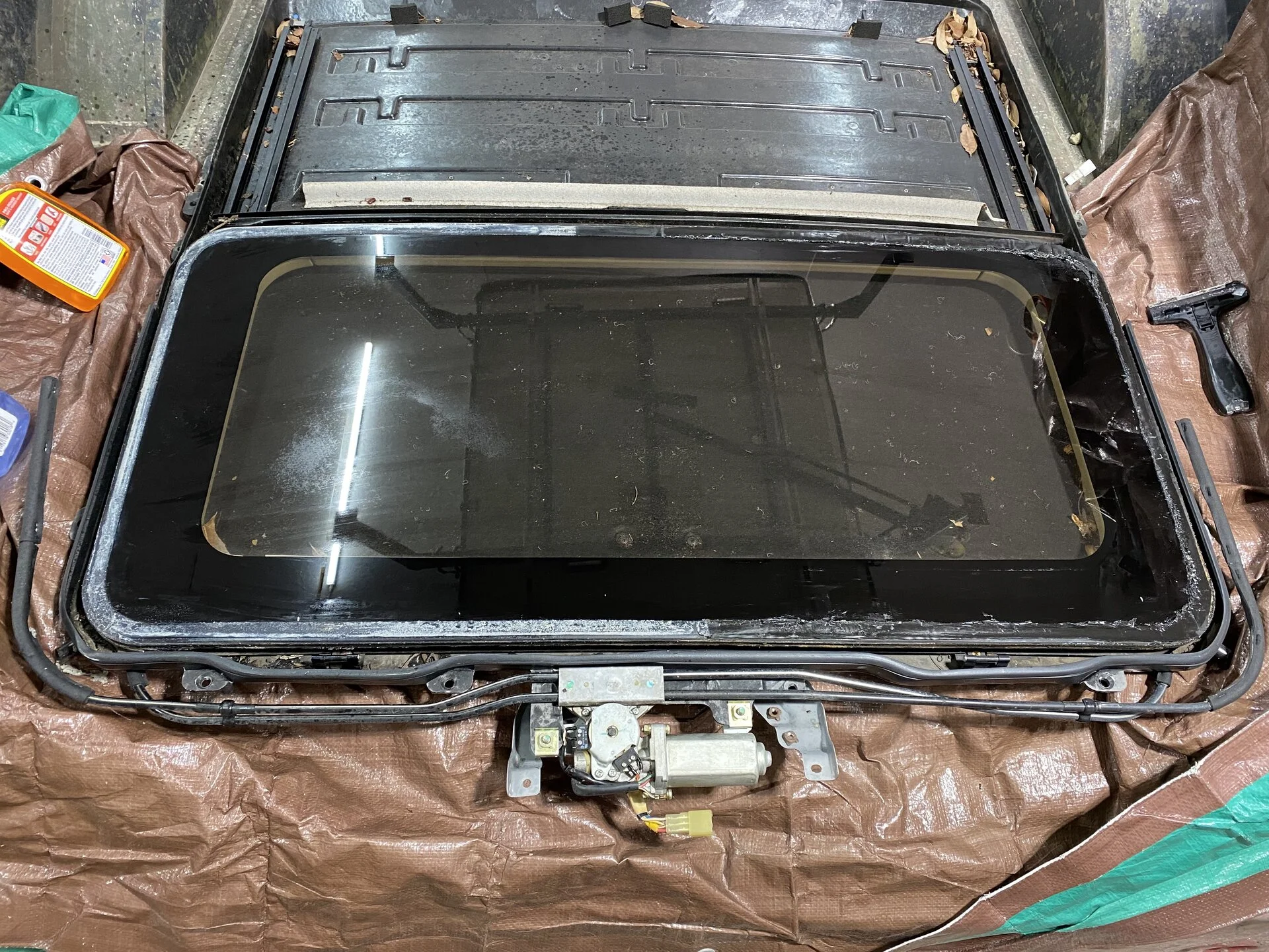

I was able to make some more progress on the roof and sunroof glass last night. The roof patches are all in and the holes welded up! I cleaned the roof thoroughly and it's ready for final prep before paint.

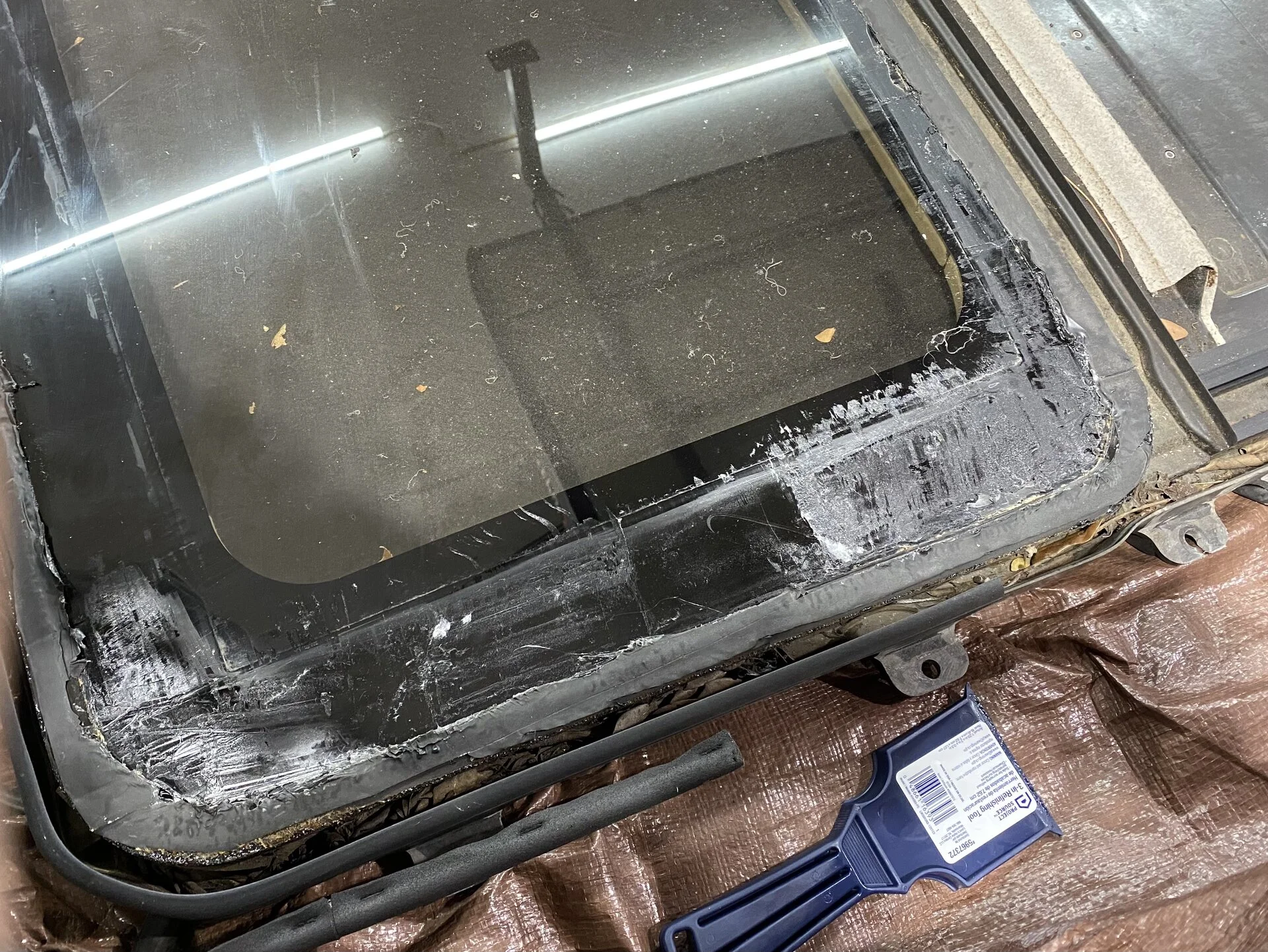

I was able to make a surprising amount of progress on the sunroof glass! With a heat gun, a glass scrapper, and some mineral spirits I was able to remove all of the adhesive from the glass! But it's still stuck on the rubber seal. I'm not sure how to remove it from the seal in a clean manner.
I did order a new seal but it apparently is for a 100 series sunroof... so it may not fit. If it does happen to work, I'll simply cut off the old seal and glue on the new one. If it won't work... well, I guess I'll try heat and mineral spirits on the seal and then use weatherstripping adhesive to seal the sunroof closed.

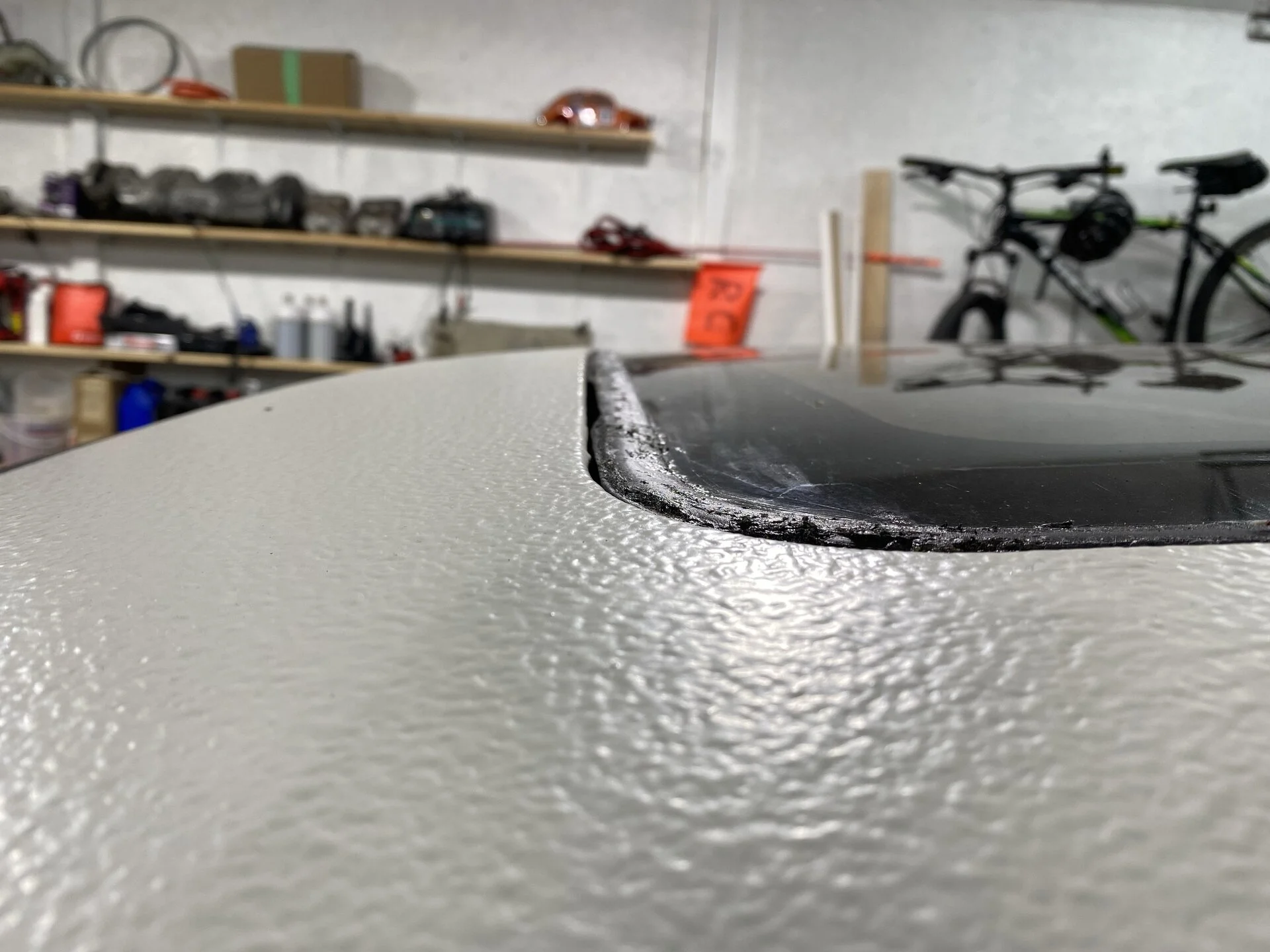

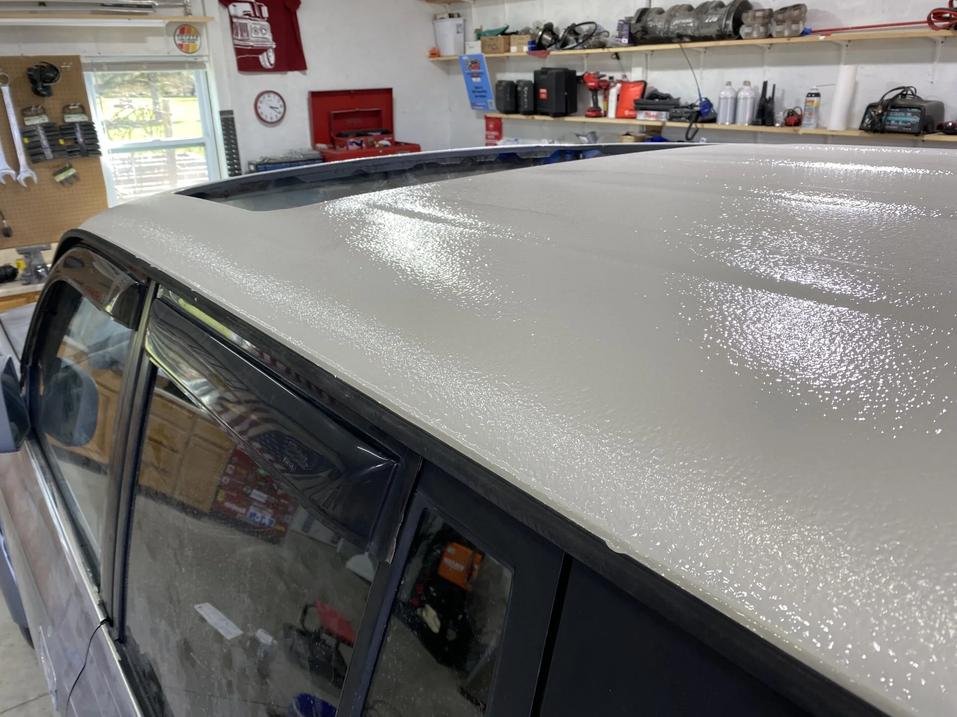

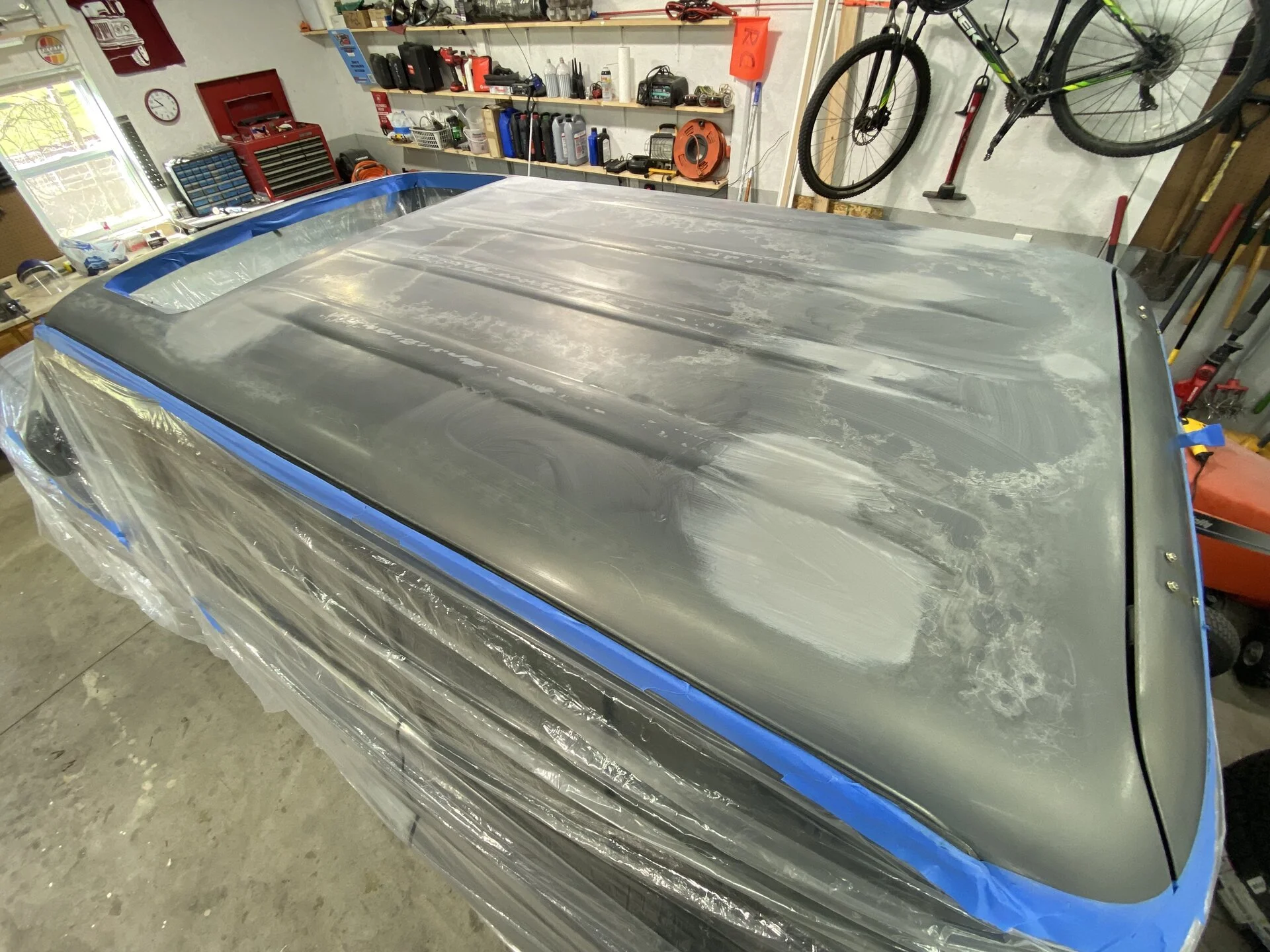

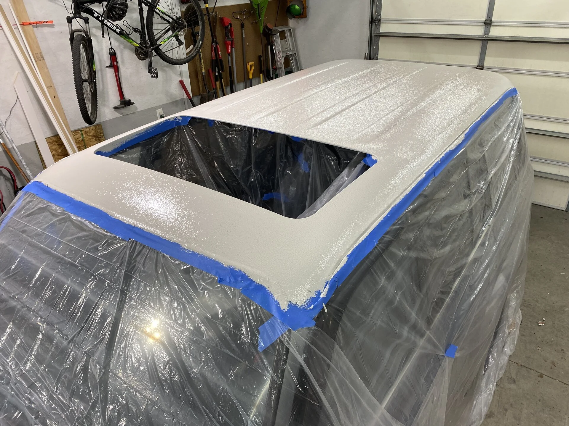

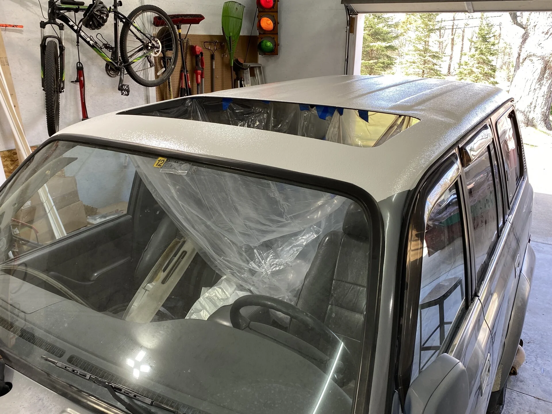

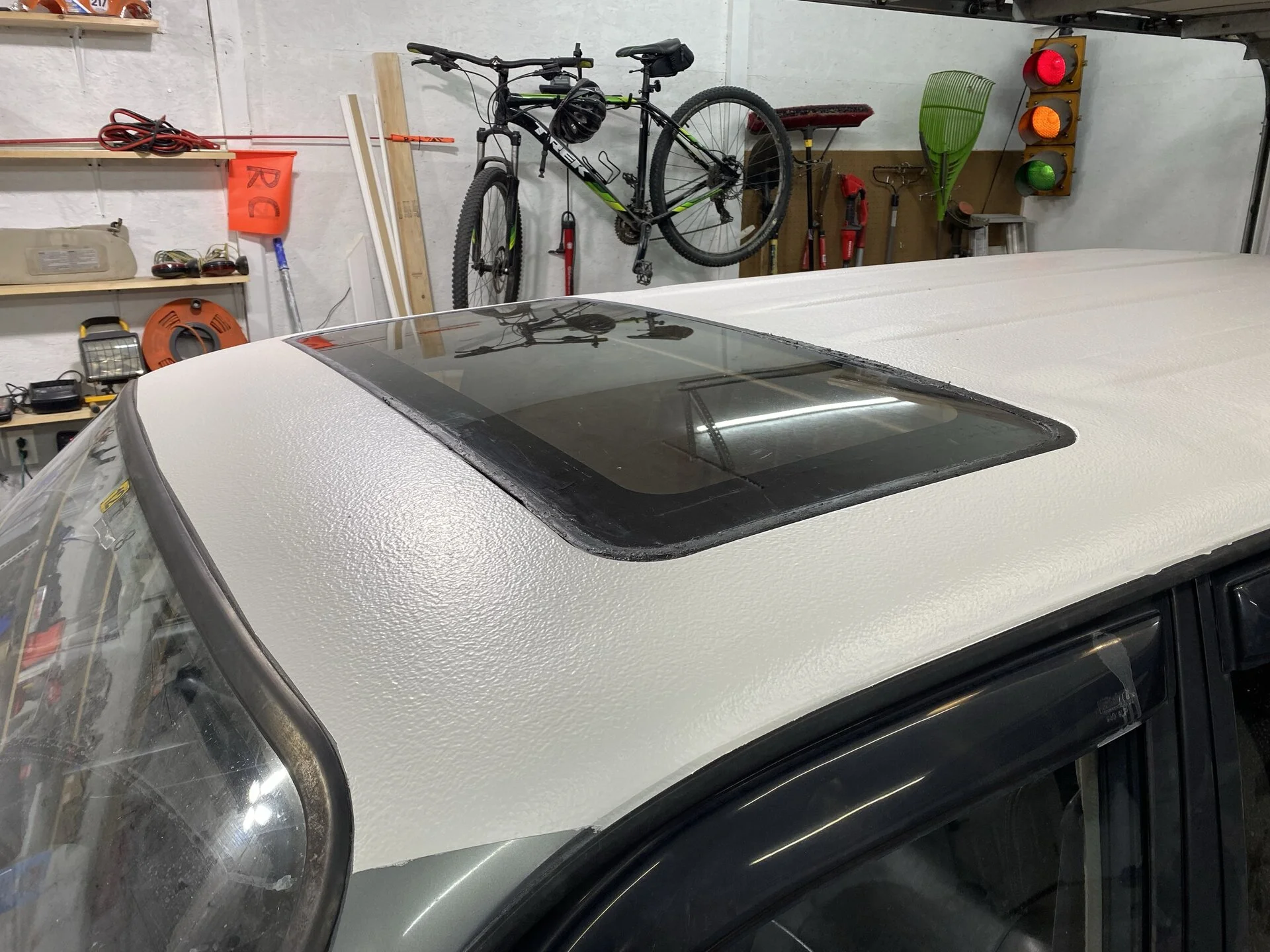

I finally got to do the fun part this weekend and paint the roof! I used Monstaliner roll-on mix with a very light grey color called "man on the moon". It all went pretty seamlessly!

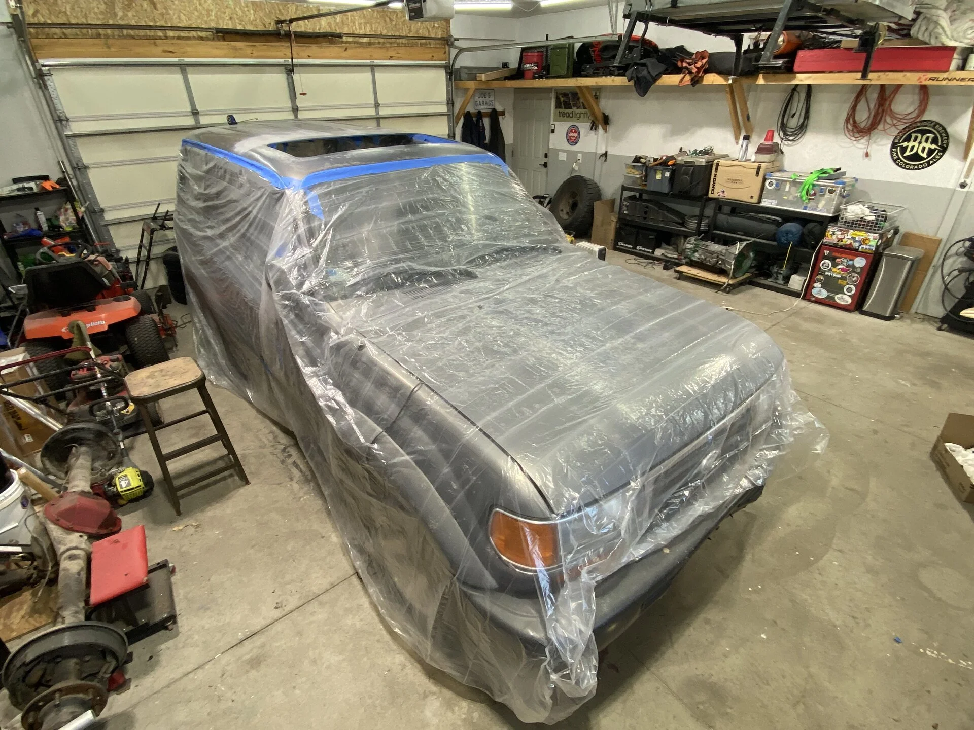

First was taping off, covering, and deep clean.
The wax remover that I used messed with the primer covering my bare metal a bit, but otherwise it worked great!
I was now ready to paint! Mixing the Monstaliner was a bit of an involved process. But it was easy enough after reading the instructions a few times. The part that was a bit funny to me was pouring the whole gallon out into a 5gal bucket for final mix. Then pouring it back into the original container. They emphasize never to paint from an open container so I think this is why your pour it back into the original.
First Coat:

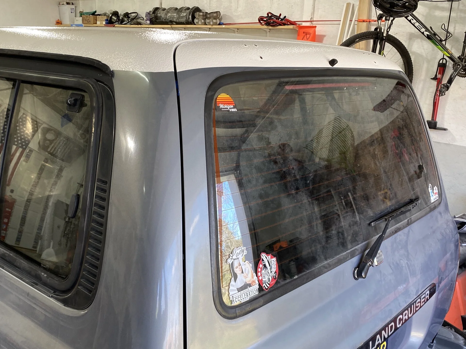

And here is the final result! I think that it turned out great! the sheet metal underneath isn't perfect but this hides most of the blemishes. We'll see how long it holds up. It's supposed to be UV resistant and not need top-coats or re-seals.

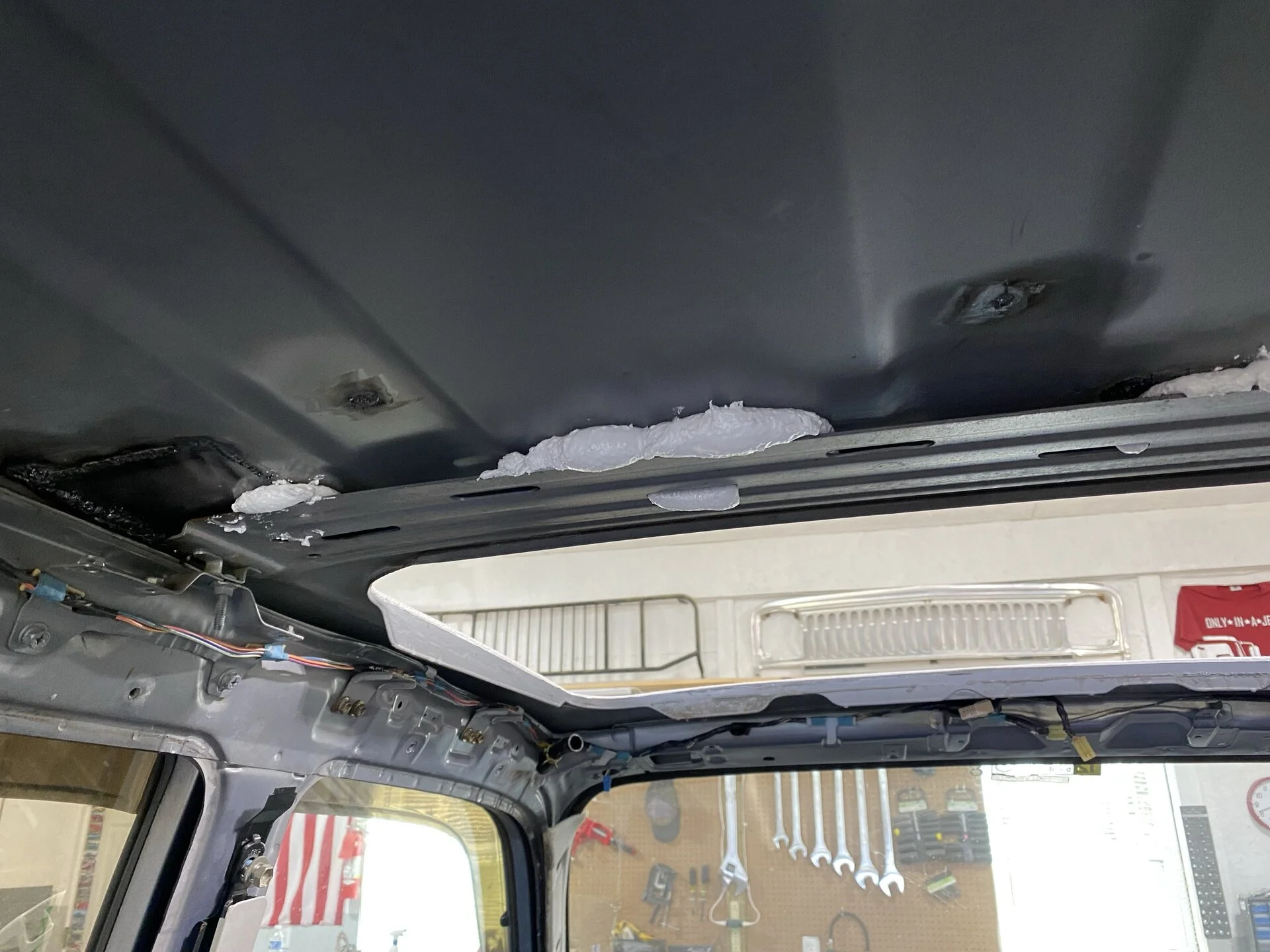

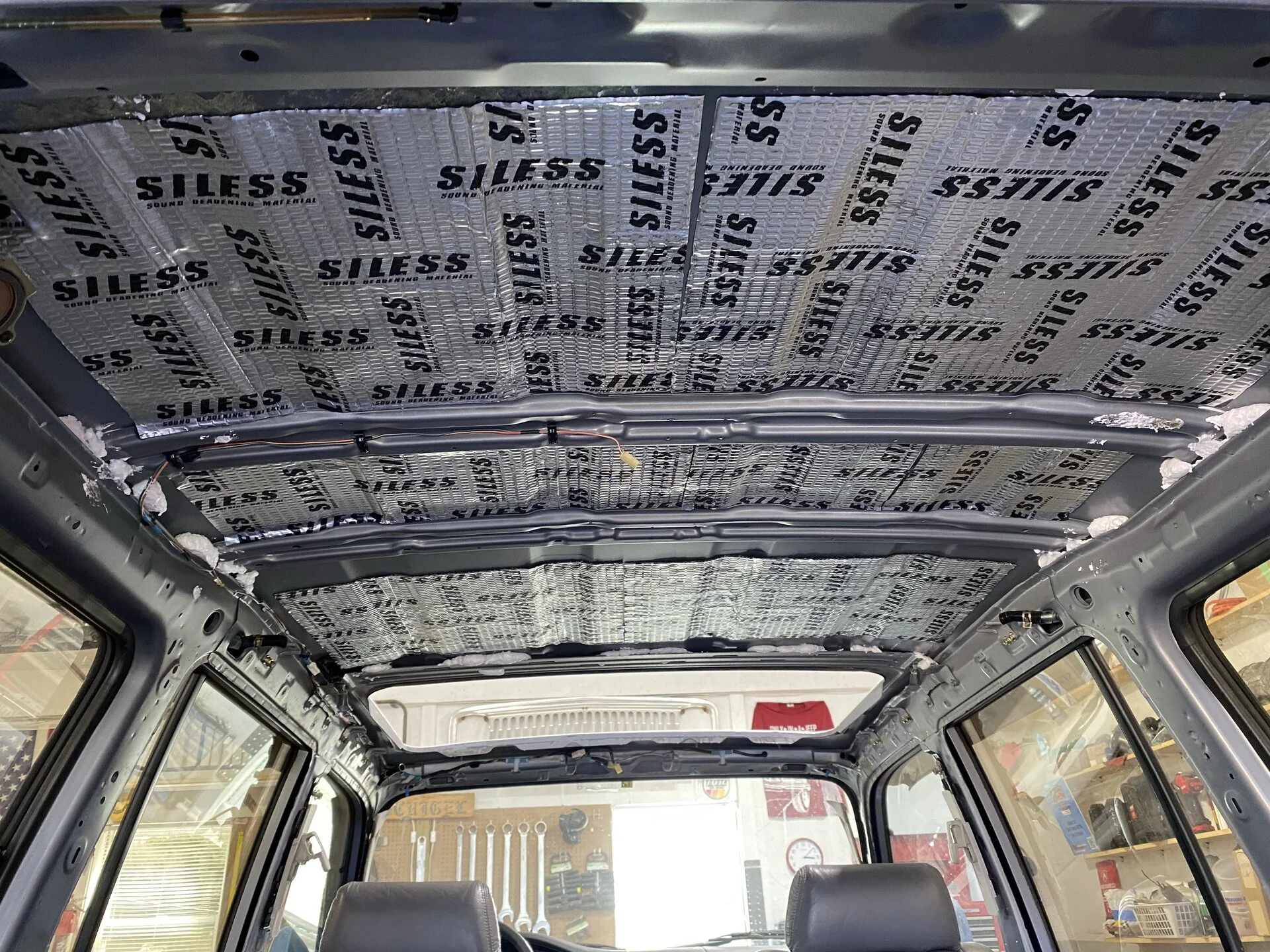

In addition the the paint, I was able to make some progress on the underside of the roof. I was planning on putting some sound deadner on the ceiling since the headliner was off but I found something else. Apparently the factory mastic that bonds the roof skin to the roof bows was likely improperly applied. Due to this, the roof bow isn't even connected!
This ultimately reduces the stiffness of the roof resulting in more cabin boom when going down the road. So to fix this, I grabbed some spray foam and filled in the bows. If I really wanted to go the extra mile, I could've tried to get the gap a bit tighter as well. But I figured this was good enough for who it's for (me).
After letting the foam cure, I trimmed the excess and installed the discount dynamat.
This should hopefully make the truck just a bit more quiet when going down the road.

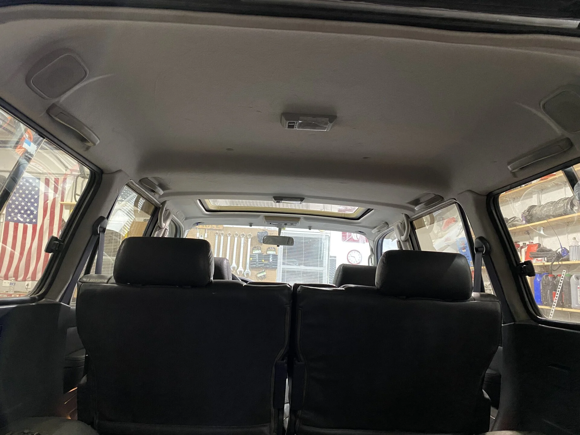

Last night I was able to get the interior back together! It went together without any real issues aside from the occasional order mis-step.
The sunroof was honestly the hardest part. It didn't seem like it was quite wide enough to meet the bolt holes on each side, but I was able to get it. After fastening it into place, I tested out the motor... and it's jammed. Oh well. So I unplugged and removed the pig motor relay to disable it. The glass aligns pretty well with the roof. I'll get some OSIquad sealant to shut it for good and I shouldn't have any more leaks!
I may go over the seal with the OSI to try to give it a more smooth appearance. but I'm not sure how worthwhile that is. The darn Butyl tape just did a number on the rubber!
If any of you are thinking of sealing your sunroof... PLEASE do not use butyl tape! It is the worst to remove if you ever need to service the glass!

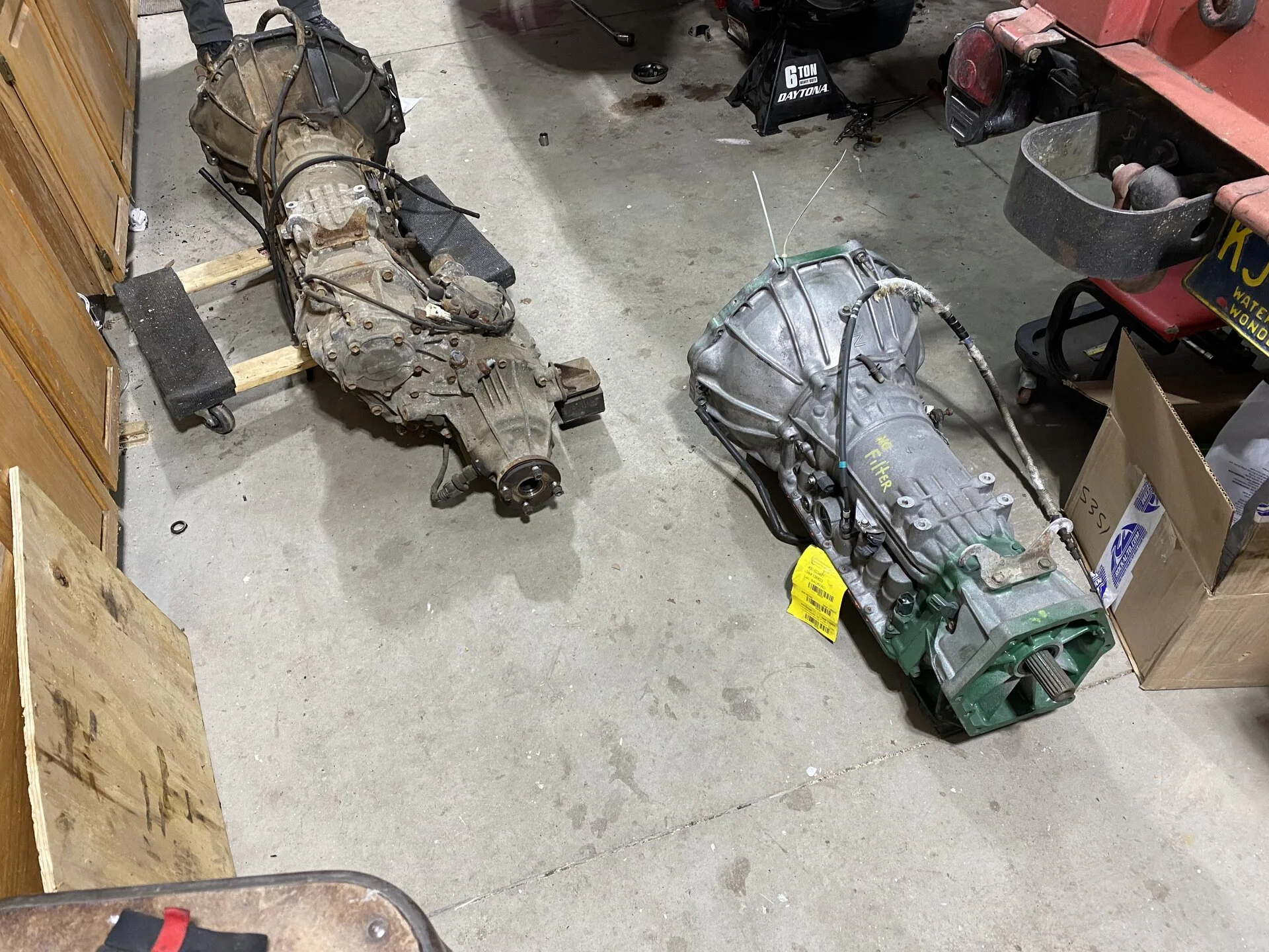

OK, so the moment that I've been waiting for finally arrived last night! After a week's worth of late night wrenching, removing the wiring harness, cooler lines, shifters, linkages, starter motor, bell housing bolts etc. the transmission has finally been removed!
Pulling out of the truck took some effort. the biggest obstacle was the exhaust hangar on the passenger side. Because of the almost non-existent clearance between the fastener and the floor, I had to use my box end wrench... which rounded the bolt head. I ultimately decided to cut it off after much consternation. You can see the remainder still attached to the bell housing.

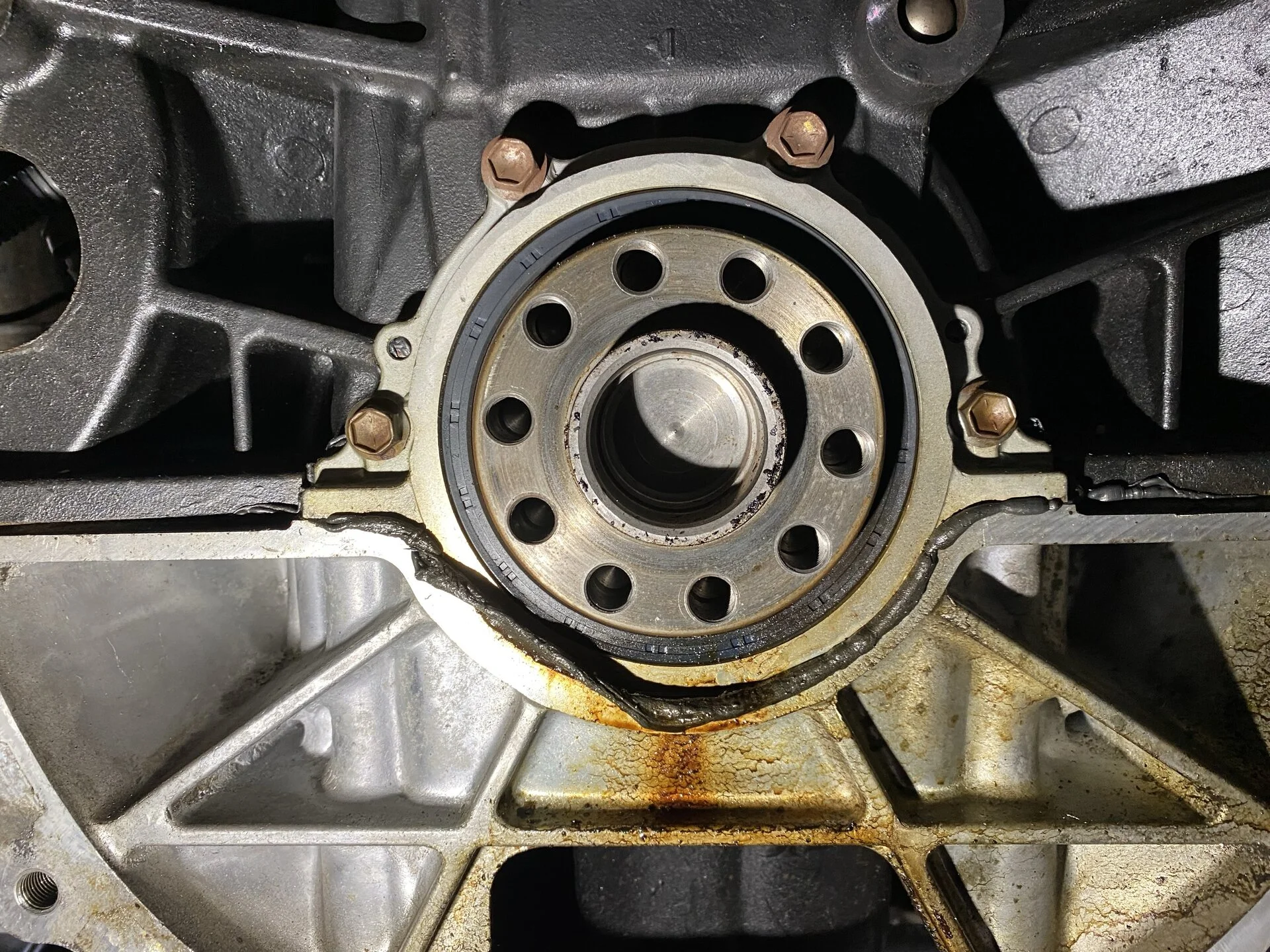

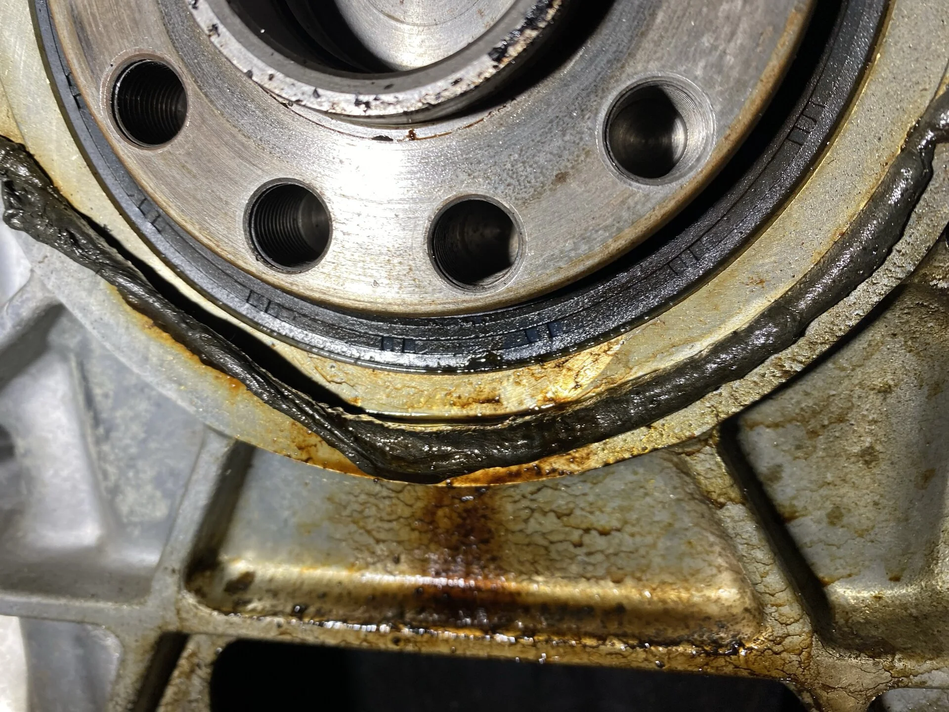

the other benefit of having the transmission out is that I could hunt down the oil leak. It's very much the rear main seal or the pan. I have a new seal and I'll remove the retainer and add new silicone to hopefully seal up this oil problem for good.
After replacing the rear main seal, I'll prep the new trans to go in.

I was able to replace the rear main seal and re-silicone the retainer. That leak should be fixed.
