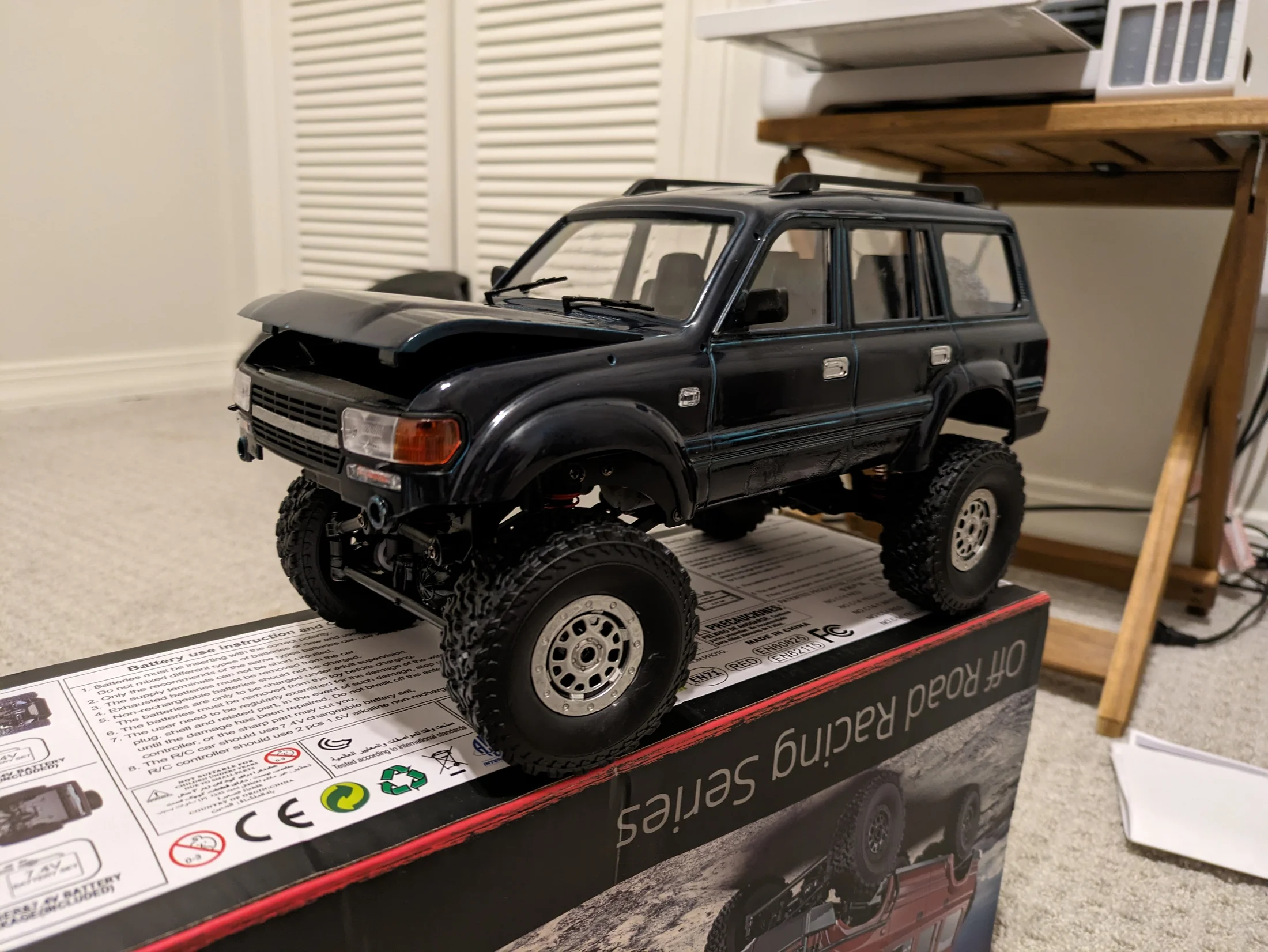

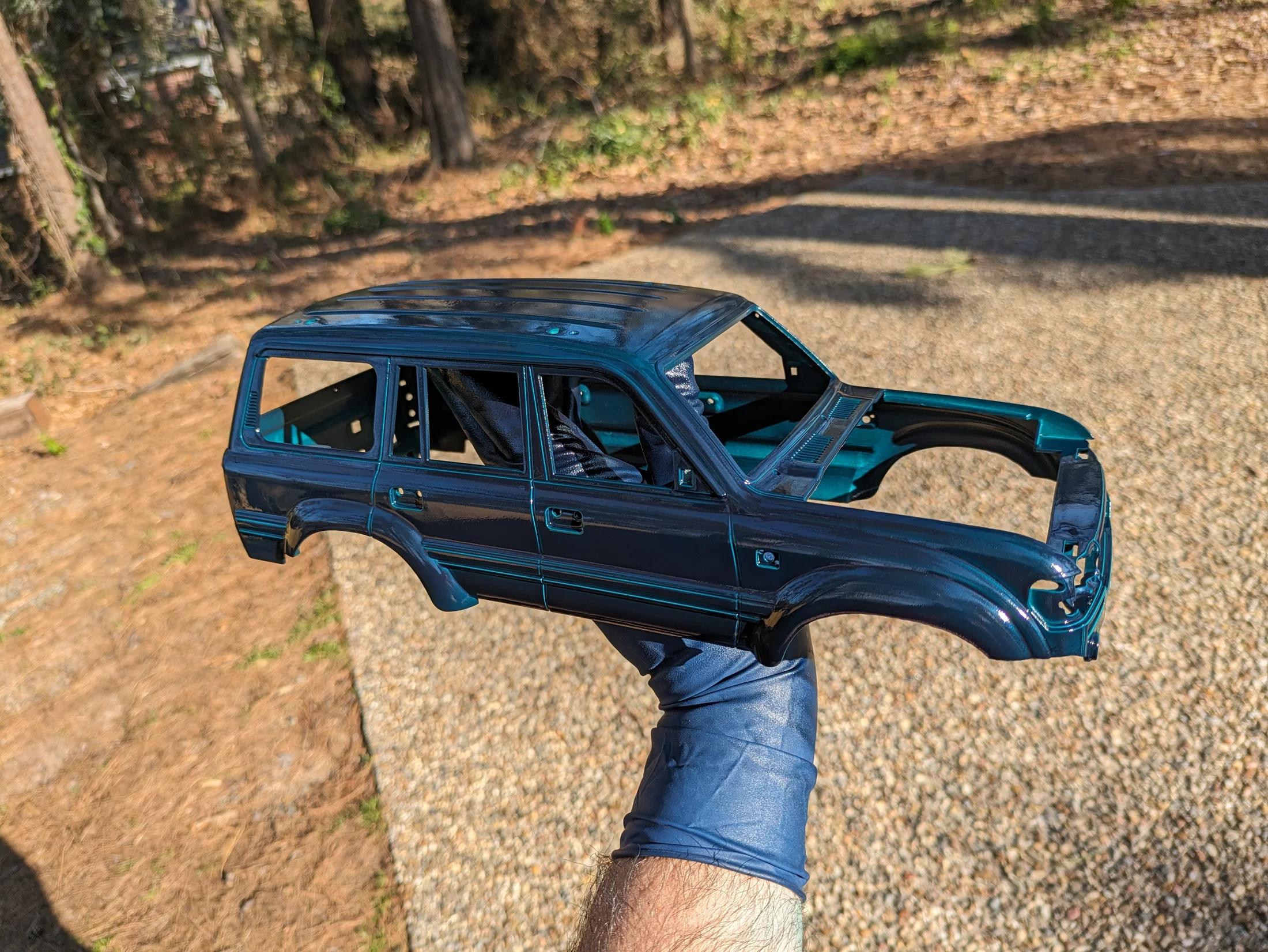

Started working on painting a tiny LandCruiser for my son. The resemblance is uncanny.

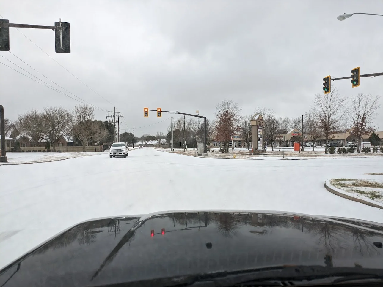

Then all of the sudden we got snow in Louisiana, I needed something from work, and I was the only idiot to drive in. I know this isn't SNOW SNOW compared to the rest of the country, but if Texas or Louisiana get snow like this, all hell breaks loose. This was Jan 2024, for a time reference.
