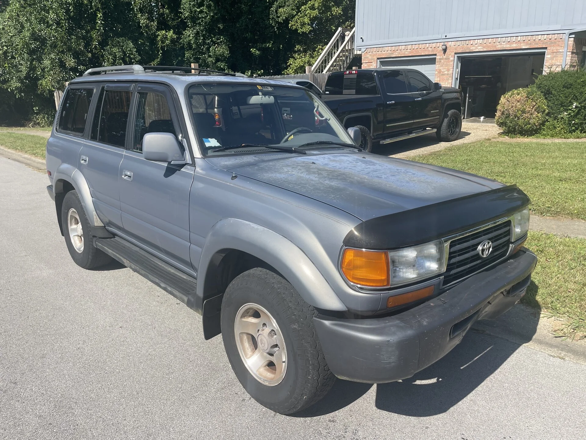

OK, so I had a little time this evening and I was able to clean the truck up a little bit. I wiped a lot of the mildew and dirt off of it and found some new not so fun spots.
Before cleaning the truck, I removed the front bug guard. It was already broken and the wife didn't like it. So it had to go. But unfortunately, as I suspected, behind the plastic was a bit of rust bubbling through. it's not too bad but I'm not sure what I want to do about it, if anything. The hood has a sun-baked look that I kind of like and removing the rust and repainting the hood would get rid of that... and then the roof would look bad. haha. Lots of mission creep if paint starts.
The other external part that needs fixing is the sunroof. it was "repaired" by someone duct taping and what looks like "body tape" or "flashing tape" applied to seal out the water... I'm not looking forward to removing this. If anyone has suggestions for adhesive removers, I'd appreciate it.

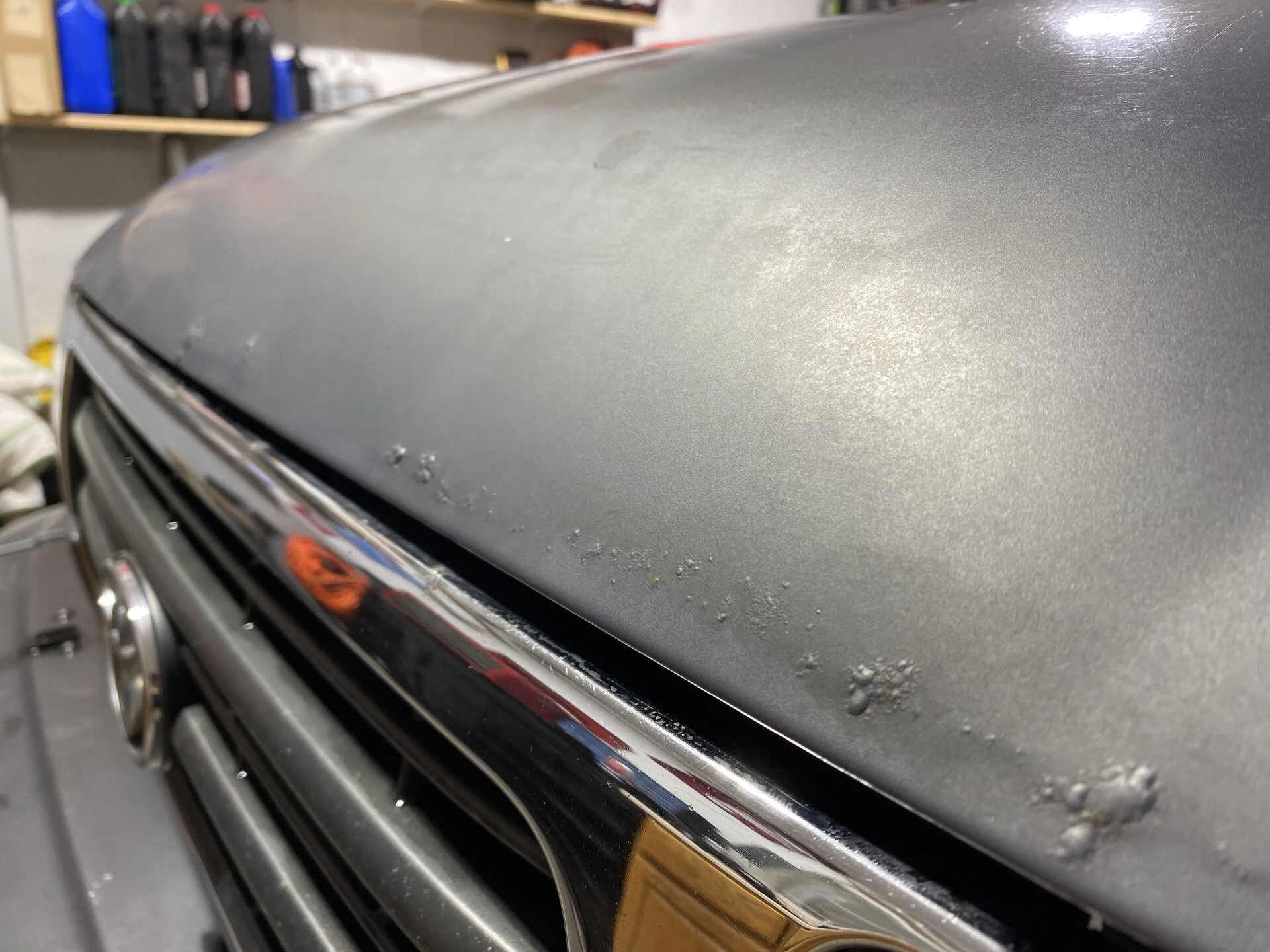

With rust forming under the paint on the leading edge of the hood, I’d suspect you will find cancerous surprises elsewhere. It might be time to look under the carpet.
The truck underside actually looks cleaner than the top. I didn’t find rust in the usually spots. Rockers, wheel well seat belt mounts, rear quarters, etc. But there is a bit on the roof rack mount. Which I’ve seen that every time too
Goo Gone may also remove/soften the paint when attempting to remove the tape, learned that lesson using Goof Off, so be careful if you use a product like that (to be clear, I'm not recommending you use it). Expect at some point you'll have to repaint at least part of the vehicle either way.
The rust in the hood is not easily repairable IMO, I'd start looking for a replacement or new OEM.

yeah, the hood is a later problem for sure.

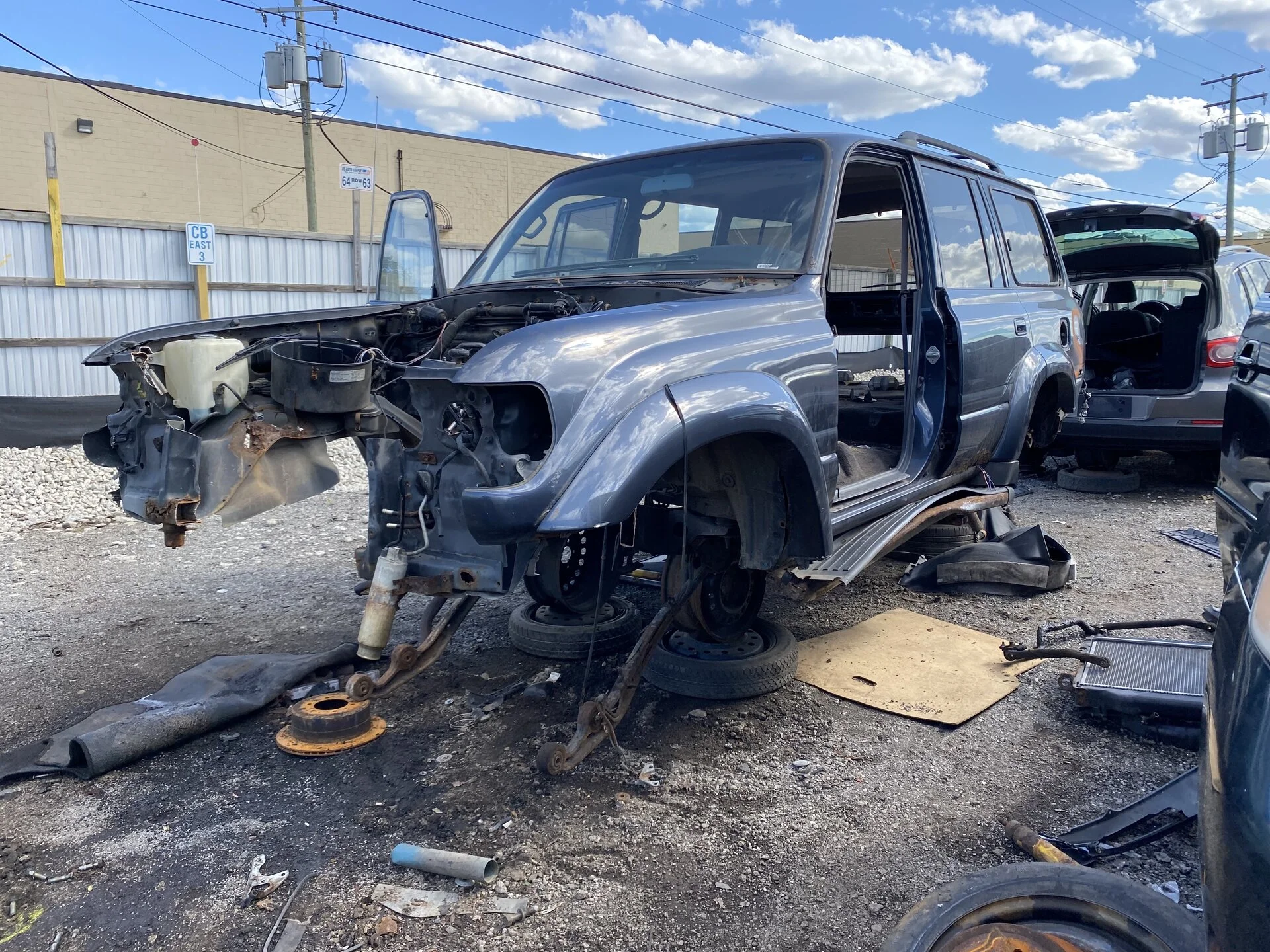

I was able to get a couple things done this weekend and both I'm very satisfied with. First, I found out that there was an 80 series in one of the local junkyards! The website said that it had been placed there at the end of September so I was optimistic that it would be mostly intact. I got there Friday after work and made the trek to the very back corner of the lost (in the Detroit area, they put the imports waaaaay in the back. When I arrived to the 80, I was greeted by this sight:
Unfortunately it had been picked clean by what I'm assuming were professionals. They came through with a sawzall and cut out the more valuable items. They removed both axles (I wonder if they were locked?), the engine, the trans, tcase, hood, driver's door, exterior lights, tailgate, etc. I was a bit disappointed since I was hoping to get a driver's door panel and switches, tail lights, throttle body, hood, etc. Nonetheless, I did make out pretty well! That above picture was taken once I finished with the truck. I was pleased to find that it had a grey interior and that the seats were in great shape compared to mine! nice and soft, mostly intact, and the leather only had a few cuts on the driver's seat. So I grabbed all 3 rows of seats to replace mine with!

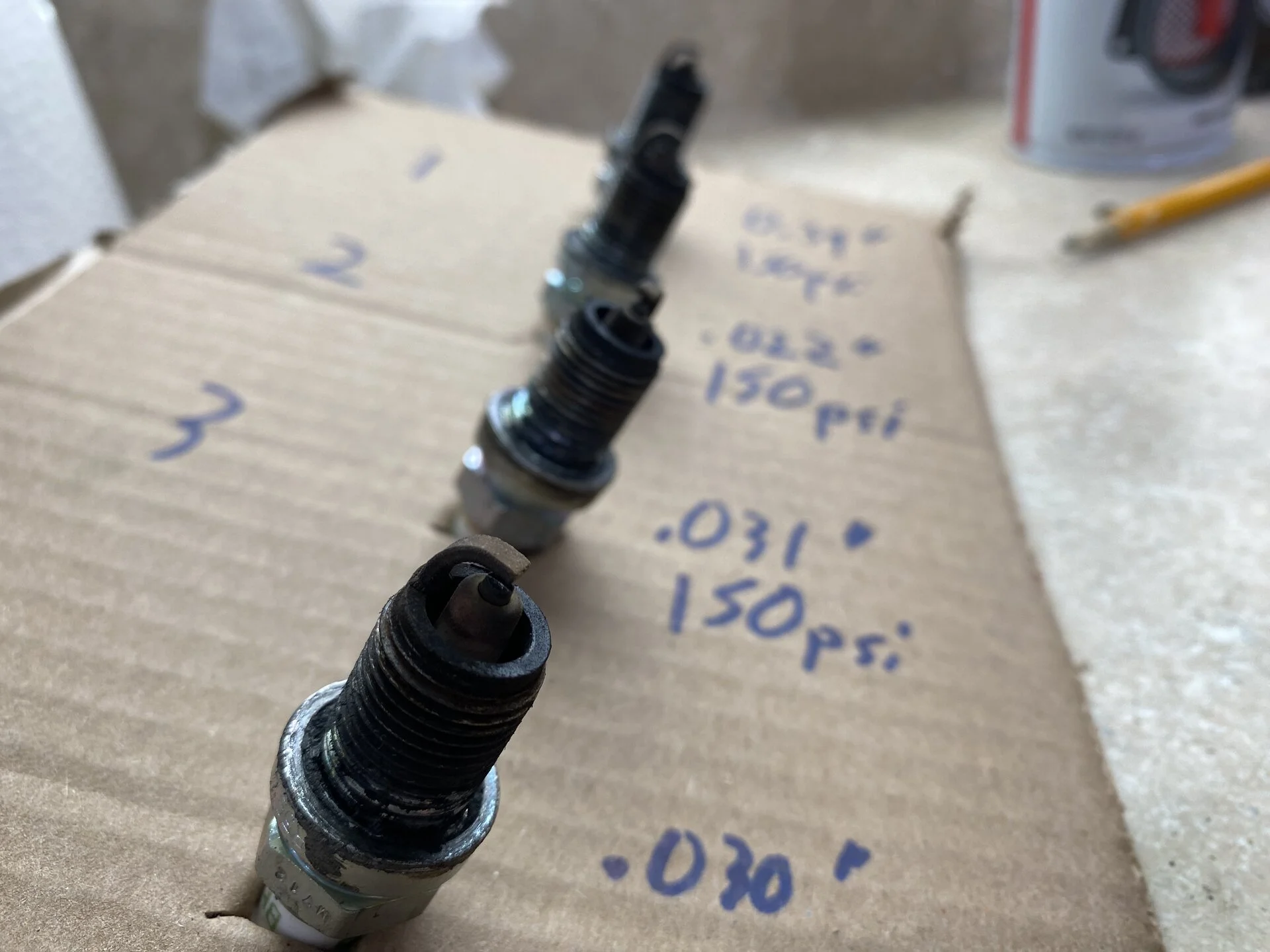

I started by removing the spark plugs and inspecting them. They all looked ok but clearly old and maybe showing signs of weak spark. Some had larger gaps near .040" and some had really tight gaps of .022". I would guess that these were the original plugs. While I had the plugs out, I also ran a compression test and got a great result! All 6 cylinders were between 145-150psi! So the engine itself is still healthy!

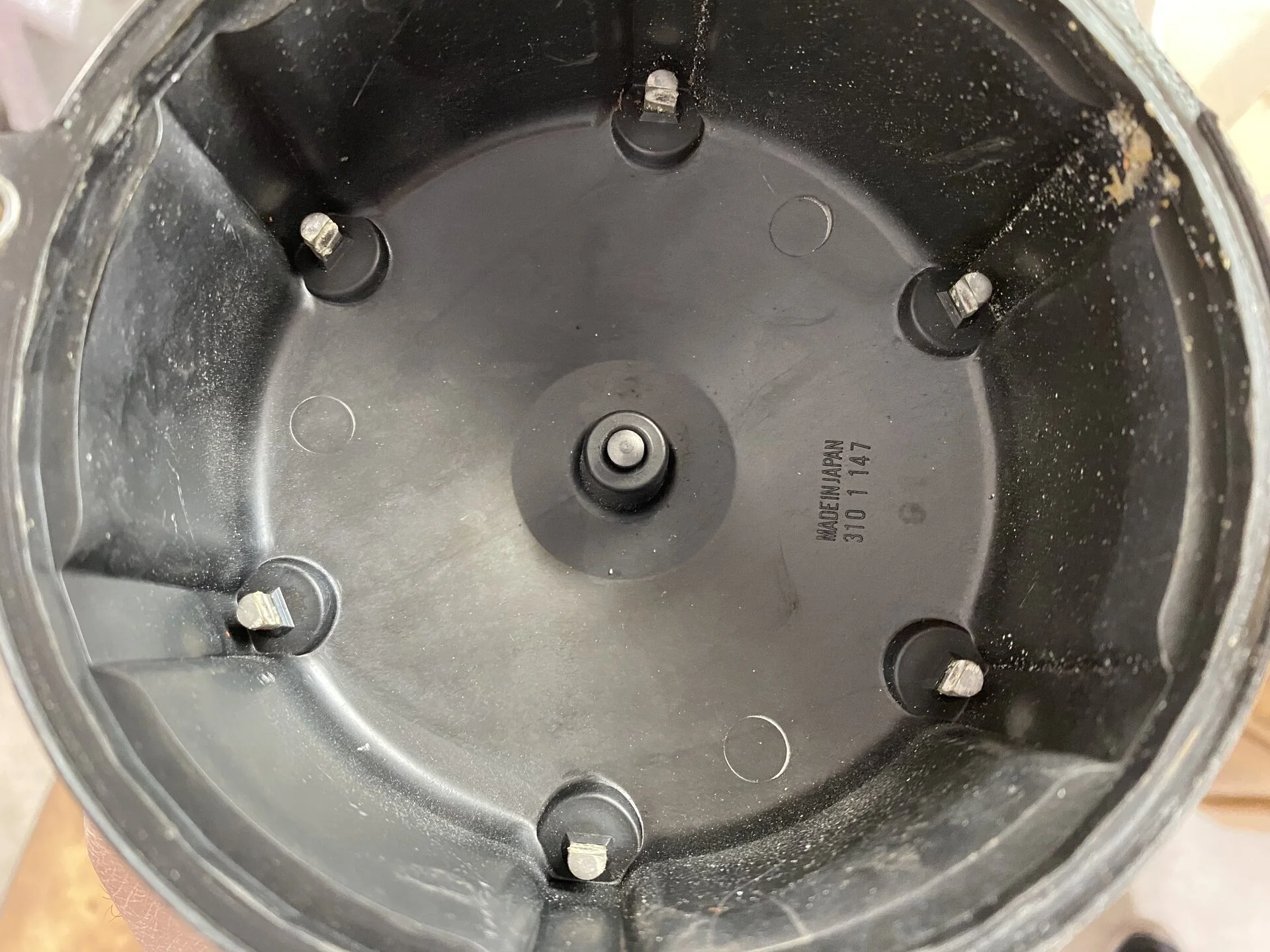

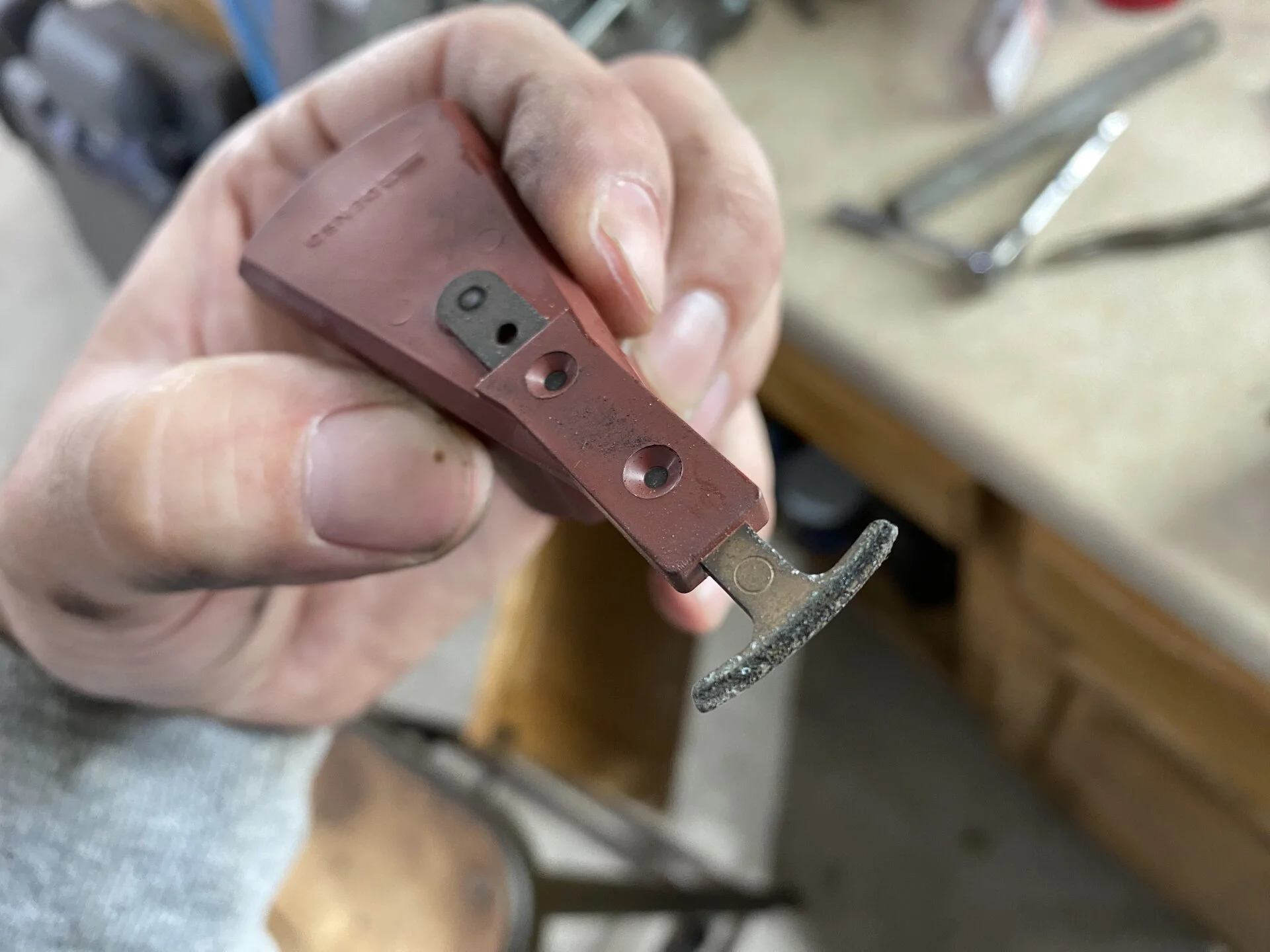

I moved onto checking the cap and rotor. When I removed the cap, I could see some corrosion on the cap points and on the rotor. They may have been ok with a quick cleanup, but parts were cheap so I went ahead and replaced them.
After replacing the cap & rotor, I replaced the ignition coil and spark plug wires. I reinstalled everything and fired the truck up and it ran normally! When revving hard, it still got a bit upset but that may just be the mix of old and new gas. I may just have to drive it for a bit to work that fuel out.
