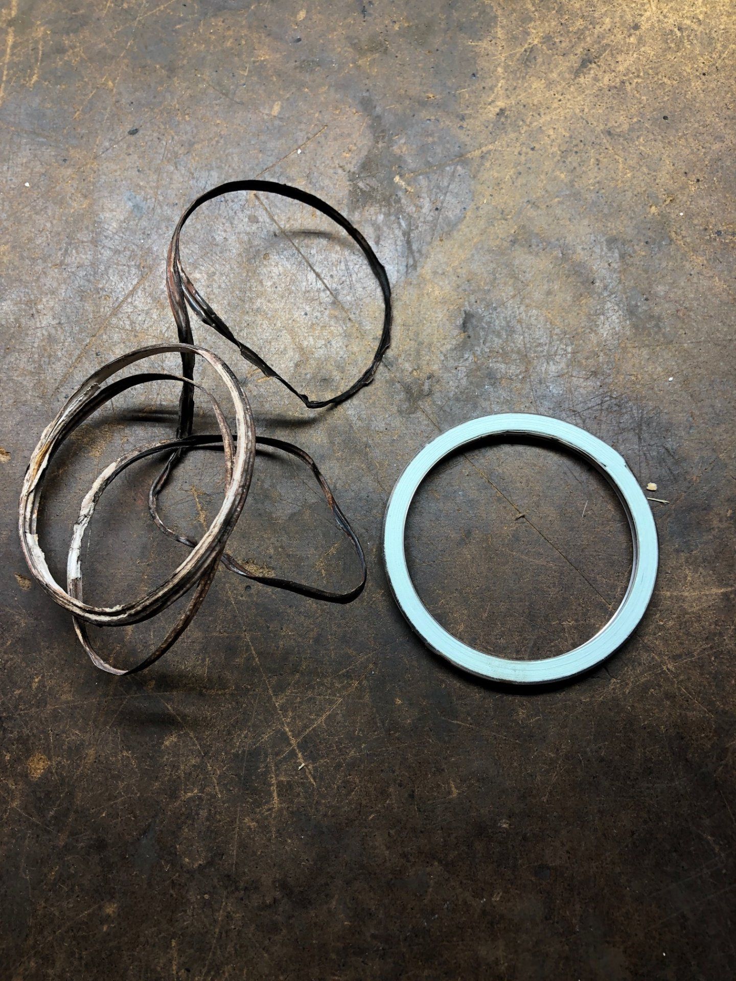

I replaced an exhaust gasket on Jack's 40. It was the donut gasket between the manifold and the downpipe and it was the most toasted gasket I have ever seen,
After removing it, I could not get the new one on top of the downpipe. I couldn't tell if there was material left from the old gasket or that the pipe had deteriorated. I had to remove the downpipe and use a hammer to lightly tap around the ring until the new gasket would fit.

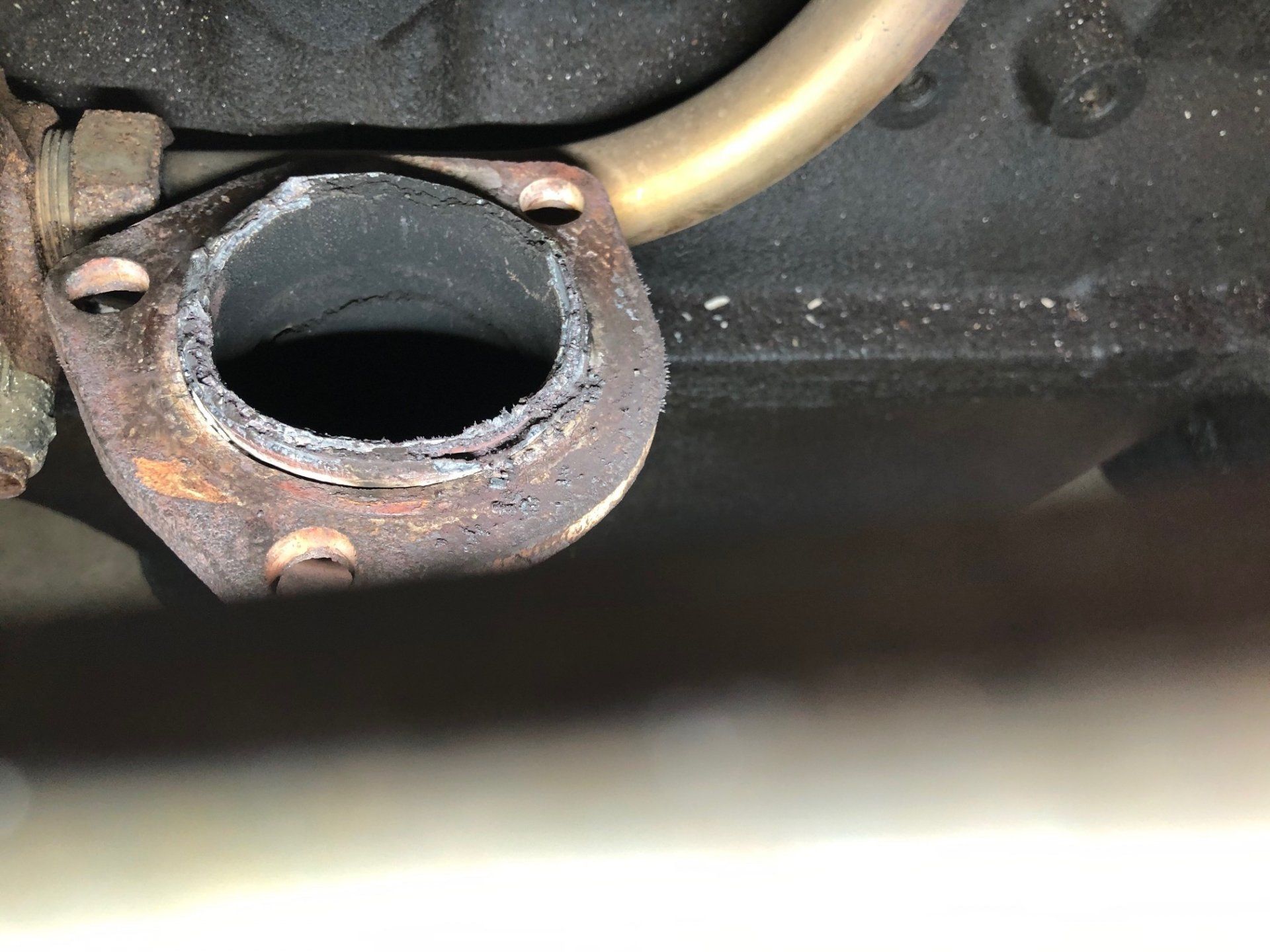

Unfortunately, after I bolted it back together it sill leaked, though not as badly as before. Any advice on what I can do to get this to stop leaking?
Your top edge looks rusted away. There should be enough room for the gasket and the 1/2 bagel shaped metal cover that compresses the gasket when torqued. I had an idiot muffler guy try to install the 1/2 bagel shaped metal cover upside down and bent the flange. It's leaked since then. I really need another stock down tube...
It's not the greatest option but muffler cement helps a lot with small flange leaks. Coat both sides of the gasket before install and let it harden before firing it up. If the flange is toast I have new ones in stainless. I could probably get some mild steel ones cut as well.
Doesn't sound easy. So, would you use a dremel or something similar to remove the old flange?
If it were me doing it at home, I would cut the pipe below the driver floorboard and repair the flange on the bench, then reinstall with a sleeve clamp.
There is a junction beneath the floorboard, so I have already had it out to get the gasket on the old flange. I just don't know if I can get the old flange out.
Not sure I understand what you mean by "out". Isn't it as simple as pull the section, cut the flange off, clean the pipe up and weld on a neck flange, using some 90* magnets to ensure it's square?
