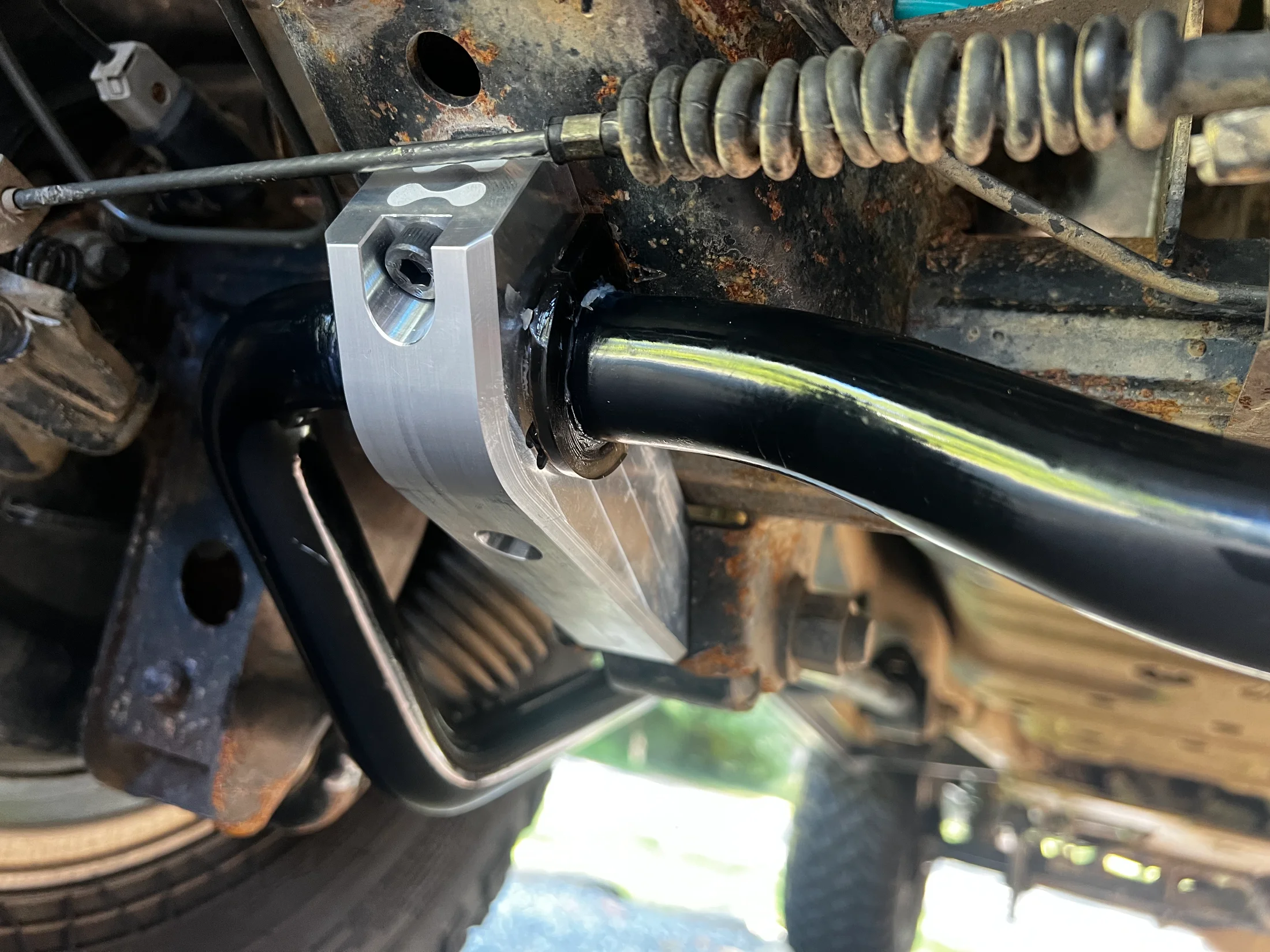

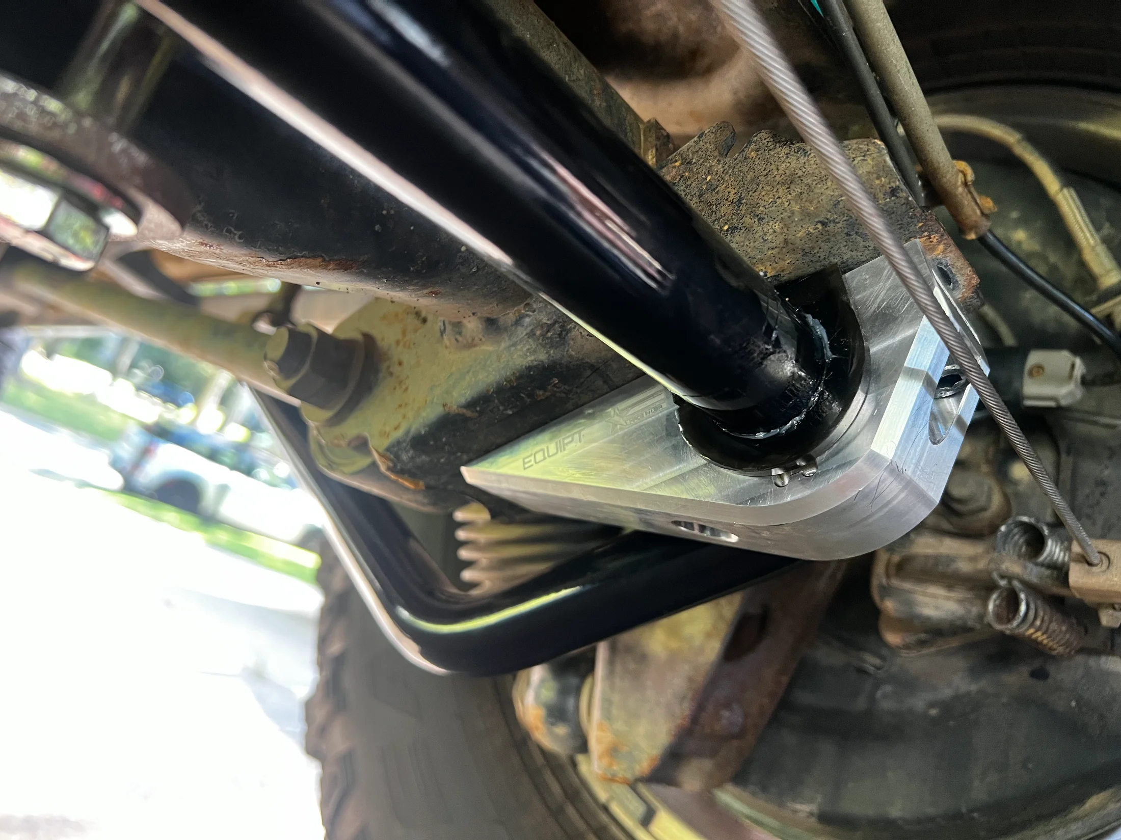

Got the @Outsane Whiteline rear sway bar brackets installed...love these! They put a nice slide angle from the rear lower link mounts off of the rear of the axle so it doesn't bash the sway bar mounts. Also installed (but not shown) Window Rocket module which dramatically speeds up the windows on all 4 doors and sunroof. Looking forward to Good Evening Ranch later this week!

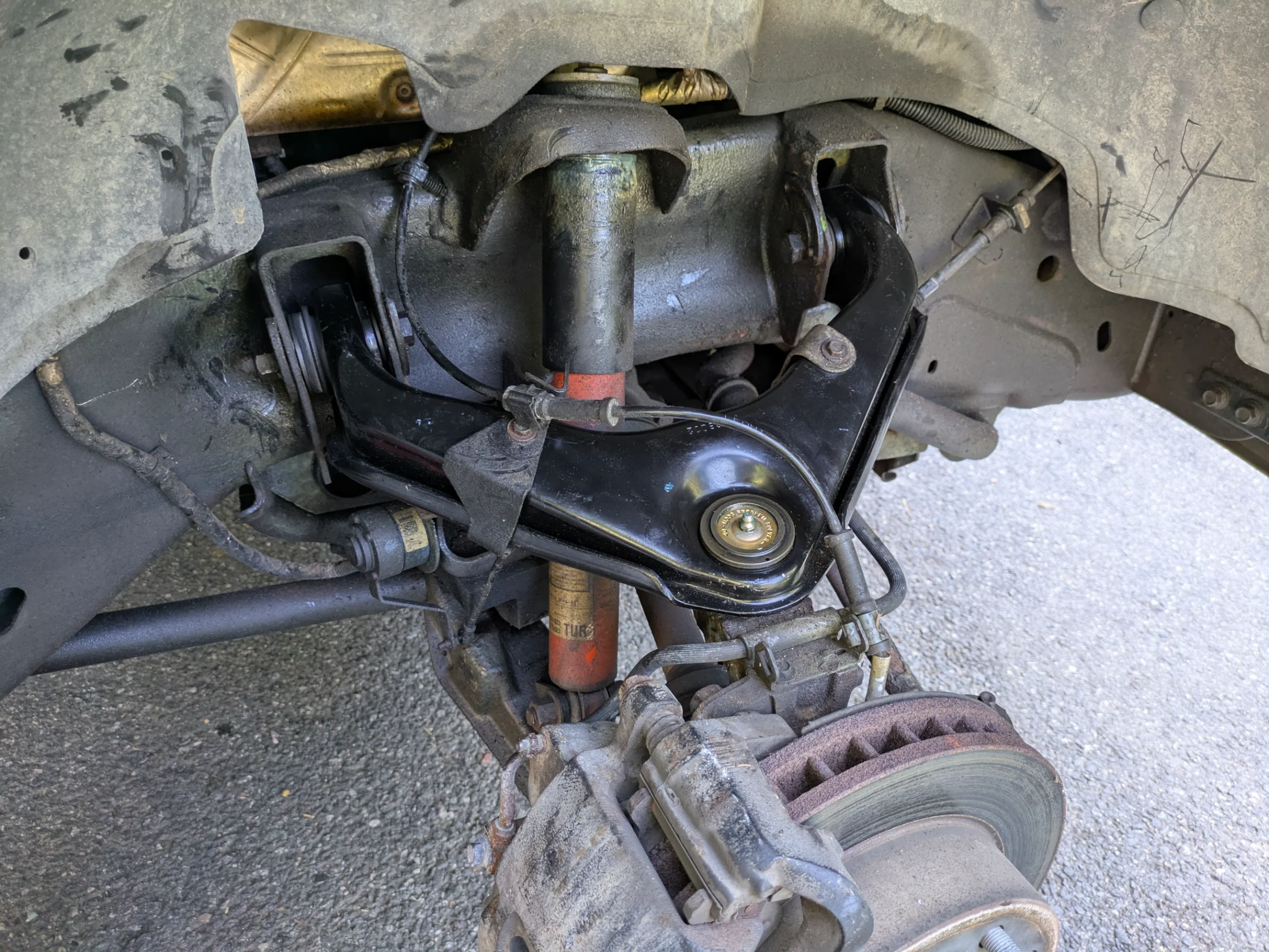

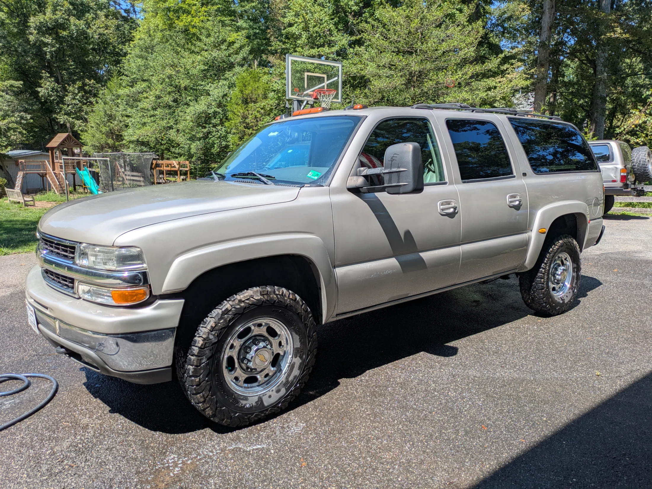

The Quadrasteer Suburban got some new upper control arms and a wash. The ball joints on the old control arms were so floppy. The smoothness in the ride is night and day.
View attachment 3976796View attachment 3976797
Those trucks ride soooooo nice. We had a 93 and 97 1500 suburban and still have our 2011. The 2011 has a new engine and freshly rebuilt auto trans ( highly recommend trans auto dynamics in culpeper) and it still cruises amazingly nice. Enjoy that one.

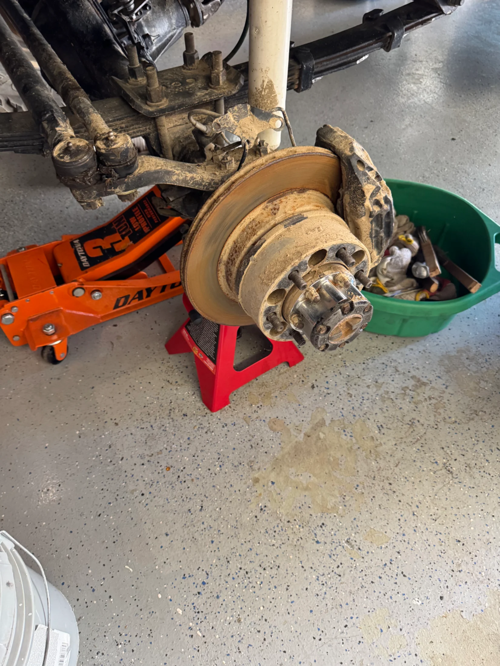

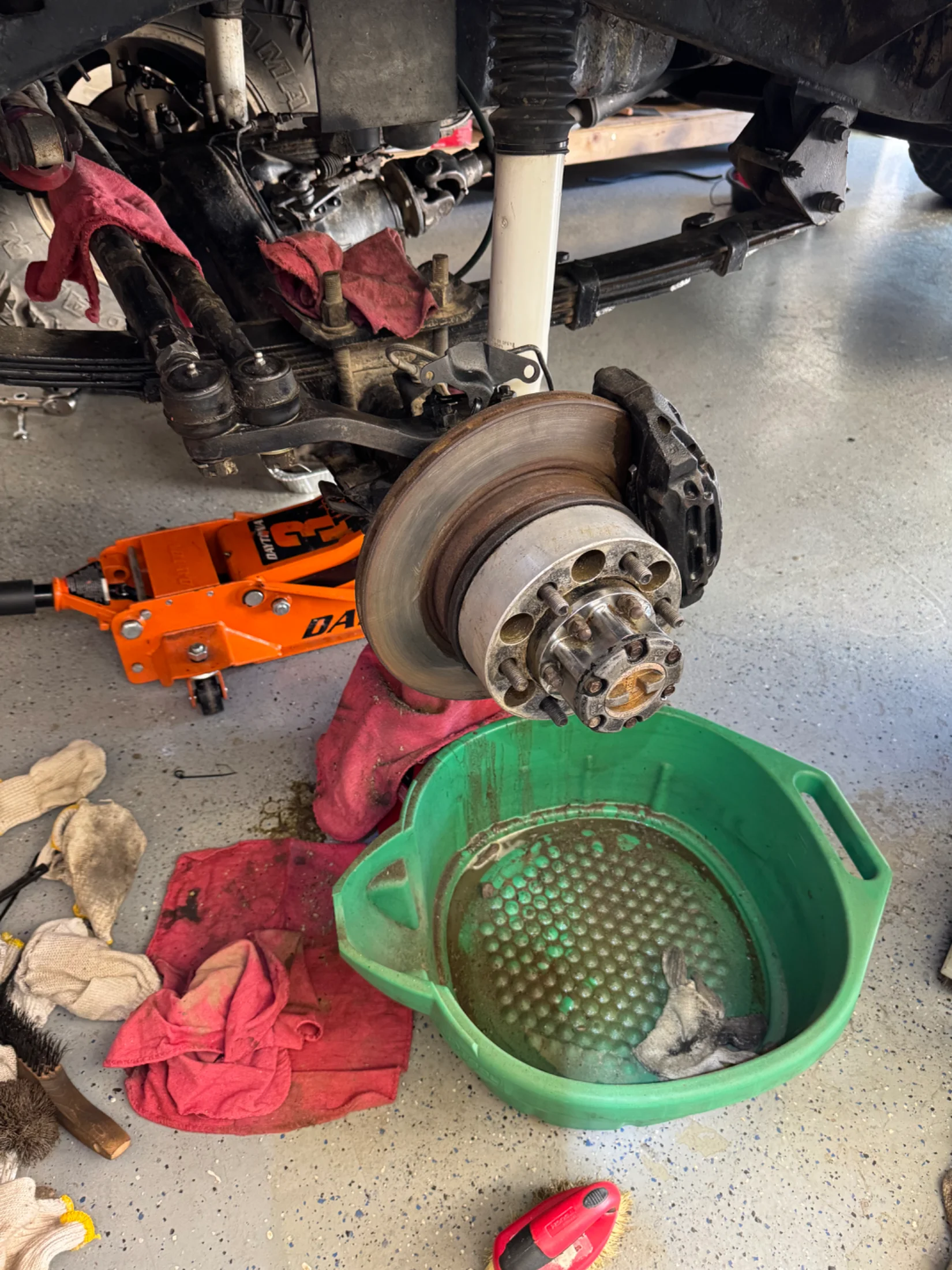

Had to remove the tire to get up at the radiator area and noticed how atrocious the brakes and hub looked even after pressure washing. Glad i found out they looked like that.
I discovered that my fan shroud could be moved (just enough, hopefully) a bit , and I was able to get my drill in there enough to make new bolt holes without having to remove the fan clutch too, so i may just have solved the issue that’s been plaguing me for years, the squeal/groany noise of the fan blades hitting the shroud sometimes under heavy load.
Had to remove the tire to get up at the radiator area and noticed how atrocious the brakes and hub looked even after pressure washing. Glad i found out they looked like that. View attachment 3977422View attachment 3977423
Nice to find a solution to a long-term issue! And good job on the brake cleanup...even with minimal mud compared to most trips, that Sh%t still gets into everything!
