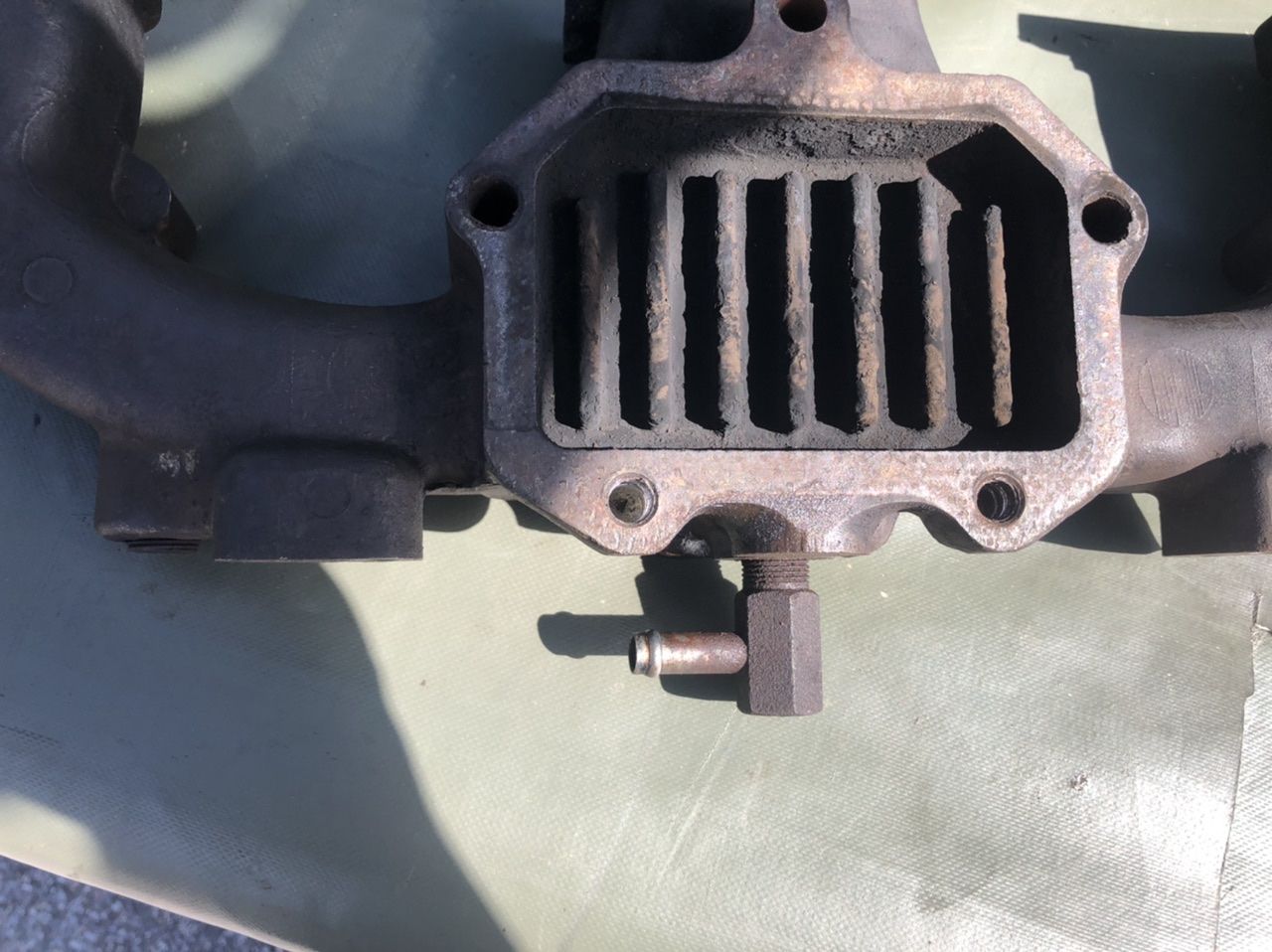

I just posted this in the 40 section, but figure I would tap the club as well.
The holes for the two short bolts that go through the exhaust manifold into the intake manifold are wrung out. The last person who did this job rethreaded one of the holes to 1.5. The other hole is 1.25 but it stripped when I took it apart.
What is the standard procedure here? Helicoils?
hmm header lol
Are you going to have the manifold shaved? I would think a machine shop should be able to recommend a good quick repair.
Same thing happened to me. I installed Helicoils that I trimmed down with a die grinder. Went together no problem. Not so sure if they will stay in place the next time I remove the bolts.
Be happy to drop the the kit and some coils in the mail if you want to try that route.
I used the mounting bolt to determine how many threads are needed and then put the Helicoil in a vise & cut off the excess rings with a Dremel and a cutting wheel. It was pretty easy. I made the length so that each end was 1 thread from the surface. If you are careful not to break the tang until you are ready, you can insert and remove the coil and trim to fit.
Doesn’t look like enough wall to put inserts in but if it is way better
