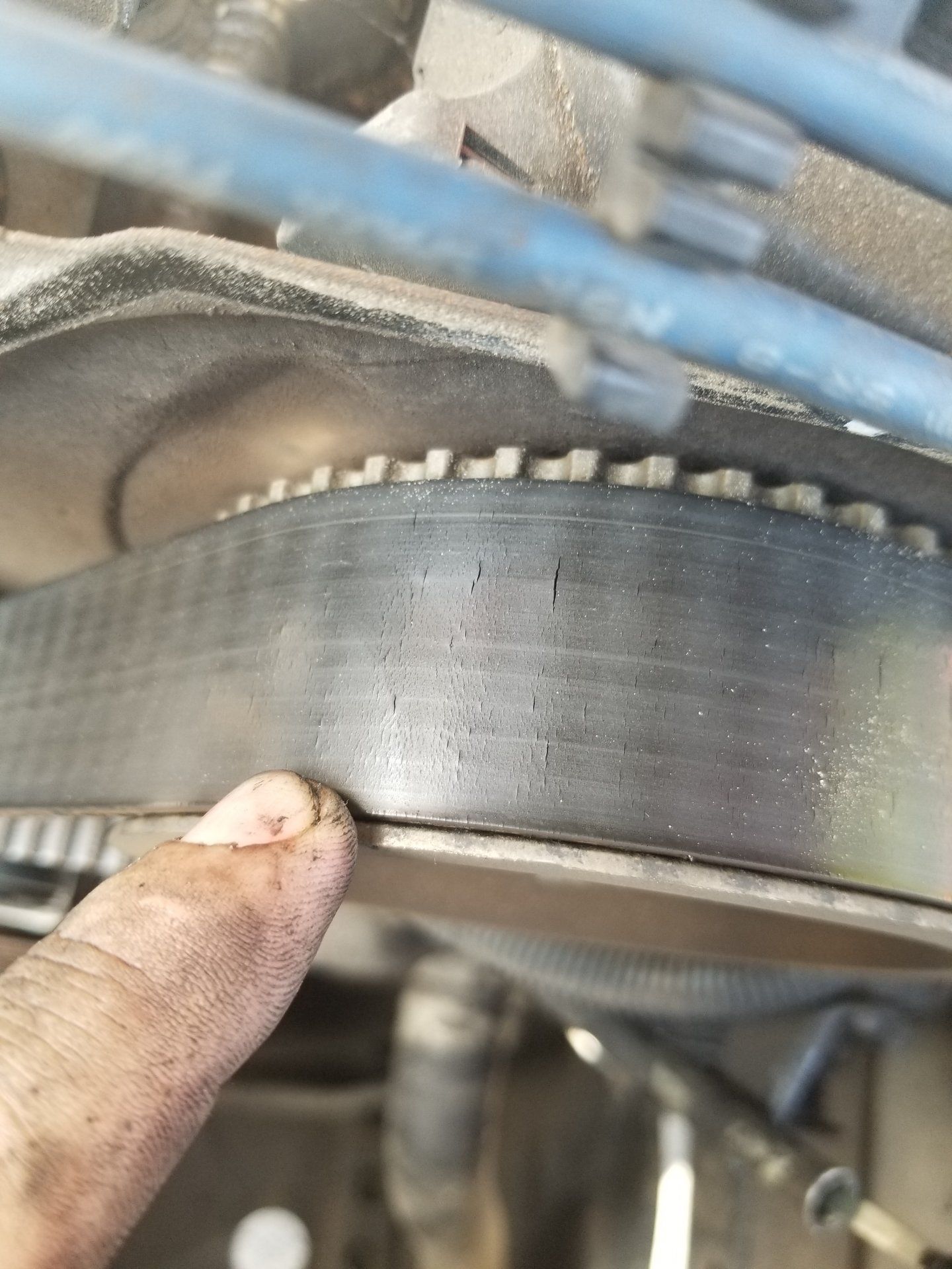

So, dug Into the taco engine. I should have looked at a schematic first to remember that the water pump is tb driven, not accessory belt driven.
That seized pulley was not an impeller grenading, just a regular pulley bearing grenading.
Anyone know what that bearing is serviceable? A new timing cover assembly is available, but I'd rather not spend $130 if I dont need to do so.
Saw that the timing belt is showing wear too, so may as well do a full job since I'm in there already.
I already have a kit in hand with all the tb parts with water pump and tensioner, but its missing the cam/crank seals. Going to wait for the remaining parts to start swapping parts.
