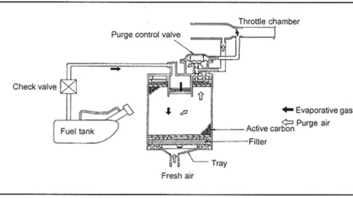

I turned the truck on last weekend, filled it up and took for a ride. once i entered the garage i heard a hissing out of the gas cap...pressure! i would like to see if my thinking is correct about how the venting will be fixed. I made sure the evaporator was free and clear. removed the broken/clogged check valve at the top of the unit. used that line that ran directly to the engine bay and put a FJ80 Charcoal canister up there. so the lines go like this... 4 from tank to evaporator separator; line at top of evap sep to "tank" side of charcoal canister. Now my gas cap reads "vacuum pressure" so to test my theory i took off a line and used my mouth the pressurize the tank. it built pressure and did not release it. moved the hose "from tank" to the "purge" port on the canister all is well but should i leave it like that? if enough force it applied to the "from tank" it opens up just not free flowing like the "purge" port.
Capped the “from tank” port and put it on the purge port because I have no emissions.
The purge port is free flowing because usually there is a fresh air vent for the purge line. When the system is purged, you don't want that vacuum being applied to your tank and pulling liquid fuel out. The From Tank line should be one way - vapors check in, but they don't check out. When your tank, and all the fuel in it cools, the system is supposed to pull air in from the fuel cap. The gas cap should also be a one way valve, it will let fresh air into the tank, but it should not let gas vapors out. Does that make sense?
Check your air flow from the evap line at the charcoal canister to the rear. It may be that the 80 series can requires too much pressure to open and your cap is leaking at the worn out fuel neck...
I’m just letting the tank vent through the purge port
How are you evacuating the gas fumes from the can?
You need to pull those fumes into the engine and burn them. Otherwise you will have a not-so-pleasant raw fuel filtered by charcoal smell in the engine bay and probably in the passenger compartment.
Make sense?
