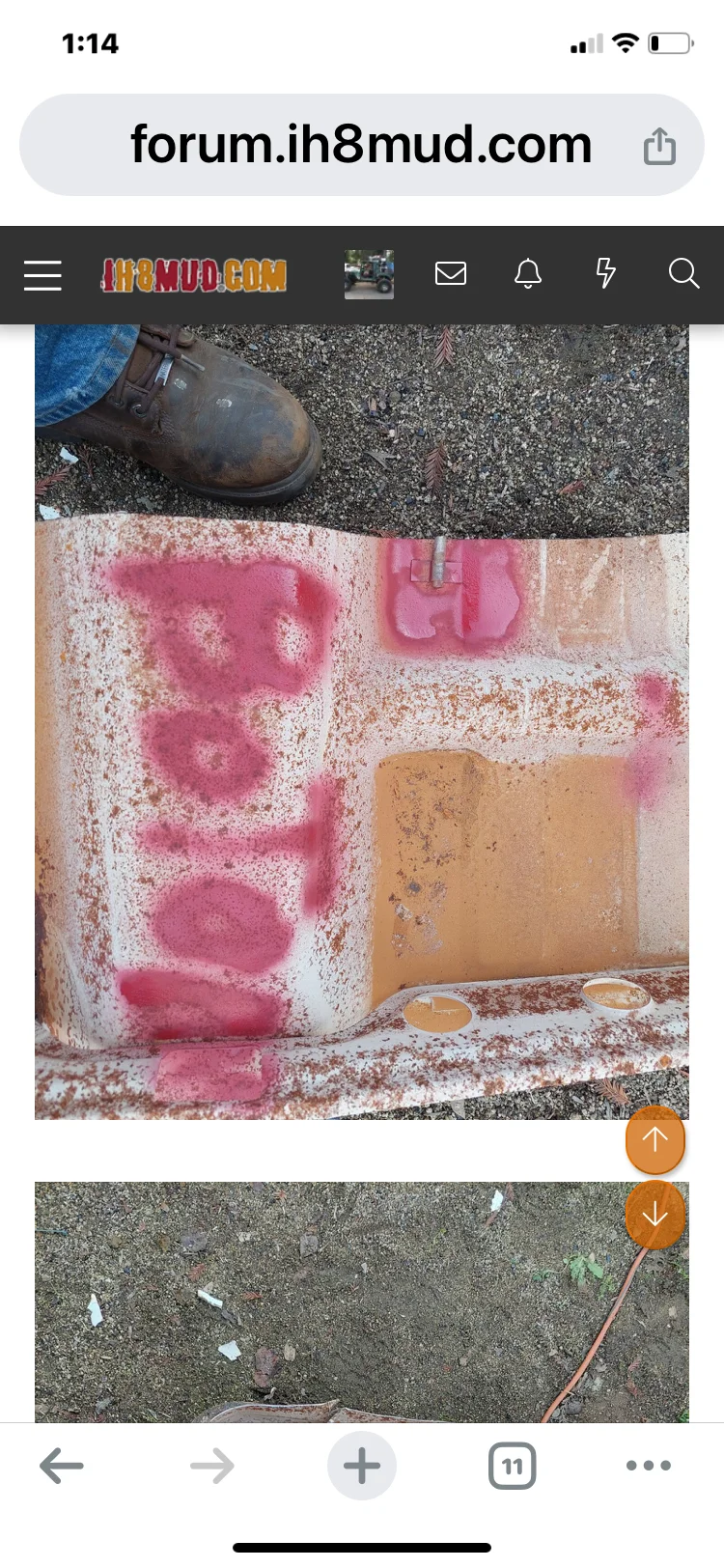

Somewhere in her we have pics of a tank someone cut open. I think the vapor lines go to each corner, so in the course of driving, one of those corners will get uncovered, even if briefly, and the vapor can escape. If the operator went crazy and overfilled the tank, now there is the volume of 4 vent lines to fill w/ liquid before gasoline enters the separator, and then the charcoal can. But I am sure it has happened...

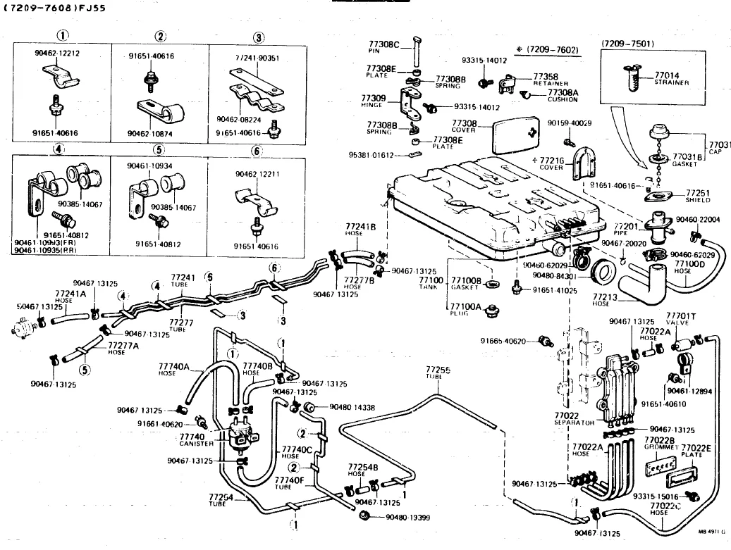

No fuel return on this 74. Yes there are two lines but the second is capped. Idk why, but according to the diagram, it’s stock that way.
I think the 77277 tube in the diagram is your return line. The line above it - 77241 is shown connecting to a fuel filter in the engine compartment.
My '74 does have a return line, and the fact that it was clogged was the bane of my existence as I tried to make my 3FE swap work. Now it very much returns!
