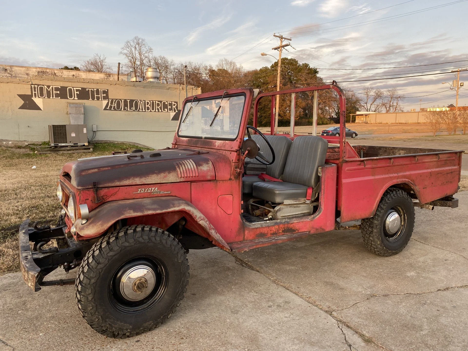

I’m working on a project that’s mostly patina paint but has bare steel on the tops of the roof and fenders, reading everything I can to see if there is a product that might last a few years on both steel and paint between touch up.
Have you looked into Ever Bright Coating? I’ve read that some guys are having good luck using it over the paint and steel but I can’t find any real world long-term reports. Restore Metal and Keep Metal Looking Its Best
Do you want the bare metal to look like it does pre treatment? If so, that’s why I like oils. It’s really easy to apply. Once it soaks in the first time it’s easy to reapply
I’ve not had to do it but you can wash it off for paint later.
I read that link. Looks like it will change the finish and be hard to get off.
Keep it simple is what this method is all about.

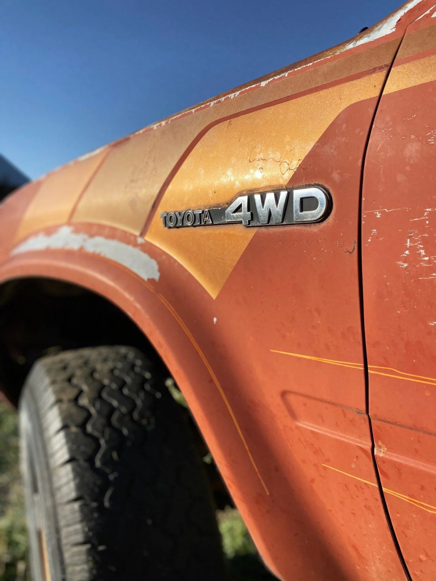

It’s a good day for some CLR and elbow grease.
I was out of Scotchbrite pads so I experimented with a steel wool pad and SOS pads.
Steel Wool for the win.
Initial clean with Zepp Orange and a plastic brush.
CLR scrub. Water off.
Spray with Griots Speed Shine.

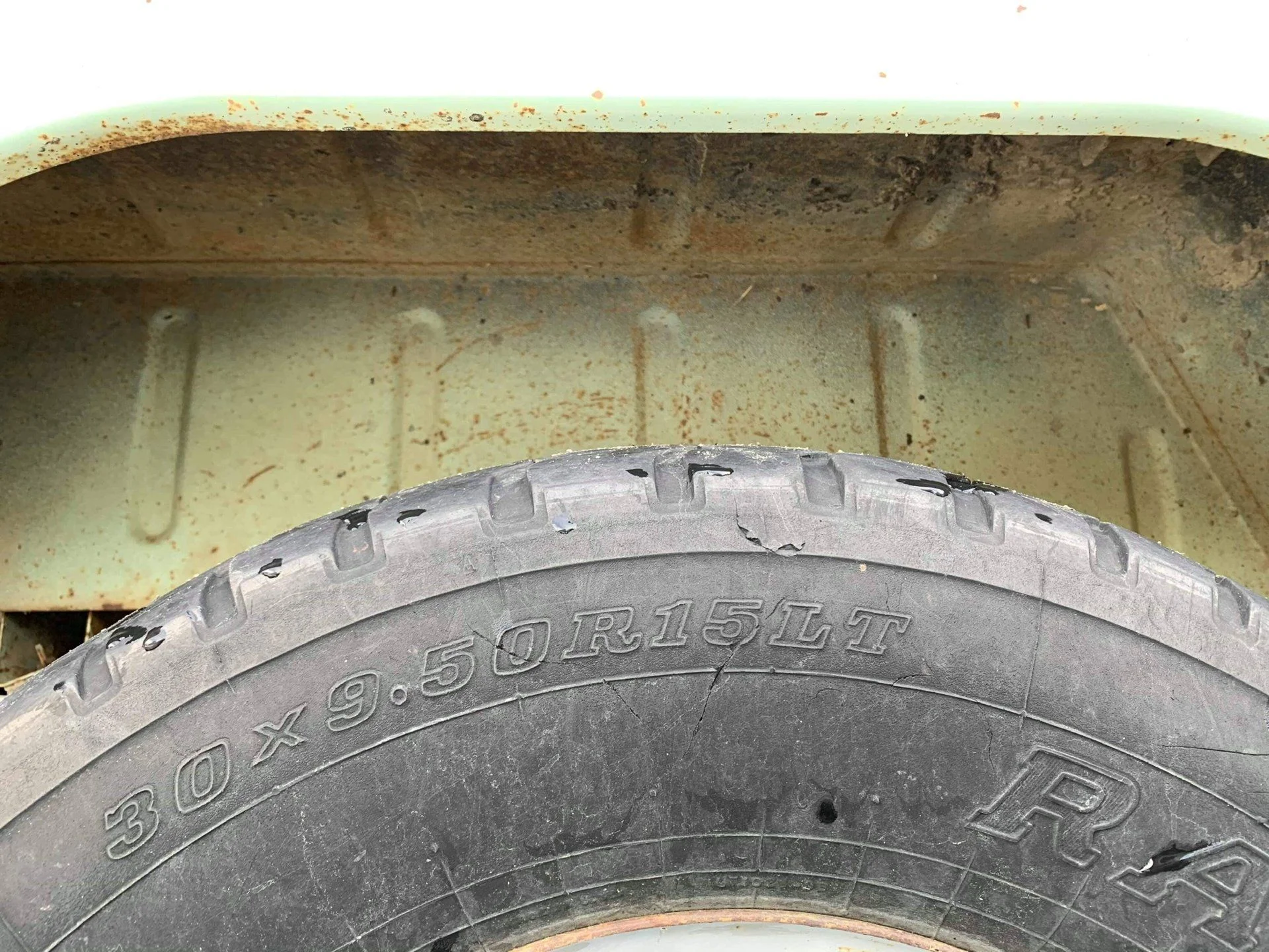

This thread is an amazing preservation resource for these machines. Thanks to all the contributors! So, I'm trying to preserve the undercarriage of what is a pretty clean 1990 FJ62. I bought an airless sprayer to apply a generous coat of Fluid-Film to everything on the bottom of this truck. and an Eastwood undercoating gun to get some of the cavities. Is there a general consensus as to how to prep for this? I have access to a dry-ice blaster and a media blaster, but I'm wondering what the best prep course is to set the stage for Fluid Film. There is minimal surface rust present, but there is a bit of road grime on a lot of stuff and oil deposits all over the place.
Thoughts on this?
What I have found is that Fluid Film does fine after just a simple pressure wash. It will soak in through dirt as well and THEN pressure wash it and it’s like a new black frame. Hose it down good with water.
Let it dry.
Coat it good with fluid film.
Drive it and use it. Repeat as needed. You will be shocked when you pressure wash it after it’s had fluid film on it a while at how black the metal is.
