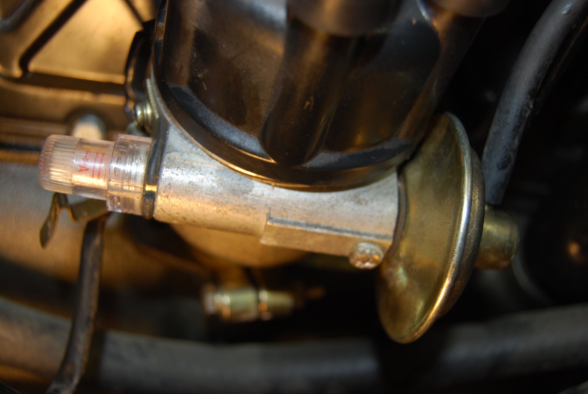

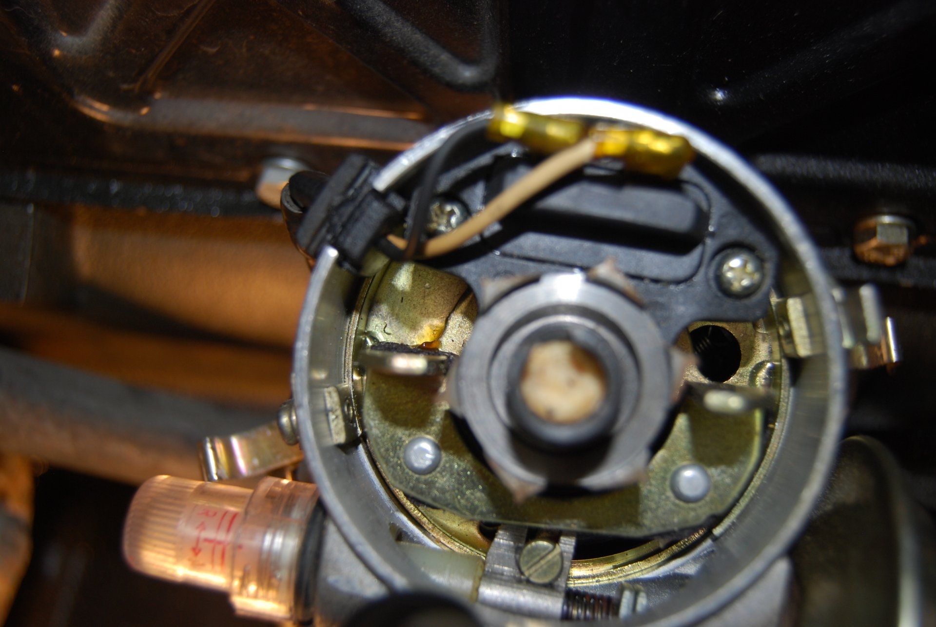

Sorry for the long post. I have searched the archives but have not found a solution to a baffling no spark situation. History: 1970 FJ40 recently acquired. Was running fine. Removed after-market carburetor and replaced with OEM rebuilt. Vehicle started and ran fine. Took her for a test drive of about 3 miles. She died. Would start and drive a bit and die. It didn't seem fuel related. Got back home and determined no spark by pulling spark plug wire. But I could get her to intermittingly start but same thing after about 5 minutes she would die and then testing showed no spark. Now I cannot even get her to intermittingly fire. The ignition is definitely not stock. Looks like an electronic ignition was put in but I need help identifying. I'm asking for help because I'm stumped. I bought a new coil. I've tried jumping a ground from the battery to the negative post of the coil. I tested 11.87 volts with a multimeter at the coil with ground to battery. I'm at wits end. Do you think it could be the module in the distributor? How would I even test?

isn't this a OEM TOYOTA NipponDenso Unit small cap , with a aftermarket type Electronic aftermarket PERTRONIX Copy Cat set up installed inside it in place of the factory point set up ?
those 2 gold / yellow insulated FLAG terminals are a HUGE RED Flag from what i know and can see in the fuzzy but sorta ok'ish photos above ?
perhaps Dr. NipponDenso / @4Cruisers and Mark A / @65swb45 can chime in about these observations .......... 🤔
or
since it's overall way too clean and pretty inside a entire aftermarket AMAZON type unit all together ?
if this is the case in either way ?
then a simple Diagnose and Verify , that aftermarket igniter pickup thing should be the #1 place to start to see if it is functioning ?

That doesn't look like an OEM distributor. Too many telltale signs, especially w.r.t. the breaker plate.

Late to the party but that's not my dizzy.
It's much different than Marshall's distributor - an extra small cap distributor (early F engine or non-US) with an unknown breaker plate/pickup coil set-up. I haven't seen one like that before. Maybe at one time the PO had installed a Trollhole distributor.
