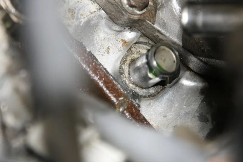

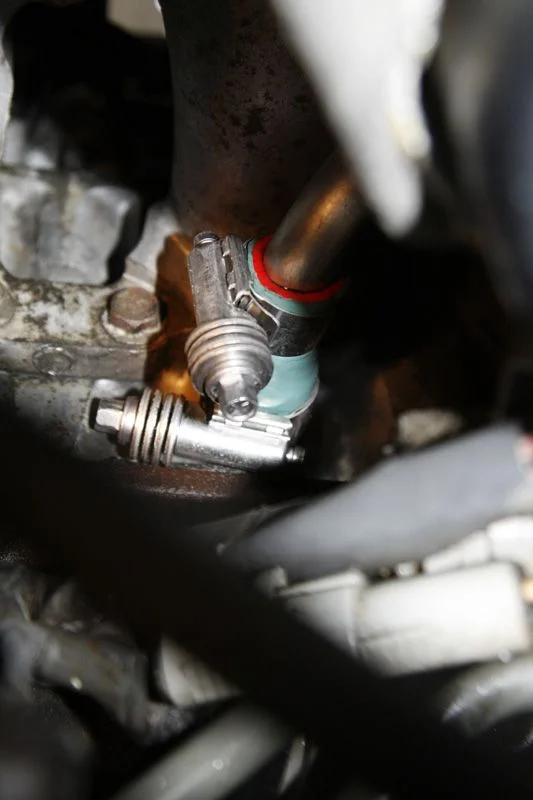

I did the PHH recently and had a fear from all the comments posted, but found it wasn’t that hard after all (thanks to all the comments and posts). I came very close to having a local shop do the work, but glad I decide to go for it myself.
1. I removed the top bolt and left the lower bolt alone.
2. I cut the crimped hose clamp with dikes and used needle-nose pliers to slide the other clamp off. No special tools.
3. I grabbed the PHH with channel locks and rotated a few times to break it free and then just pulled it off by hand. I rotated the hard tube to remove the PHH in one piece. This bends the hard tube at the mid-bolt mount but keeps it attached, no need to break it off.
4. Installed the new hose and clamps. Done in less than 30 minutes.
5. Drink a #6.
My PHH was in excellent condition. It is in my spare parts bag. I don’t see the need to remove the hard tube and think it is actually easier to just keep it in place. Hope to get another 200k out of the replacement.
A few picts:
View attachment 525148View attachment 525149View attachment 525150
