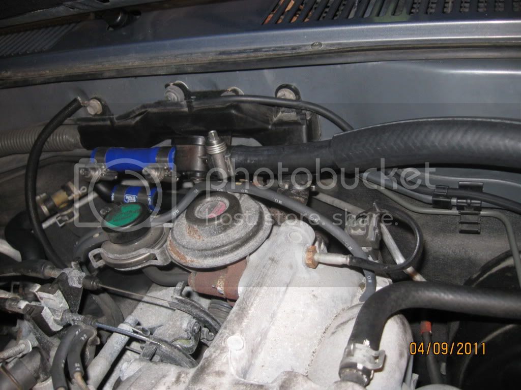

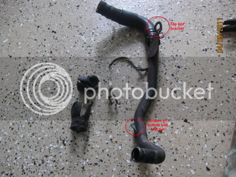

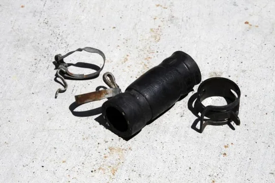

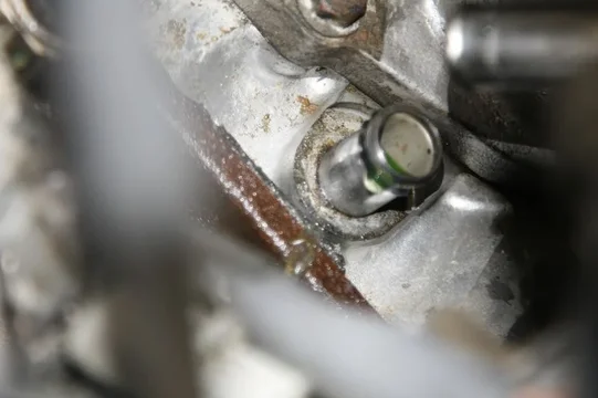

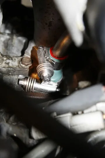

Just wanted to thank everyone on this thread. I did this couple weeks ago and it was a success. I wanted to share my experience for anyone who's looking at this thread and of course wanted to share my photos ;p
Couple of Comments:
1. I can get to the PHH by turning the wheel all the way to the right. Thanks to mattafact.
2. The BIGGEST issue for me was "the bottom bolt" on the metal tube. I can't get my tool on it, so I just rocked in back and forth to break it off of the bracket.
3. I wore an eyeglass protector; bumped into parts quite a bit and watch your head
4. I ended up using 3ft and 10 inches of Gates green stripe for the bypass and sleeved it up w/ 1" regular heater hose from Napa
5. Thanks to Brett (Houston FZJ80) for the FHH and PHH kits
Here's the photo album.
Here's my troublemaker.
Here's the final result.
