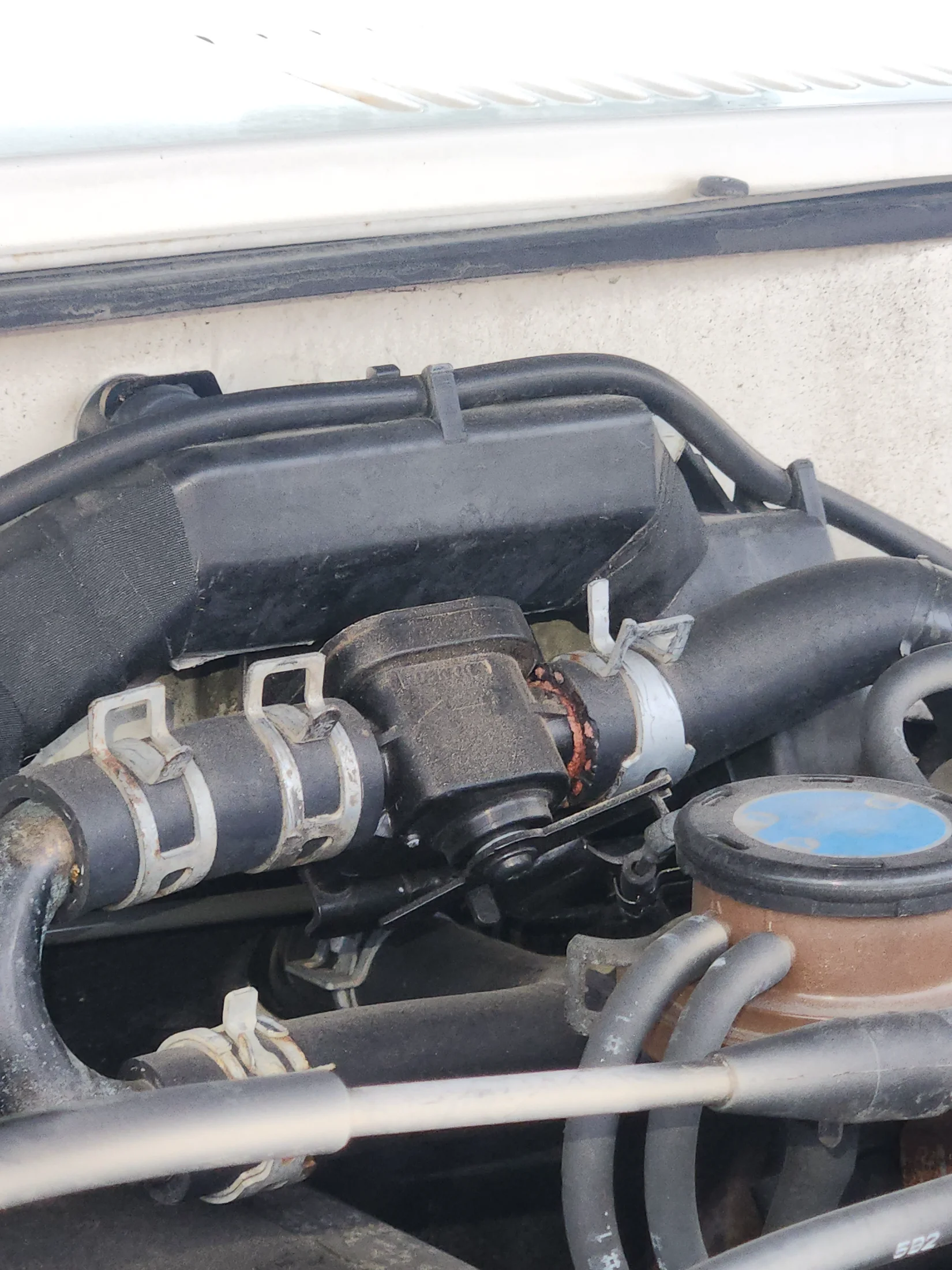

Ive been monitoring a coolant leak on one of my heater hoses. Doesnt seem like the leak is getting worse so Im attaching a pic to ask if this is something to worry about? Maybe replace the hose already? Looks new as my mechanic baselined it last February.
I have a camping trip 3 weeks from now so getting the truck dialed in to make sure its good to go. TIA
I would replace the heater valve. Yours isn’t the worst I’ve seen, but that is one way those heater hoses start to leak.
Get in there, get your hands dirty and see exactly why it’s leaking. Maybe just need a tighter clamp ? I just did a rear heater bypass hose and rockauto has the valve for about 25$.
The hoses appear generic and cut to fit.
Best guess is the clamp is not squeezing equally or tightly enough around the hose to make a good seal.
However as already mentioned it might also be a crack in the side pipe to the heat control valve so the only thing to do is to disconnect the hose on the right in the photo and carefully inspect the side pipe for cracks and the hose for defects.
If you find nothing, a quick fix might be to purchase a BREEZE Constant torque clamp based on the OD of the replacement hose.

I will check it out if to see if there are cracks. Followup question, do I need to drain the coolant for this process? I do not want to get to that scenario if I am just checking for cracks. Might as well replace the actual valve if I will be needing to drain the coolant anyways.
I would wait until you are ready to do the valve as you will be losing a bit of coolant in the process. The is the top of the system so you won’t lose much

No you don't. If the valve really is fairly new I'd just work on that hose.
The valve is not as brown as the 30 year old valve I took off ours a year ago but the plastic has an awful lot of brown discoloration like my failing radiator..
I can guarantee that the valve and hose were replaced last February. Anyway ill check them out myself i want to learn to work on my rig if its just some light work like this as I should be 🤣
Last Night i wiped the area down. Ill monitor it the next couple of days if the coolant sip comes back to see whats going on.

From the picture you posted you see the pink, dried up coolant around the fitting of the valve, but the telltale sign is you see the internal threads show pink as well. That indicates a leak originating from inside diameter of the hose, leaking through the internal threads until it reached the hose end where it attaches to the heater valve.
Replace that hose ASAP regardless of its age. Most likely the hose was damaged during installation.
The exact same happened to me. Replaced that heater hose and the valve, fixed the issue and never returned. Part number for new heater valve is
87240-60130
