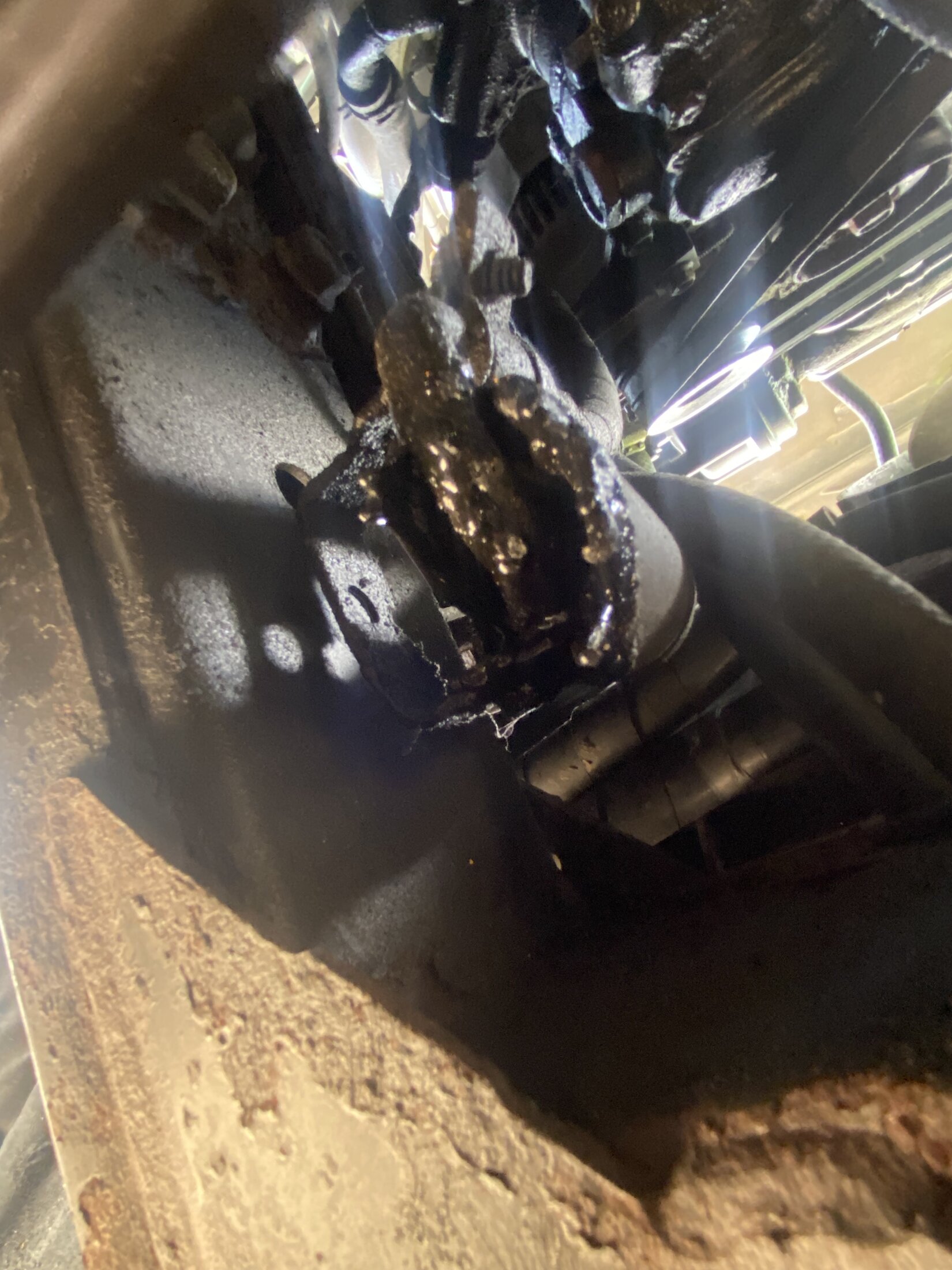

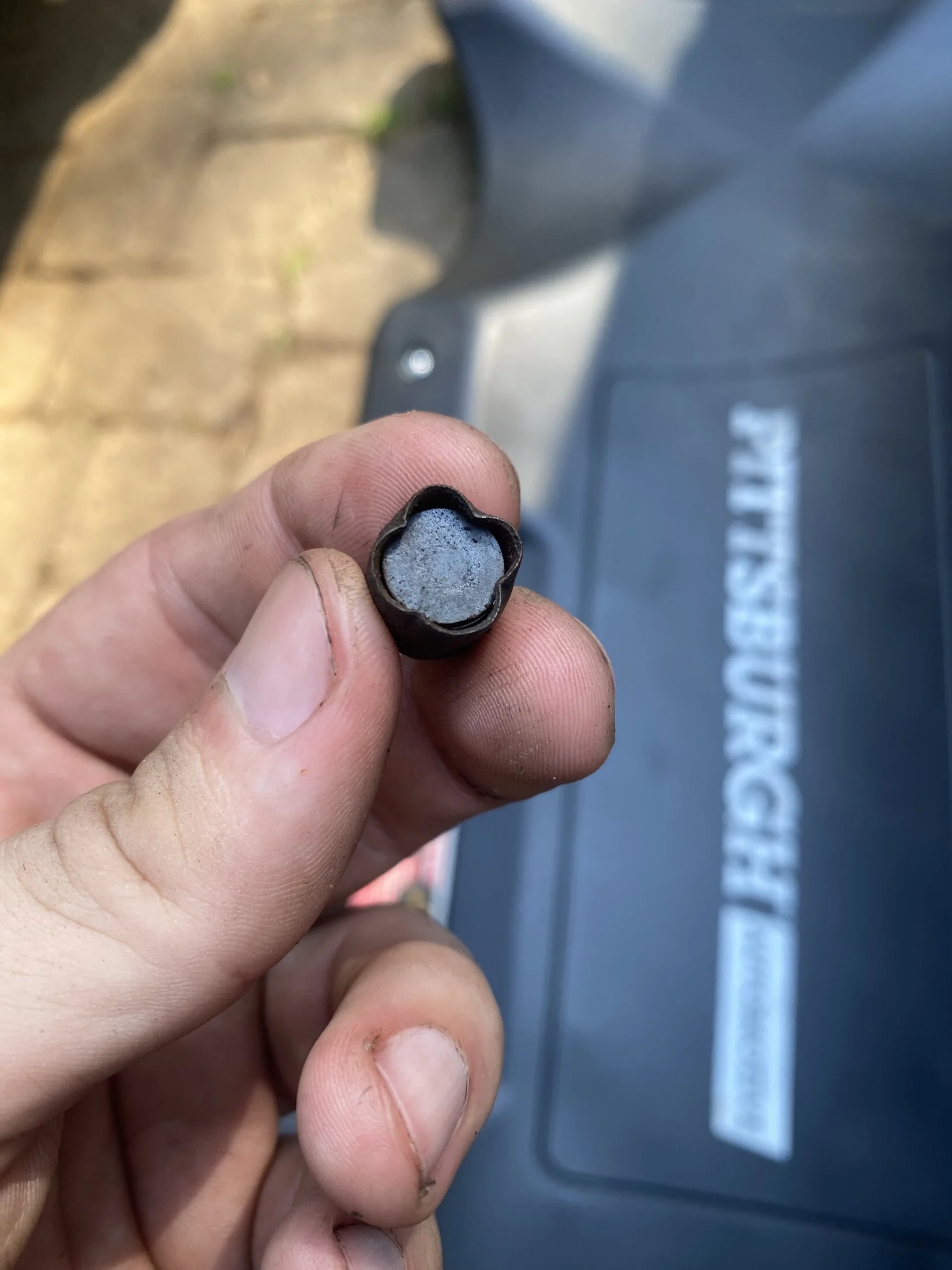

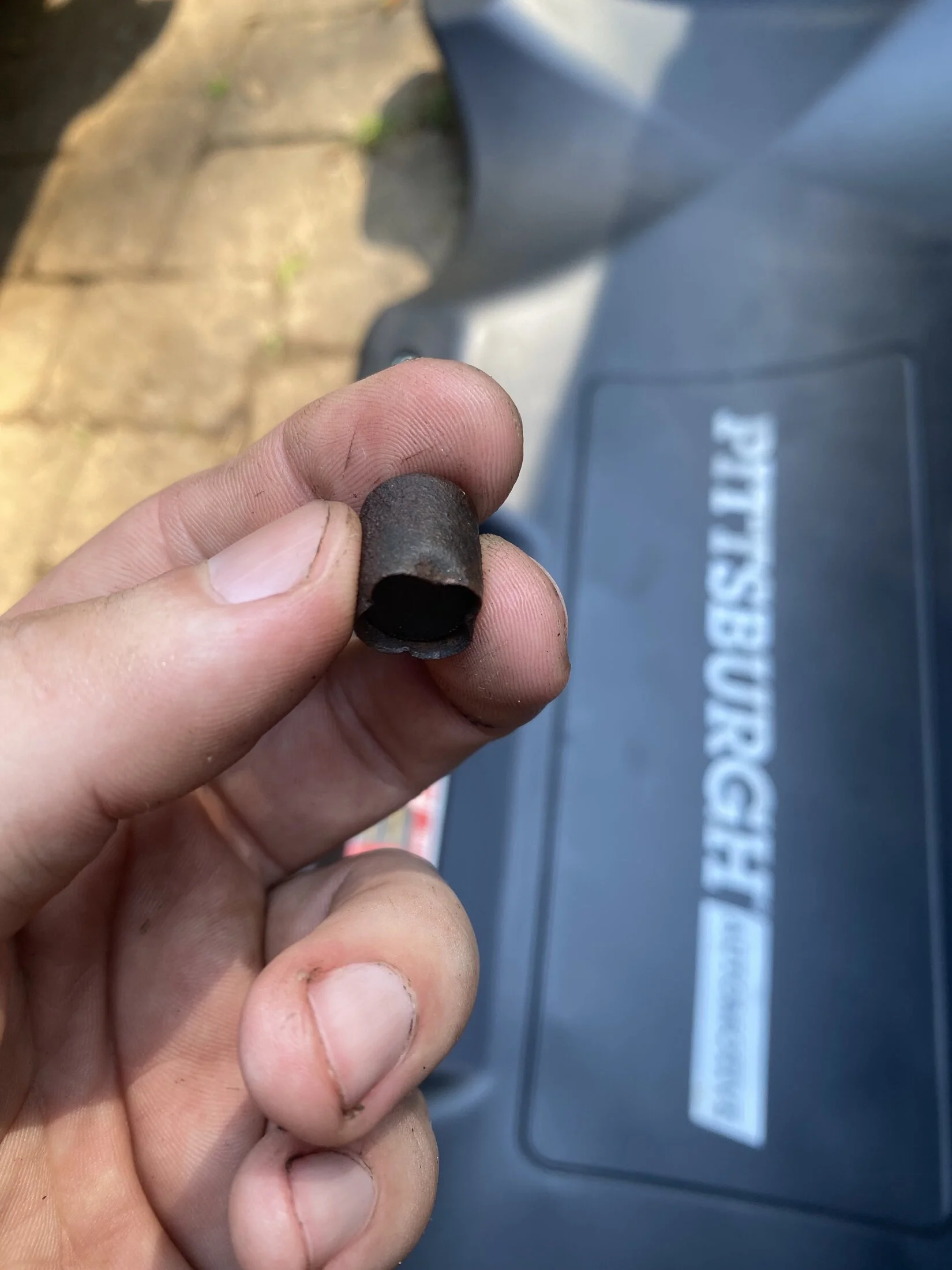

Hey all, I was replacing fluids yesterday getting ready for a road trip this weekend, and when using one of those strap oil filter removal tools, this little piece fell off and I cannot for the life of me figure out where it goes. It seems to have a spring under the the metal plate. I'm assuming this coincides w/ my oil pressure gauge no longer working.

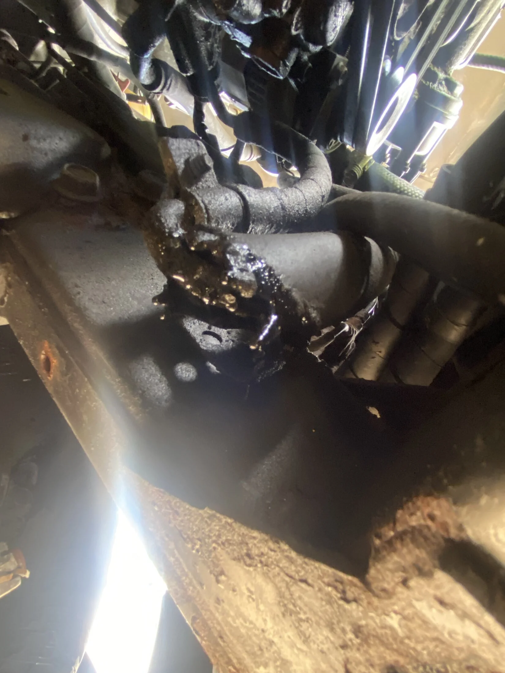

2) Didn't have any luck w/ finding another forum for this, but has anyone changed their PS pump hoses to AN style? Will rubber and push-lock be fine or do I need to replace with PTFE? No idea what caused the melting cover, was there when bought from PO.
Cap looks like it came off the front diff breather that is routed up to the frame in that general area.

Bless. Diff breather sounds very likely, will check it out tonight.

Clean/wash that area off that's wet, can't tell what's going on in the photo, then post up another photo.
