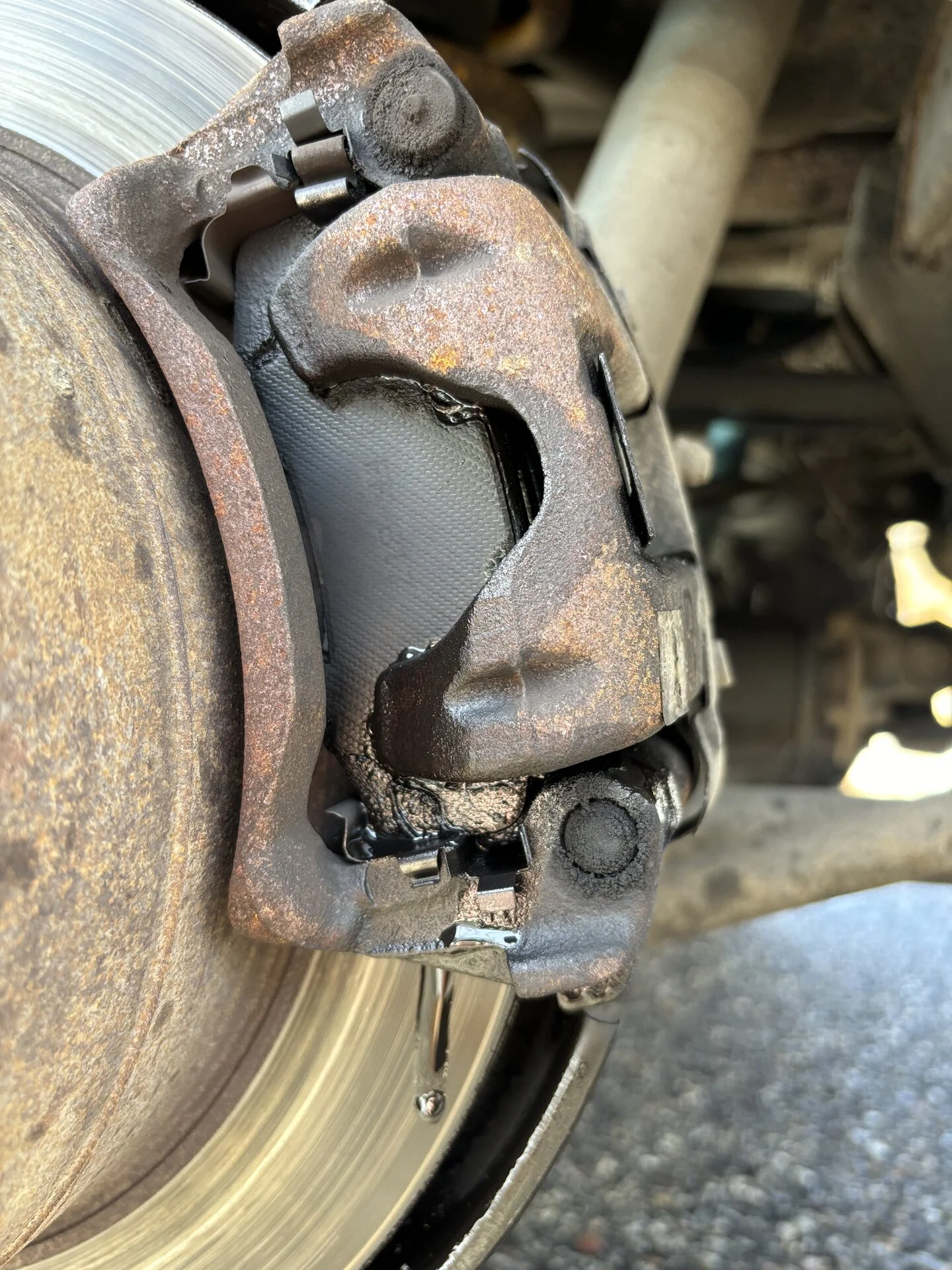

Pics. Rubber hose is completely dry. I’ve never had a caliper leak before.

Would be interesting to see photos of the leak source once the caliper is pulled off.

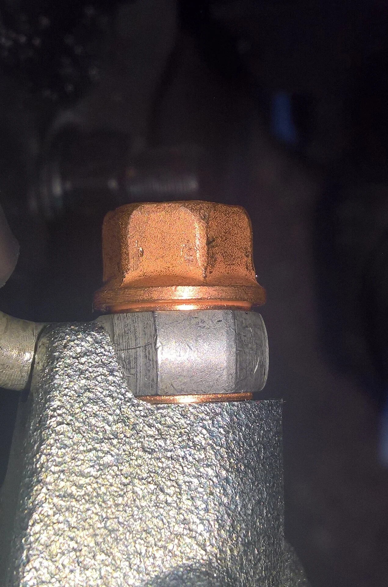

Trivia and hard to tell from the photo but the banjo bolt for the flexible hose does not appear to be OEM??
IIRC the banjo bolt came with the caliper.
Let us know what you find, pics help.

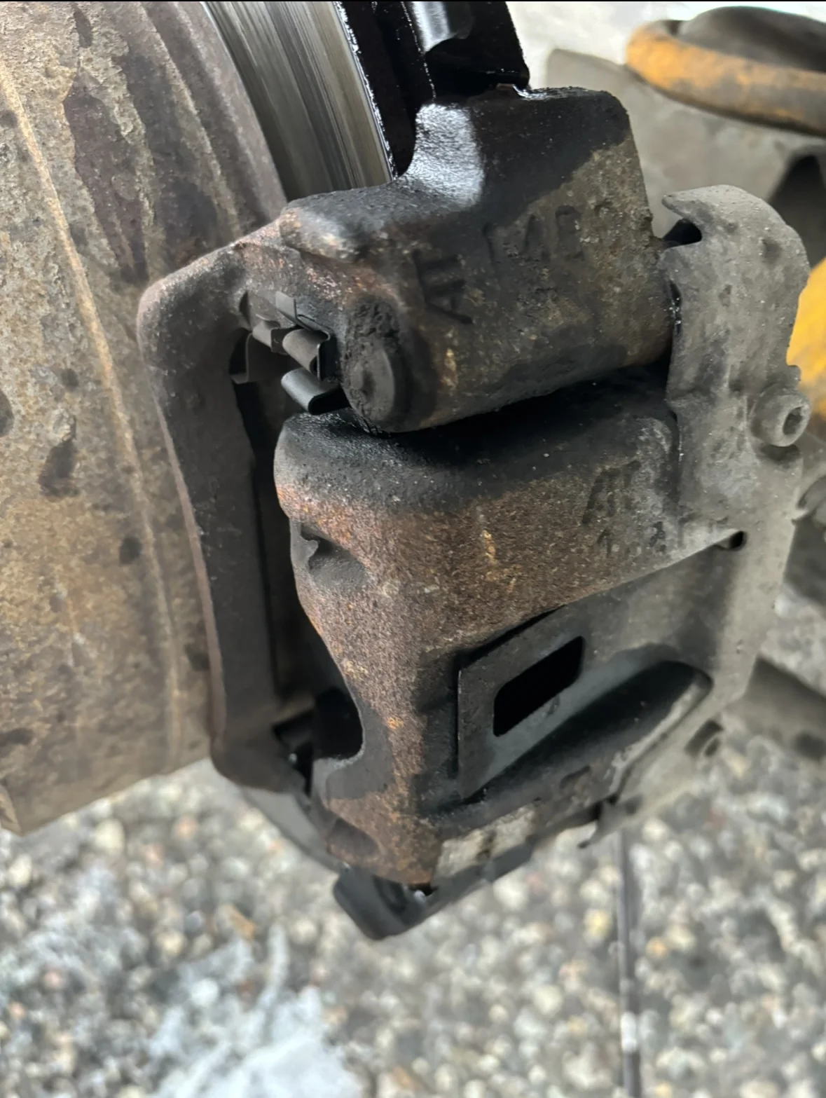

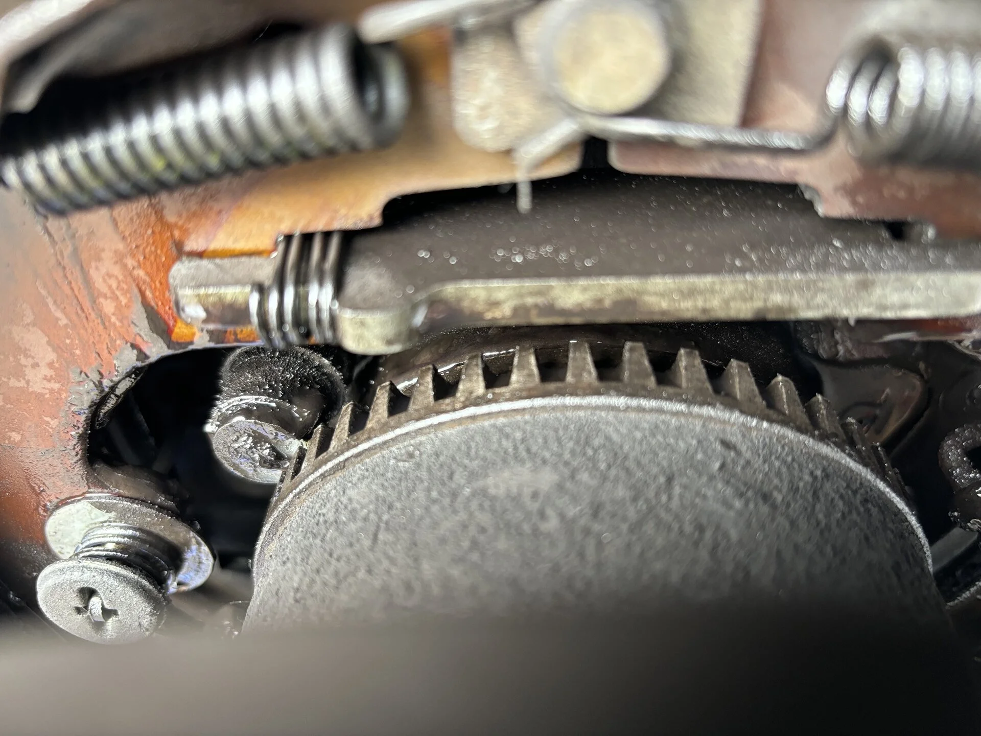

Pumped the brakes and took this picture. Pretty interesting as the fluid is running down the brake disc on the opposite side of the caliper piston.

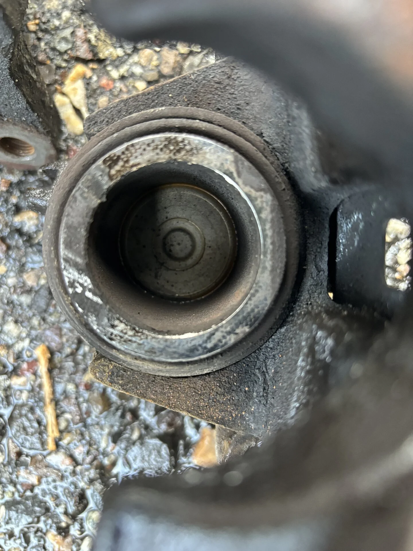

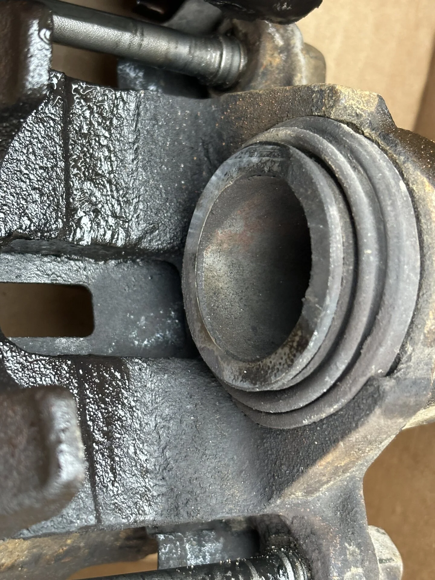

Take some photos looking inside the caliper as soon as you pull it off the rotor.
Well, I’m starting to think I might have an axle seal leak although one side of the caliper seal is suspect.

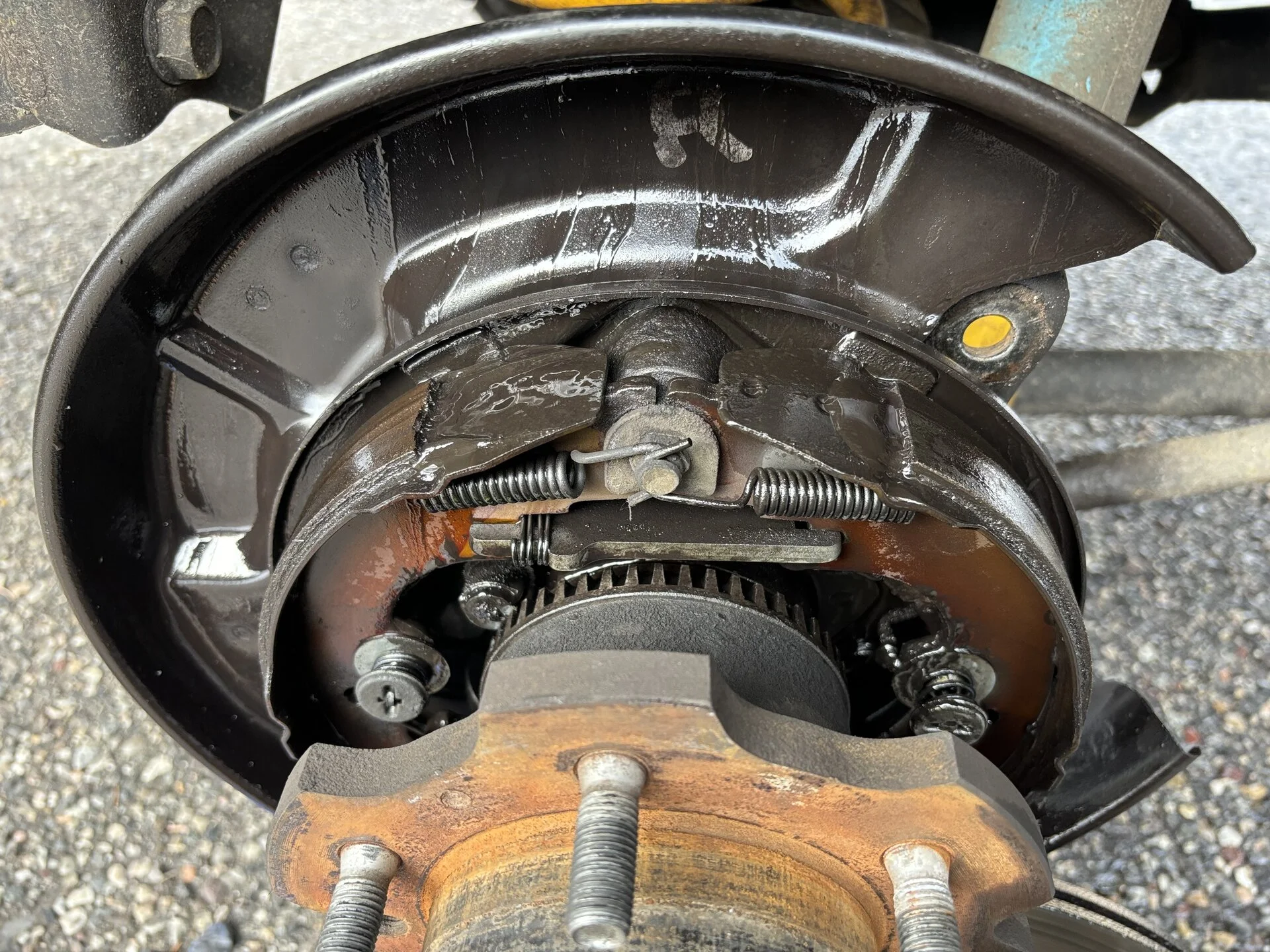

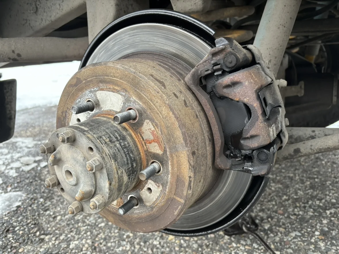

Got photos of the rotor (removed) and the rear hub on that side??

The threads I've read about inner axle oil seal leak seem to always show a wet outer axle hub or oil residue on it which I didn't notice.

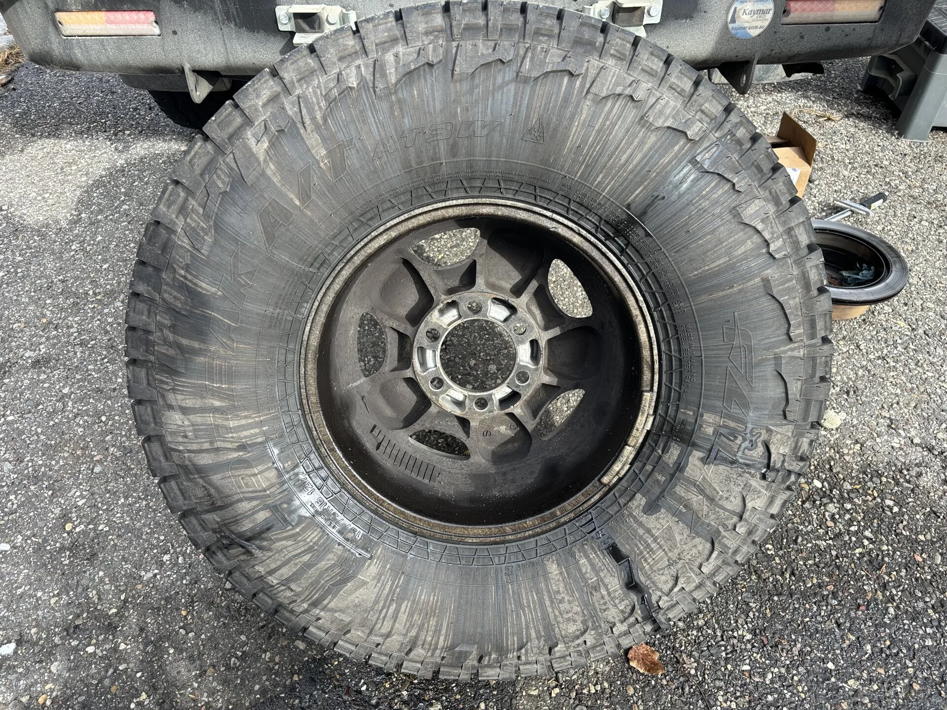

Pulled the brake disc. Pretty sure this is a gear oil leak. Strange thing is that when I pumped the brakes fluid started running down the disc and it looked like I had some brake fluid loss. Maybe 2 issues going on at once.
The inner tire oil spray was what first alerted me to the problem.
