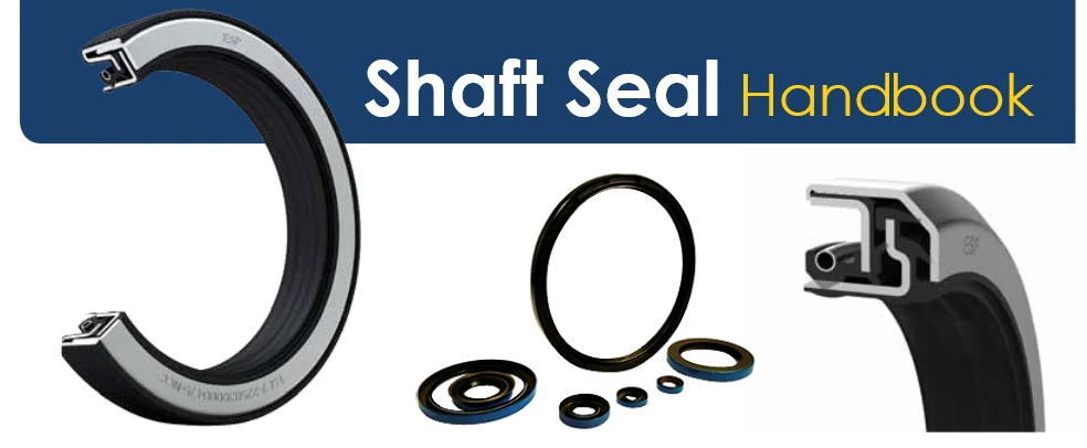

Was watching some You tubby videos out of Australia and came across one discussing the Terrain Tamer HD hub seals. Apparently the seal rotates on itself instead of on the spindle with the idea to reduce wear which is particularly important on the rear spindles which are not replaceable. The seal lips also have a new design so as to be less likely to leak.

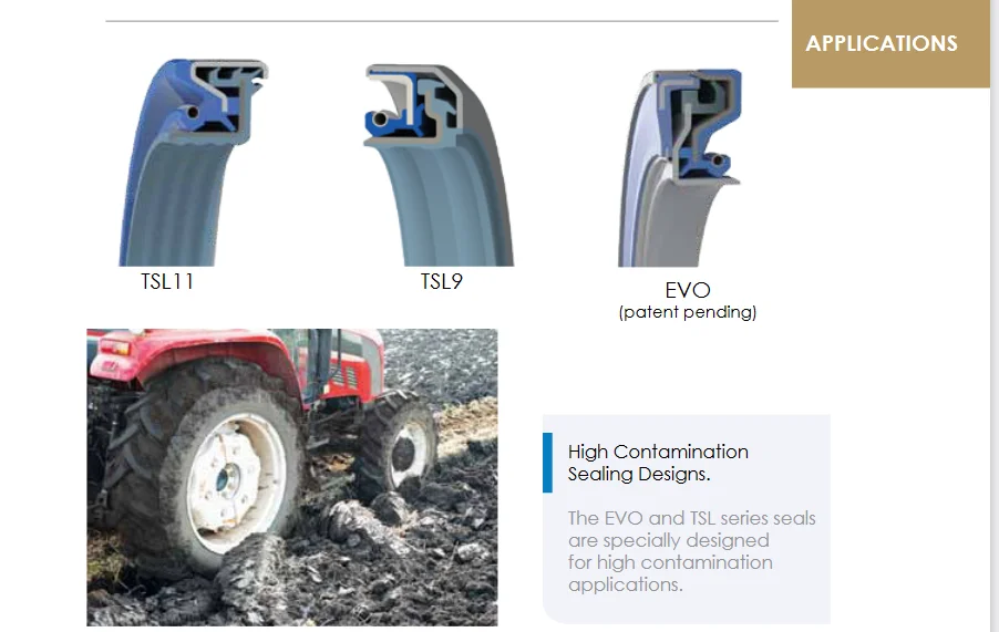

These types of seals are used in large four wheel drive/steer tractors. Have been for years. IIRC, Case/New Holland uses the SKF version.

How reliable do you think they'd be on US-market, full-time 80s regularly doing freeway speeds? Are they used in tractors on high-speed (relatively) shafts?
Any idea what they're called in the seal industry?
The manufacturers have different speed ratings, so yes, I would think they would work on an 80, used on the highway.

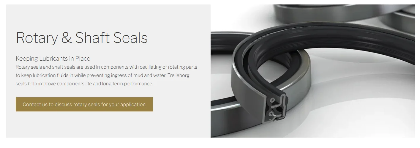

No idea about the nomenclature. I didn't spec them when I designed the axles for CNH, they did. I was mistaken about the manufacturer - it was Trelleborg, not SKF. All that Swedish stuff runs together in my head.
That was one concern I had also, can they handle the speed (internal friction?), but if it's a proven concept then maybe not a factor.
It would be interesting to learn what company makes them for Terrain Tamer and where. If SKF, NOK, etc, that should alleviate any concerns.

Here's the Trelleborg solution - cassette seal (generally):
ESP has them too:
