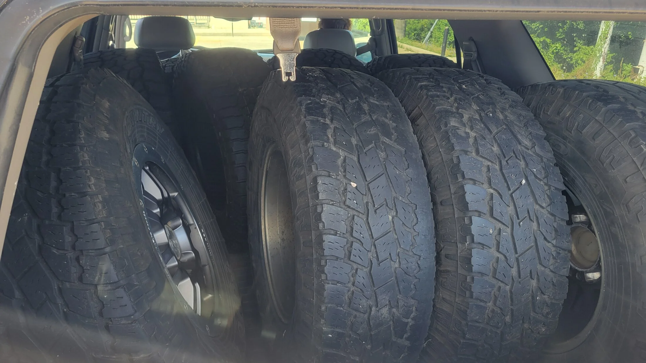

500 miles and 9 hours of driving later... A set of 4x Rock Warrior wheels in good condition (with old, destroyed tires) + 5x nearly brand new Falken Wildpeak 285/70/17! Just need to get the new tires mounted and wait for my spacers to come in. Fingers crossed that the new tires fix my issues!
BTW, you can absolutely fit 9x 33's in the back of a 2003 Sequoia, hahaha.

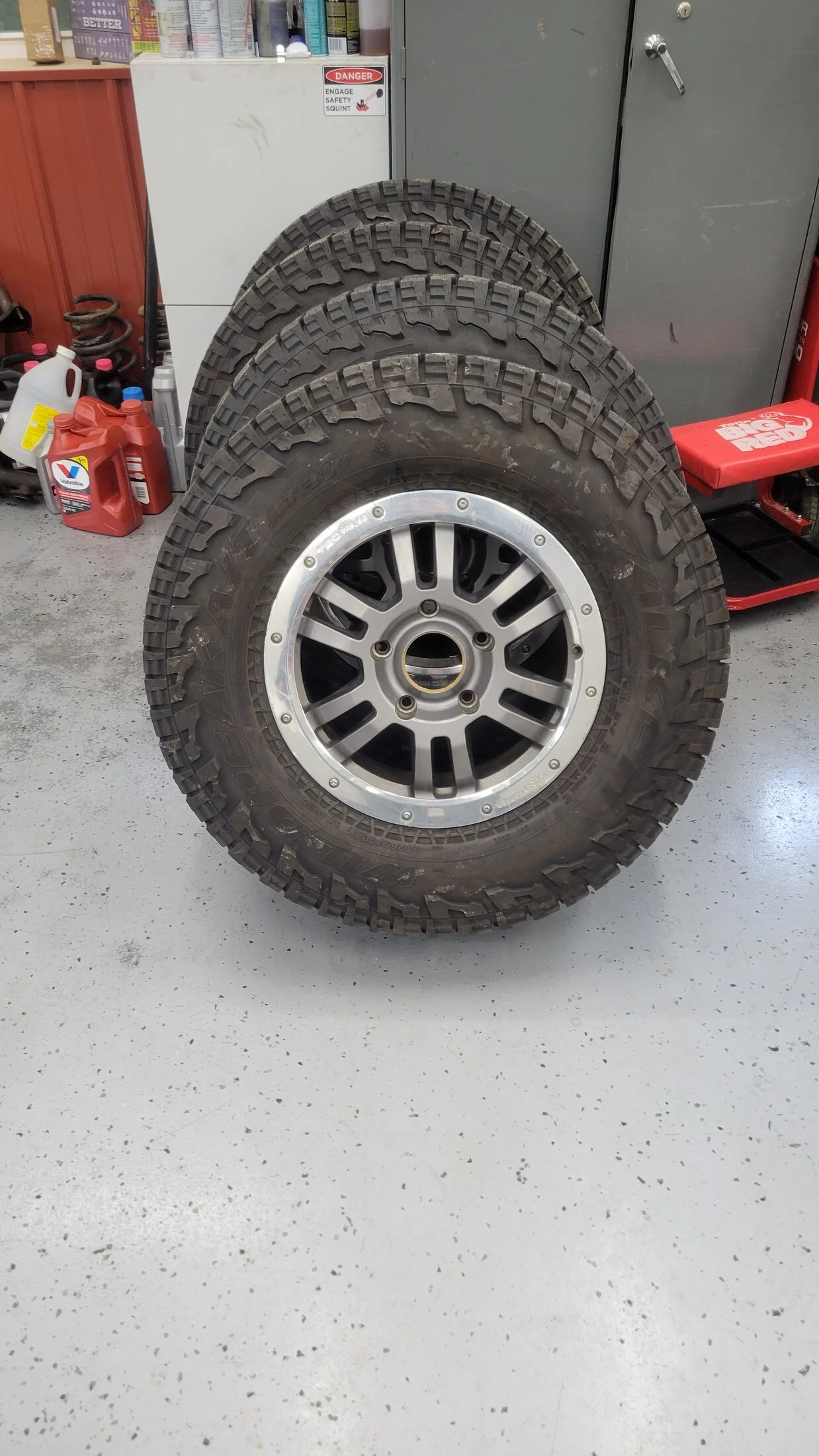

Just waiting on my spacers now after getting tires mounted... I know Rock Warrior wheels aren't anything special, but man, I think they're just about the perfect looking wheel for a 100 series! Just the perfect look of rugged yet refined. These came with the center caps, but they're pretty ratty (like most RW center caps I guess...). I may 3D print some new ones & use SendCutSend or someone similar to do a custom aluminum logo inlay/center.

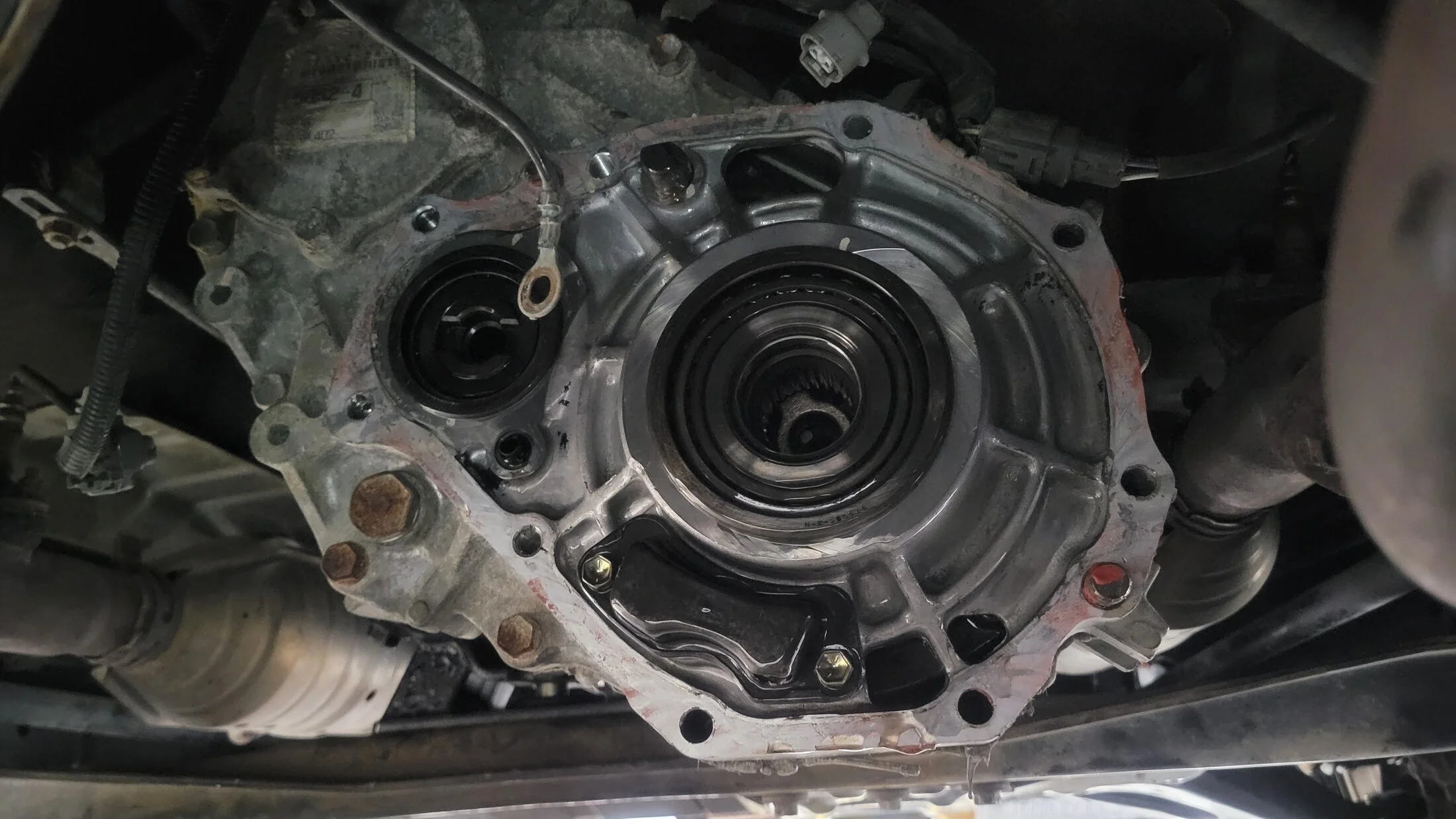

Just gave it another go tonight with the driveshaft in place (which gives me more leverage) and check this out:
Yeah. That output bearing is shot. That probably explains why it changed so much (but didn't go away) when I pulled the rear drive shaft off too.
This seems like an uncommon failure, so I'm going to have to do some digging I guess. I know Cruiser Outfitters sells a whole rebuild kit, but I'm hoping that's not necessary here. It looks like I might be able to pop the rear of the TC off in-situ to replace that bearing, but we'll have to see I guess.
You can remove the rear housing on the TC to change the breaking and seal.

So it begins... New bearing and seal should arrive tomorrow from @cruiseroutfit - gave them a call on Monday and Jason got me sorted out! Price for one bearing and two seals (because I know my luck) + shipping to my doorstep across the country in 2.5 days was $75, which was $40 cheaper (and twice as fast) as the bearing and a single seal from my local dealer. I'll take it!

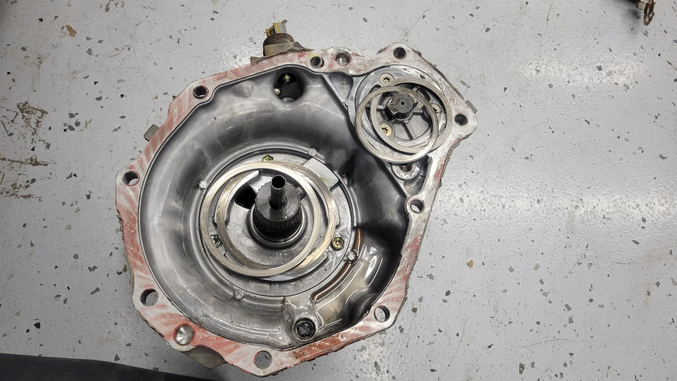

I've gotten the rear housing extension off & mostly dissembled at this point - I have to go get some better lock ring pliers tomorrow to deal with one of the snap/lock rings inside of the housing (specifically, the one that holds the shaft in place on the bearing). As suspected, there is a large amount of play in the ball bearing now - I'm hoping there's no wear on the actual housing itself, but I won't know that until the new bearing is installed.

Thankfully, pulling the rear bearing is easy enough. I got it apart today & check this out - yeah, I too love when bearings sound like ratchets:
