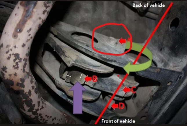

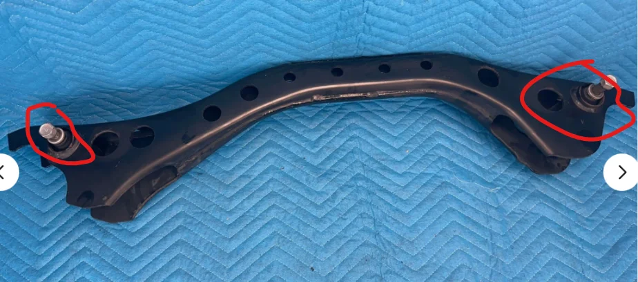

Had to edit my earlier post as I had the bushing location wrong on the torsion bar crossmember. It looks like the 'support assy, front suspension' sits inside a frame crossmember. Appears the torsion bars and support assembly have to be removed to replace the bushings.
First pic below shows the support assembly with bushings circled.
Torsion bar adjustment below with bolt/bushing circled.
