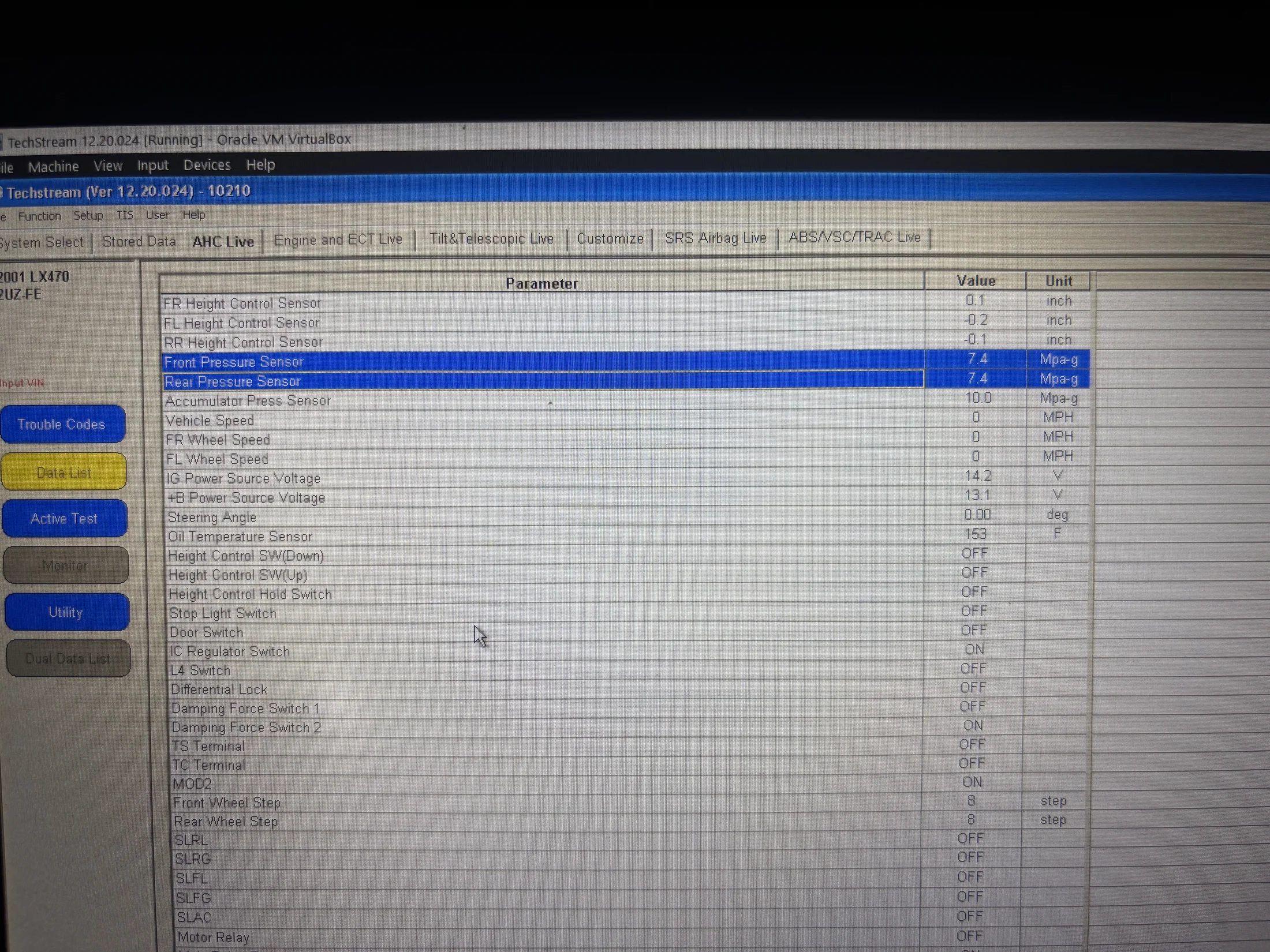

Is there a thread or any collection of information that explains options for rear springs to help high rear AHC pressures? I've looked over the ones that I can find, but there doesn't seem to be a real consensus on how much each option lowers the pressure. My rear pressure is a little high at 7.4. I have drawers with tools/camping gear, otherwise stock. 265k on my truck, and the rear coils are original as far as I know. I have globes on order, although that won't change the pressures from my understanding.
I still need to adjust my torsion bars to get the front in spec, but I'm just looking for some input on what to do with the rear. Spacers, OEM LX coils, Kings, AHC LC coils, non-AHC LC coils? Too many options...

Thanks all for all the info, I got my front pressure to sit at 6.9, which I’m happy with for now. I think I’m going to try spacers in the rear and see where I end up.
I tried to adjust the rear ride hight sensor, but the rear pressure did not change. I slid it all the way down on the slider. Shouldn't that lower the pressure?
On a slightly unrelated note, whenever I try to read the trouble codes for AHC through techstream I get an error. According to the live data page I have 4 trouble codes present. Has anyone run into this before?
I figured out a solution, jumped the 2 terminals in the DLC1 under the hood according to the FSM and read the codes via the blinking light. Then cleared them by pressing the brake pedal 8 times within 3 seconds of IG on. Now techstream gives me no error when trying to read codes, and none are present.
Did you disconnect the AHC temp sensor? Without disconnecting the temp sensor you may get incorrect rear pressure readings.
