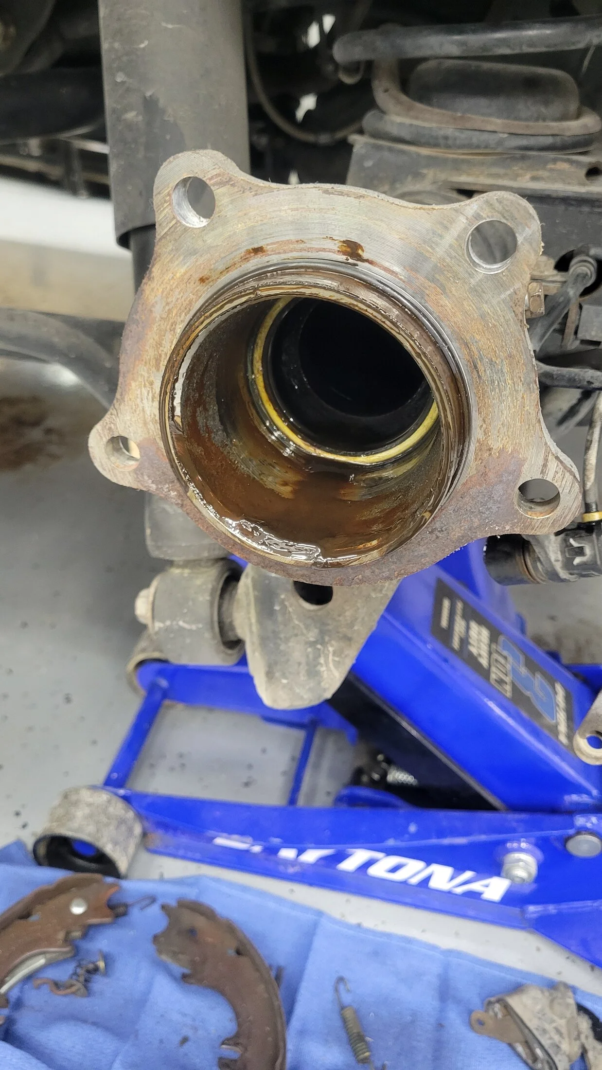

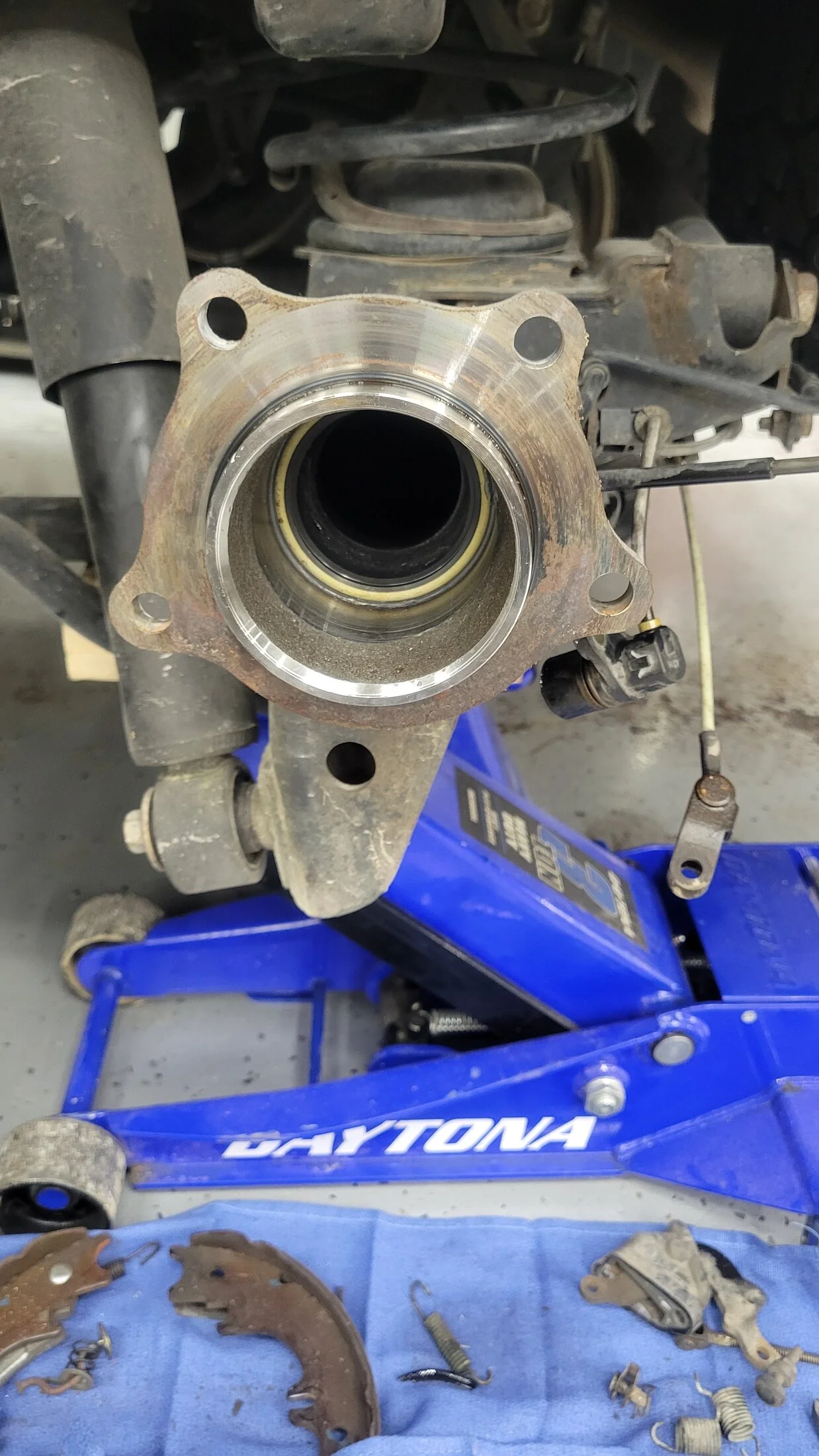

Still waiting on my press tools, but got the axle shaft pulled today. I didn't have gear oil slung all over my parking brakes (or any external gear oil), but you can see it was slowly leaking past the seal - maybe that's what nuked the bearing? Could have sat a couple years like that diluting the bearing grease.
Got the new seal installed (after screwing up the first one, as is Alex SOP...). Ordered another 3x seals from Partsouq just now in case I *do* need to end up doing the other side.
