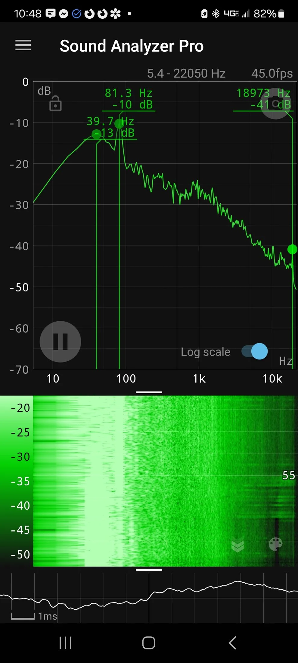

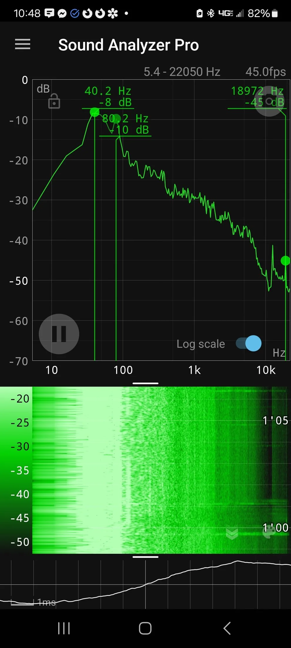

Yeah, it's almost like I'm getting constructive interference in the front. Some screen shots of my sound analyzer app sorta of proves this - although I'm not quite sure if I had cruise control on at this point, so it might not be quite A:B, but, check it out:
Phone held near windshield - look at that -8dB peak right at 40ish hz:

VS phone held behind my head - that same peak is now down to -13dB, which is a big change!
I'll verify that this data is real when I drive it with my buddy tonight. Doesn't solve the issue, but it's another data point...

Phone held near windshield - look at that -8dB peak right at 40ish hz:View attachment 3714467
