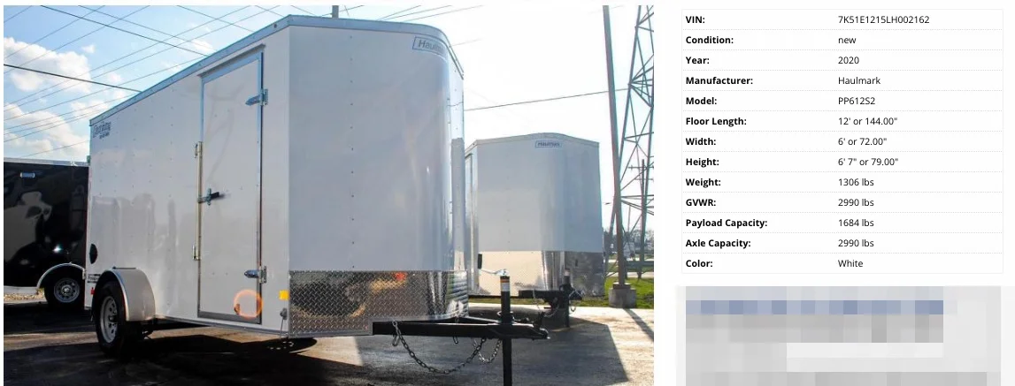

@GordJ - Here is a picture of the model of the trailer (not our actual trailer, but this is the make/model).
@Rgill - We're not hauling the bikes, we're hauling gear for weekend races (tents, tools, grills, propane tanks, etc.)
Looks like total weight is 2990. So based on what your using for a tow vehicle you might squeak by. I thought the trailer was 3k empty.

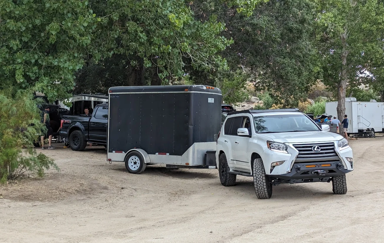

Here's what my group has and we often load it with too much crap. As a communal trailer, It's abused and put away wet. I try to do my part to check tires and tire pressure as no one else does. I just chopped the coupler off too and re-welded a new one as the last was so tweaked, couldn't count on it being locked on the ball.

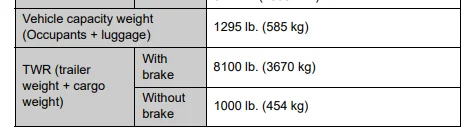

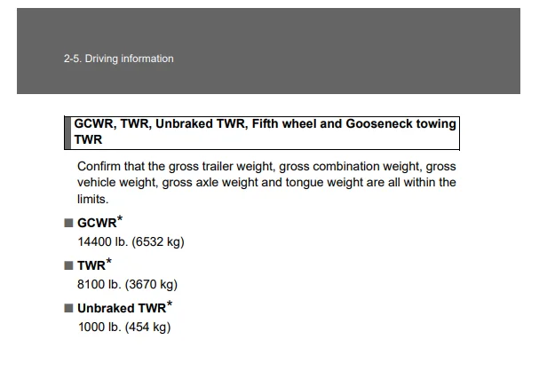

You can tow it legally. Pretty sure the Toyota manual says you should use trailer brakes for anything over 1000# so I'm not sure what would happen in court if you were in an accident. I would not personally tow it without brakes, except maybe to get it home empty.
Edit: confirmed it's in the manual

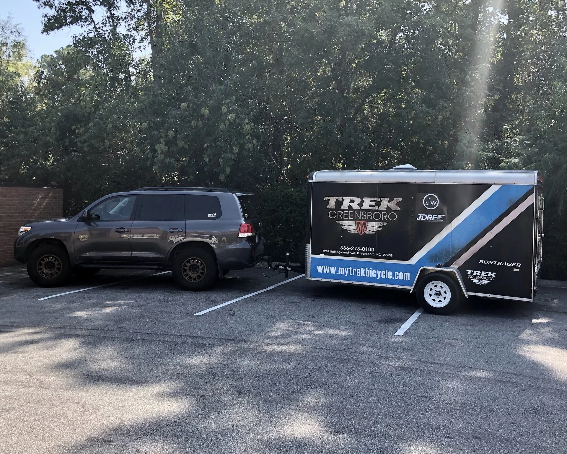

I tow a 2700 lb (wet weight) with no trailer brakes all the time. Ive towed it all over North America for years. Absolutely zero Issues.
I'm regularly towing a 4 place side by side (total machine and trailer weight of roughly 2,600 pounds) without brakes with my 100 series and it does just fine. If the load is to light, the brakes like to lock up and bounce the trailer. So if you do go with brakes, make sure you can adjust the power to the brakes depending on load. The only thing I tow that has brakes would be our small 1,800 pound teardrop camper. I've towed it with vehicles with a controller and without. It's fine either way.
