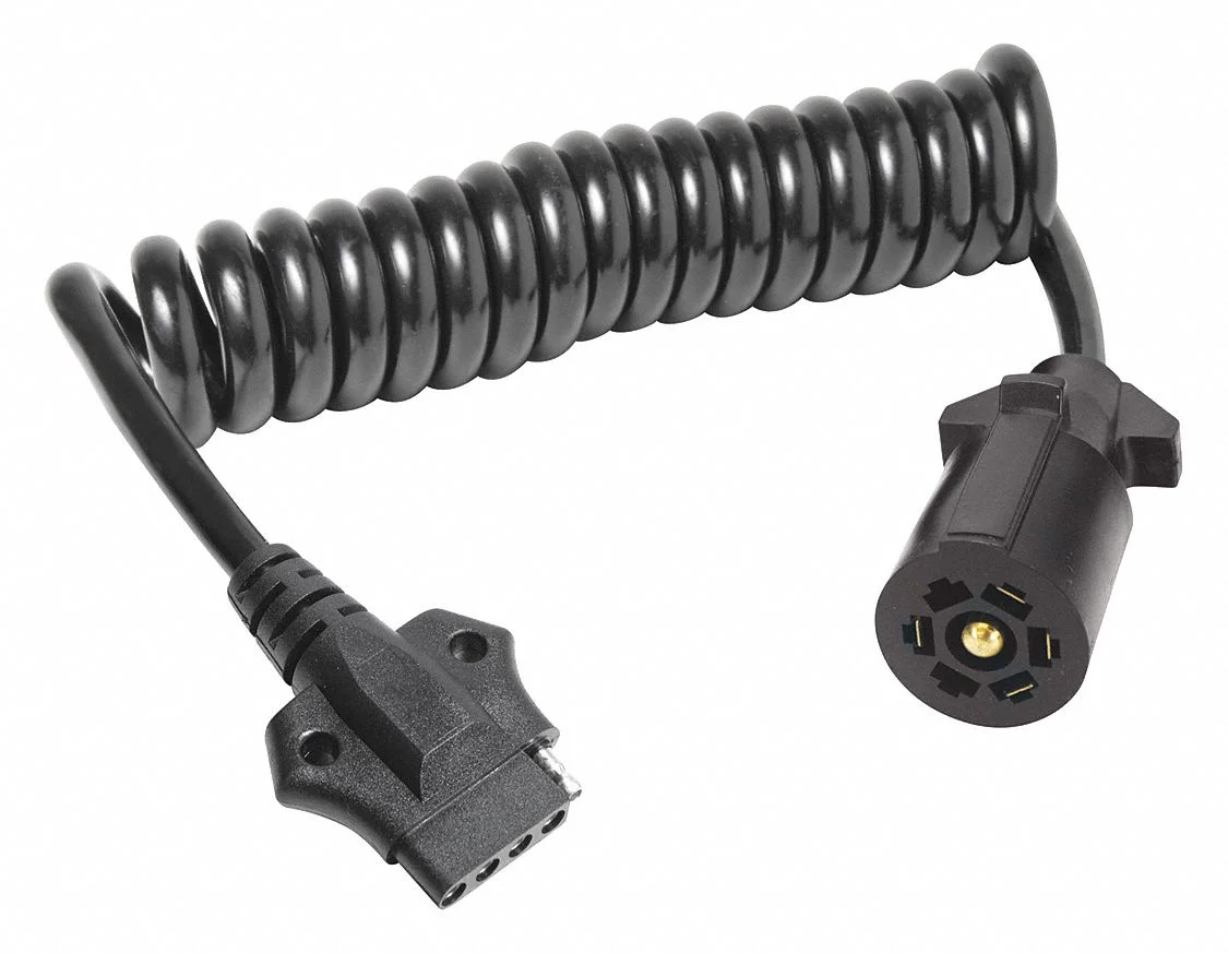

You need the Toyota 7 pin and a generic 7 to 4 pin adapter. The quirky thing about our vehicles is it’s all off to one side, so you usually also need a 4-pin extension harness too.
For the adapter I really like the models that plug into 7-pin then have a coiled cable that is a few feet long before it ends in 4-pin. This accomplishes both jobs at once. Easily lives inside the tailgate storage area ready for use.
