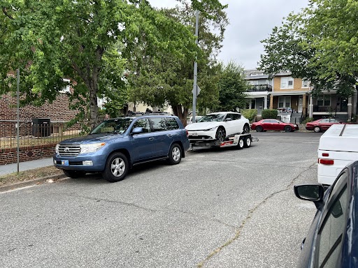

200.1 putting in work. Our EV is having issues so into the dealer it goes. Imagine this is probably 7k plus with trailer and it towed excellent.
RedArc Elite TBC otherwise stock.
