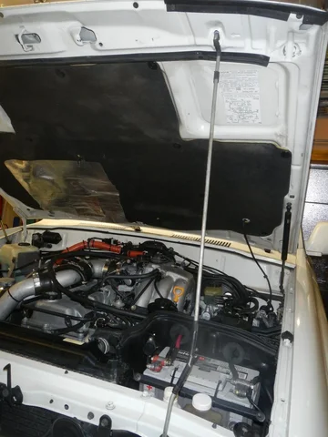

They are standard on DX models like mine, I went the opposite route and installed struts. The rod is still in place but has not been used for ages.

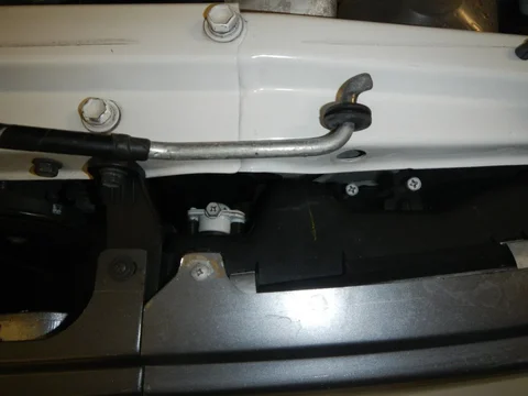

Here is a few pics of my DIY prop rod. It is just 5/16 rod stock, rubber grommet and spiral wrap. DSCN1508.webp DSCN1511.webp DSCN1510.webp DSCN1509.webp
I always thought the prop rods were annoying until my hood slammed down on my head. 80 hoods are not light! When I bought my 70 I tried out the prop rod in my 80. I added the prop rod to my list errr, "Book of Mods". It is number 119 in the book...

I thought I had a 60 rod prop but the angle isn't right. It will not sit over the radiator support nor will it clear the support when vertical to slide into the slot on the hood.
Anyone have a picture of an actual 60 prop?
