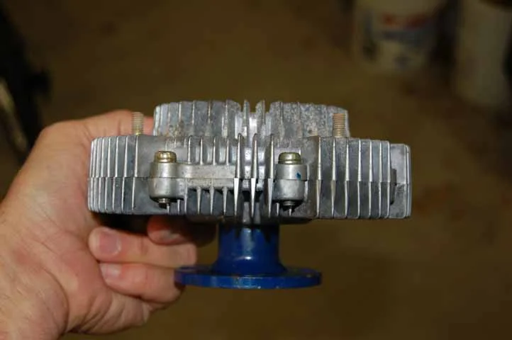

blue hub:
I think that folks are often in the 15k cst to 30k cst range with the oil they use these days. The Toyota oil is typically a lower CST but may be a higher quality. Here's a hobby version of the oil that should cover the refill on a blue hub:
You'll hear from some that changing the oil is all that you need to do but that's not always true in my experience. Sometimes the plates open up at too high of a temp to support sufficient cooling and I'm sure that some may open up too soon and waste fuel mileage. I prefer to use a double boiler and candy thermometer method to calibrate the opening temp on these but you can try a heat gun, etc. The last time I setup a blue hub I set it to: small hole 50% open at 110 degrees and have been pretty happy with that setting.
The only part you need for a rebuild is the oil, the rest of the needed supplies are the tools to remove the fan clutch, split it in half and adjust the opening temp.

Will this Aisin Fan Clutch work? Here is the link to Amazon
Amazon product ASIN B00829HAV8
Yep, that's the Aisin blue hub everyone talks about on the forum.

I bought that blue hub and mine is inadequate for cooling. I'm pretty sure it's exactly as @jpoole stated. I have two bottle of CST 15K in my possession now, just gotta find time to do it. If I would have realized this to begin with, I would have opened it up immediately and changed the fluid to be sure. I'm in the Midwest and don't typically see the heat extremes of the other folks, but mine can no longer hold the cooling if I'm pushing it at all.
